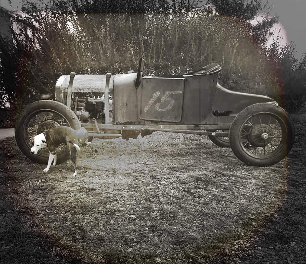

    OK, big news! I have a rolling chassis! Alright, I'll use that phrase lightly, as none of this stuff is mounted permanently. But knowing how I am with project, the quicker I make it whole, the easier in my mind it is to tear apart small sub assemblies to repaint and clean up or what not.

    Good bye until winter is over. Unless we get an insane warm up to melt the 10+ inches of snow on the way, that's it for any chassis work. I was hoping to get the torque tube made (I cut into two sections--but haven't determined the length), but I just ran out of time to get everything ready for the storm rolling in.
    For now I'll be relegated to work in the basement. But that's good because I need to start getting after the wood frame for the body.
