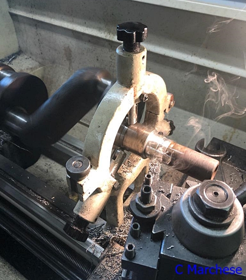

    Some minor progress. My engine builder started on the A-crank conversion. You will actually later see me build (assemble) my own engine, I just don't have the abilities to do the machining and babbit pouring to do these engines. As a totally do it yourselfer, it almost seems weird to me, to have someone else doing so much work on my own stuff, but I know my limits....and obviously I am not a machinist.
    So he chucked up the two crankshafts I sent him and turned the snouts down to fit the Model T crank gear. Next step is to drop them off at his preferred machine shop to to have the mains turned way down and the rods turned to clean them up.

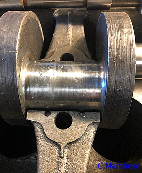

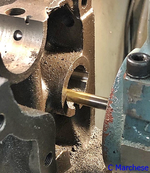

    Not much to report from my end, but over the past month I have received many pics from the machinist. Lots and lots of block work, quite frankly a little more than even I anticipated.
    Lets start with boring the mains for the larger Model A crank:
    As you can see, the boring goes right out to the edge of the main bolt holes:
    The front and rear main castings need to be shortened to clear the counter throws on the crank.
    New "pin" holes are drilled to hold the babbit in place:
    Now the crank lays in there real nice:

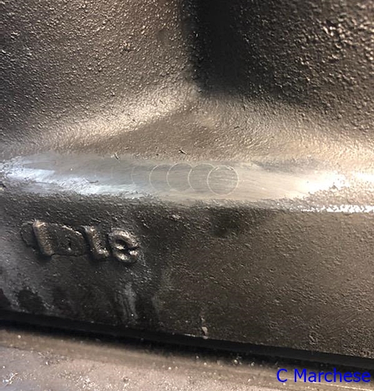

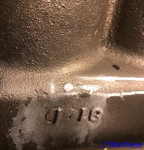

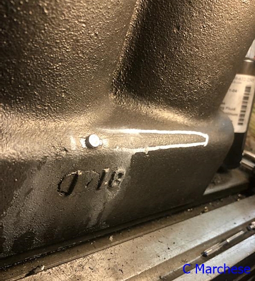

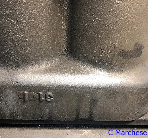

    On to a typical crack in the water jacket. This is pretty common, and I was happy to hear he could fix rather than me trying to get a guy the next state over to do it when the block cam back.

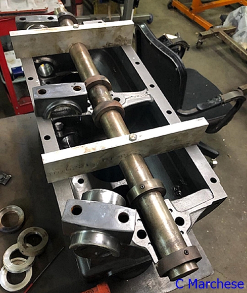

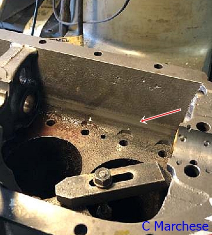

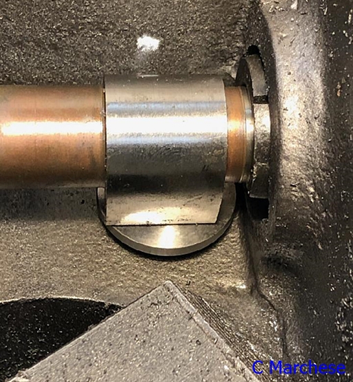

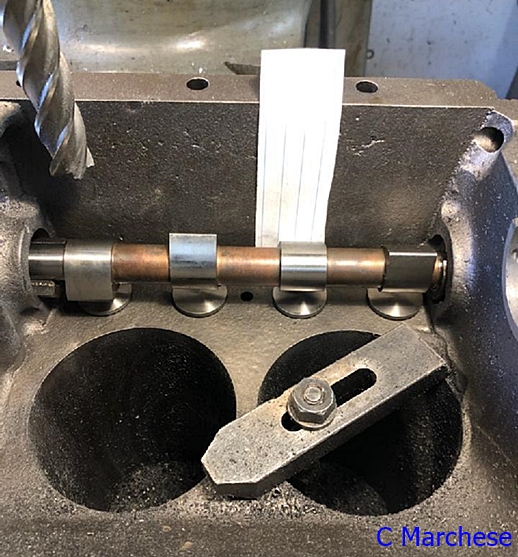

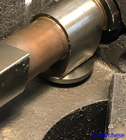

    On to more block work, to get the cam into the block due to the larger lobes, notches have to be made on the first two cam tunnels.
    The cam due to the lobe size uses a larger lifter base, very similar to a Ford Y-block. But with the curved wall of the block, they don't sit down enough to clear the lobes. so a little counter sinking is required.
    And then, to add to it, the cam lobes also hit the side of the block----the paper is there to protect the lobe:
    First counter sink the lifters, just a little eyebrow :
    Then a trough cut down the side of the block to clear the lobes....on the other side of the center web, it only hit in one little spot:

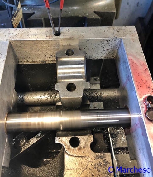

    Setting up to pour babbitt, this is the latest as of about a week or so ago. I know he poured the caps as he sent me a video. I'm not sure if he got to the block yet.

    Ask your machinist if he would share how he got the finish on the block after the lock stitch crack fix. Amazing!!

    Bob is correct, the notches will mean nothing once the split cam bearings go on and are in place. The notches are strictly to clear the lobes on install.
    However, this guy (and a few others) run bigger Model A based cams right on the block bores---and again, notches needed to clear the lobes.....they use full pressure oiling though.
    I think it's just a needle scaler. The flash lighting hit right on the repair, but if you look close you can still see the plugs.
