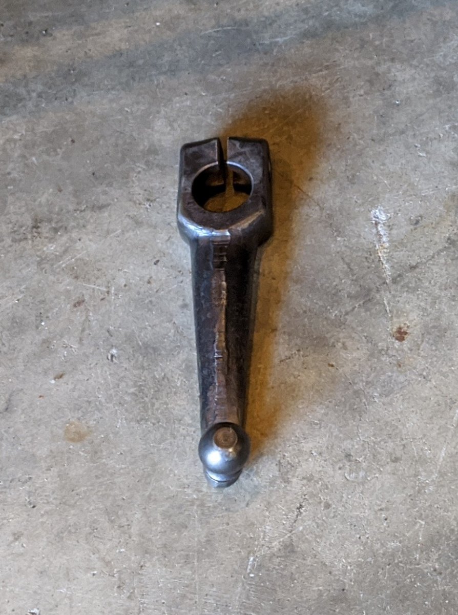

    Here's a cropped image from above,
    Again looking for a typical tie rod end style pitman arm with 1-1/4" sector pinch bolt hole to replace my ball style arm.

  24. F1 steering boxes had the shaft enter to the bottom side of the box. F100 had the shaft enter to the top side of the box. You have an F100 box.
    53-56 had a ball style pitman arm. 57-60 had a tie rod style pitman arm.

    Editor
    Good to know thanks
    I'm having a hard time finding info on sector shaft diameter
    Both my boxes have the larger 1-1/4" sector shaft
    F250 same years?

  28. F250 is the same box, yes. Except 59/60 4x4 which will be a longer(?) pitman arm and a different steering box flange and code. (If you come across one of these, I'll happily buy it off you).
    F100/250 trucks had a 3CC31 code steering box. F100/250 4x4 trucks had a 4CC39 steering box code.
    57-60 F100/250 boxes will have a 1-1/4" sector shaft diameter as well.
    F350 is a completely different box and I do not know if the sector shaft or pitman arm is a similar size.

    hate to beat this one to death but
    what would this smaller sector (1-1/8") from my junk pile go to?
