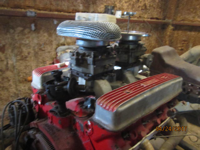

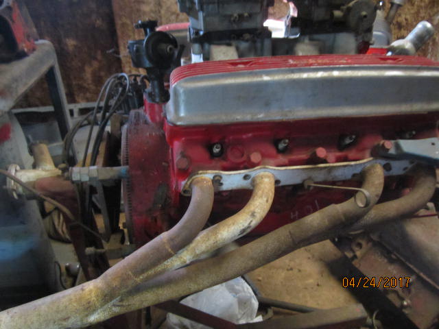

    John Mummert @ ford-y-block. com sells a T5 adapter. I have one on my 56. Best thing I did besides the Pertronix Ignitor from a performance perspective. Don't expect a lot of revs, tho. I have dual 1904's, a split header, ratio rockers (poor man's cam) & a lightweight flywheel, and stock rear axle... my 223 stops pulling at 3000ish rpm. They're tourqey tractor motors, more like a diesel w/ power down low.

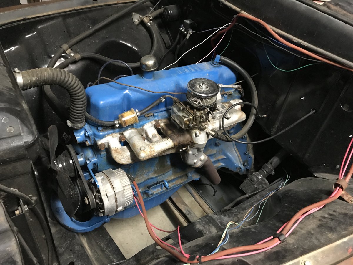

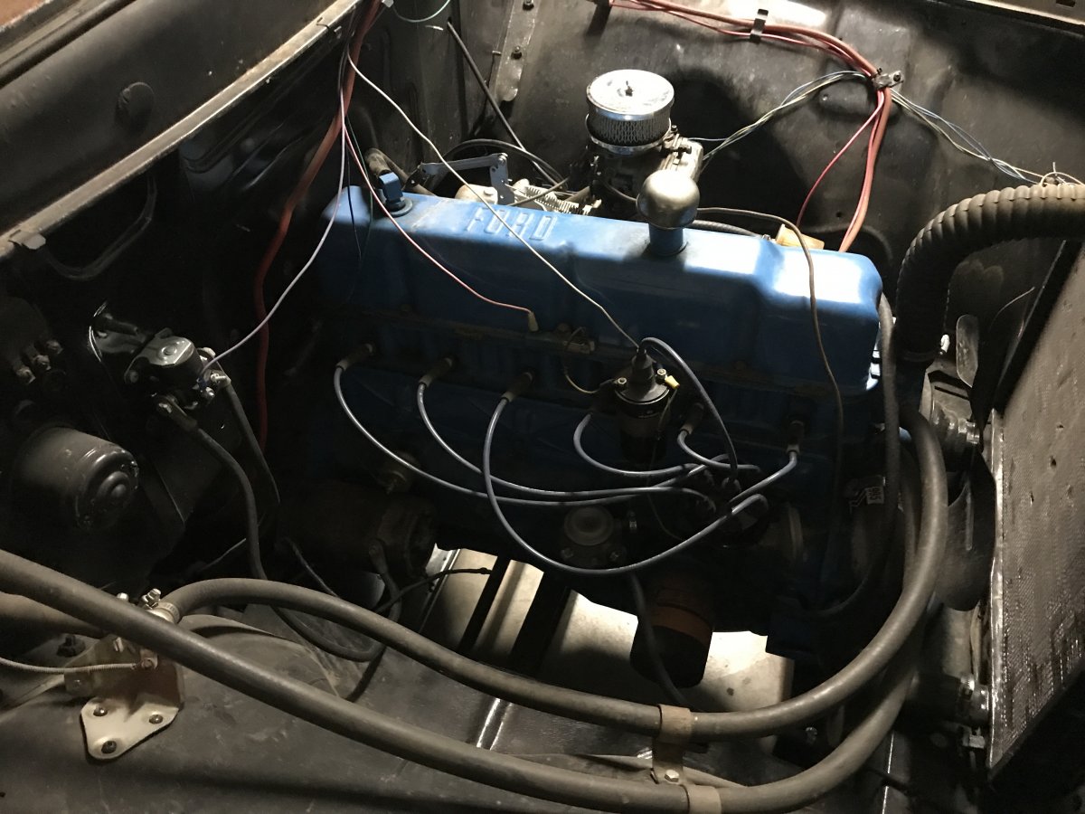

  9. IMG_0376.JPG IMG_0377.JPG Don't mind the terrifying wiring hanging everywhere, that's about to get fixed. As well as the fuel leak onto my intake manifold.

    EDIT: OK, now I see the photos. Take that air cleaner off and try again. Those little paper jobs have caused trouble before.

    It has a Load-O-Matic. Vacuum runs the whole deal. There is no mechanical advance.
    The single biggest upgrade that will yield power is to can the distributor, and get a modern one.

  12. That plastic gas filter is a fire waiting to happen. You engine appears to be newer than your truck. It has a PCV. Could have came out of a 1964 truck. The timing chain can be changed by removing the harmonic balancer and front cover. Be careful the marks don't alighn. There are 12 pins between the marks. Like on a Y block and some AMC engines.

    That little "air cleaner" is part of your problem. Those Holleys need the intake of air routed correctly, not half choked ...
