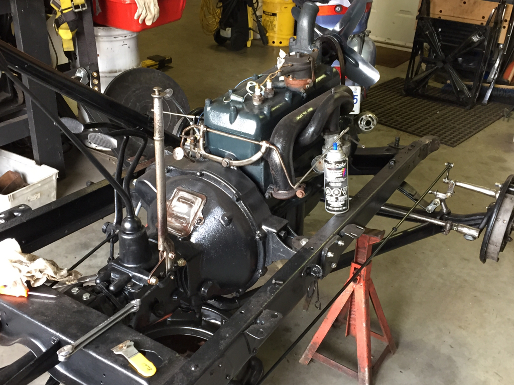

    Slowly making progress but not as much as I hoped..
    Did a little parts run on Saturday to a local supplier
    Motor and tranny painted
    Hopefully after work today I'll be able to put the frame on and get some real work done

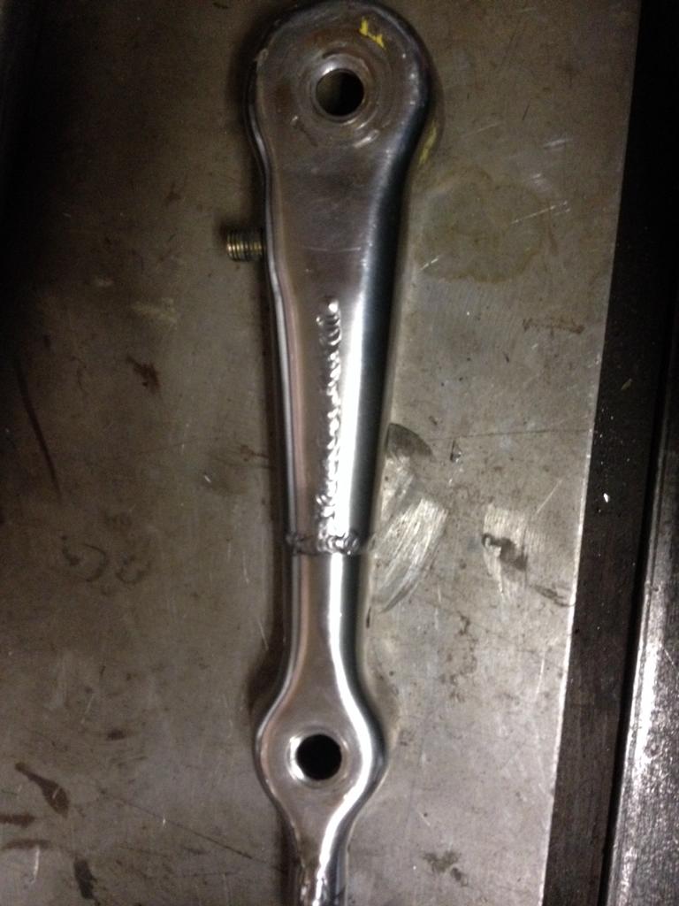

    Just saw your Kreger engine mount, and thought I might post a picture of the one I just bought. Not 100% sure if it is exactly the same as yours, but here are some pics that might help you rebuild yours if it is the same or similar. Hope it helps. Keep up the good work.

    Almost exact! How is the rubber mated to those triangular peices? Mine are pooched

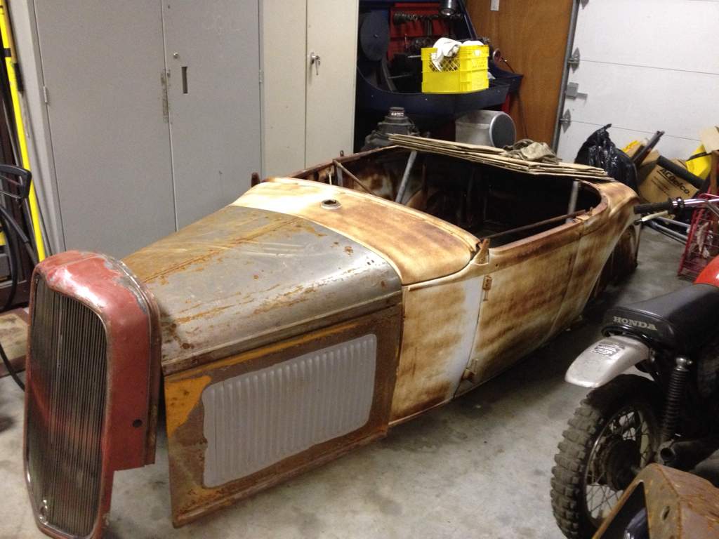

    Got the body from a fellow hamber ( and he bought from and old speed shop years ago) And one of my good friends brought it down for me.. Cleaner than I thought ! Few things to address yet..

    Wow!!! Nice solid body!!!
    There is a small metal rod/wire about the same thickness as a paperclip that goes through the triangular piece to hold the rubber block in place. Hope these close up pictures help.

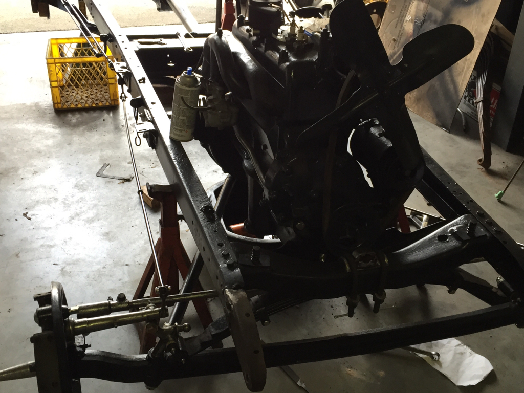

    Geez sorry I went stale there for a long time there boys got in a car accident in September and just started a new job shortly after that do haven't had the time to do much at all ! Now at least with my new job I have 7 days on and 7 days off soo we should be getting a lot more work done..
    I'll grab some better pics tomorrow but these are the latest I have on my phone but progress is farther than these
    I was having a big problem with the rear cross member and spring not lining up
    Stupid me rushing and installed the front motor mount backwards.. Now you'll know the answer in anyone has this problem, took me awhile to figure it out

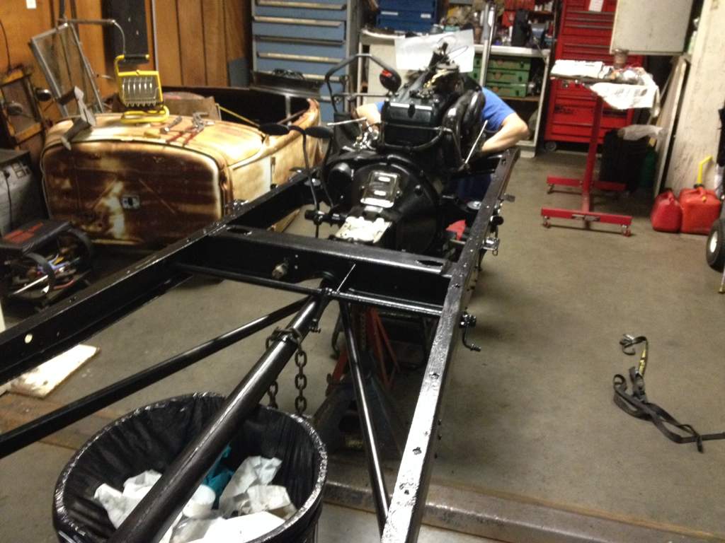

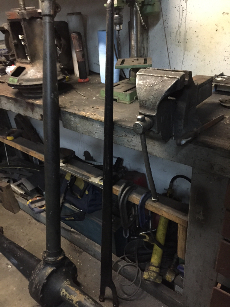

    More work done these days off slowly but surely getting done haha
    The bones were hitting the frame since we kicked it up so I had to drop those aswell
    Cut them roughly 8 1/2" in
    My buddy had a stock banjo rear with the torque tube on it so we were able to bolt it up instead of guessing
    We used 3/4" round to drop them down just heated them up and bent them down approx the width of the
    Stock bone
    All done

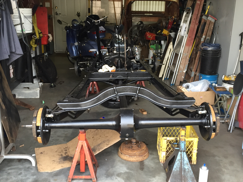

    Everything is done chassis wise, bolted on ready to go
    Wanted to do 18's but settled with 17's gonna send them to get blasted and paint them antique white I'm thinking

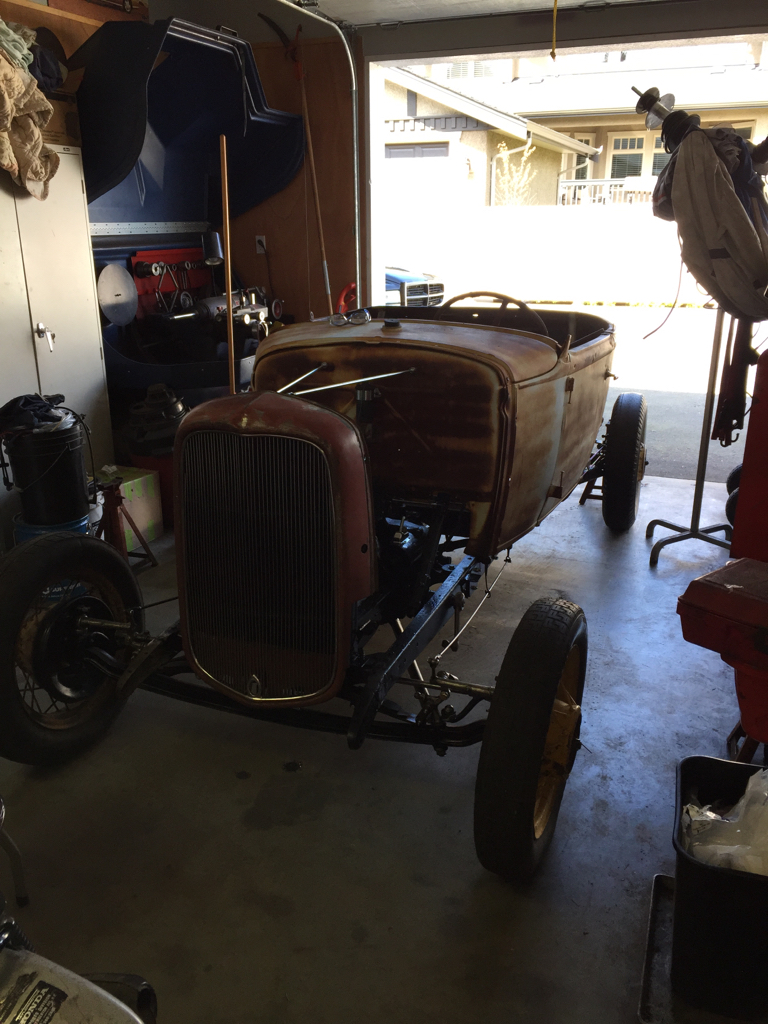

    Pic of the car on the wheels with body on
    Got the radiator made and mounted and grille she'll just placed on for now ... Starting to look like a hot rod ! (Sorry for dark pic)
    Now just on to bodywork within the next few weeks here... Have to fix some minor issues aswell with steering I'll keep posting !

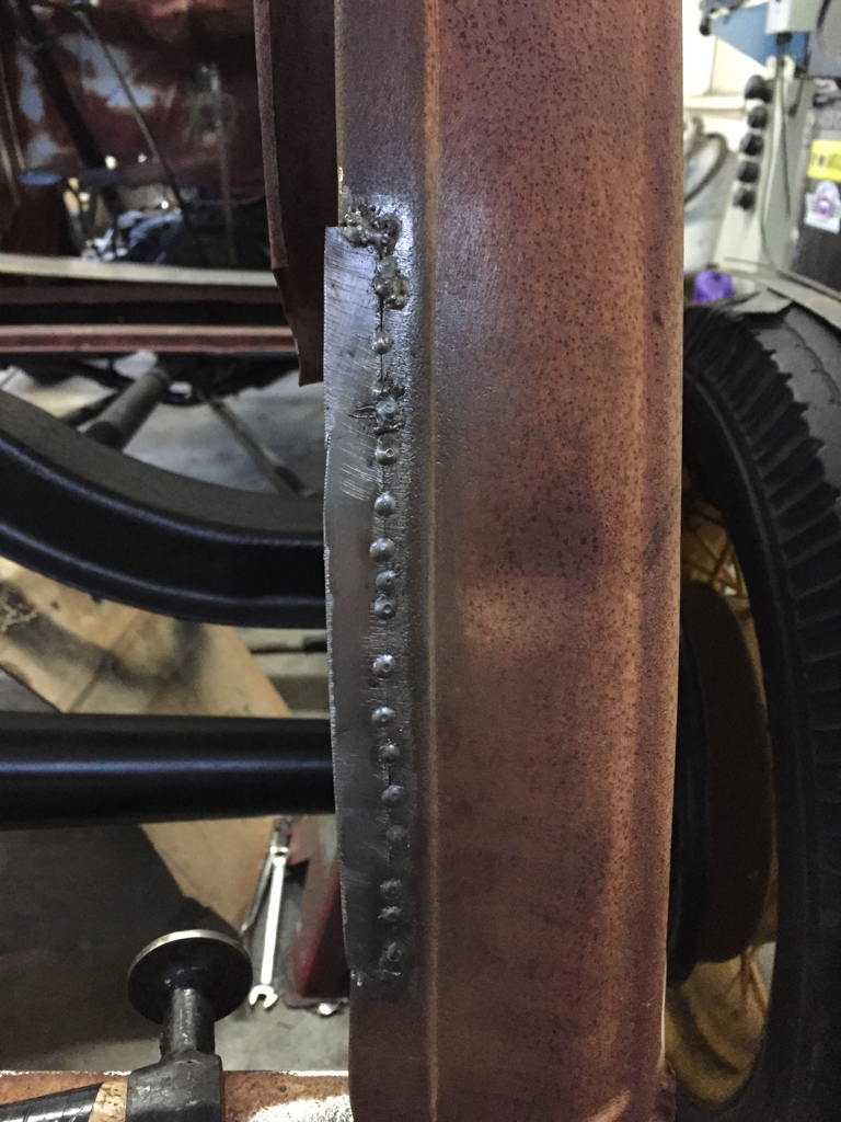

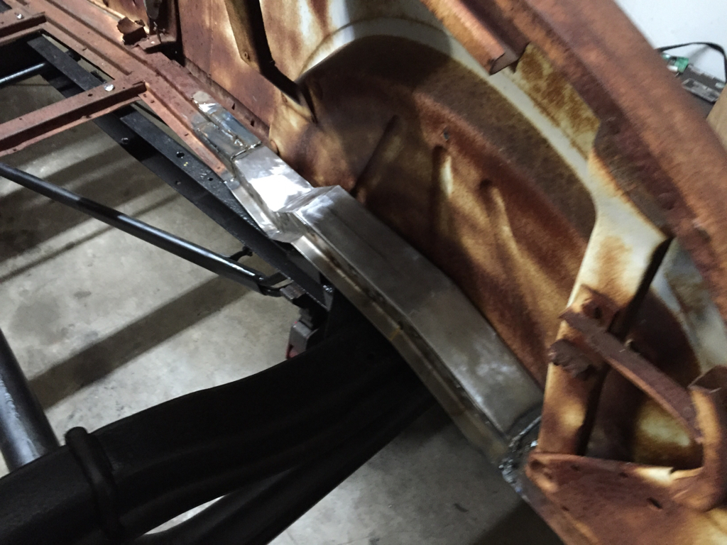

    Got some more work done it these days off onto body work finally! Haha
    First thing we did was made the new subrails for it in the rear
    Got to shrinking the above decklid panel and patched a few holes aswell
    Next thing we tackled was doing the rear quarter panel right in the corner where the decklid sits both sides
