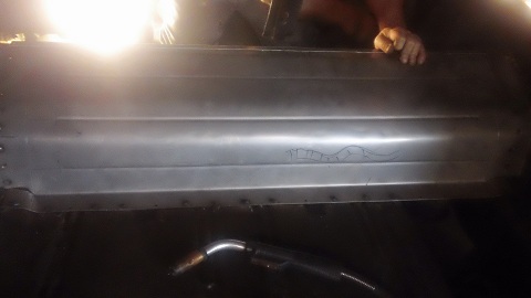

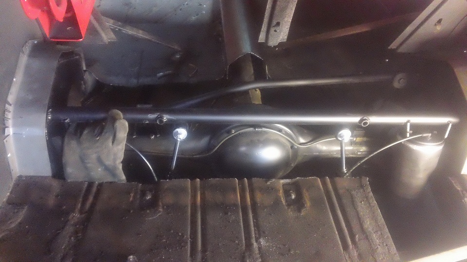

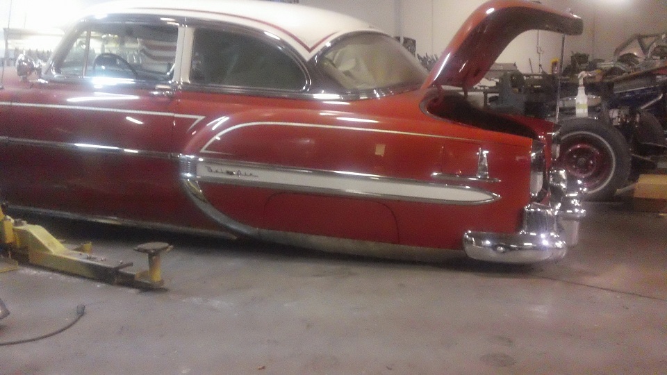

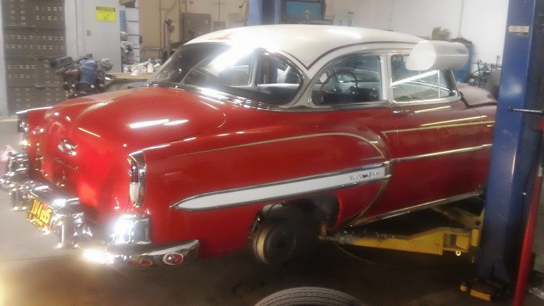

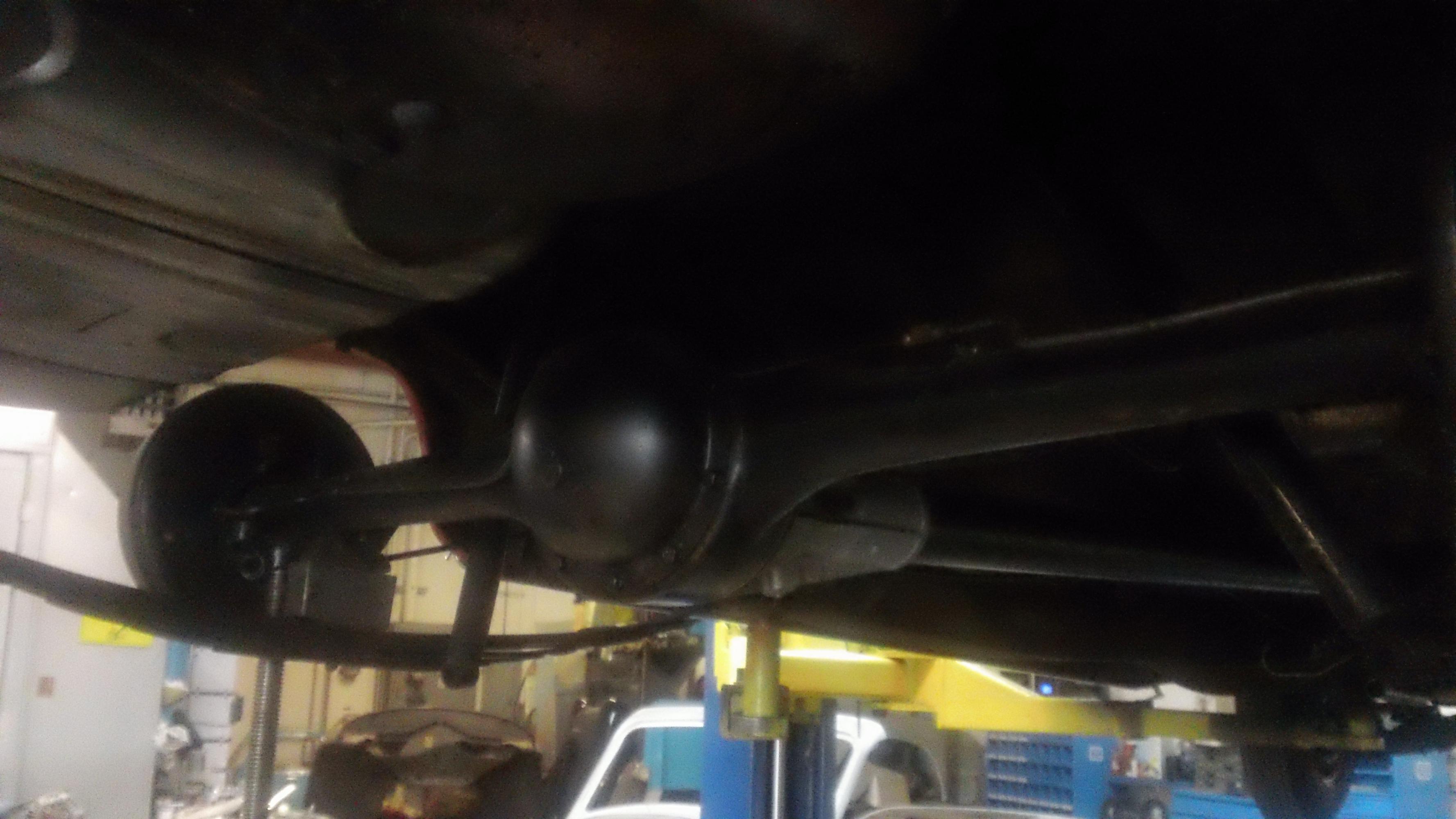

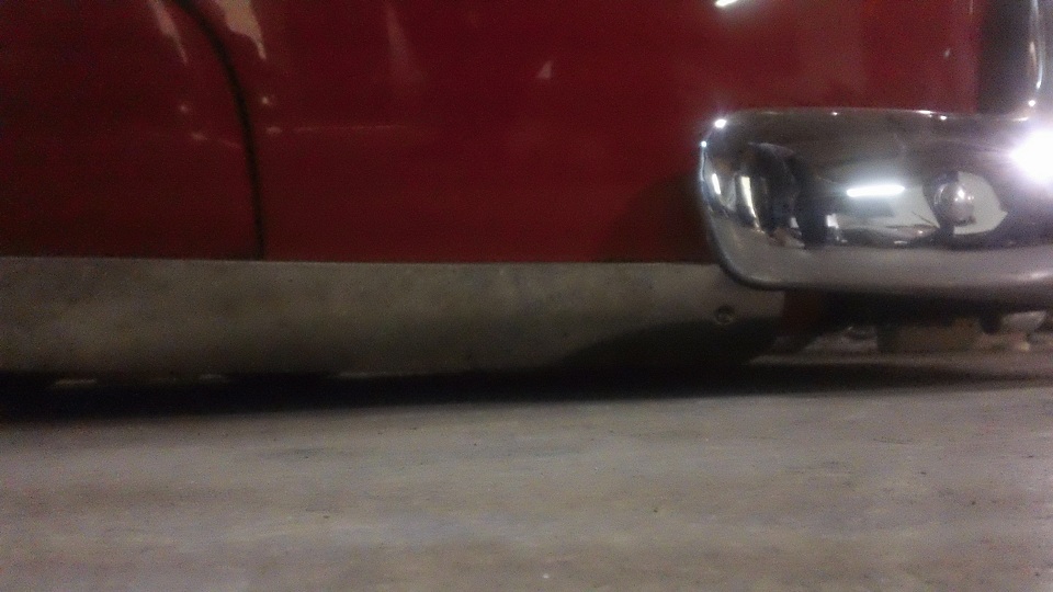

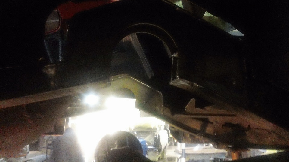

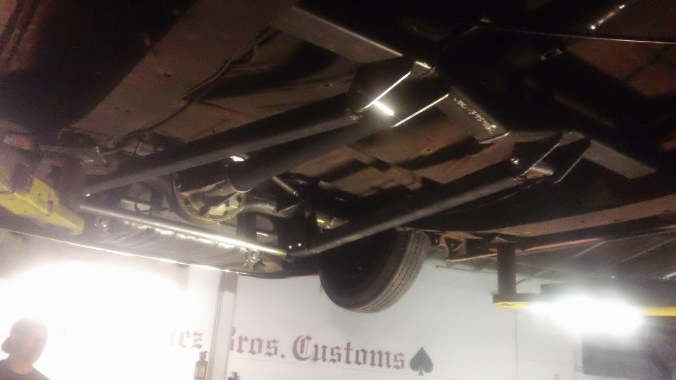

    One of this weeks 2 link installs at the shop was Dave" skittles" Cervantes 54 chevy post. it came to us with the o.g. close drive but he wanted it LOW, so we decided to move the rear end back 1 3/8" to center it in the wheel well. by doing this, it should prevent the drive shaft from jamming the tranny, a common problem when you slammit with tall blocks, minus a few leafs. we recommend a 2 piece drive shaft to eliminate the monster tunnel problem that occurs with most low cars. keep an eye out for the J.B.C. close drive yoke conversion coming soon.

  2. That's cool. How did you mount the axle on the rear bars? What is your close drive yoke conversion going to allow you to do? An open drive shaft on a stock tranny?

    I don't get moving the rear 1 3/8" to the rear? I know the GM AD P/U are off but even the cars or does dropping it to the ground make center look off?

    There is 2 reasons .first is to center it in the wheel opening and second is to prevent jamming the torque tube into the tranny..As far as a mini truck i never owned 1 nor seen 1 with a closed driveline....

    Moving it back recenters it. with a 2 link you get a little more arc (depending on length of bars) than a 4 link. even though it has tall blocks its already on the forward swing because the imaginary line from front pivot to axle center isn't parallel to the ground.
    looks good and is a easy way to save the floor under the back seat

    Nice work man, I built custom trailing arms for mine (approx 5') like c-10 trucks. This style suspension works great for these cars as you dont have to cut up the floor and the pinion angle change is very little during all its movement.

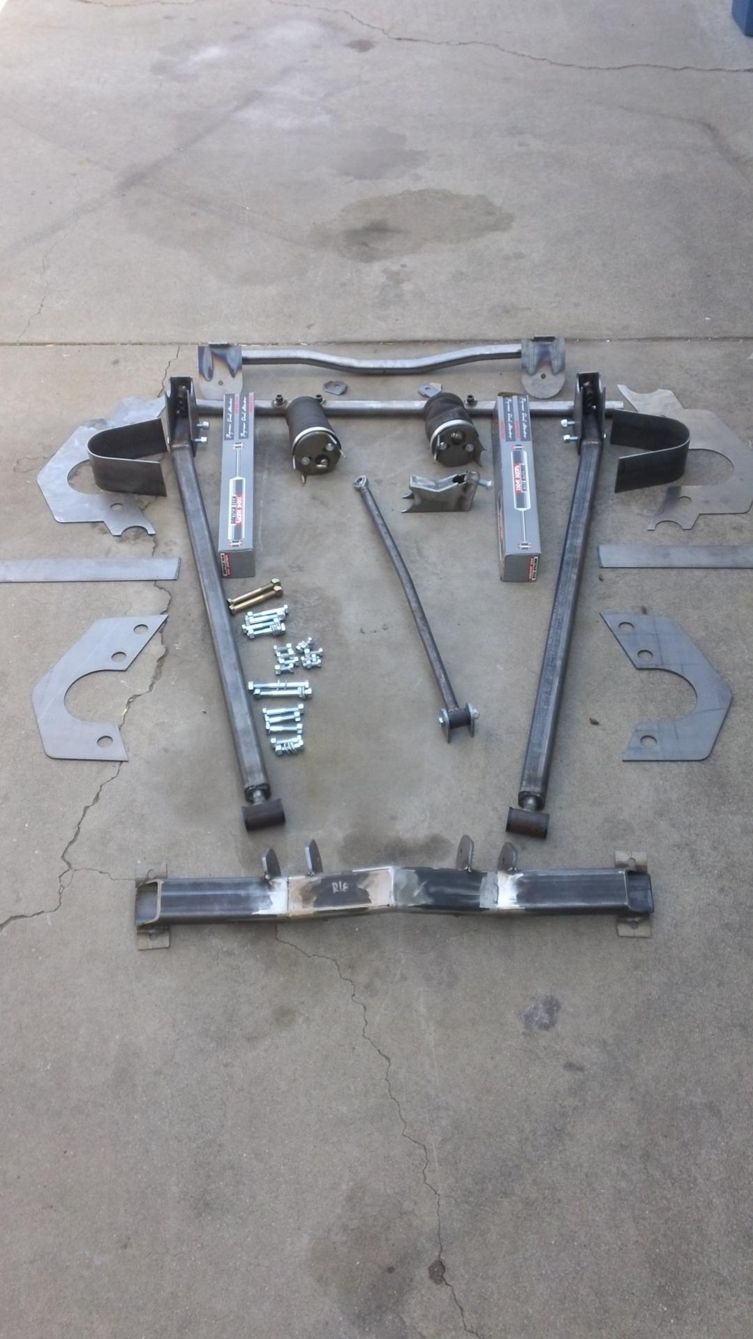

    cain, thanks for sharing, the more I see this set up, the more I want one. I looked at the website but it needs helps.. not much info. what rearends can be used (does it take a 3" tube (axle housing) like a 9" or will a rearend out of a S-10 4x4 work (I think those are smaller diameter)
    Also, when the front gets lowered, does the bolt in crossmember (front arm mounting location) hit the ground (since it is bolted below the frame)
    One more question, how much does the step go above the factory frame rail (how much is the floor raised)
  20. jbc jobe
    Joined: Feb 28, 2011
    Posts: 30
    jbc jobe
    hey boones
    the perches are set up for 3" tubes, but ive centered up and welded smaller tubes.only the trucks47-59 sit below the frame but thats cause they have running boards.cars sit roughly 1/4" above bottom of frame on the cars and notches vary 5-6"s. i also recommend a 2 piece drive shaft for little or no tunnel. hope this helped.
