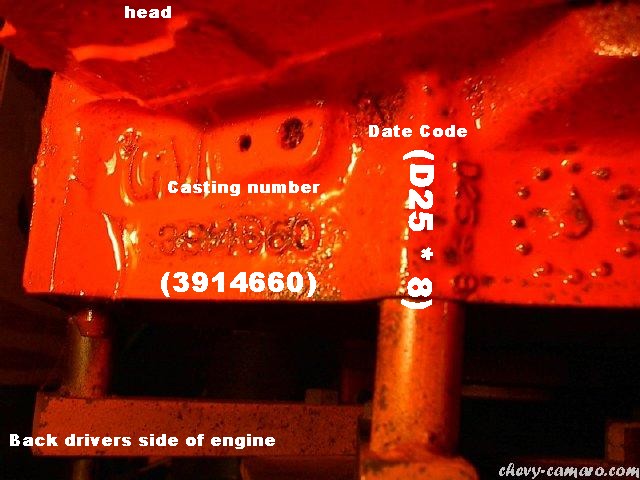

    What motors did Chevy put in 1978 Impala. Were there any problems with any certain motors. I'm thinking about buying one that was taken out of a running 1978 Impala. I'm told its a 350. How do I go about finding the #'s to identify it as a 350?

    look on the left side of the block, behind the head and between the trans. Should be a set of #'s running parallel to the trans case, then look them up here:

    There are numbers stamped into front the block on the passenger side on the head surface, you may have to scrape the grease and gunk off to see them they will be very small, the numbers are coded to indicate horsepower exact year of production and vehicle it came out of. the casting numbers on the rear of the block are a basic indication of what it is.

  5. some years had the 5.0 305 or 5.7 350 stamped on the rear deck drivers side head with other number like 397001 something like that they are big enough to see them

    On the driver's side of the engine block , at the back of the engine , you'll see a set of numbers...the following number are the ones you'll problably see:361979= '76-79 305 cu.in.----366245='78-'82 350 cu. in.----330817='70-'80 400[​IMG]cu.in.

    in addition there are these numbers you may see on the back of a '78 Impala engine: #460703='78 350 cu.in. , #460776='76-'78 305 cu. in. , #460777='76-'78 305 cu. in. , #460778='76-'78 305 cu. in. , #471511= '79-'82 267 cu. in. , #3914678='68-'79 350 cu. in. , #3932388= '68-'79 350 cu. in. , #3951509= '70-'80 400 cu. in. , #3951511= '70-'80 400 cu. in. , #3956618= '68-'79 350 cu. in. , #3970010= '69-'79 350 cu. in , #3970014= '68-'79 350 cu. in........I hope this helps , I keep this little book with me everywhere I go , just in case I find one worth saving....

    Look at the damper, if it's the wide one it's likely a 305. But the letter code stamped on the block (under the alternator) will tell you for sure what it is. Also it's possible the engine was swapped some time in the past 33 years.

    ^^^^ I agree 267's are TRASH!! as for a running 78 350. its a small block chevy, i have use countless motors from this era, all they need is a gasket set and they will run great for another 15 years. No need to spend unessesary money. If the engine goes in a couple of years then replace it. The number on the back of the block is 3970010, which specifies 350. Since it is a late 70's car 350, it will be a two bolt main block as well.
