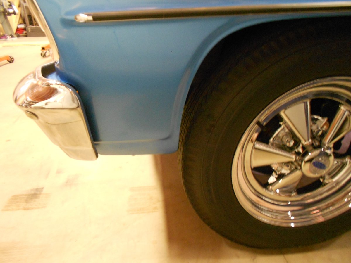

    Having a problem diagnosing an issue with a car that came into the shop for the front tires rubbing the front of the wheel wells.
    Background: The owner rebuilt the original front suspension with new bushings, ball joints, tie rods etc, using the original upper and lower control arms and upper control arm shafts.
    The car is also very solid and I can't see any visible signs of previous collision damage.
    The car does have a front disc brakes conversion that was done previous to the current owner and at this time, I have not been able to identify whose conversion kit it is. It is a smaller diameter rotor that appears to use the original spindle, and can use a 14" wheel. The front tire diameter close to the factory original diameter at about 25" .
    The owner claims that before he rebuilt the front end, the tires did not rub and were not that far forward in the wheel well as they are now. The suspension bushings, ball joints etc. were not wiped out but tired. It did have a slight pull to the right and off center steering wheel, but didn't steer terrible.
    So he then took it to a alignment shop an they were unable to align it back to specs, without the front tires going way farther ahead in the wheel wells, and then the tires hit the fenders. So the did the best they could, so he could drive it away. It now steers bad.
    So now it's in my shop to figure out what's wrong and make it right.
    The alignment that it came here with is roughly an 1/8 positive camber on both sides and 3/4 negative caster on both sides. The negative caster is making it steer bad. They did the negative caster to get the tires to clear the wheel wells. Since caster is set with the lower control arm strut rod, the tires are too far forward. The strut rods at this time are roughly adjusted in the middle of the threads.
    Desired caster is around 1 positive. If I were to put it there, I will probably run out of threads on the strut rod and the tire will go way under the front fender.
    I now this is getting long, but the more info is the better to help to figure out the problem.

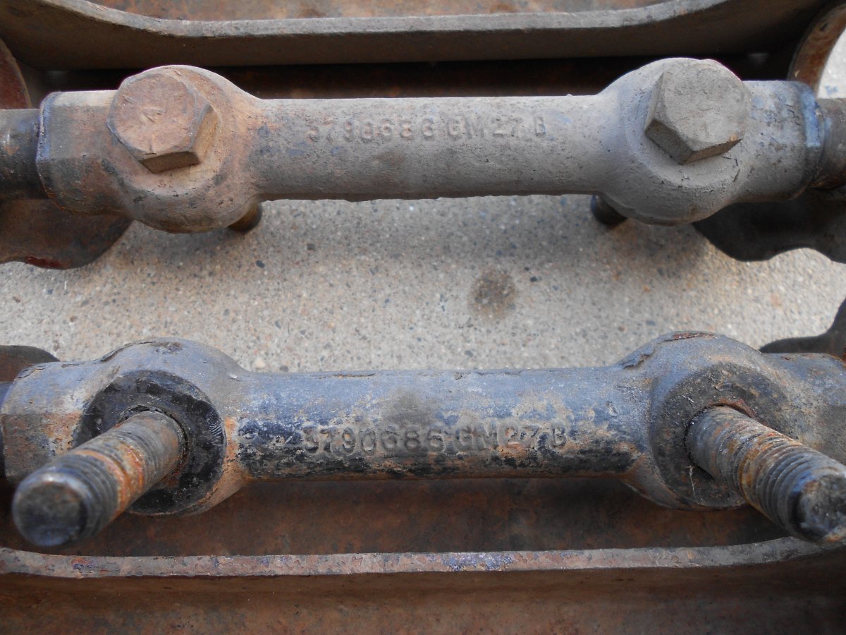

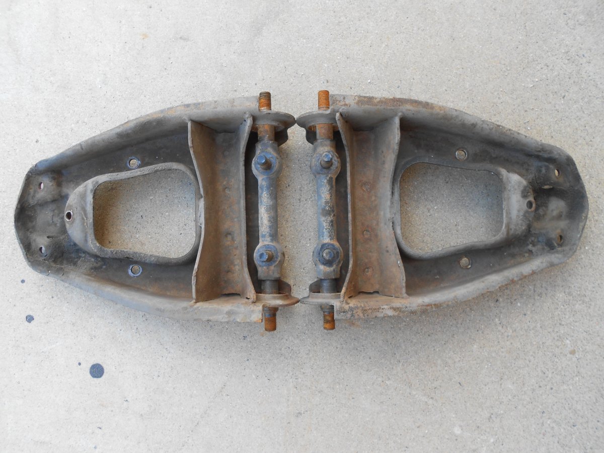

    Here's a matched pair that came off a big block drag car. bought the front clip for the like new Wilwood disc brakes. I removed the old bushings and ball joints but both identical and interchangeable.
    DSCN9913.JPG DSCN9921.JPG DSCN9924.JPG DSCN9915.JPG DSCN9918.JPG DSCN9920.JPG
    scrap metal 48 likes this.

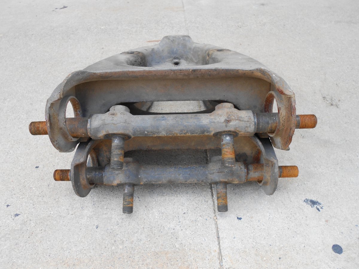

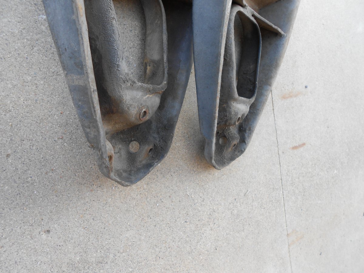

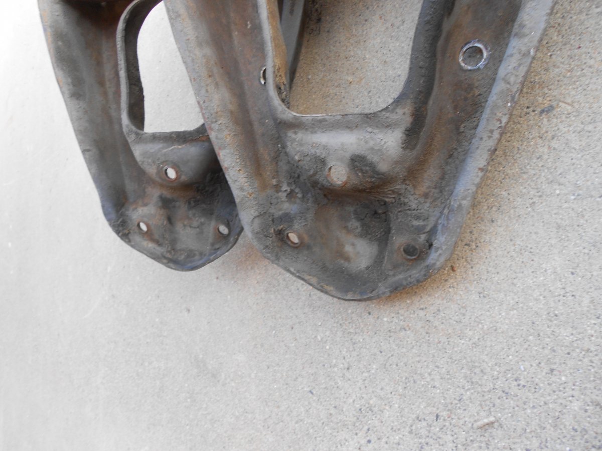

    My current car aligned to factory specs. Plenty of threads left on either side of strut rod bushing and about 1/2" between tire and fender (560 15 Firestone). Earlier cars have pretty much the same fitment to tire. My car has caster set the same on both sides but needs a bit more on the drivers side to correct for road crown and will probably be just almost touching after. Also, upper control arm sits at an angle and if the springs are excessively tall might be hard to get positive caster in it as the ball joint will be sitting more forward at ride height. Not cheap but Church Boys Racing has fabbed upper A arms that move the arm back 1/2" for more caster along with a Shelby type repositioning inboard (can't just redrill on a Chevy II) and taller ball joint to correct camber issues.

    Thanks for all the great photos. You have pretty much answered my question if the upper control arms are different. I say they are the same
