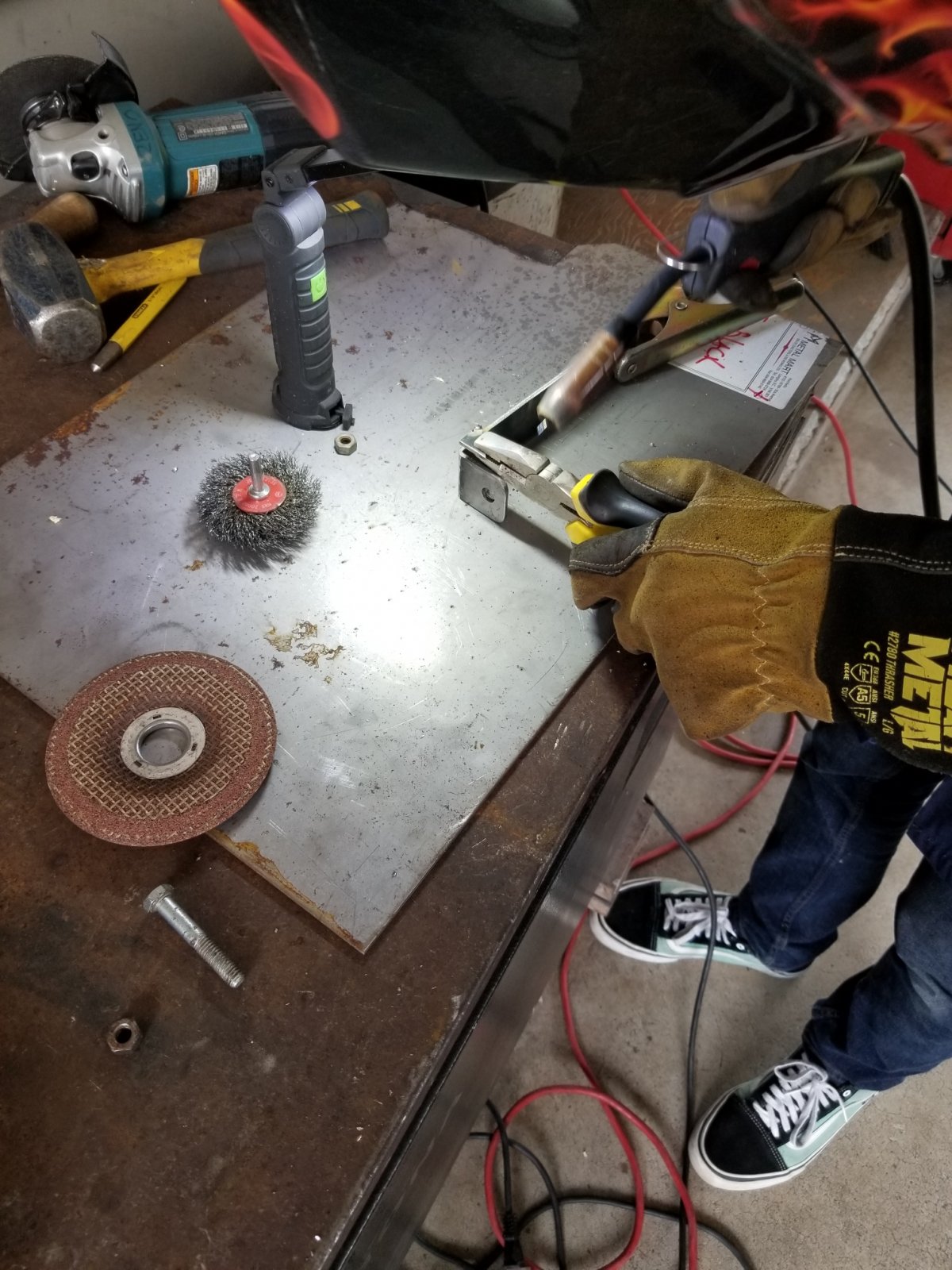

    One of the kids finished the welding on the tailgate while I drove around trying to find bolts. Couple of pin holes to touch up then clean it. Continuing the bolt up we have caged nuts that have snapped off. Make the hole bigger, weld a nut to a washer then tack that to the hole.

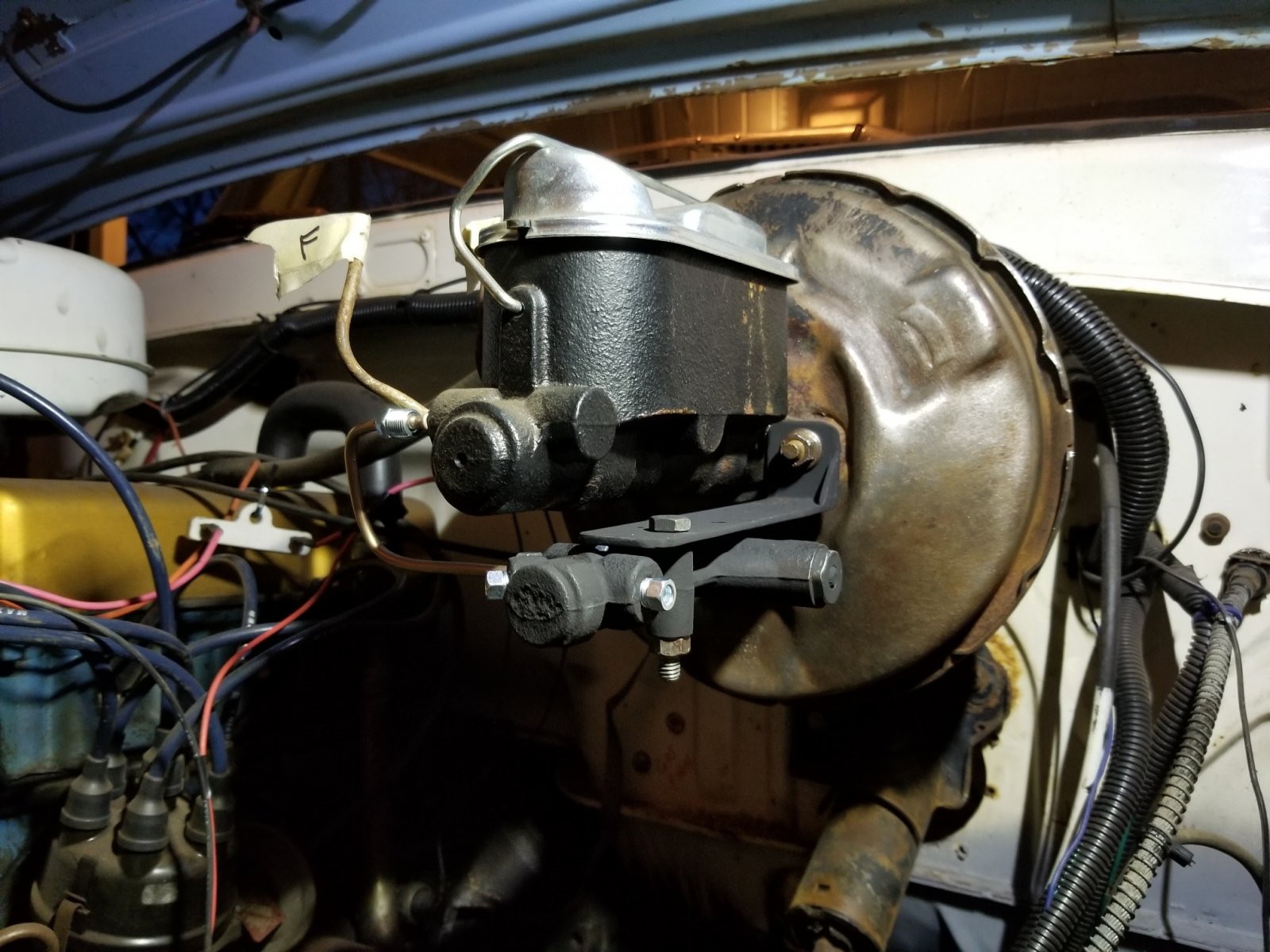

    My 17 yr. old hung with me the whole day while my wife and other guy were gone. I messed with the passenger door and he made a 12g bracket to hold the metering valve for the drum/disk brakes. You tend to underestimate the value of making simple brackets until you start showing someone. He just got accepted to go to school for Industrial Design when he graduates from High School so I spent more time explaining why it should be 1/4" radiused as opposed to square edge. Why you look at other brackets for style clues around the rest of the vehicle and why something might look like it does, eg. gusseted or not. Only got one bracket done but, it is one helluva bracket. Got him making a brake line too. Day of firsts.

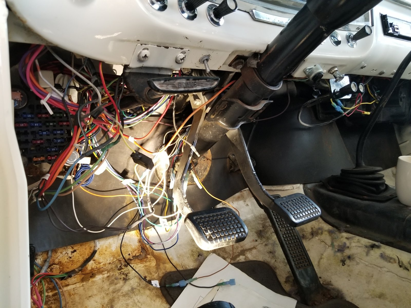

    Planned to finish brake lines today. Poked at the wiring coming through the firewall and... it's bad. Out she comes! Wasn't planning on a complete rewire but, after pulling all the plastic loom cover off I found 2 more bad connections and the grounds were either rusted or attached to rust. I guess if you don't do it complete you get what you deserve. Going to go 'no wire look' so pulling from the firewall down into the frame and will feed the engine from the front. Need to extend a bunch of wire just to make it all a bit harder than it needs to be. Gotta get rid of the road draft tube and switch to a PCV.

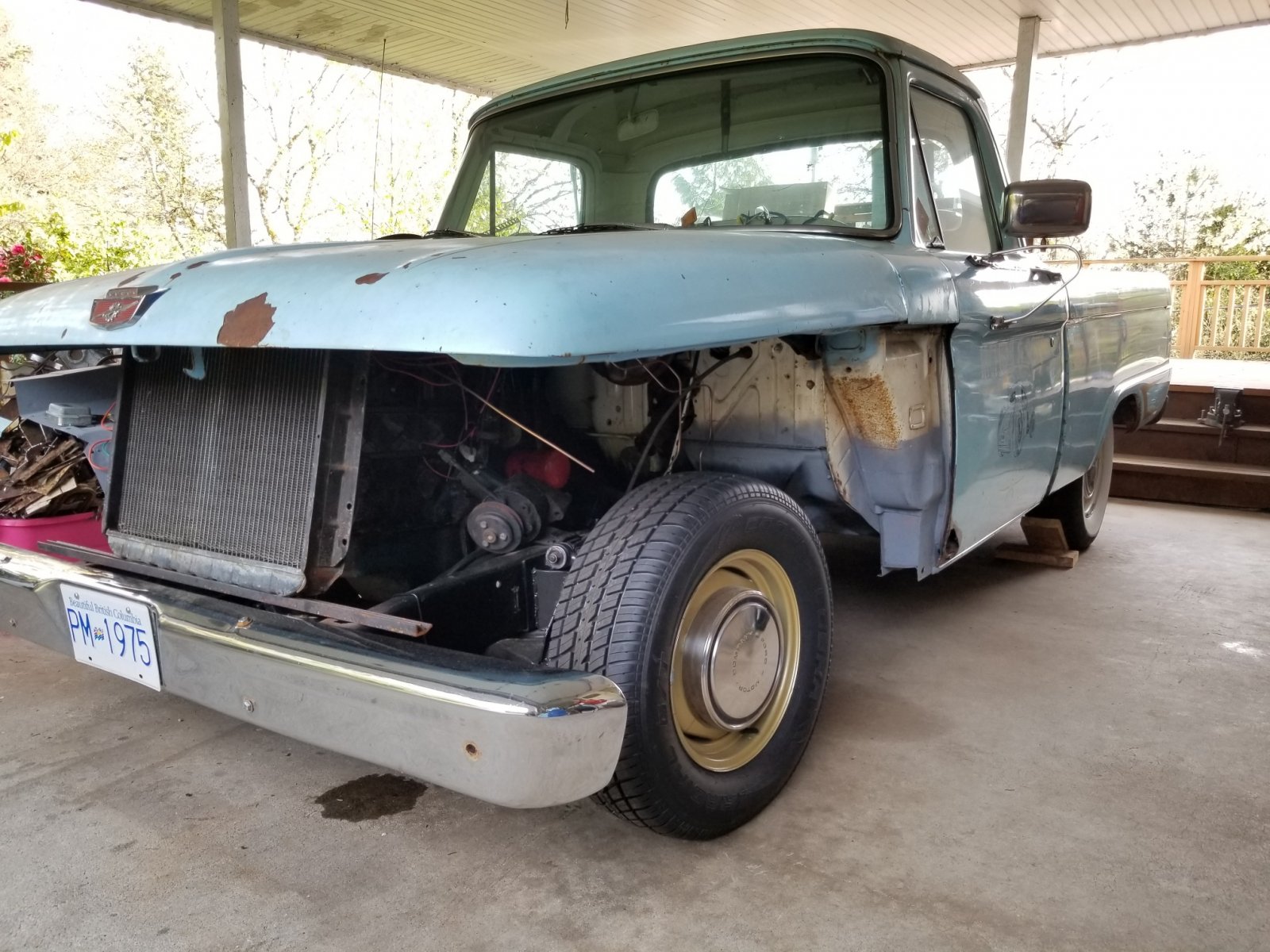

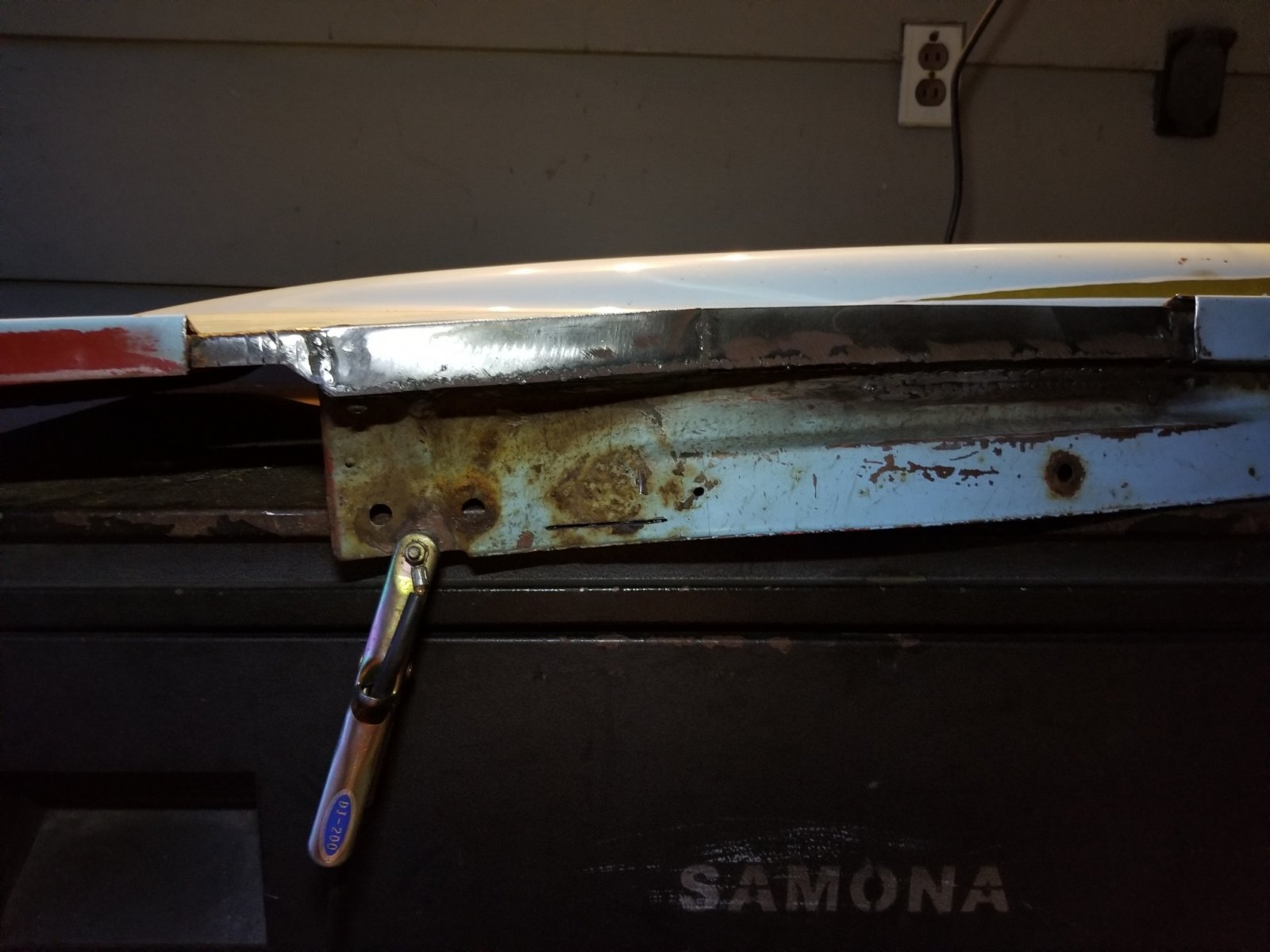

    What should I do while waiting for parts - how about some more rust repair. Going after driver's side fender. Inner structure first like everything else on the truck. I'll grind it all smooth dolly it straight then make the outer skin. It looks flat but, actually pretty curvy. Will have to make it in several pieces to get the curves to work.
    20220430_161921_resized.jpg 20220430_200834_resized.jpg 20220430_204540_resized.jpg

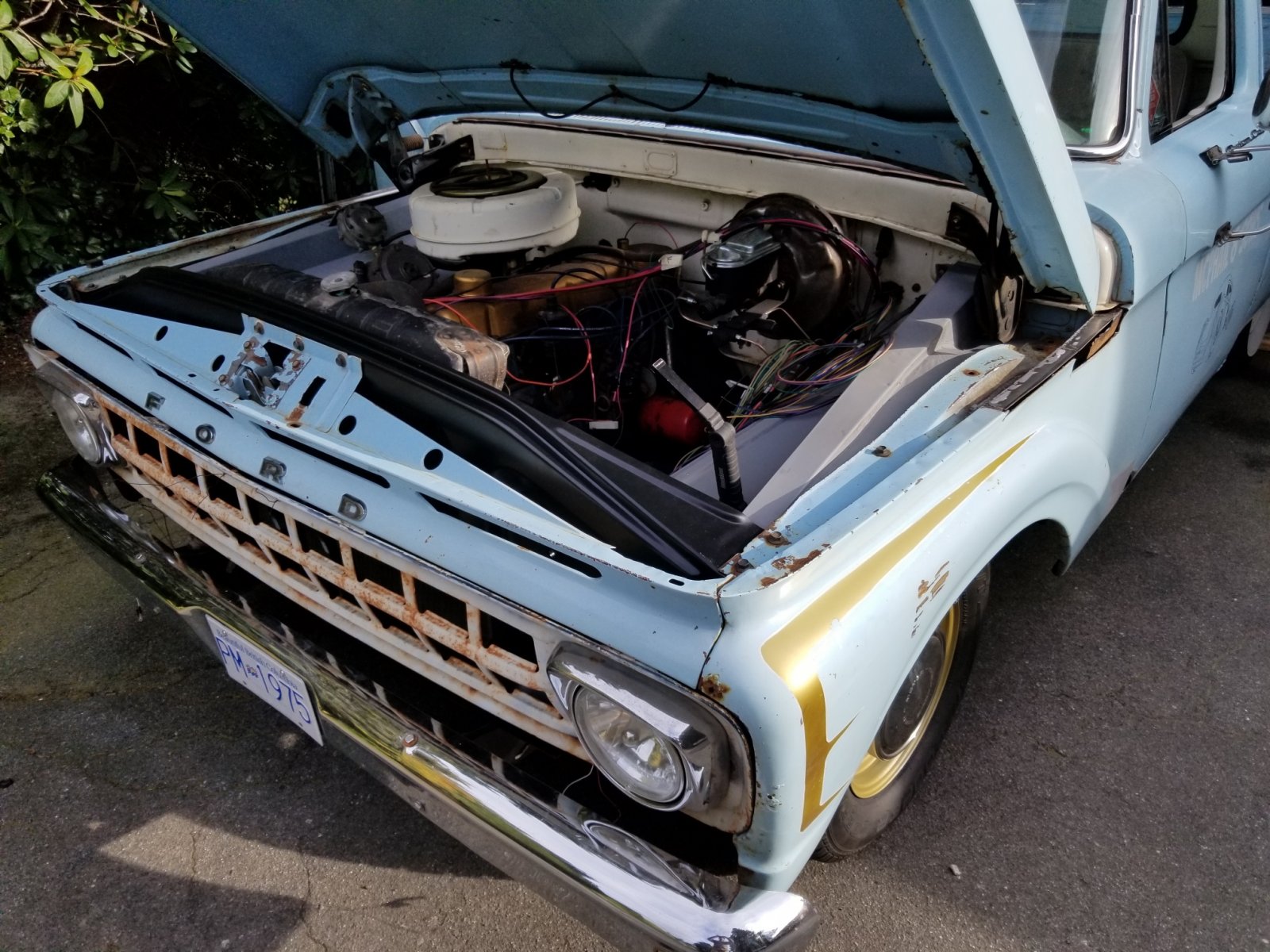

    A good day, all bolted together and grill is safety wired so we can drop it once wiring begins. The grill and fenders were held on with zap straps when I bought it. I'll spend more time shimming at final assembly including pulling off weather strip and strike plates to get the doors dialed. Haven't seen it together for a year. Now I can decide on wheels, gold with blackwall or white and whitewall.

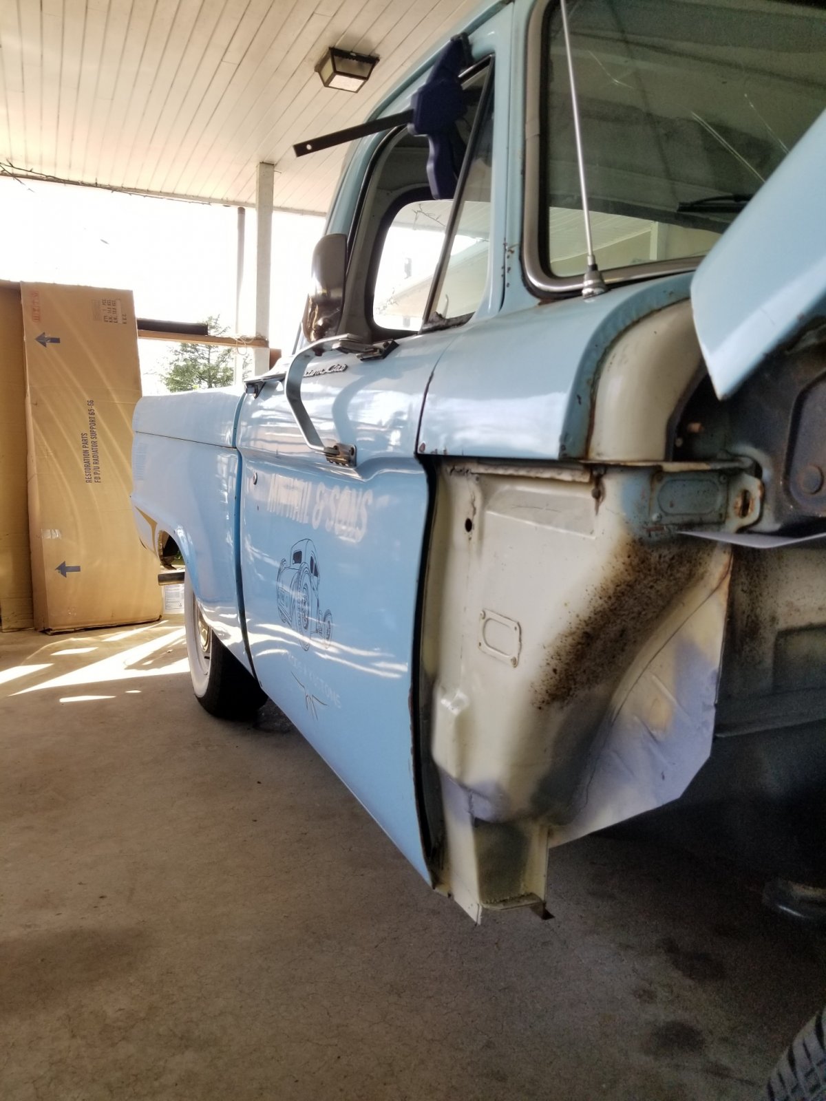

    Still waiting for parts, still fixing rust. Hit the bondo jackpot. A big bump of mud under there but felt smooth from the back??? Little bugger of a fender took a big hunk of the day. Inner structure is repaired nice and solid. Will make the top of the fender tomorrow then grind it all smooth after finish welding. I just gave it a nice cozy sponge bath yesterday then I blast bondo dust all over it today. Typical real world sequencing.
    20220514_154737_resized.jpg 20220514_193024_resized.jpg 20220514_201709_resized.jpg

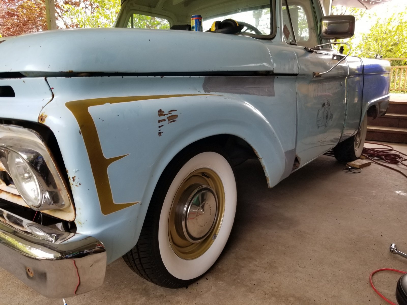

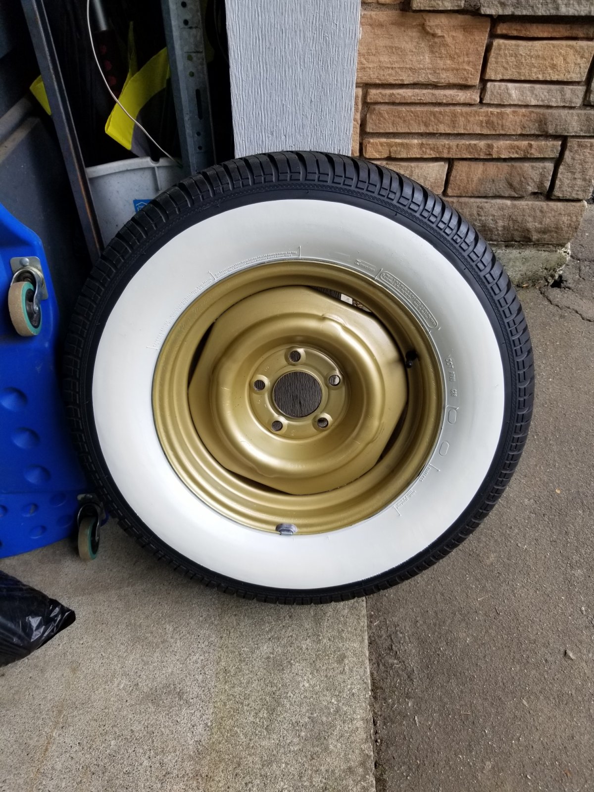

    Ran into a technical issue with calipers so had to do something about the whitewall situation for our front wheels. Went a bit ghetto and ground the letters off the sidewall of my brand new Cooper Cobras. Sprayed 3 coats of Plastidip then 3 coats of SEM white vinyl dye over that. How do I know that works - well, because that's what I did a year ago to the rears and they still look nice and white. No dis-colouring. Not proud but, happy! When prices come back under control I'll go for some nice whitewalls but, for now, as my teenagers say - It's got the drip!

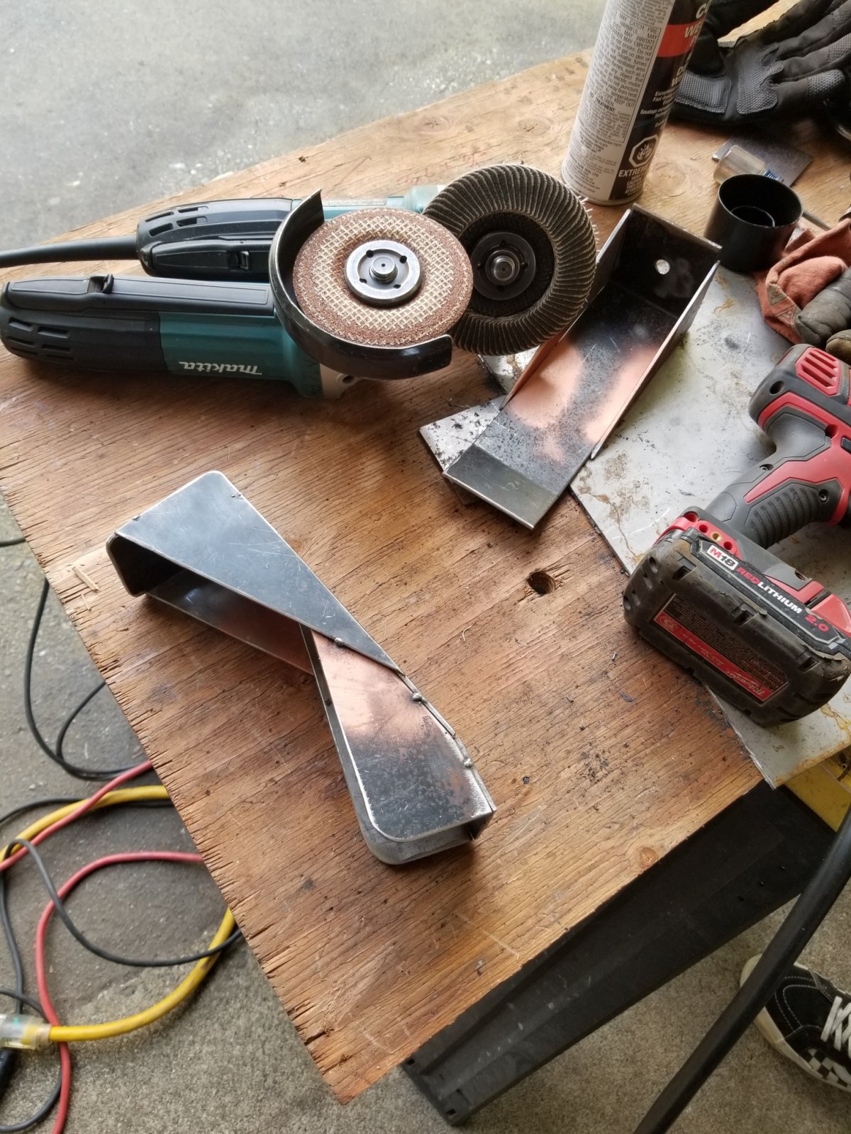

    Got my 15 year old all day making shock mounts. Cutting, fabbing and some welding. So much to learn at that age but, he did great. How is it you can point a camera at a kid and they can manage to disappear.
