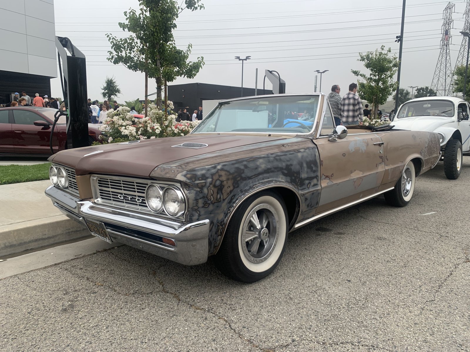

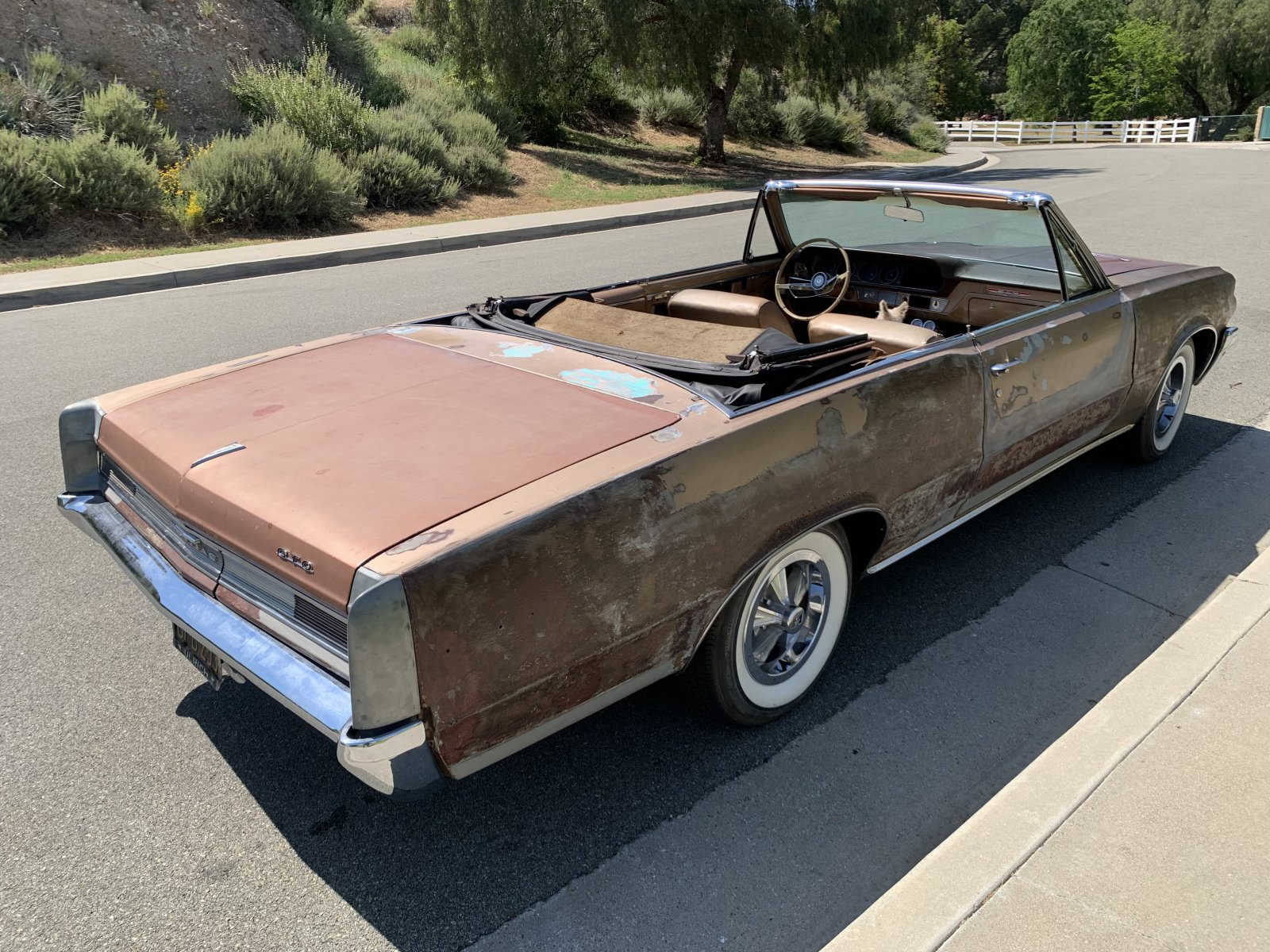

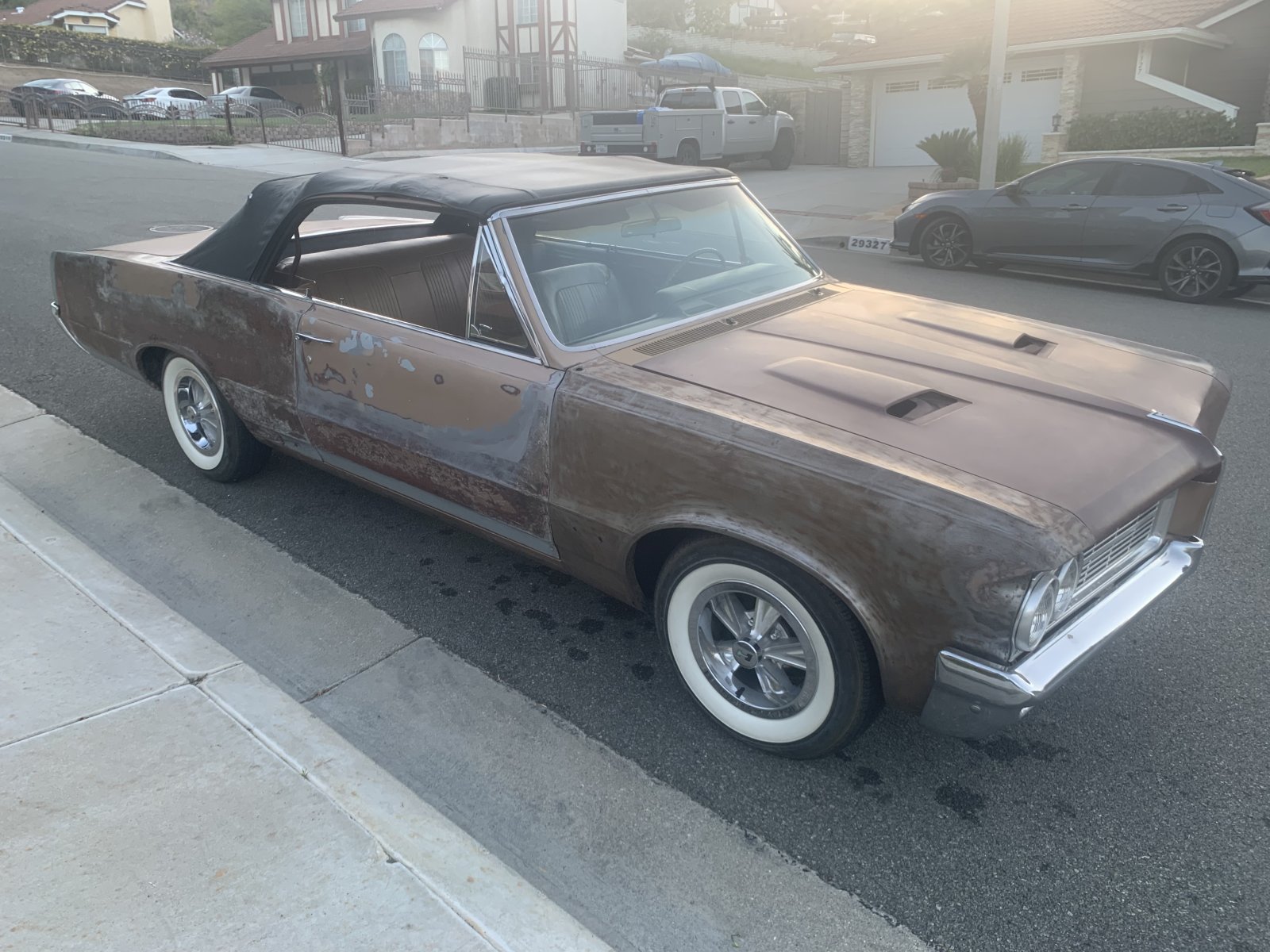

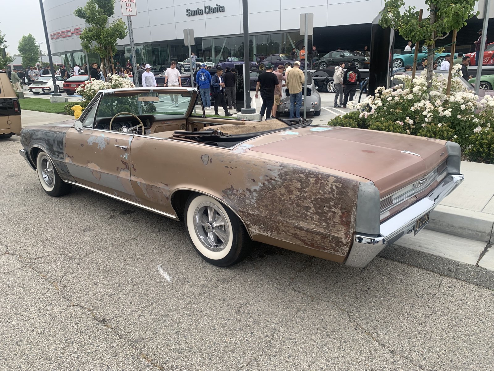

    The 421 has a home in this 1964 Le Mans convertible, it was originally ordered with some nice luxury options like power windows, air conditioning and power steering. It has a TH350 replacing the original 2-speed ST-300 and has a 2.56 rear end so I can keep up with traffic on the freeway if I need to.
    It’s still a work in progress but I’m glad to be driving it now, a new interior will be in the works soon as well as a new top.

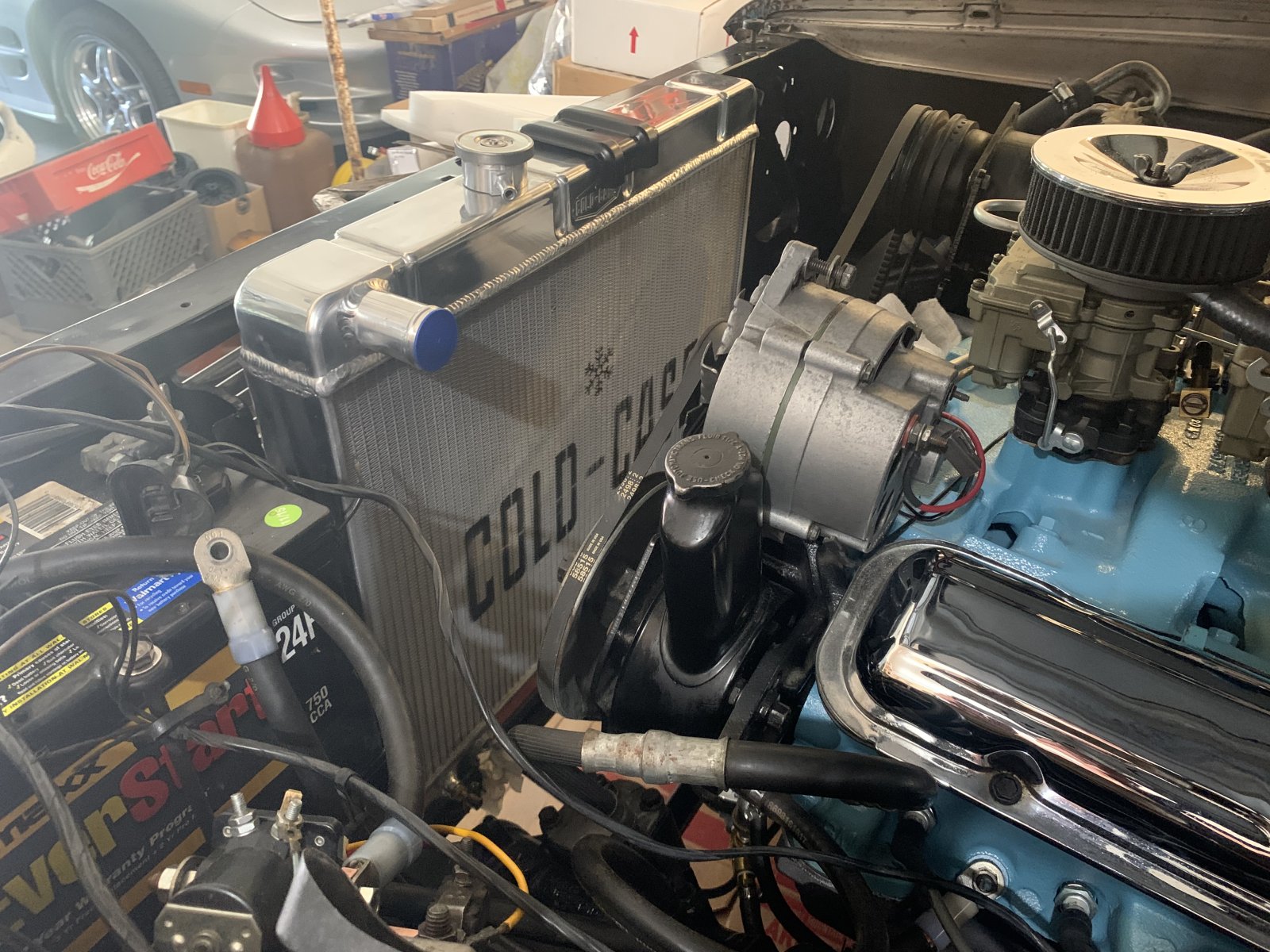

    What brand of radiator are you running and would you recommend it?
    I had my original 2 row recored 30 years ago, but I'm wanting to go with a new radiator this time.
  11. draggin'GTO
    Joined: Jul 7, 2003
    Posts: 1,795
    draggin'GTO

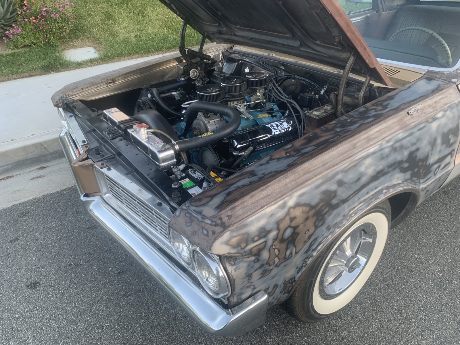

    I’m using a Cold Case Severe Duty aluminum radiator which was recommended by the owner for my air conditioned application.
    This Le Mans has the heavy duty/air conditioning cooling system which comes with the deeper core support that accepts the 17-1/2” radiator core as opposed to the standard 15-1/2” radiator.
    In order to use this particular radiator I had to switch from the 1964 thermostat housing which goes to the passenger side of the top tank inlet normally like all ‘64 and ‘65 cars to the 1966 thermostat housing to use the ‘66 - ‘67 drivers side inlet. I modified the original steel fan shroud and moved the upper hose notch to the driver’s side.
    The Severe Duty radiator only comes in the later configuration and has two 1-1/4” tubes as opposed to the standard two 1” tubes. These early A-body GM cars with the less efficient down flow radiators that have limited frontal core area need all the help they can get especially with larger engines like the 421.
    I have a 160 degree thermostat and the car usually stays between 170 and about 188, once I install the condenser and the air conditioning becomes functional we’ll see how it fares. I will install all the sheet metal and masticated rubber A/C baffles at the same time to insure as much air flows through the radiator as possible.
    Also using a 19-1/2” factory clutch fan and a Hayden Severe Duty fan clutch which made a big difference in overall temperature control. My radiator has a trans cooler like all that are for automatic transmission applications. I have a pretty efficient 13” Continental converter that couples well under normal driving so it’s not necessary to add an additional transmission cooler. That converter does help by letting the engine get up in the RPMs a bit when I’m opening all 3 carbs.
