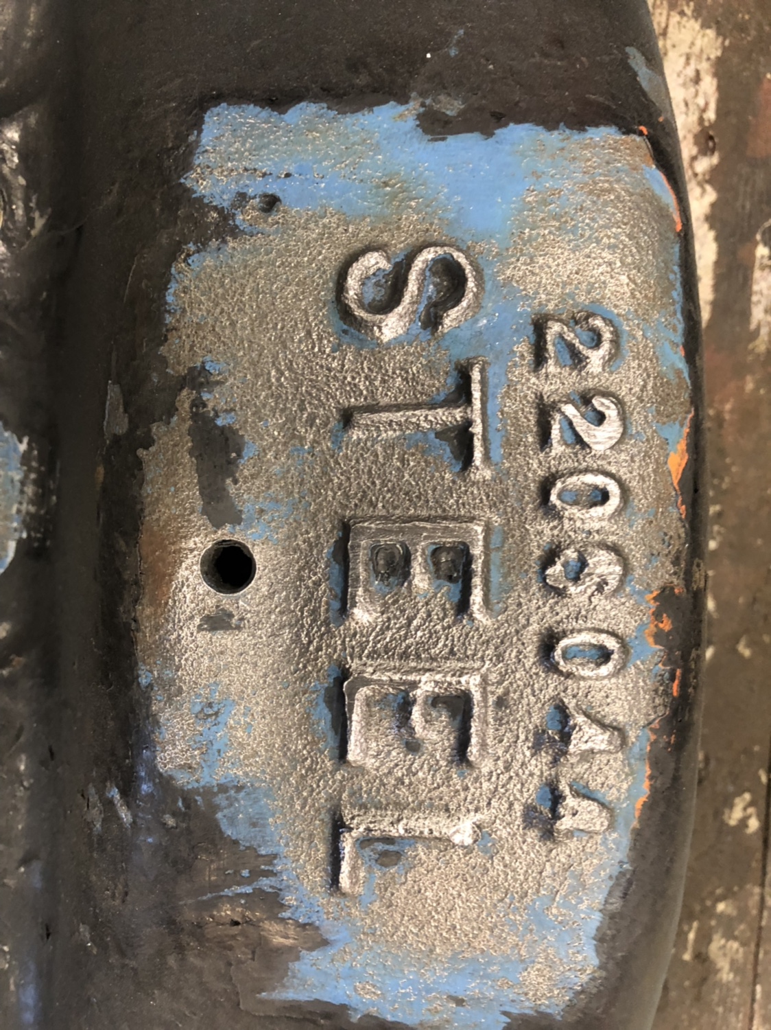

    I can only tell you that cast steel bellhousings were indeed considered safety housings at that time. Ansen and Wedge made them for the aftermarket and I was required to have one at Lions Dragstrip in 64 behind my SBC in a 62 Chevy II.
    loudbang and II FUNNY like this.
  5. The fact it says "STEEL" means you stole it. Really that bellhousing and lower steel plate is the real deal. Most were the cast bellhousing - we have a few between friends. Can look at the trans later...but there should be a pad down near where you would put the bottom bolt into the bellhousing on the passenger side bolt into the bell housing....on latter years it's where they look for the vin # stamp.....let us know. You could go over to the B Bodies only site and join to put your info in the 63/64 Max Wedge section....you'll get responses there.
  6. great buy. I would sell the trans to a restorer and get one with a slip yoke. the one you have cant handle as much power. there is a reason it didn't last very long.

    If I am right. That should be a '64 only trans. '65 should have a slip yoke. Also the 426 hemi came in 1/2 year '64. You may have something to sell and fund more of your project. I would contact Jim Kramer @ Kramer Automotive in Pa. to find out.

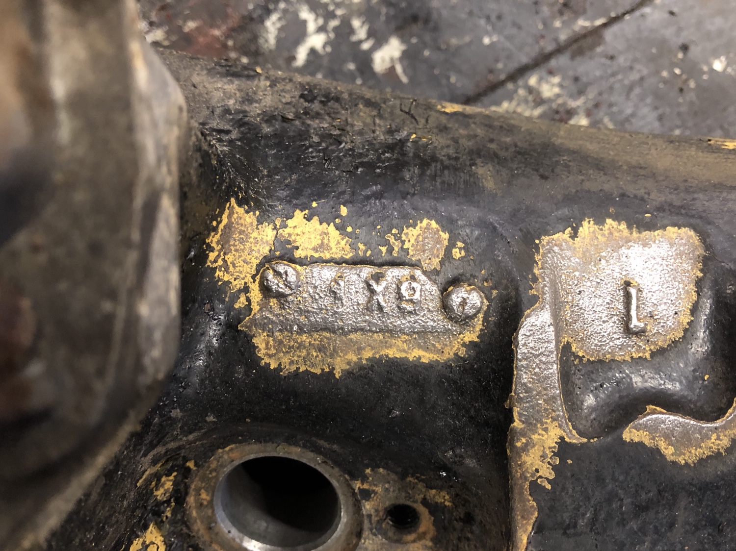

    Thanks for the info. It doesn’t have a pad like this one in the picture...

    I sent something to MOPARS by Mosher, but didn’t get any response...

    The bellhousing is for a 1964-65 B body Hemi.
    The transmission number for a 1964-65 B body is 246 4641

    The trans is just an early 23 spline A833, it isn’t from the same car. I originally was going to put a manual in it when it was going to be Chevy powered, but didn’t have any MOPAR stick stuff...when I stumbled on this I planned on running it, but the bellhousing is probably gonna need a new home.

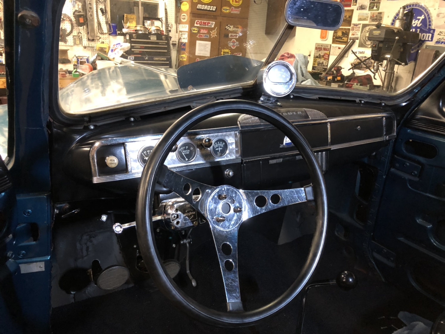

    Slow!!!

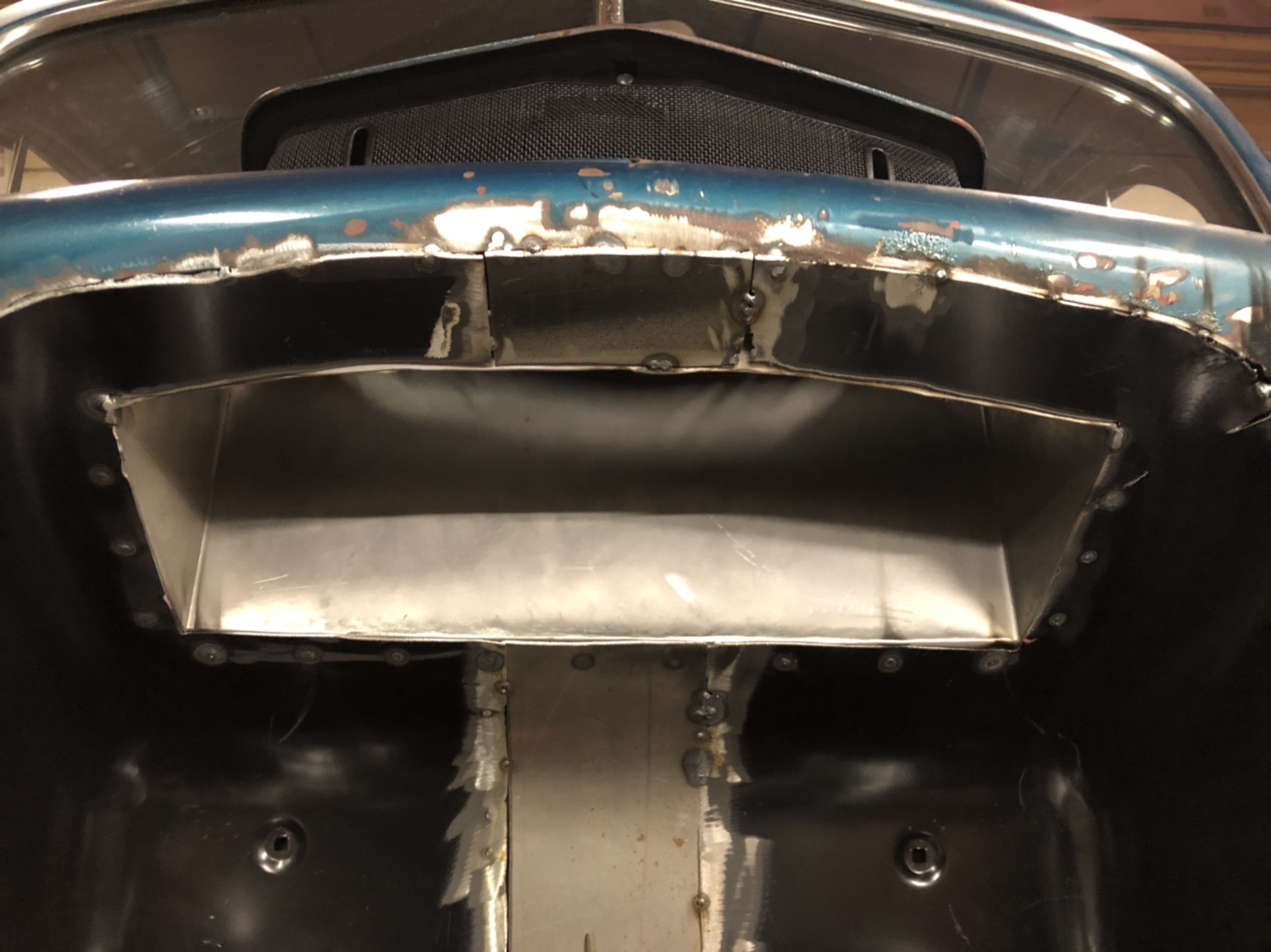

    I decided to make the cowl vent functional for the engine, since the engine was back into the firewall anyway...
