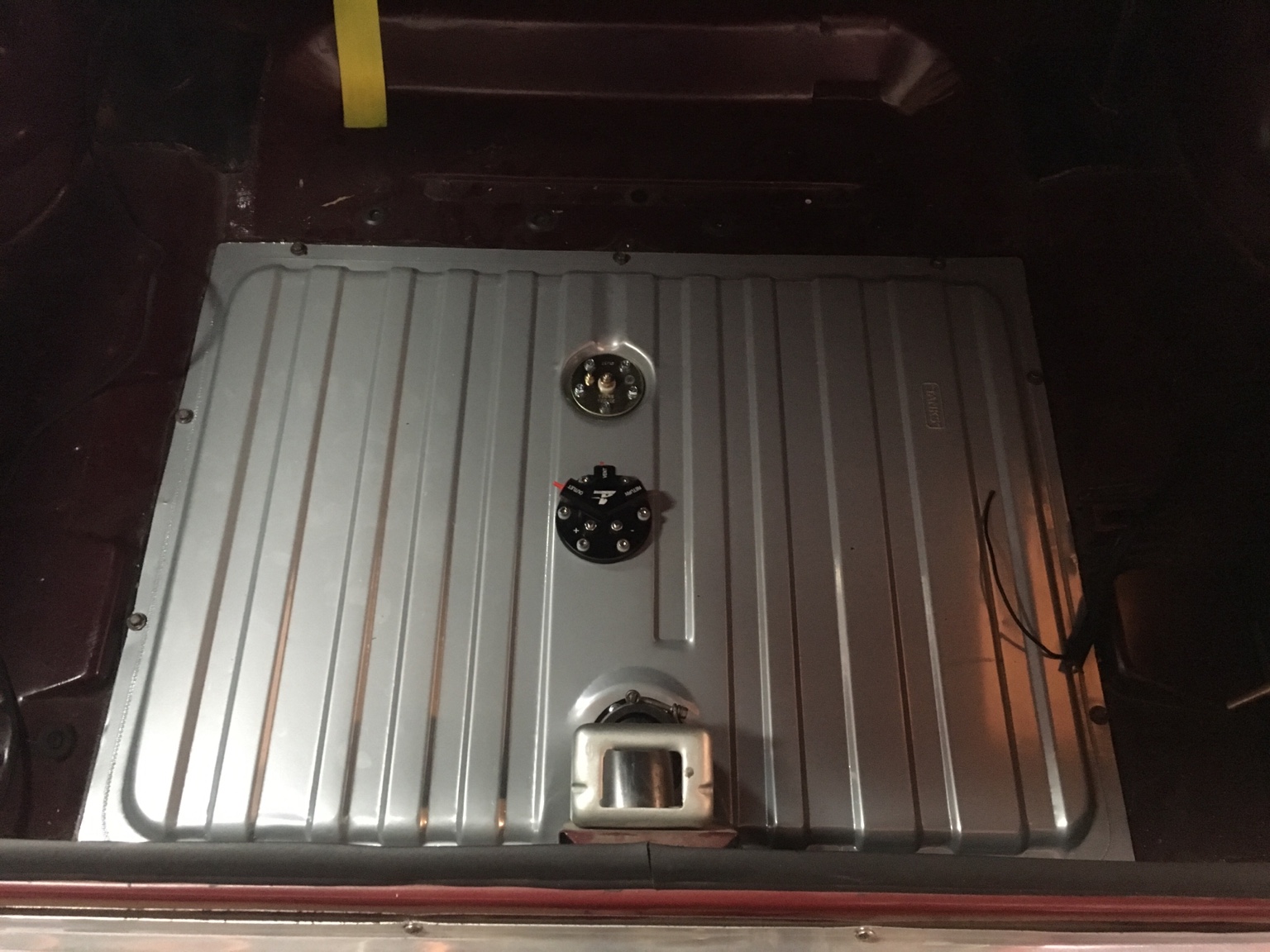

  11. Aeromotive fuel tank with in tank pump and top side sending unit. Got it all fitted to the factory fuel filler

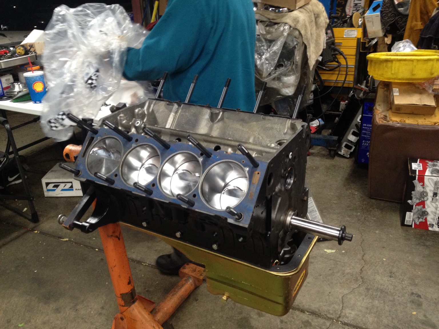

  15. A little progress on the motor, once I get it back I can get the brakes done. I think I need to relocate the master cylinder, but won't know for sure until the motor is in [​IMG][​IMG][​IMG][​IMG]

    Hell of a shot those intake ports look HUGE

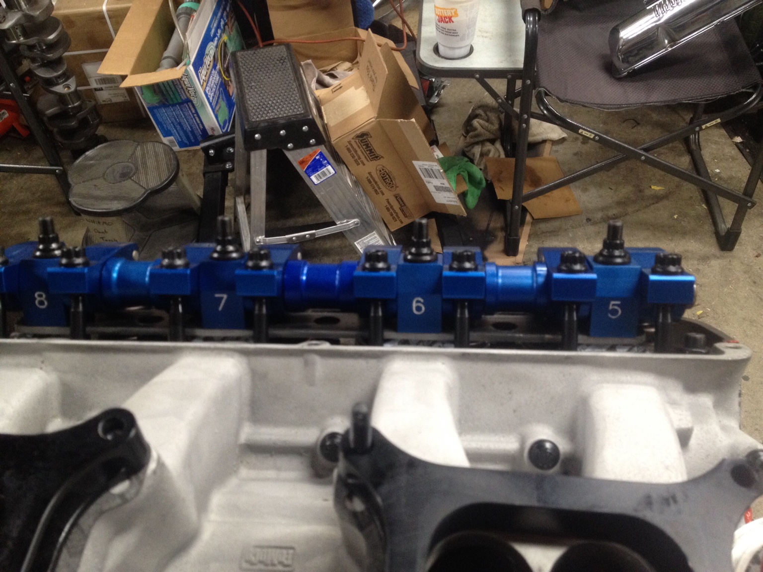

  18. Getting closer!
    [​IMG][​IMG]

    NICE Rocker setup. Now no excuses if you forget which side is which. :)

    Curious as why you are not using the rocker shaft end stands.
    Maybe not enough valve spring to need them?
    fiveoh108 and loudbang like this.

  23. With the roller cam, there is only 150 on the seat and 325 open so my engine builder didn't think they were necessary.. Nice catch though!
