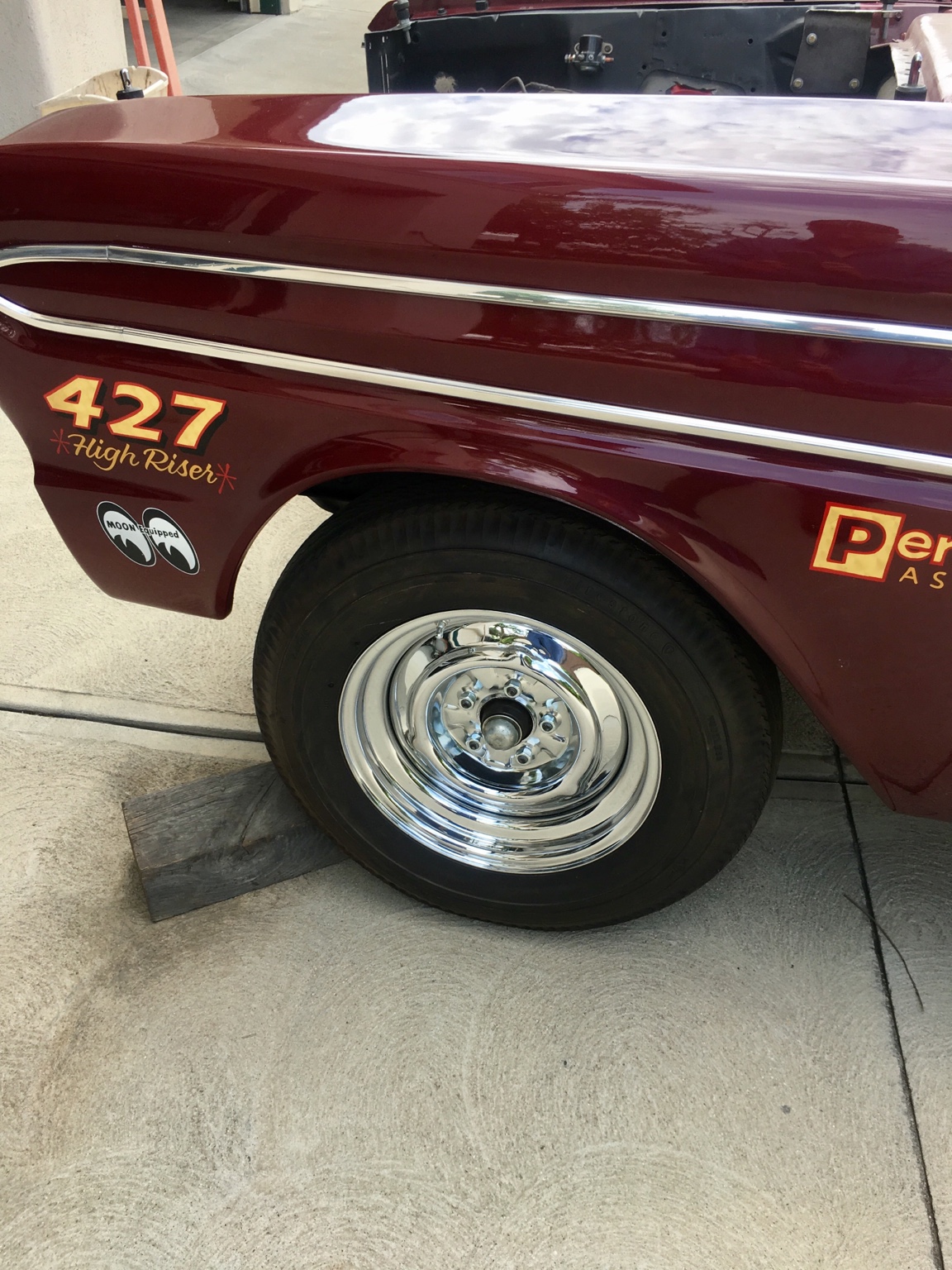

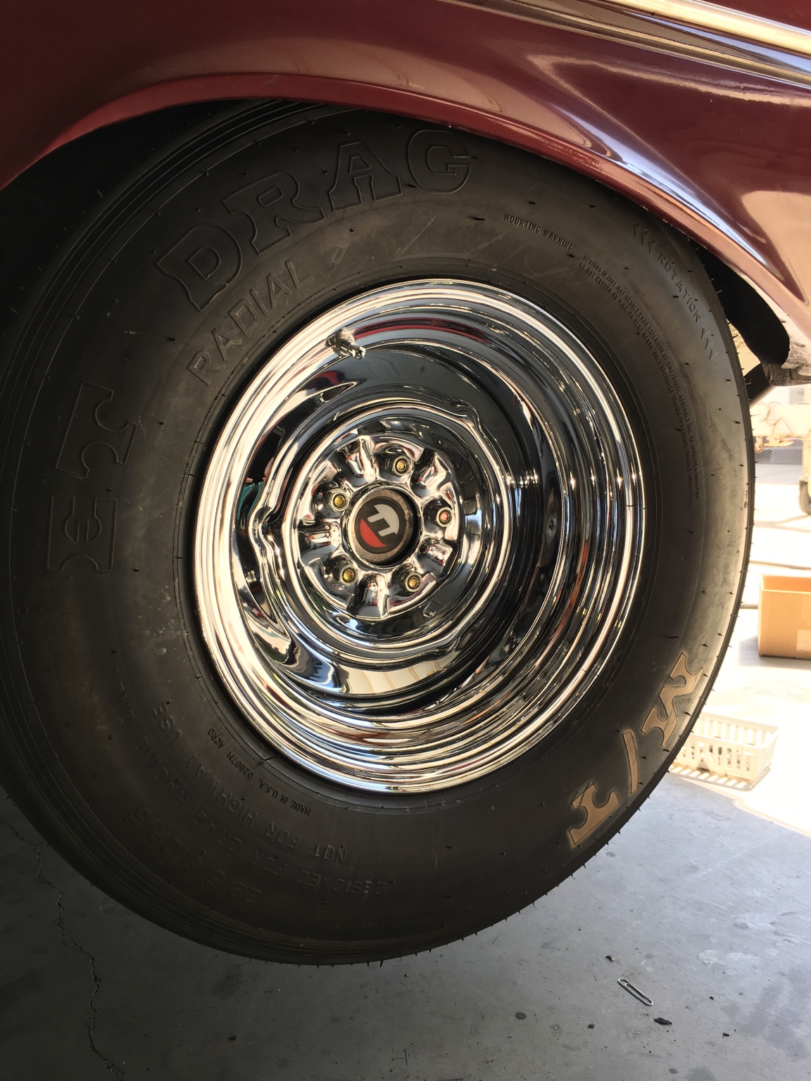

    Dale found that my axle center hub was for an F100 truck, which is why I was having so many problems locating a brake drum with the small bolt pattern and the larger hub. He had it machined down to the smaller diameter and got shorter studs. I didn't need the 3" long studs.

    Mike,are those 5/8"
    Studs?If so,where did you get those lug nuts,and how did you deal with drilling the wheels for the oversize studs?I've been wanting to put 5/8" studs on mine,but I've been worried about losing part of that raised stamped shoulder around the stud hole after drilling.

    Those are just the 1/2" studs, grade 8 and hardened. I have seen lots of fast cars with 1/2" studs. I am leaving off a foot brake now too so it won't be such a shock to the drive train.

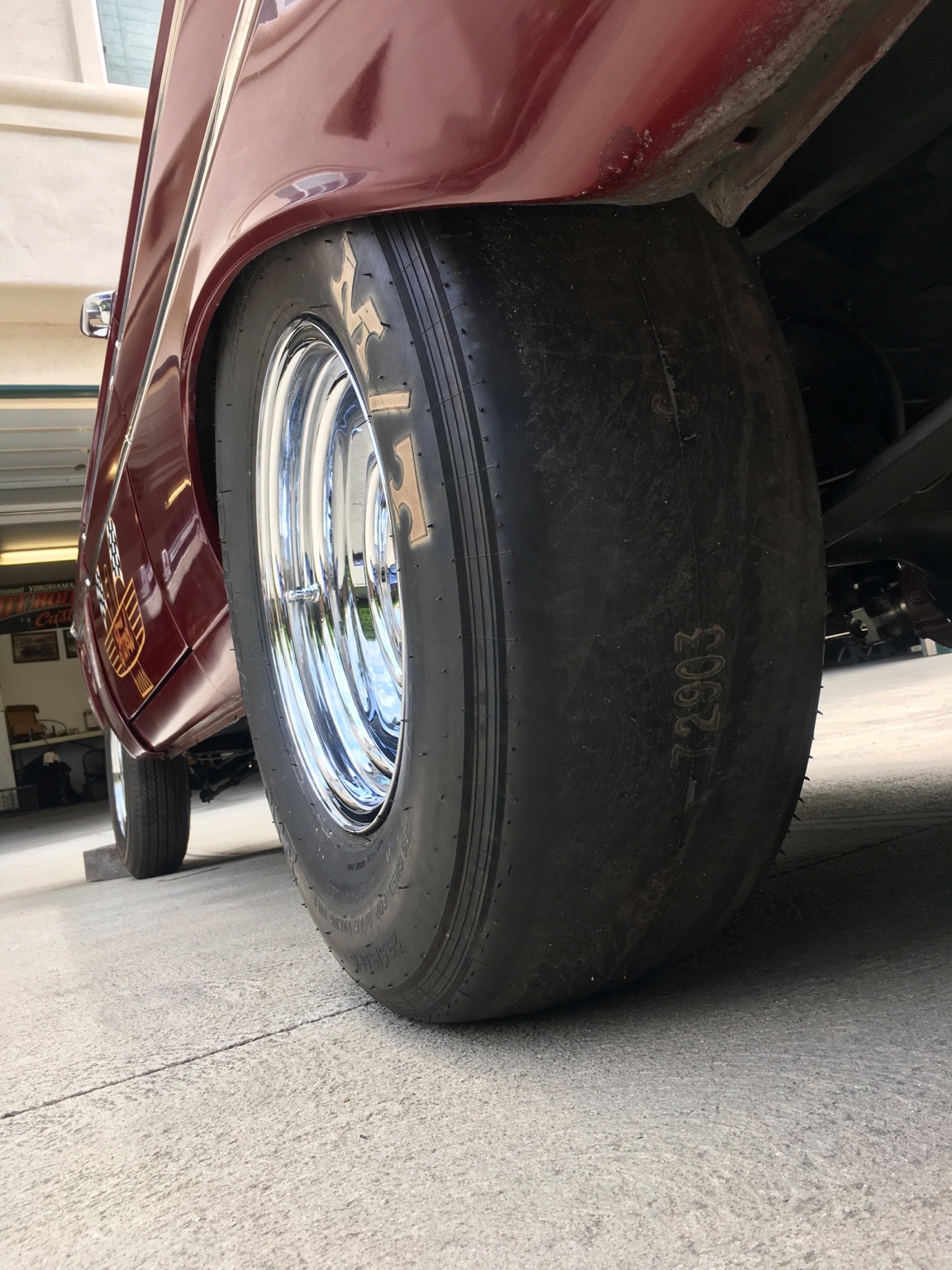

    New windshield and new axles in in [​IMG]
    [​IMG][​IMG]
  11. loudbang
    Posts: 12,020
    That last photo are the lugs tight? If they are I don't think you have enough threads showing to be legal.
  12. fiveoh108
    Joined: Jun 15, 2010
    Posts: 890
    fiveoh108
    You have to have the threads come into the nut at least the the same distance as the diameter of the stud per NHRA. There is no need to have a long wheel stud as long as you keep it properly torqued, then all should be well
  13. RmK57
    Joined: Dec 31, 2008
    Posts: 578
    RmK57
    The way I understood is they have extend past the wheel nut by at least the thickness of the stud. Yours look to be flush with the nut.
  14. fiveoh108
    Posts: 890
    fiveoh108
    From the NHRA rule book. The thread engagement must be at least at deep as the stud is wide. I have 1/2 studs, the lug nut is 3/4-1" thick, so flush is within the rule. Whether I had a flush mount stud or one that stuck 4" past the lug, the most important thing is proper torquing of the lug nuts that provide the clamping force that keep the wheel from moving on the hub. Even with 5/8" studs, if you don't properly torque them, they will bend or sheer a stud off. I am particular about this and check after every round, after having my studs bent after a race from lack of torquing them and from a friend loosing a quarter panel after not checking them.
  15. seb fontana
    Joined: Sep 1, 2005
    Posts: 5,287
    seb fontana
    from ct
    I read [in the rule book somewhere in the 5.2 area] last year that the thread has to go into the lug nut to the end of the hex and in the pic it showed a closed end lug nut [go figure]..I had questioned why everyone left the studs so long; basic reply was too lazy to cut them back..So as long as the stud reaches the end of the hex or in this case uses all of the threads of the nut [which is more than dia of stud] they should be fine..
    loudbang and fiveoh108 like this.

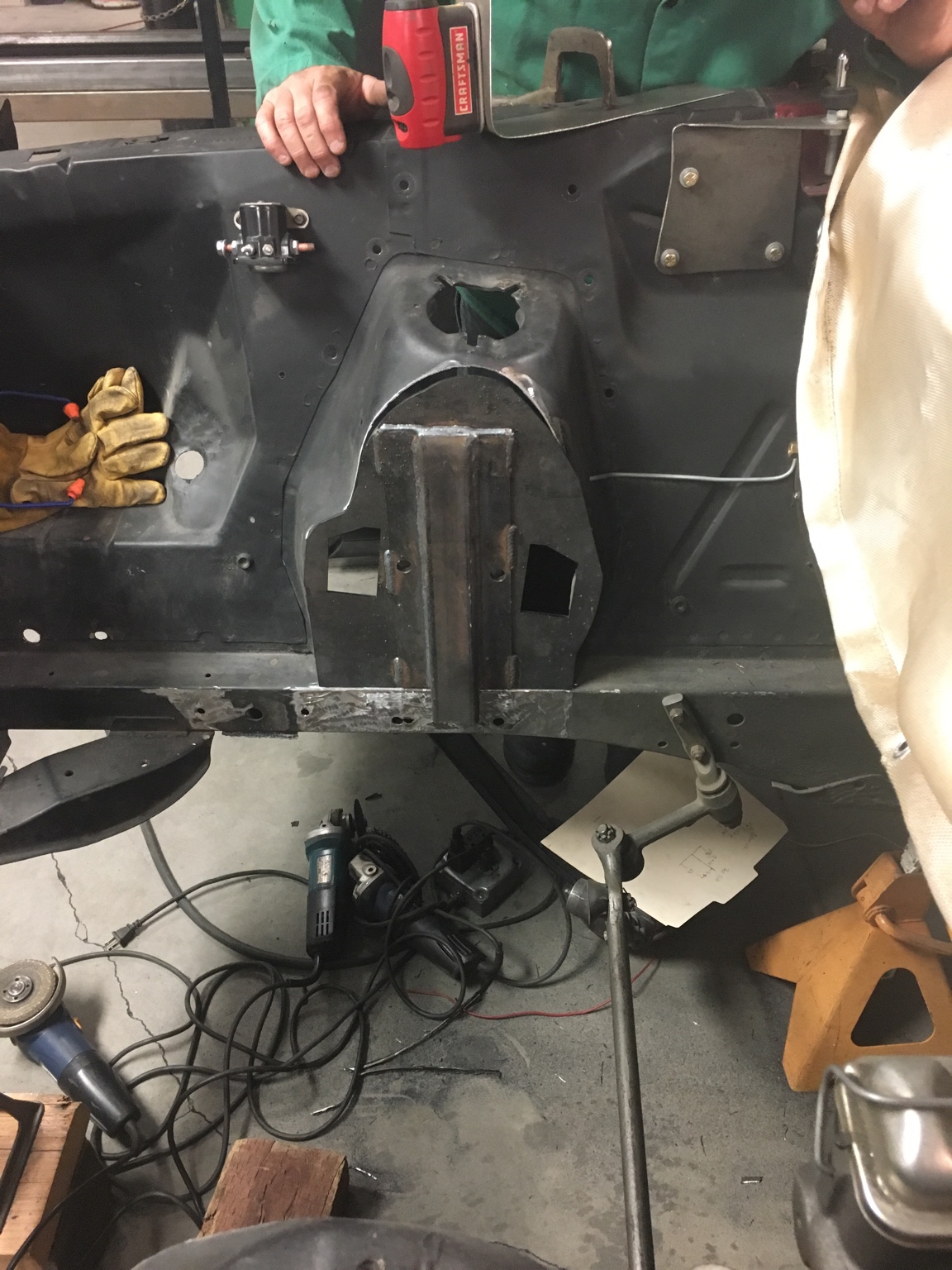

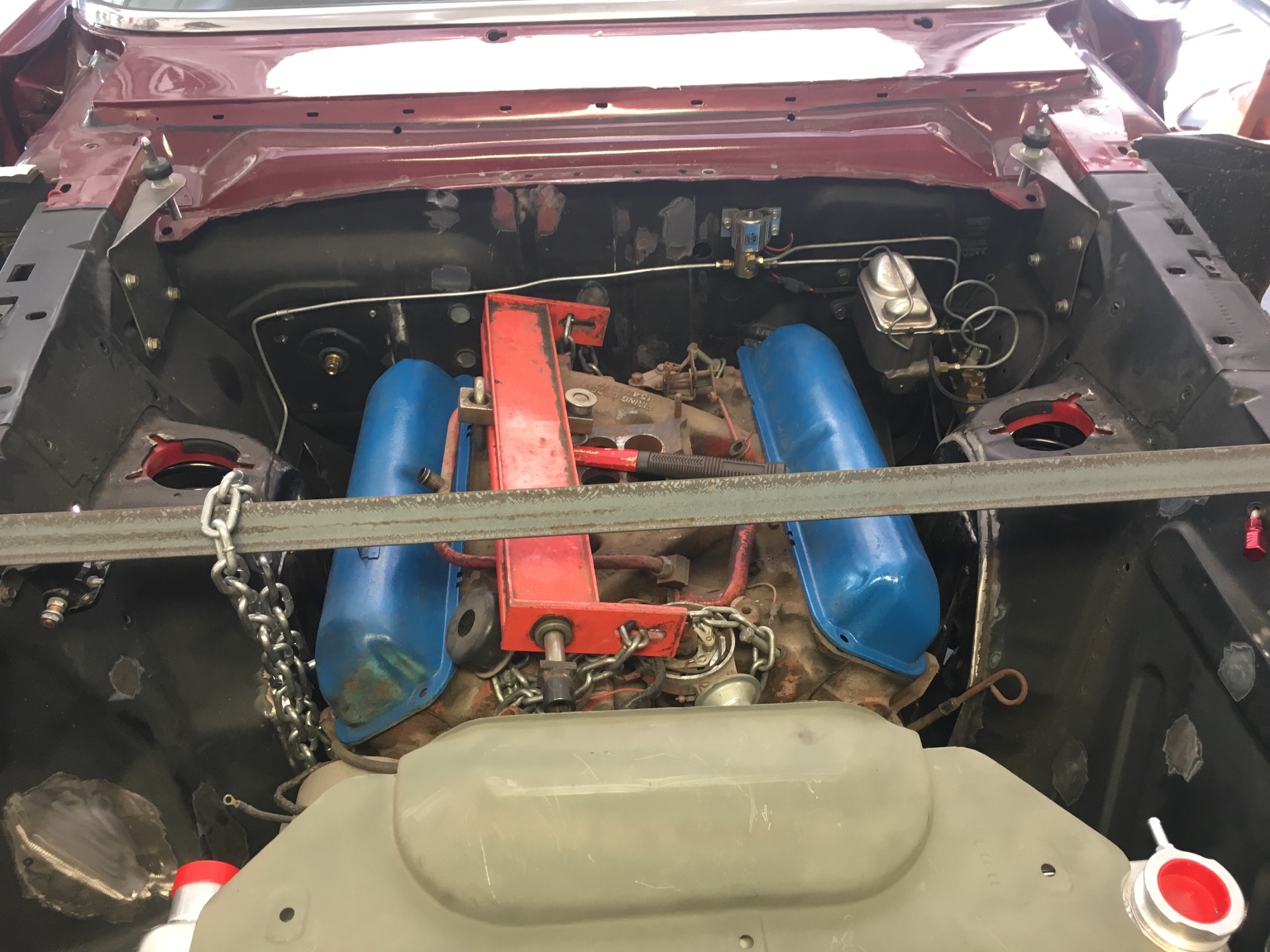

  17. fiveoh108
    Posts: 890
    fiveoh108
    It uses the factory ones and moves them out about 1.5" per side, the kit also comes with longer adjusting sleeves for the tie rod ends and new mounts inside the frame rails for the strut rods because they move back about 3/4". I got aftermarket motormounts from a guy on eBay that provide for more header clearance.[​IMG][​IMG][​IMG]

    Some more progress, fitting that big radiator in.. and the removable core support [​IMG][​IMG][​IMG][​IMG]
  23. powrshftr
    Joined: Mar 29, 2013
    Posts: 4,447
    powrshftr
    Removable core support will be a lot nicer for engine removal/install with the Trans attached.
    That's a smart move right there.:)
    loudbang and Gammz like this.
