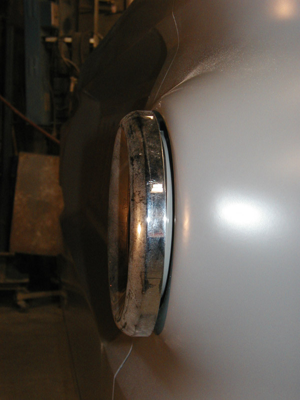

    Front of the truck with the headlight bezels, emblems, and[/center]
    grille removed. There was a bit of surface rust and that had to be dealt with
    first.

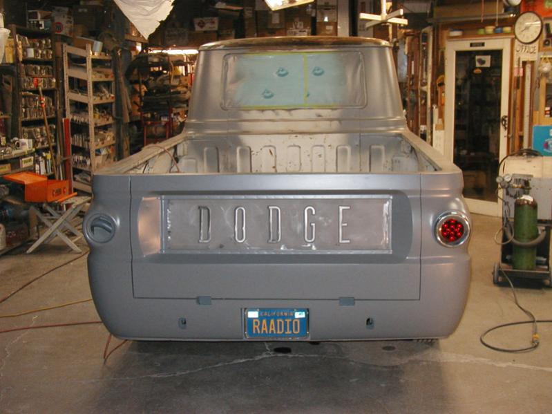

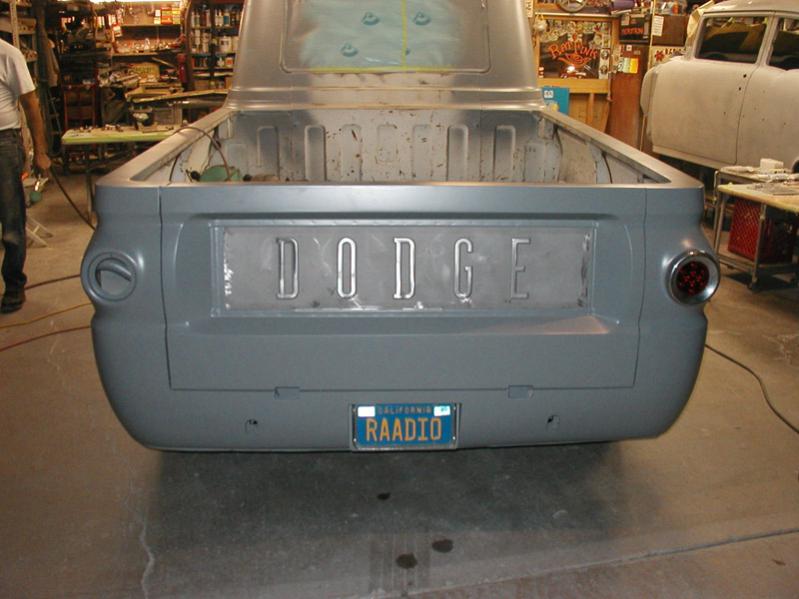

    [left]The tailgate was hammered. Some of the edges were ground down[/left]
    and it was split in several places. After sand blasting, we were able to get
    down to welding up all the cracks and other problems.
    [center][IMG]http://www.jalopyjournal.com/forum/truck10.jpg[/IMG]
    [IMG]http://www.jalopyjournal.com/forum/truck11.jpg[/IMG]
    [IMG]http://www.jalopyjournal.com/forum/truck12.jpg[/IMG]
    The ass end of the truck is just about buttoned up at this[/center]
    point as you can see by the pics below:
    [center][IMG]http://www.jalopyjournal.com/forum/truck14.jpg[/IMG][/center]
    [left]Very little filler was used as an amount that is too thick will[/left]
    eventually crack or break off. When Radio Bob got this truck the tailgate was
    3/4 of an inch higher than the bed and the seams were all over the place. As you
    can see now, he seams are a pretty snug fit.

    [left]These next batch of pictures show the rear end[/left]
    in it's final stages. You should scroll back up to some of the earlier pics to
    see how bad the rear end was before Radio Bob got his hands on it. Please note
    the tail gate latches, they are no longer. Radio Bob looked at the tail gate
    latches and said "I kept looking at it and looking at it and I just
    couldn't get my head around this piece of skrag!, they had to go!" So the
    stock gate latches were replaced by some Chevy Silverado cables and hidden on
    the inside of the bed. You'll also notice that the holes for the latches are
    gone as well. The seams on the rear quarter have been filled with weld and are
    now smoothed over. Bob said I'm going to have a custom truck and I'll never live
    it down...So it seems to be true.

    We're trying out different kinds of tail light assemblies that
    are being pieced together with different things that look like they may work.
    This one is a velocity stack ring and a big rid LED light set from Harbor Freight.
    The original tail lights are just a piece of hard plastic that looks more like a
    coaster than a tail light. We also have some 50's Pontiac tail lights and some
    59 caddy tail lights for some way out space look. At this point we're undecided.

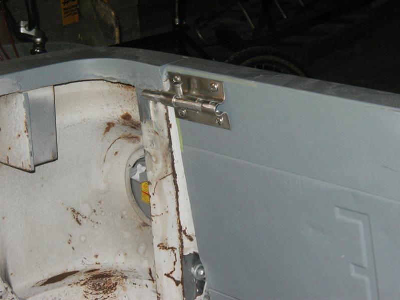

    [left]Some detail of the replacement tailgate hardware.[/left]
    The factory brackets had long chains smacking around the back of the truck, best
    to avoid scratches with this new and improved hardware.
