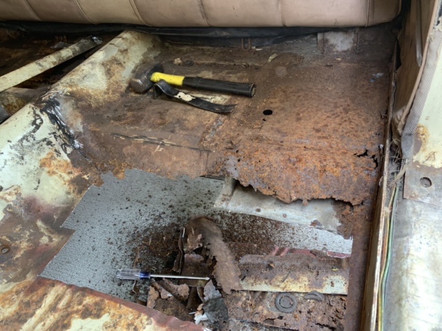

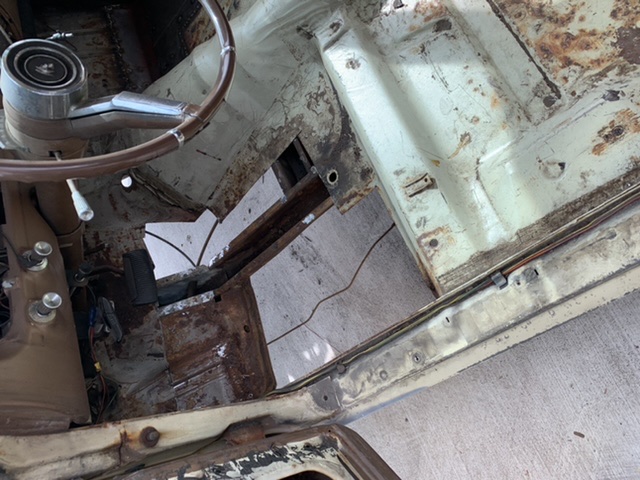

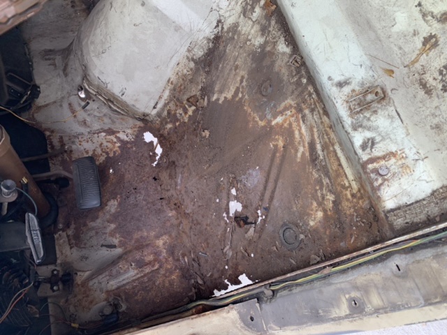

  1. I got new floor pans for it, I got them in separate pieces since the entire footwell on my pieces is not too bad. I think the floors are the same since the doors are interchangeable. I think the extra wheelbase is from the c-pillar back

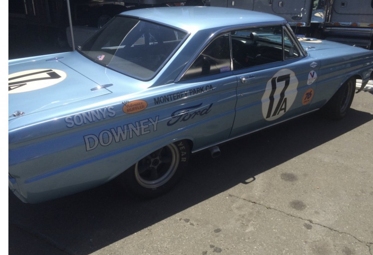

    the last pic is when I met you (In-N-Out / Hot Rods birthday bash at Pomona)

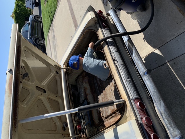

  4. Getting on some of that rust repair![​IMG][​IMG]

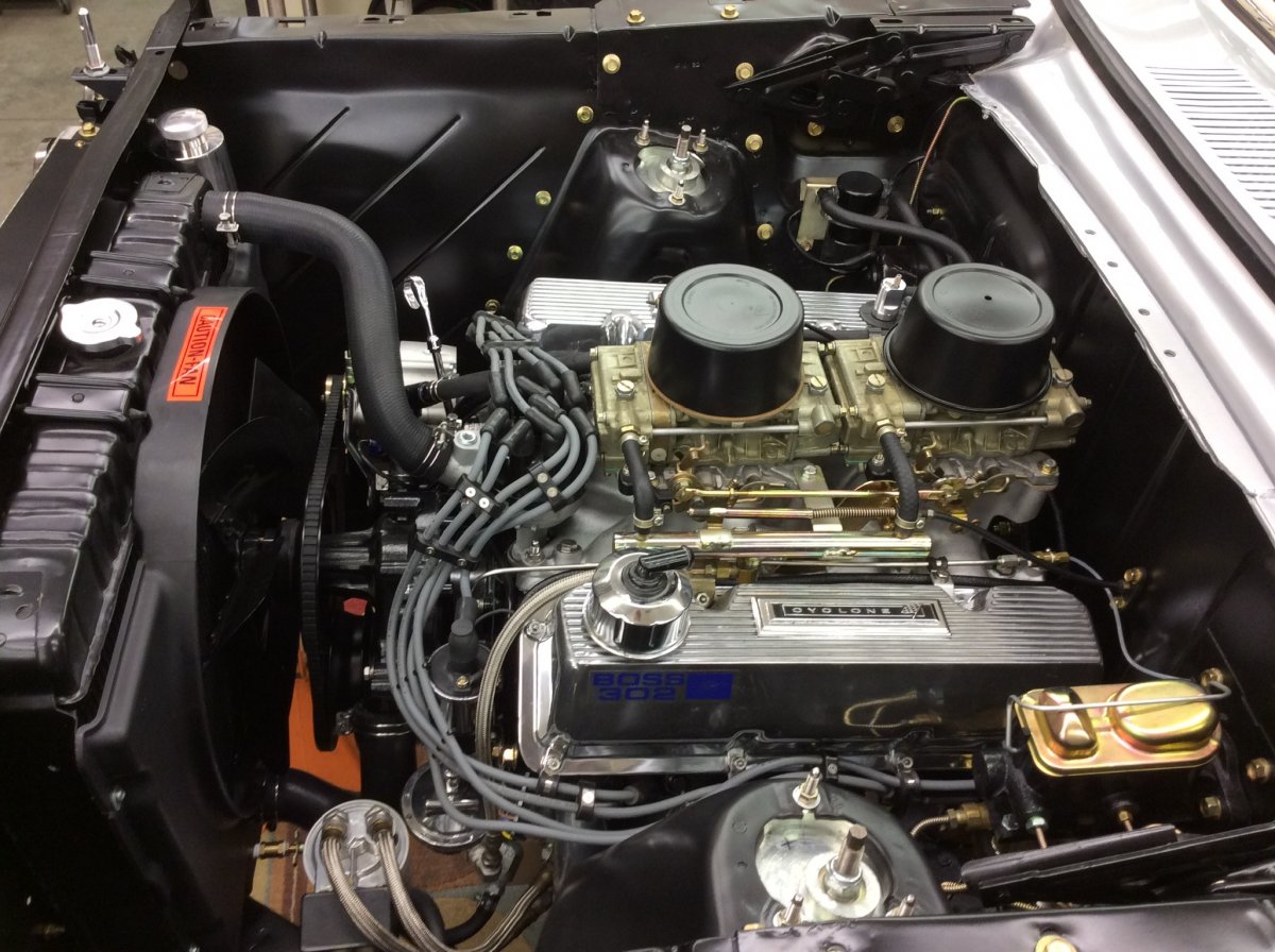

  5. Is it a big block or small block? I wanted to represent the mercury somehow. I also got an early 260 timing cover with the breather tube, so hopefully that will work since the valve covers are solid.[​IMG][​IMG]

    ^^ SBF, could be a 351W however it could be just my eyes. I see you're adapting FE valve covers to a SBF. Also you don't see too many of those 2x4 intakes, I've only seen them on SBF Shelbys. If a 351W the intake would be wider due to increased deck height. The quickest and easiest way of differentiating between the different family Ford V8 engines is to count the valve cover bolts.

  7. It’s a 351w with a 427 looking dual quad intake, carbs mounted backwards, and FE valve covers with valve cover adapters small block to big block. Good eye! Hopefully will be in the comet soon

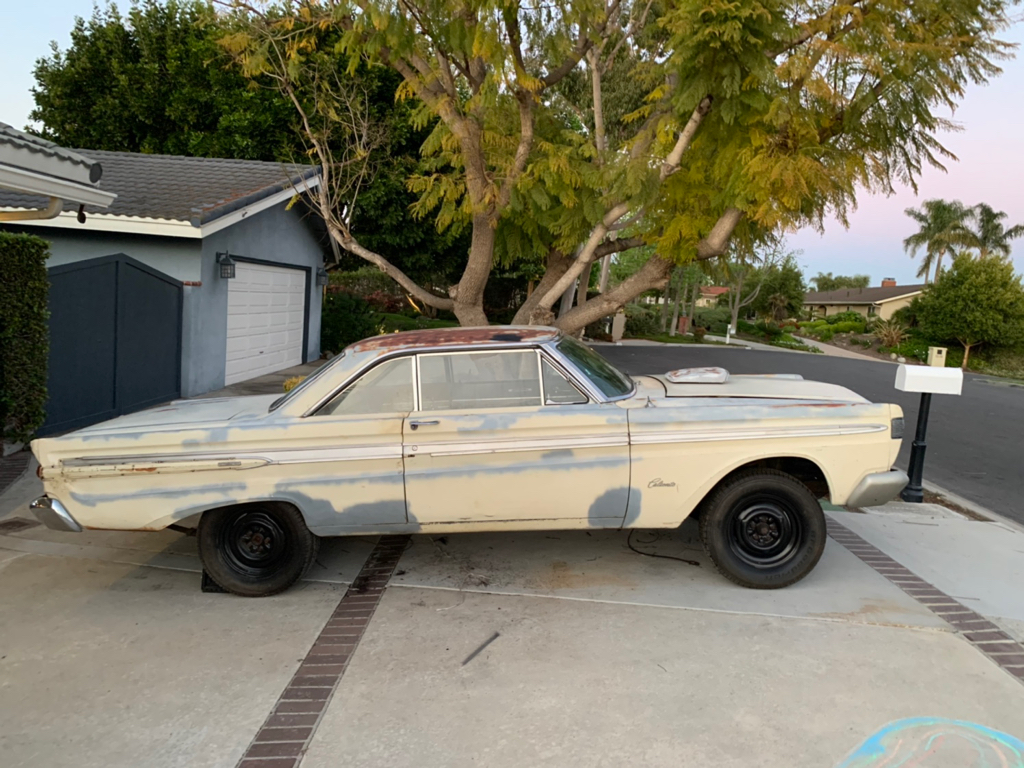

  8. I go back and forth over that look over the H/M 64 Fairlane, stripped of side trim, window trim ect. IMG_1577.JPG IMG_1576.JPG IMG_1578.JPG

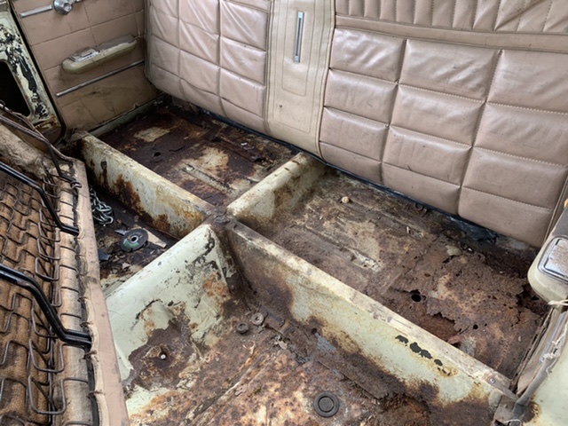

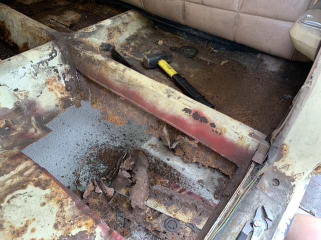

  9. It’s been a while since I updated this thread, still going strong! I got a 302 with a spun main nearing for cheap, that will not be a dual quad 331 for the comet. Working on floor rust repair, the back floor under the seat is not re popped so I gotta make it or find it somewhere.
    As I have been reading, I have learned that the engine compartments where painted grey on team am style cars of the day so oil leaks and cracks could easily be seen. May go that direction. Still deciding on what kind of roll bar/ cage to put in it... I welcome any input

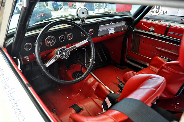

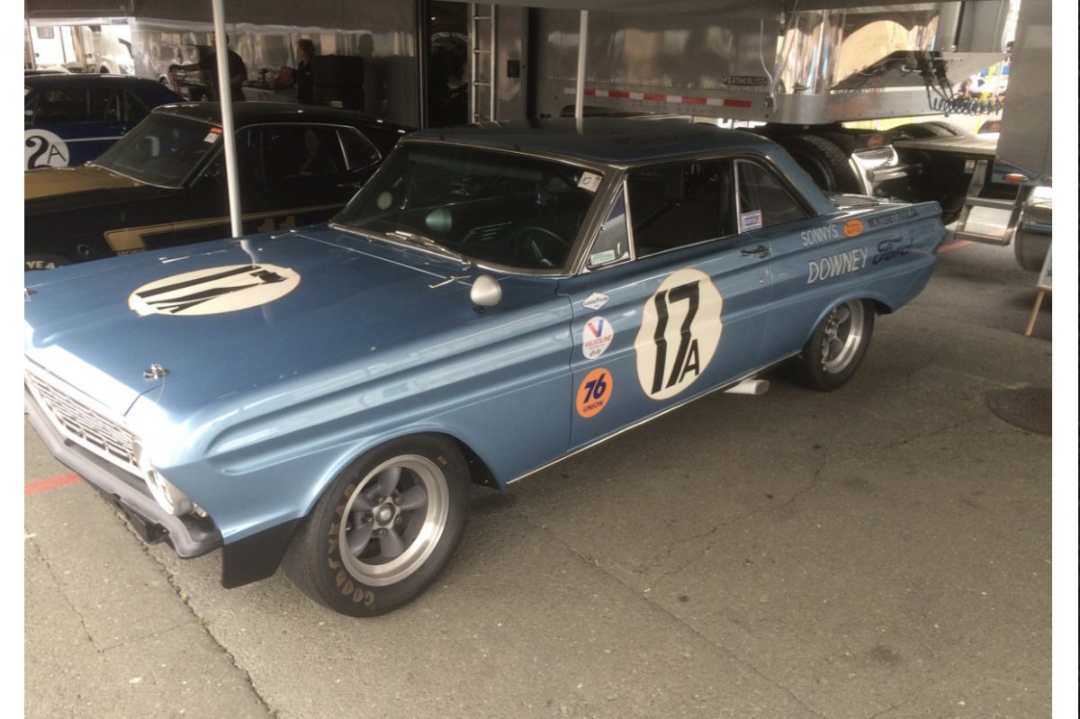

  16. Killer Cousin from the Falcon’s done right thread....
    355F42AF-96FA-4A13-AD23-3F45DEB6B415.jpeg 1A8D9A8D-5D7C-4E81-942B-C3C1F9156098.jpeg

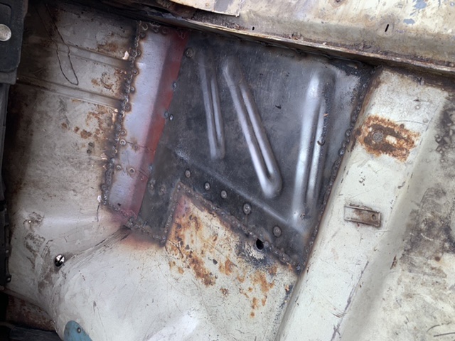

  17. More floor work![​IMG][​IMG][​IMG]

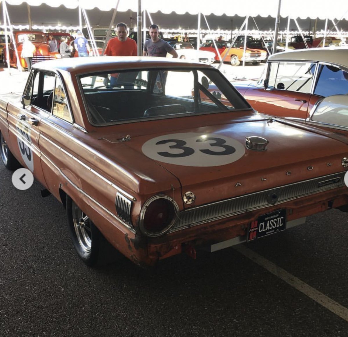

  24. No Comet...but still cool inspiration for ya C863ECD9-07BB-43F7-A03D-842F913BE82A.jpeg E8695A22-6FDC-4268-B441-15EAF6FBB052.jpeg E68D2C1E-B052-4482-A42C-9107B81871F4.jpeg
