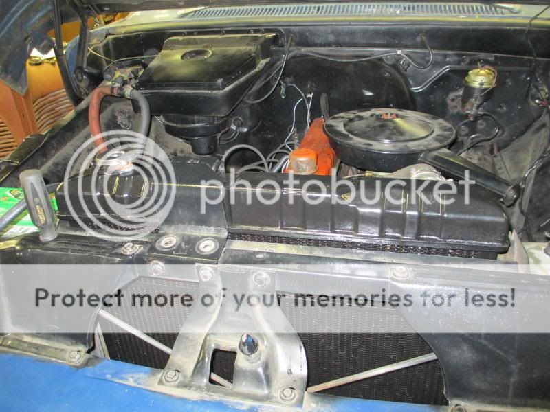

    There is no shroud on the 64 I recently bought from an original owner and no sign of it ever having had one.

    Well I finally got word back from the radiator shop and the radiator has 26 pinholes between where the top cap and the tubes go into the top cap, which can't be repaired and there are 10-15 random holes throughout the whole thing, also can't be repaired, and the whole reason why I brought it in there (the huge leak) is also not able to be repaired... so it looks like I am screwed. So I bought a radiator from RockAuto, its a 3 core, so we will see how that works.

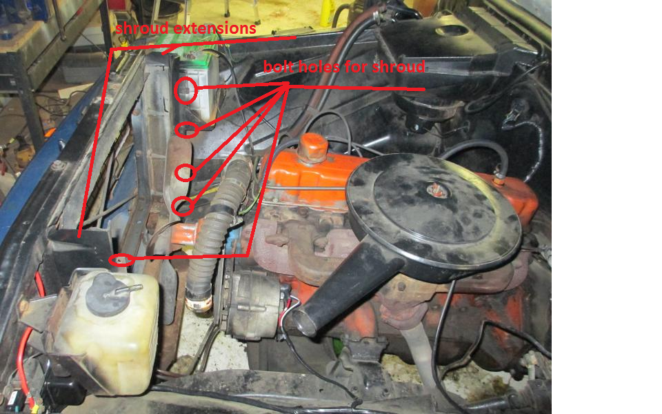

    I believe these trucks did come with fan shrouds from what i remember reading on the 60-66 truck forum,earlier years 60-62 had a round metal shroud( looks like a section cut out of a metal barrel) and later years 63-66 had a plastic style shroud...I found this out when I was researching shrouds for these trucks and ordered a new shroud for my 65.....im not running one on my 66 yet it stays cool so far with a new radiator but when money allows ill be putting one on it...you can order a shroud from LMC, BROTHERS, ORANGE TRUCK SHOP.....
    In your pictures you can actually see the tin/metal fan shroud extensions coming off each side of your radiator support with holes where the fan shroud bolts up to..
    http://www.lmctruck.com/icatalog/cbe/full.aspx?Page=33
    http://www.brotherstrucks.com/prodinfo.asp?number=FS01803
    theres either 3 or 4 bolt holes on each side:

    Good spot, it doesn't look like they give you much room there, do you have pictures of your truck?

    I dont have pictures of my 65 anymore and dont own the truck anymore, but did find you this picture off the chevy truck forum ...its a v8 but will mount the same once you take that 8" aluminum fan spacer off your water pump LOL:

  11. Hey LostHope,
    I know you've been around quite a few of these C10s, have you ever actually seen a stocker with an unmolested shroud on it? I'm just wondering because you're in a warmer climate than I normally am, but, I've NEVER seen a C10-20-30 with a fan shroud on it. I know the factory service manuals show they have one, but, I've never seen one. Most of them I look at don't even have tattle-tale marks at the holes you have highlighted showing that they had one removed in years past. I'm sort of thinking that since they shared so many parts with the COEs that they probably put shrouds on all the COEs, and just put shrouds on some of the standard pickups. I know I can tell for certain that my '64 C10 has never had one on it. Strange.

    My stock 66 c10 has a shroud, looks original to me.:cool:

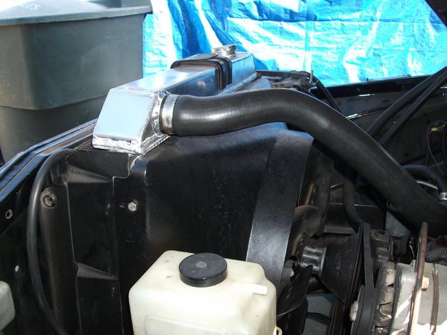

    So I just got the radiator from RockAuto... the box had the hell kicked out of it, the top radiator hose tube was pushed in an angled at 30 degrees, something is rattling around in there and it sounds like a bolt in a coffee can, a ton of fins are torn and damaged... called them up and they said, "no problem, we will ship you another free of charge, fix that one up, scrap it, or keep it... we don't care, we don't want it back. We are sending one tonight, shipping is obviously free". That blows that I can't drive it this weekend, but early next week I will be able to and I won't have to worry about rushing a couple fixes...

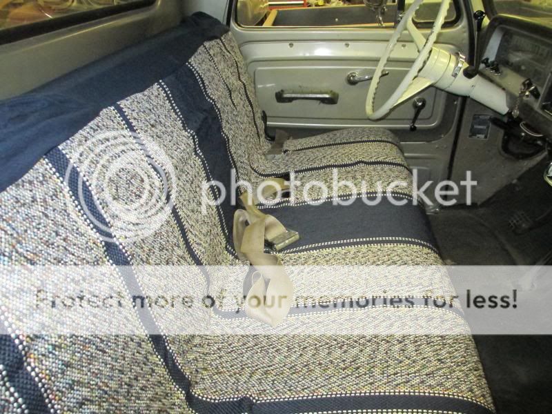

    I will post some pictures tonight, but I got the triple gauge set installed and the seat cover on there. I need to finish up hooking the gauge set to the engine and then I will be good to go. The new radiator should be in tomorrow, then I will take her for a spin and maybe post a video.

    Here are the pictures as promised:
    Hooked up are the gauges and the seat cover is installed. The wiring is finished and all I am waiting on is the radiator.
  25. Looks good man. Those saddle seat covers have covered a many of those seats. There's a good chance you'll see one when you open the door of a 60-66 or 67-72 GM truck. I still remember the pockets on the front of my dad's 70 Chevrolet K20 being loaded with casette tapes from The Outlaws, ZZ Top, Stevie Ray Vaughn and everything else of the era.

    Thanks bodi, yeah my dad had one in out '69 when I was a kid. That reminds me.... I need to find some cassette tapes at goodwill :p

    I worked on getting the radiator installed tonight and everything else set up. I need to run some new ends on the tranny cooler area, they are different from the other radiator.... too long and the ends are kind of messed up, so I will head to napa tomorrow and grab another NPT nipple and fix it up. I will take her for a spin tomorrow. Keep your fingers crossed that this thing is done nickel and diming me for now.
    Here are some pictures:

    The transmission lines look like they are brake line and the rubber hose is transmission hose, so it can handle what it is being used for.
    I had to remove the spacer for the fan because of where the tranny cooler line ports are on the radiator... In doing that I have to go through and shorten one of the lines completely and then make sure it has a really tight radius.... I decided to go with tranny line and a nipple instead because I can clear what I need to clear without damaging anything or have it come in contact with the fan.
