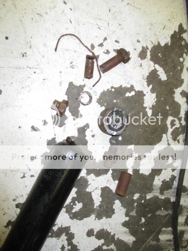

    I just spend 3 hours out in the garage getting one shock off (one bolt was hanging it up) and earlier in the day I spend another 3 hours getting the other bolts off. The bottom mount on the driver's side was holding the shock and bolt in there. All in all today I broke the other 3 bolts (1/2 inch dia.) trying to get the shocks off, each one was worse than the previous.
    The shim on the bottom of the shock was rusted to the bolt. Someone put on the wrong shocks and hardware too. One bolt and nut set was metric, the other inner diameter of the shock shim was too small, they were fully extended at normal ride height. Sweet jeebus what a pain. I have pictures of my saw zawing the shock end off and the bolt/shim as well as pounding it out with a sledge hammer.

    Here is an image of the epic battle between a Jap shock verses American power tools. 3 hours of my life wasted, but I won... so I am satisfied. I may keep the shock for a little while as a memento... haha
    This is only a small amount of broken hardware and other pieces that I was able to round up. The rest broke under a lot of tension and are strewn across the garage.

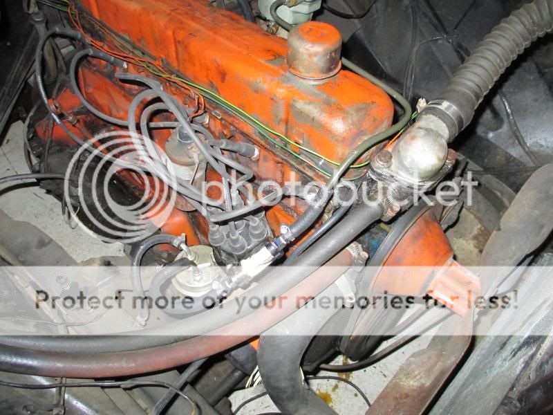

    Well I replaced my thermostat gasket, valve cover gasket, rebuilt the carb, ran a new fuel line with an inline filter, cleaned up the engine, cleaned up the electrical connection with the temp sensor, ran a new vacuum line to the tranny, new rear seal on the tranny, new u-joint, slip yoke, and carrier bearing, new brakes are on the rear axle, and fixed the issues with the gauge cluster, not bad for less than 5 days worth of work on it.
    Here are some pictures of the engine compartment, I snaked the vacuum line next to the valve cover, I still need to take care of those wires before everything is said and done though. I need to test drive it and tune it in again, a tune-up will come later when I can afford it... I am out about $120 so far and that pretty much sums it up; the slip yoke was $80 of that.
