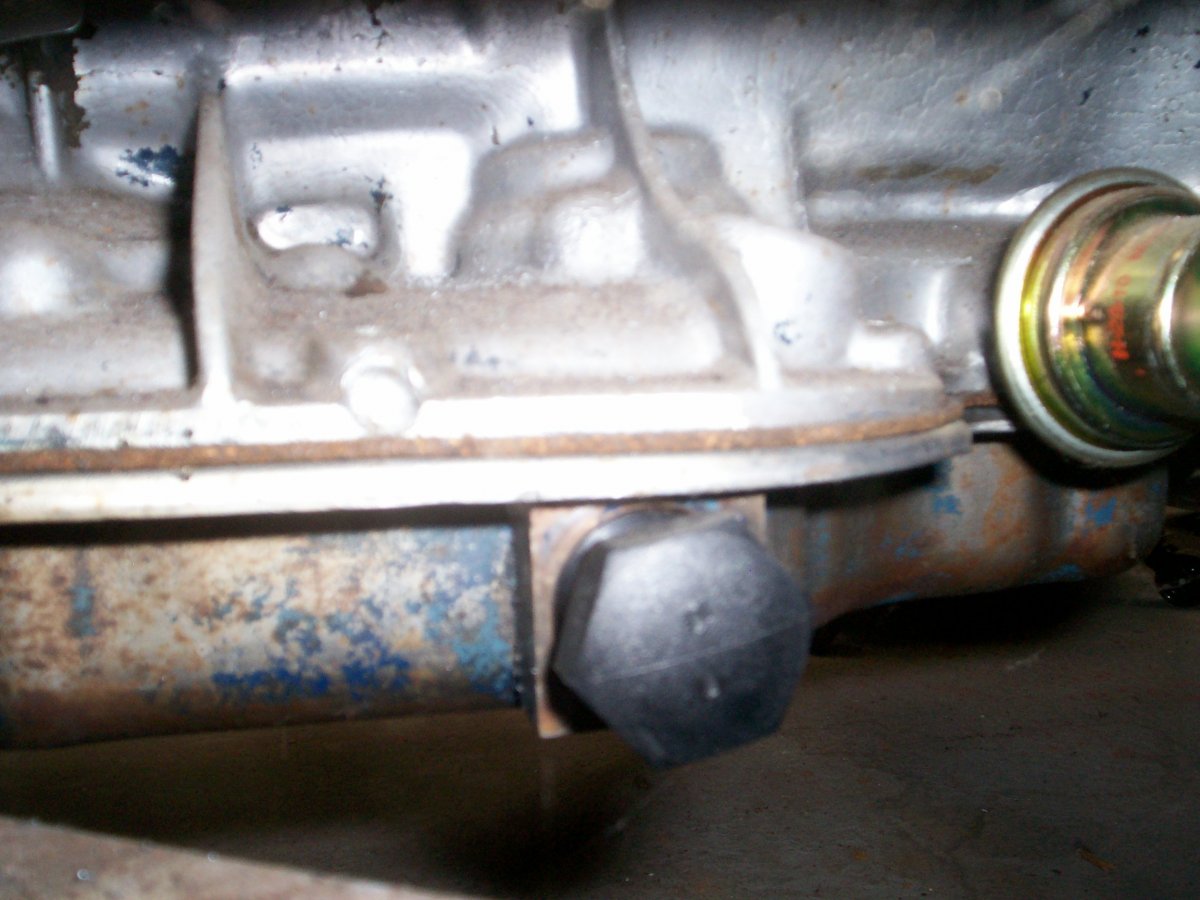

    krazee
    Ok, here are some photos of the Buick sourced T400 and adaptor ring of a '64 Fleetwood 429.
    The adaptor ring is 1 1/4" thick. 010.JPG 011.JPG 012.JPG
    Note the black plug on the side of the trans, this where the fill tube and I assume the trans dip
    stick go. The TH400 fill tube and dip stick mounts just above on top.
    Does anyone have a photo of the T400 fill tube?
