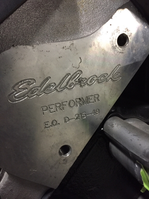

    I have an 86 Ford truck 302 that was going in but picked this up today to replace it. 306, Edelbrock aluminum heads, lumpy cam, Offy intake. All rebuilt and ready to go
    ImageUploadedByH.A.M.B.1463261243.997304.jpg ImageUploadedByH.A.M.B.1463261255.202354.jpg ImageUploadedByH.A.M.B.1463261265.774130.jpg ImageUploadedByH.A.M.B.1463261274.713130.jpg

    I'm guessing 365 horsepower or so then it will be getting a Torqstorm blower so I think it will be a 500hp combo no problem!! Or should I go turbo? I need to decide soon so I can start getting the engine mocked up in the chassis and know what I need clearance for.

    Update on the motor, I decided to go a different route with this motor. I am building a 331 for my 1960 F100 out of this motor and I plan on putting a Coyote 5.0 in the 63.
