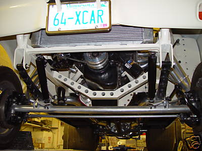

  18. havi
    Joined: Dec 30, 2008
    Posts: 1,877
    havi
    Hopefully this fairlane will give you an idea. You'll see it's a custom frame all the way from front to back. (not my car)
