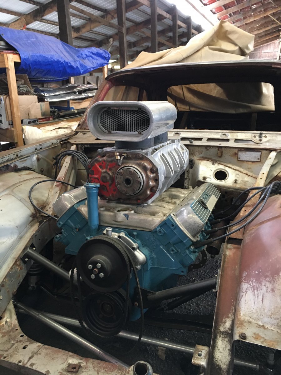

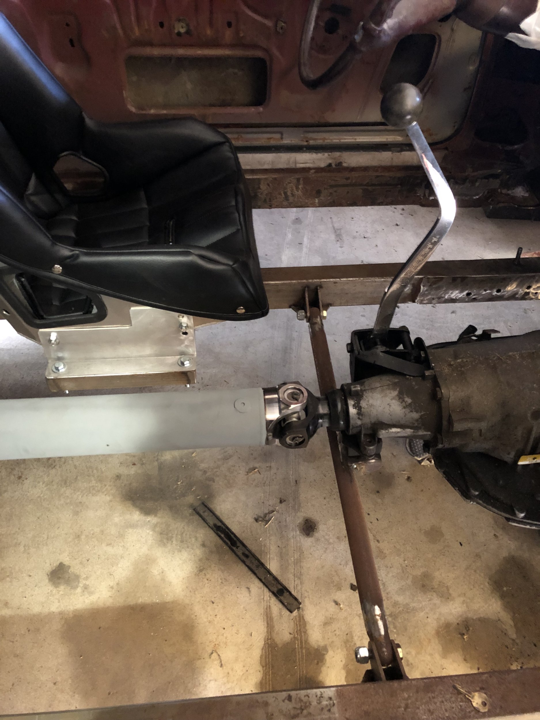

  16. young olds
    Joined: Oct 9, 2009
    Posts: 151
    young olds
    havent updated in ever! its been on the back burner for about 7 months now. since the last update i decided to go more drag then street. I put a chris alstons back half in, eliminator II 4 link. going away from the t56 in favor of a manual vb th350 and likely a blower instead of centrifugal.

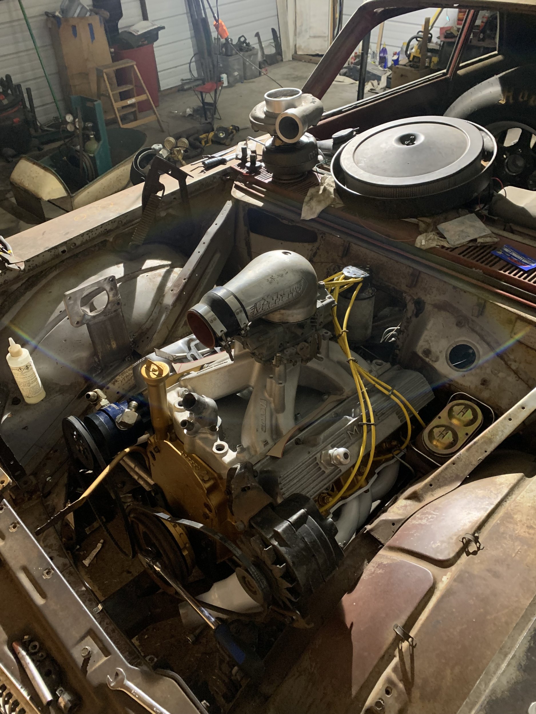

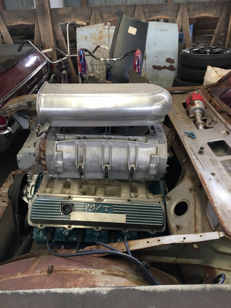

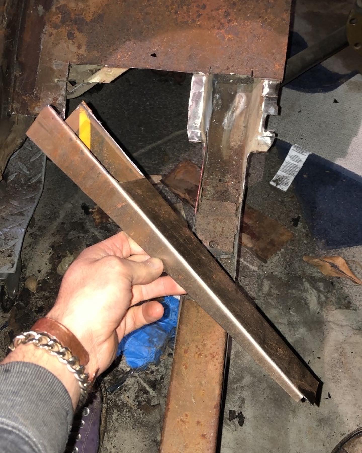

  17. young olds
    Joined: Oct 9, 2009
    Posts: 151
    young olds
  18. young olds
    Joined: Oct 9, 2009
    Posts: 151
    young olds
    Car is still a work in progress, hoping to get back to work on it after about a 4.5 year break.
    ffr1222k, oldsjoe and doc's like this.

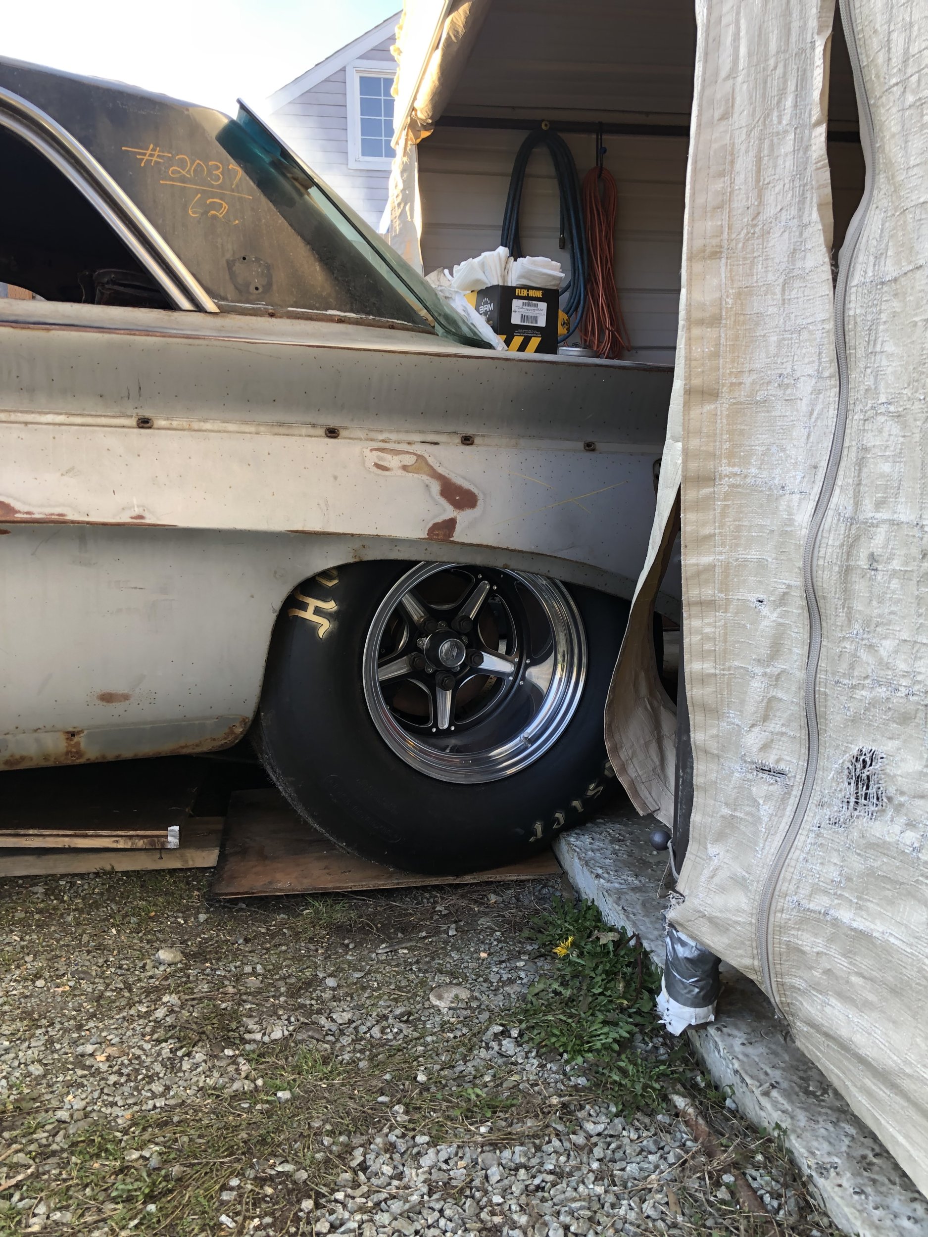

  22. young olds
    Joined: Oct 9, 2009
    Posts: 151
    young olds
    Planning on bringing this car home after years in storage. I recently purchased a Vega box from a fellow member, other then that it’s been small progress. It now has a 4l80e, kilduff lightning rods, 15x12 rear wheels( et wheels could not make the wheels I wanted in the specs I needed so I ended up with billet wheels) with 31x13.50 tire, I decided to switch from bbo to sbo( I have a diesel block) but plan on sticking with the 8-71. Not hamb friendly anymore so no pictures and probably the last post I’ll make here but if interested I am a regular on the classicoldsmobile forum( same username).
