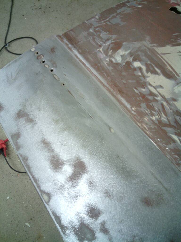

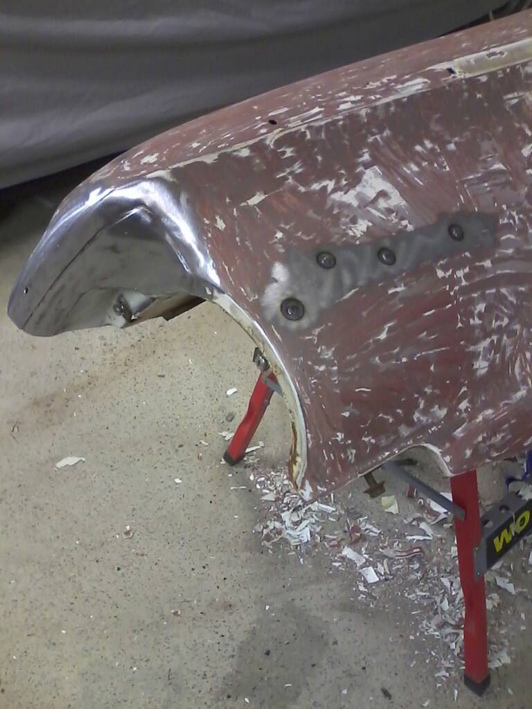

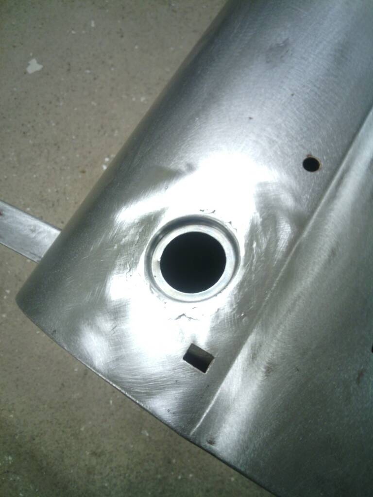

    Time for small update... I removed paint from left fender, welded few holes and did one patch to the front where I found small rusted hole. Also welded front seam full to get nice and smooth lines.

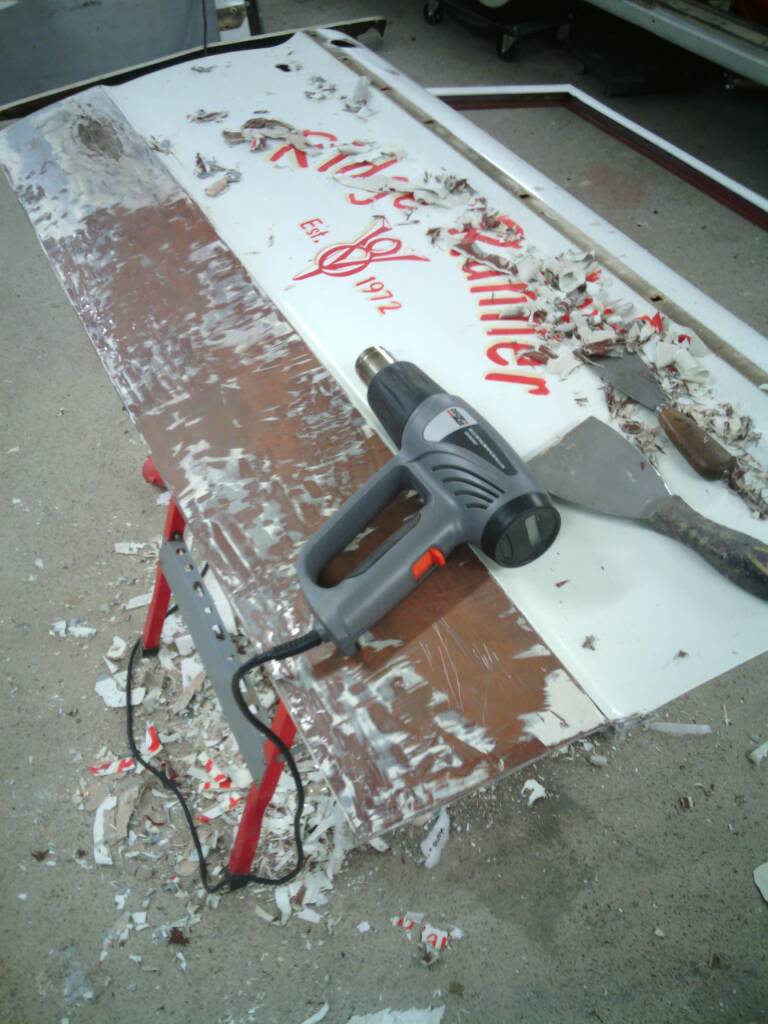

    Parted out right door and striped some paint. There was a big dent on the door and it was filled with bondo. Why the hell do it like that when it can be straightened out really easy? After little hammering and dollying it's much nicer. Too bad that there's few drilled holes in the dent area.
    I'm gonna shave door handles and replace them with some kind of push buttons. Any hints? Lincoln style or similar...

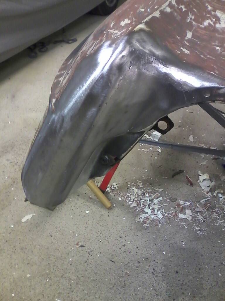

    Borrowed some tools from work so that I can do more prep work at home. Straightened few dents from left door and sand it down to bare steel and same treatment to the left fender.

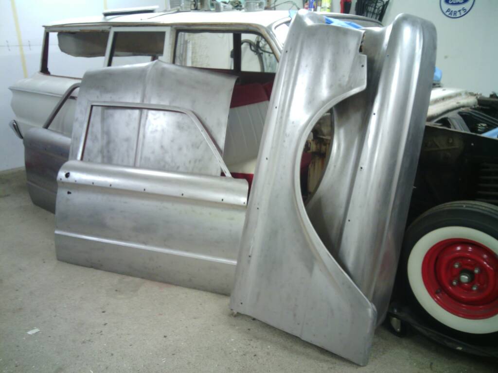

    Thanks! I did more prep work today and got done what I was planned to do at this weekend. Now fenders, hood and doors are bare steel.
    I already welded smaller door handle holes but I have to wait those push buttons to arrive.

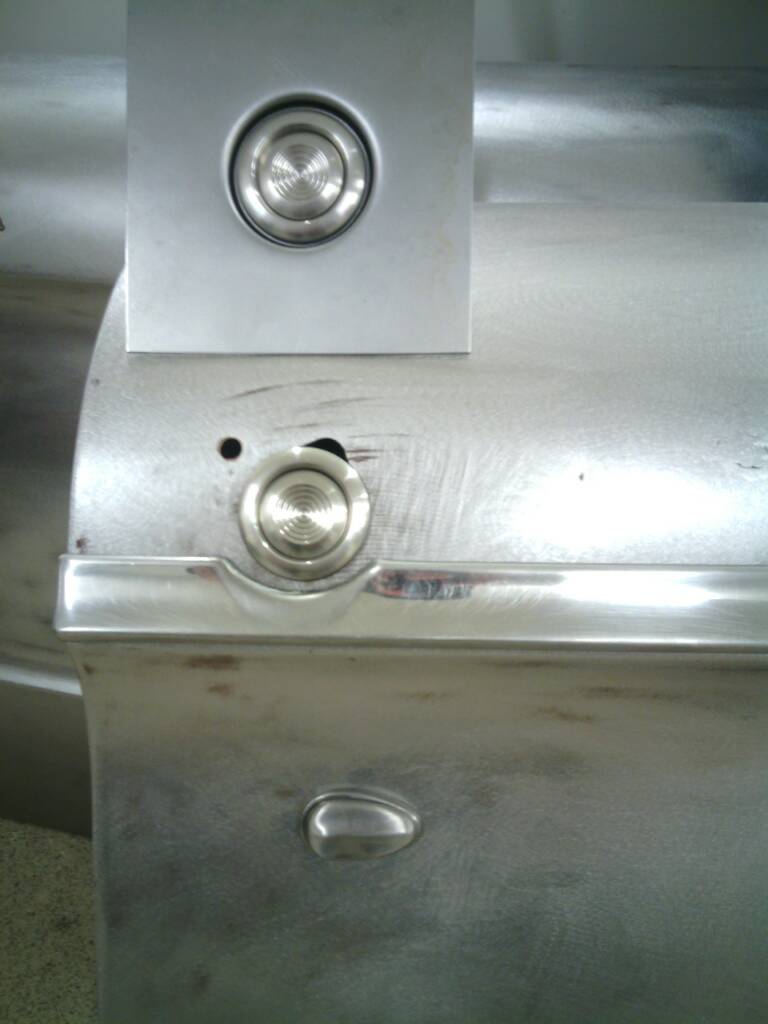

    I did some test fitting today and button fits to original door handle hole pretty great. Minor modifications must be done if I use them without frenching plates but I just have to decide what to do. Wife told that use them as is... Should I belive her??? :D

    No problem.I think it will look good either way,but using those frenching panels there will be more flat surface for the nut.Keep it up!

    Less work without the panels, but as Finrodder said, the nuts will be easier to seat if you use the frenching panels.
    However, it must be said that keeping your woman happy goes a long way to a trouble free existence, so bear that in mind. ;)
    Either way will look good though.

    Door has pretty tight curve just above door handle hole so you guys might be right. I have check how that nut will seat without panels.

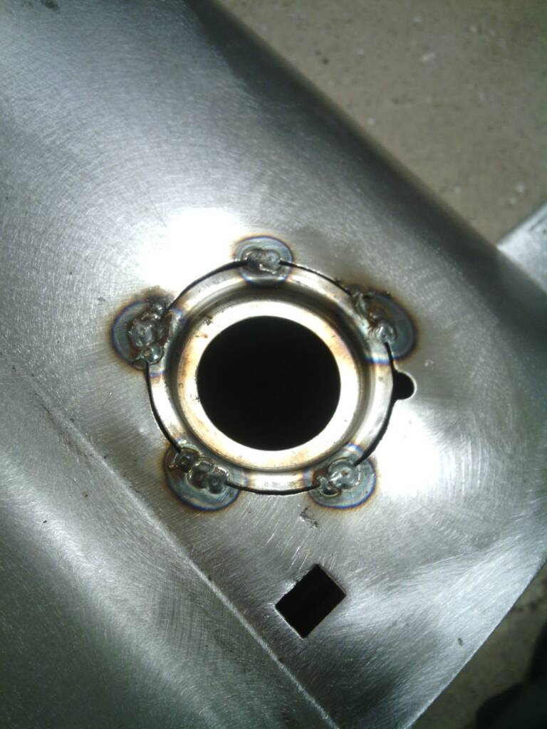

    Found out that nut don't seat nicely on the back so it was clear that buttons will be frenched. After little cutting, welding and hammering one button is now frenched. It turned out really nice and now nut will be seat as it should.

  20. The frenched button looks so much better than hid it just been mounted flat. HRP

    It does and looks with mouldings like it was made in the factory.

    Wow,that looks pretty cool!
    I am not sure is it easy to put there,but a matching pushbutton on the tailgate could be cool too?

    It would be cool but it's impossible to do because there is window crank and lock cylinder. You can't open the tailgate without lowering window. Otherwise I'd do it, no doubt about that.

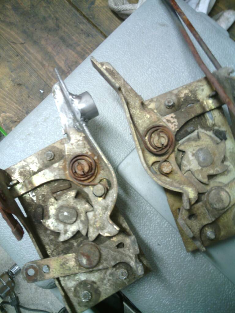

    Last saturday I had some time to french left door push button. You can see from photo how little piece of panel I welded on doors.
    Also did minor modification to door latch. Hammered it straight and welded small piece of steel rod to fill empty space between latch and button.
