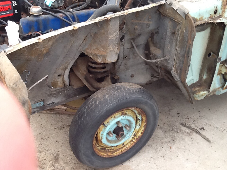

    Hello Ya'll,

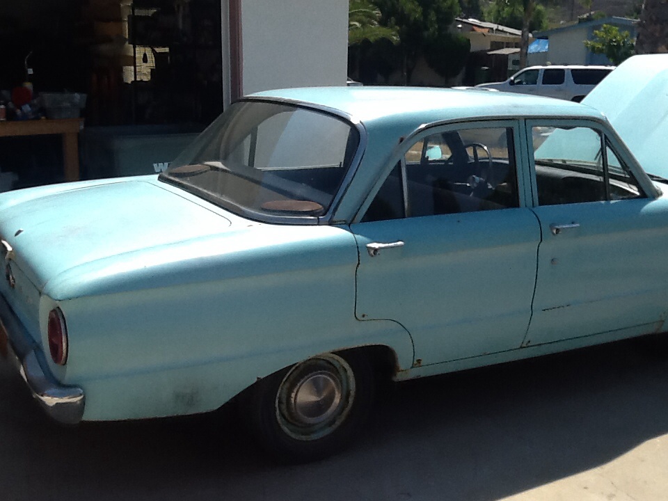

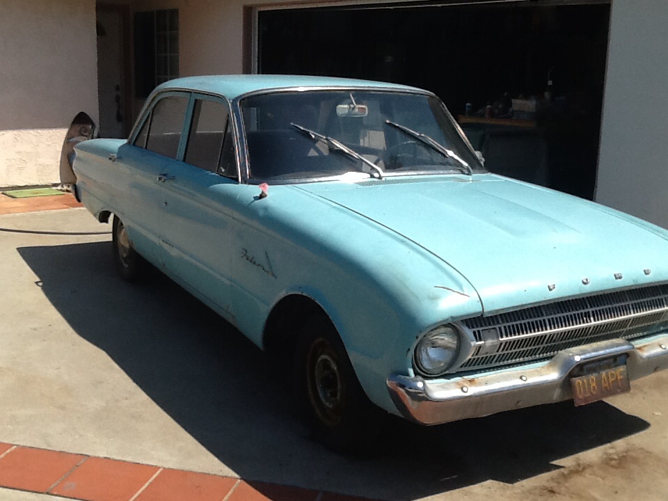

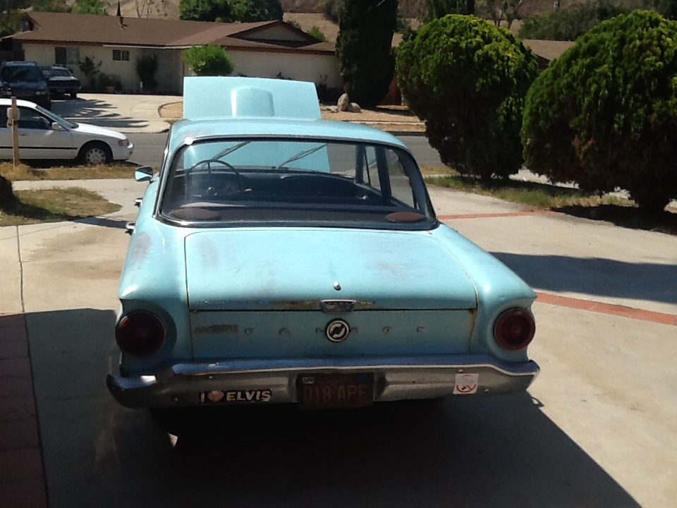

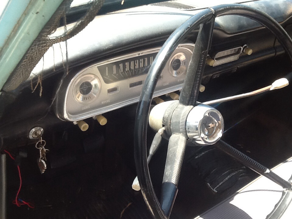

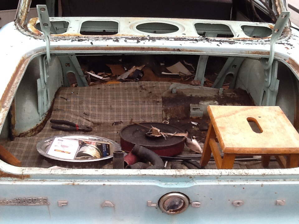

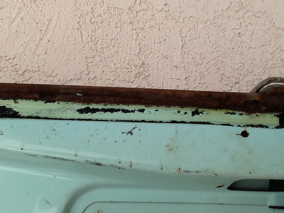

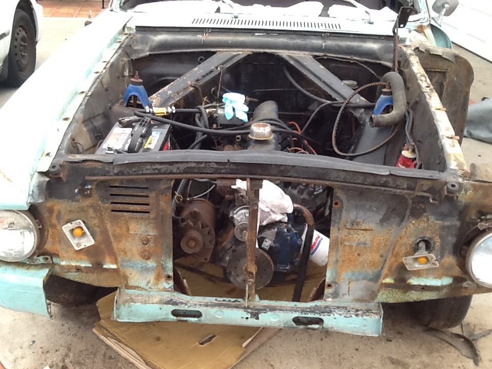

    I'm a newb to the group so here is what I'm working with. I've never done a restoration and I can already tell I've bit off a little more then I can chew on this one. Bought this of craigslist for $1000 in the same town I live. Yes I know it's a four door but, I like the look and it's fits my whole family and I'm told has better gas milage then some modern cars. This is gonna be our around town Sunday grocery getter. No hot rod, it's gonna go to my daughter when she graduates. Maybe ;)
    After I got it home I realized it had more rust then I expected and therefore I am going to do a full media/sand blasting job on it. Before I started the strip down I attacked the engine to bring her back to life. Rebuilt the carb. Replaced fuel pump,water pump and did a tune up.
    Now I still don't know if it's a 144 or 170 yet but am thinking its a 144. The radiator was rusted out so I ordered a CU1463 Spectra Premium radiator but it didn't fit. It was a little thicker then the OEM even though it was advertised as a direct fit! :(
    So at the present I'm stuck in the water on that one. I did start her and she fired right up, yeah! Did a quick test gear shift and she moved so I may be ok on the tranny.

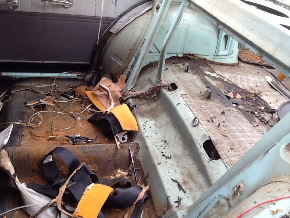

    So I jumped right in and started stripping her down. Removed hood, front glass and almost finished the two front fenders. The rusted bolts kicked my arse! There are a few down behind the front bumper that are rusted beyond belief. They hold the fenders to the front spoiler? I think it's called a spoiler. Like I said I'm a newb at this.
    Any way just wanted to introduce myself. Here's a few pics of the car and I'll post more tomorrow of the strip down. Till then...CYA!

    It's a big mistake to immediately start slinging parts off the car, especially with your experience level.
    Do you have a place to work?
    Do you have a place to store parts for...months at a time?
    Glass..What glass, the windshield?
    Have you documented every bolt, electrical connection, clip, washer, and rubber piece?
    Have you photographed each assembly before disassembly? You will not remember, it's like a Rubix Cube to the zillionth power.
    Have you labeled, each part with it's hardware, bolts and connectors bagged and tagged with it?
    Stay out of the whip zip bang cha ching after market parts catalogs at least for now. Most of that crap you do not need.
    Did you price getting the radiator re-cored/repaired from a reputable shop?
    Have you ever sand blasted a car? Are you prepared to immediately paint it afterwards? Do you know how to prevent sand or media from coming out of every crevice and grinding every hinge or moving body part for the next decade?
    Did You try to clean her up before you took it apart??
    I'm only trying to prevent you making the mistake I did when I was 15. The vehicle I destroyed meant something to me.
    What I would do if I were you.
    Carefully put it back together, if you can. Forget about the body for right now.
    #1 Evaluate the car, make a thorough bumper to bumper inspection. Actually you should have done this before you bought it.
    Pay close attention to the rocker panel and floor. Are the spring towers solid under the hood? How does the cowl look under the dash and how are the floors in that area. How does it look from underneath where the front end assembly meets the floor and firewall. This is the torque box. This car has no true frame. Rust especially surface rust is one thing, rust out is another. If the floors and torque box are rusted out, you may be better off finding another car.
    Check the floors under the mat/carpet. Check the truck and the rear suspension and where it mounts to the body. If it's repairable proceed, if not Craigslist or find a buildable Falcon and use this one for parts.
    #2 Buy the Factory Shop Manuals for this car.
    #3Will it roll? Will it stop? Make sure the brakes are in order. Grease the wheel bearings on the front while you do the front brakes. Do the lines need replaced? Most likely the rubber lines do. The wheel cylinders/master cylinder may can be cleaned up, if not buy new ones. Kits are a waste of time and money. Make sure the emergency brake works especially with the single cylinder. You may choose to upgrade the brakes later but for right now make sure whats on it works. Are the tires good if not replace them and you might as well paint the wheels or at least clean them up real good if you replace the tires.
    #4 The engine. The first thing you do to the engine is take off the gas cap and sniff but do not make a day out of it unless you want to be visited by Puff the Magic Dragon...
    If it smells like gasoline that's good. Most likely it will have a sicky sweet varnish smell, that's bad. Preferably outside with good ventilation away from ignition sources, drain the tank into a bucket or large pan. You may need several of these if the tank was full. Note the color and smell of the gas. Look for rust and crud. There should be a drain bolt on the bottom of the tank. If the gas was pretty clean you may can re use it if you pour it through a T shirt. If it smells of varnish and it's dirty or has water in it's no good. If you had to punch a hole through the crud to get it to drain, you likely need a new tank. You may can try to clean up but if it's rusty and dirty replacement id best. You can rig you up a small temporary tank to just run the engine.
    Blow out the fuel lines and replace any that are questionable. Put a good filter in the system.
    Have the original radiator repaired or try to find another Ford Falcon factory radiator and have it repaired. You may can find a good one at a junkyard.
    Make sure you have a good battery and all the wires especially the heavy wires are in good order. Check the ground straps.
    Lube all the carb linkage and make sure the fuel lines are new or a least clean, make sure the vacuum hoses are in good order.
    Change the oil and filter.
    Now the car should have decent brakes, a clean fuel system, decent tires, battery to the engine with all wires under the hood in order, carb hooked up and linkage working and the emergency brake in order, new radiator and hoses hooked up now she's ready to crank.
    Consult the manual for tuning info. If it runs OK you need to tune it up with new points plugs ect. If it runs poorly or not at all still replace plugs points ect. Keep the old condensor as the China/Mexico stuff may be bad out of the box. If it still does not run start trouble shooting it . tips swill be in the manual.
    Now the car runs and stops on good tires.
    #5 Check/change the dope in the transmission and rear axle.
    #6 Make sure tail lights, brake lights and head lights work.
    #7 Get insurance for it.
    #8 Take it for a spin and see what needs to be done.
    #9 Get some light Scotchbrite pads and lightly wash the car. Follow with rubbing compound. Buff then apply some car wax and buff again. You are going to be surprised in how good it will look. For the rust spots, scrub apply primer over naked metal with maybe some matching spot paint over that.
    #10 Now the car runs drives and looks pretty decent. Now you can think about serious body work or engine and brake hop up and upgrades. A plus with this method is you can still enjoy the car.
    IMHO this car does not look like it needs blasting.
    I'm a newbie at car restoration but I have 30 years of dismantling experience
    McDonald's...just kidding....your looking at it, my driveway
    Yes I have five moving containers in my back yard
    Yes in sandwich bags
    So far it's pretty self explanatory but yes definitely will be taking pictures as I go.
    I can't afford that anyway
    The radiator I have looks beyond repair and if I can get one for close to $100 that's cheaper then driving around.
    Sandblast before yes......yes primer will follow next day.....I'll be using tarps to catch what I can....a decade? I hope not.
    Yes pressure washed
    I made the mistake at 16 but he's all grown up now and on his own, 29 years later.
    Shoulda, coulda woulda but I didn't.
    All that looks solid....just surface rust.
    Uni body

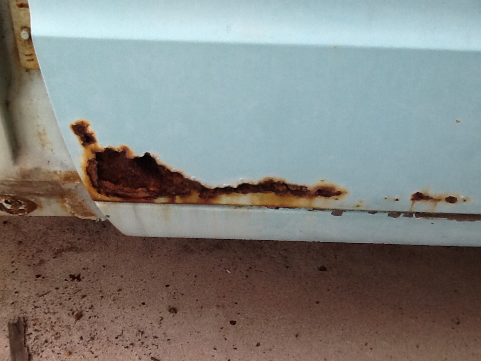

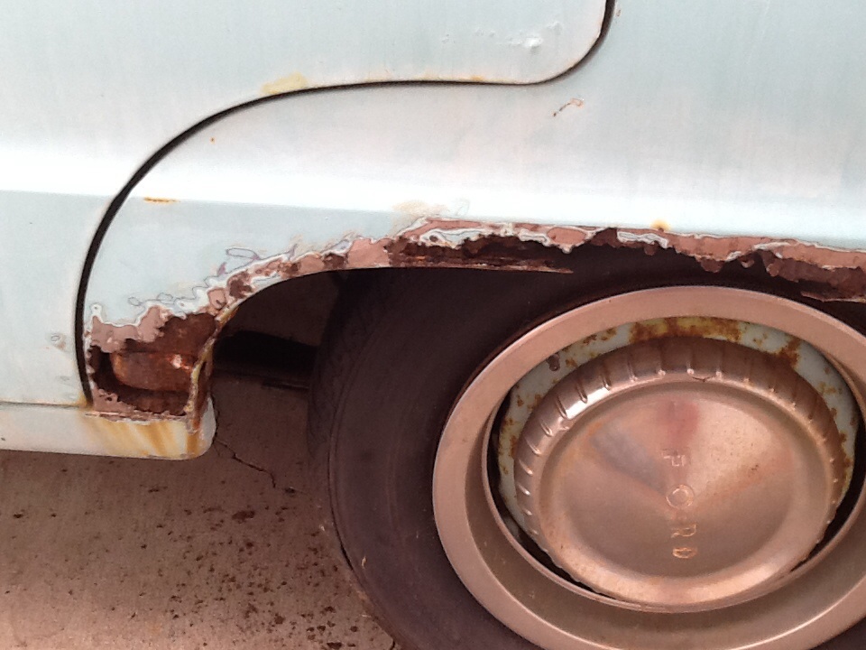

    Rust out in drivers door panel and rear quarter panel
    Suspension looks seriously rusted. I was gonna yank it and replace all.
    Got it in PDF.
    #3Will it roll?
    Rolls fine
    Will it stop?
    Master cylinder bone dry and brake lines rusted.
    $250 I can do front and rear pads and drums.
    Grease bearings is cheap and easy
    I was thinking of going plastic lines....cheap and easy
    Was thinking of going disc but that's later down the roadAre the tires good if not replace them and you might as well paint the wheels or at least clean them up real good if you replace the tires.
    Just bought a harbor freight sand blasting cabinet today. 13" rims fit. Found some cheap low rider white walls at pep boys down the street. Gonna wait on that for final touches.
    Tank was drained, lines blown out and new filters put in....I'll be keeping an eye out to see how fast the filters get clogged.....if they clog to quick the tanks getting replaced.
    Time is money....not gonna waste that much time hunting unless a new radiator cost me over couple hundred bucks.
    New battery and new straps...done
    Done
    Done
    How does the cowl look under the dash and how are the floors in that area. How does it look from underneath where the front end assembly meets the floor and firewall. This is the torque box. This car has no true frame. Rust especially surface rust is one thing, rust out is another. If the floors and torque box are rusted out.
    I took a peek under the mats and I don't see rust...still need to inspect more
    Too late
    Did all that she's already fired up and idling.
    All the electrical is working
    You think? I don't know what made me more tired, reading your post or removing rusted bolts. LOL. Thanks for all the advise....now back to work

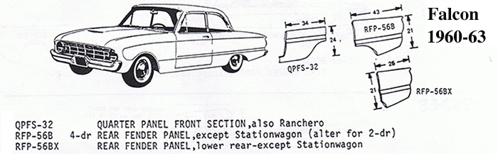

  14. That radiator WILL fit. I ran into the same thing...on the exact same car...even the same color...
    Cosmo

    Here is Elvis resurrected from the dead.

  28. GSEVEN
    Joined: Aug 9, 2014
    Posts: 19
    GSEVEN
    Ok here are some progress pictures. From what I can tell this is the extent of the major rust.
    From what I can tell it's not that bad to me. I was caught by surprise on the inner trunk lip rusted. I was looking for panel skins and I don't think I see any panels for the a 4 door rear front quarter panel. The one that is in the door jam.

    Can anyone verify if the front quarter replacement panel front section QPFS-32-L on this picture for a 2 door is the same as a 4 door?
    The panel they have on that site is for a two door and the area I want to fix is in the picture of my car. The length of the two door fender is not a big concern because I really only need the left side of the panel where the door jam is rusted out. Unfortunately I don't know anyone who has a 2 door to compare to see if the shapes are the same between 2&4 doors.
    Anyone know for sure?
