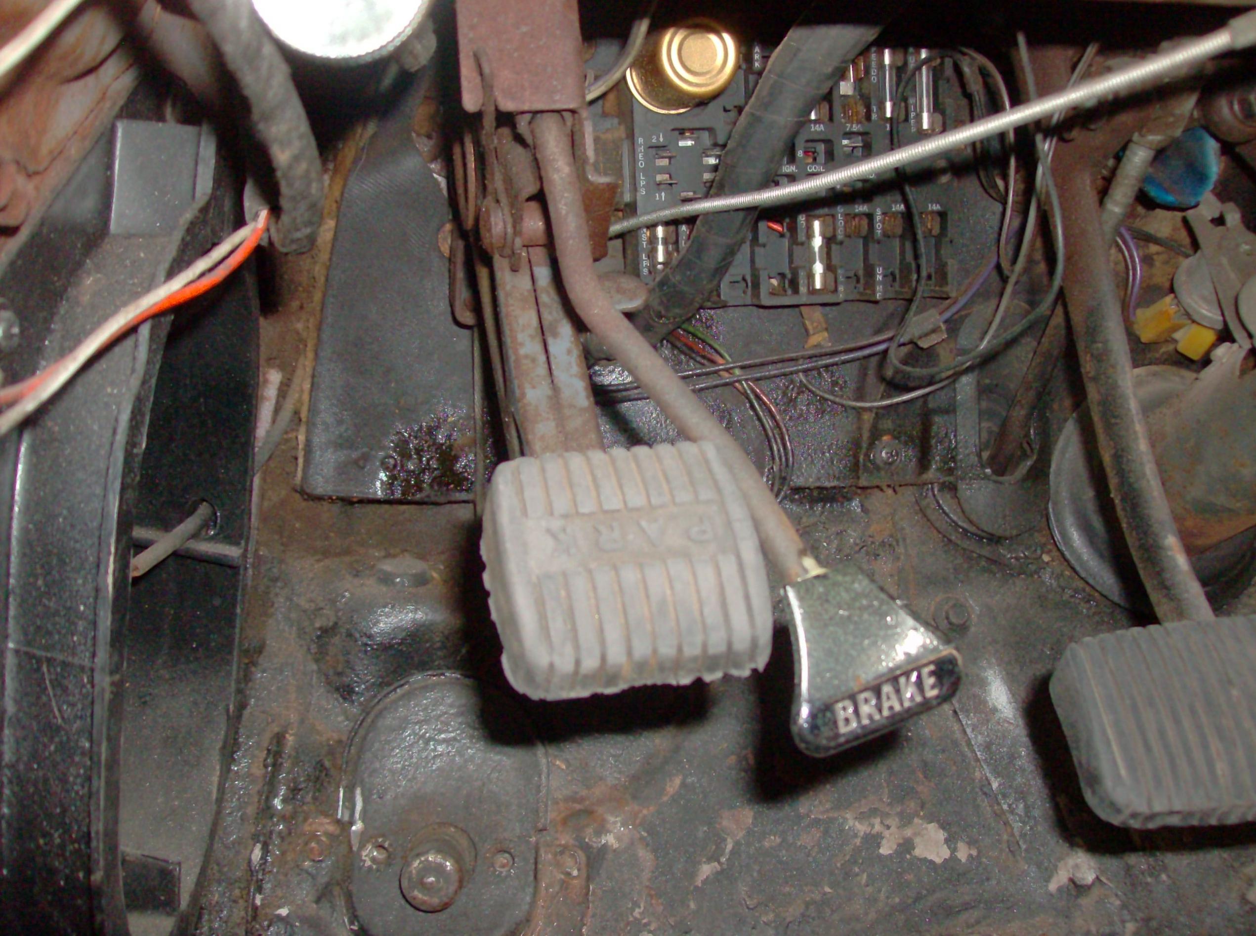

    Working on a friends '60 Ventura and need a source for side moulding clips as pictured below. I also need to know what kind of clips hold on the upper rear 1/4 mouldings- they are missing except for the stud ones on the ends. Finally if anyone has, or can take a pic of their p-brake pedal/release handle, I need to see how the release handle is supposed to go. The one on this car is loose and I think the po glued? the handle on upside down. If I twist it up so the release handle is at the top it is upside down. So I am not sure what is going on with it.

    The e-brake arm is simply old and used...it's bent down too far...it should be closer to the bottom of the dash...the handle is correct in the pic shown...it's the arm that's the problem. You can take the whole unit off the firewall by setting the brake, attach a vise-grip to the cable so it doesn't release, remove the two (or three) bolts on the engine side of the firewall, one at the bottom of the dash and slipping the brake cable ball out of it's socket in the unit...
    Then you can straighten the handle, repaint it, grease it up and put it back on...it's not that difficult...

    Got it fixed. Had to bend the handle rod a little and then turn the handle 180 degrees. After I had the alignment right I welded the rod into the assembly.-Worked great.
