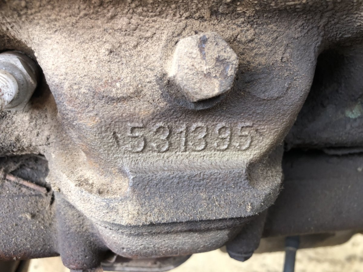

  2. engine number 37M.....'62 & 63, 389, 2 bbl, 283 hp, automatic.

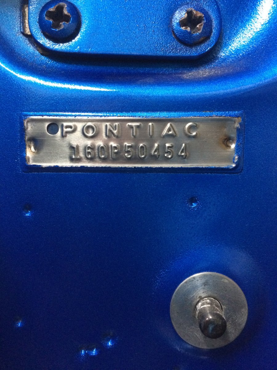

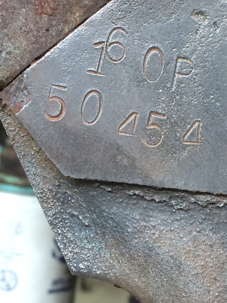

    This was the stamping on front passenger side of engine block on my car, and the VIN. 494F931B-8B5A-4856-AA6E-B18F7A2B5413.jpeg DB2E7C93-5C2F-47DB-BD4B-A2C8014F9C40.jpeg

    I didn’t realize they stamped the vin into the engine! Cool
