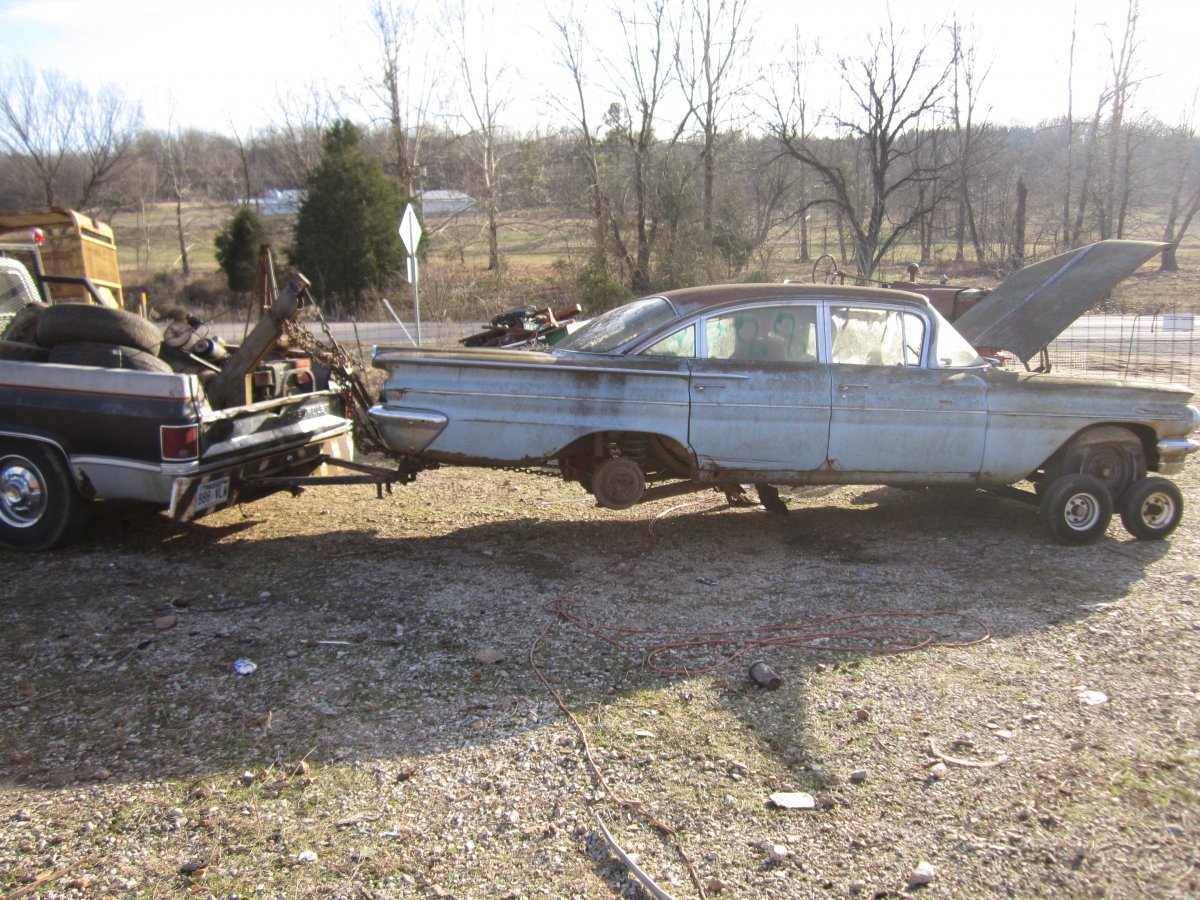

  4. My buddy, Sonny and I once bought a 60 star chief 2 door sedan[!]. I wanted the 389 for my 56 pontiac and he wanted the mint bumpers off it for this car. Rest went to scrap. sonnysponcho.jpg

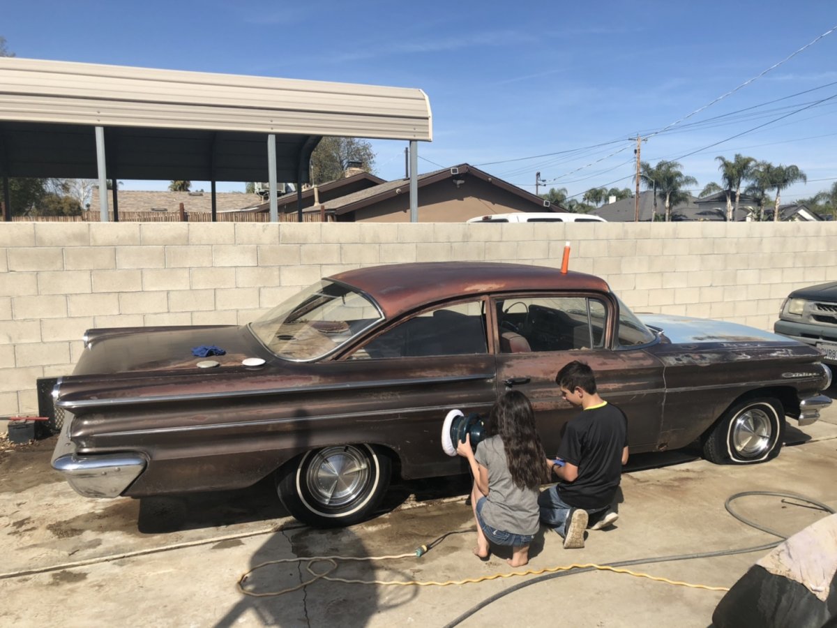

    I gave bored kids that wanted to help rubbing compound and a buffer (not shown) and said have at it! Surprisingly the paint is shiny in some places. IMG_8105.JPG IMG_8107.JPG

    I recall another member had a similar YOM Chevy long roof and wiped it over with CLR before clear coating it. All original and looked great when done. Here's an example how CLR can rejuvenate old original paint.

    Oh wow! I will buy some tomorrow morning!!!!!!

    Great your kids are involved! Keep doing that!
    Also.....That bronze color is really growing on me.

    Yeah me too but apparently my patina is not a cool as others because my car looks the same after cleaning the rust. Lol

    Looks like by the young ‘be smile you are raising them right. Future hot riddlers.

    Thank you! Yeah, we have a good time! We don’t accomplish much but we have fun! Lol

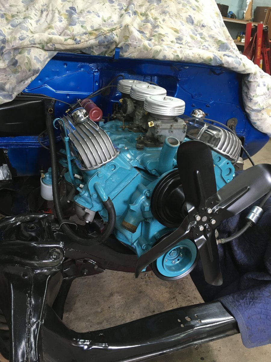

    I had a 60 Catalina 2dr sedan, 389 auto, converted to (correct) tri-power and 4spd with original parts. Used a brand new Richmond T-10 trans in it. Mine didn’t have reverse lights either, like this car

    Another pic. The engine had the entire vin number stamped on the front passenger side of block. Added the long ram manifolds and oil filter relocation
