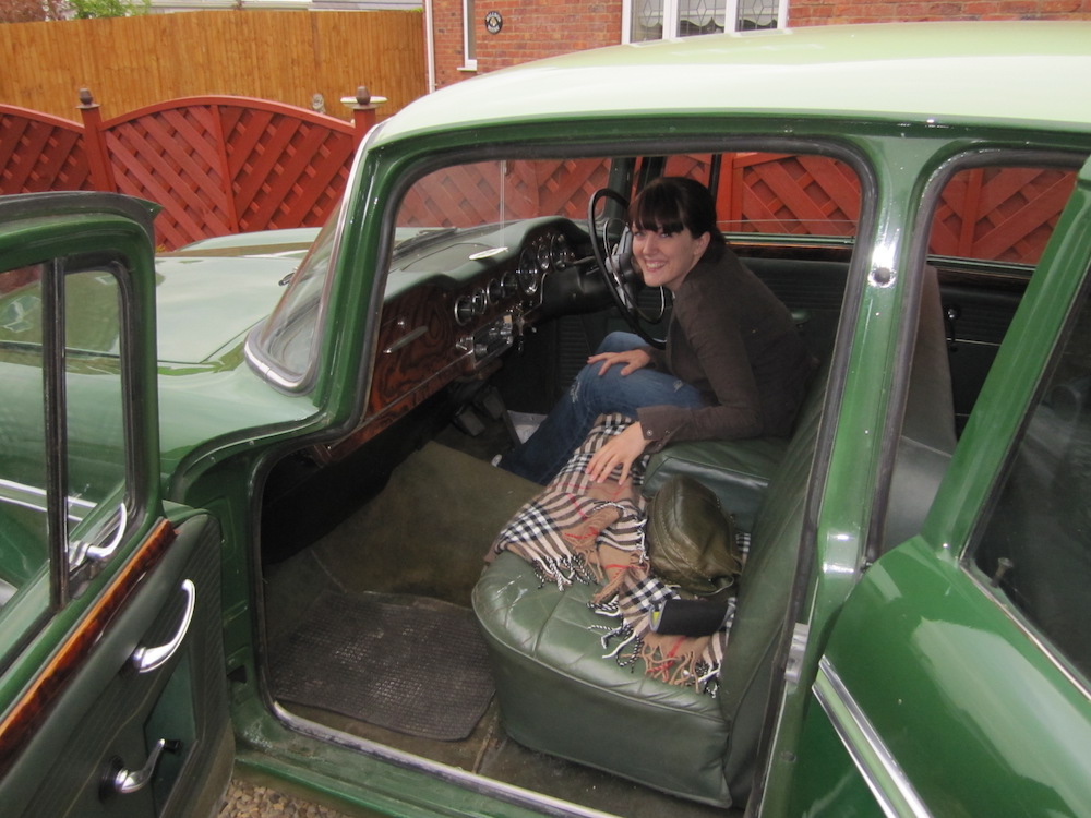

    IMG_2887.JPG Didn't get many cars here in the UK with bench seats

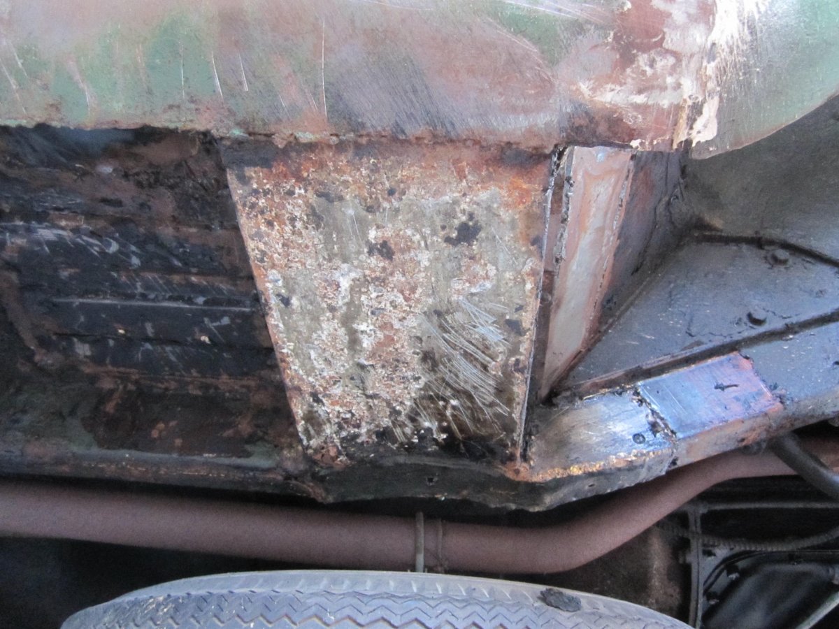

    So, it failed its yearly MOT (Ministry of Transport Test) on a load of structural rust issues and bad repair work underneath... Tester said we should ask for our money back, but I had already envisioned myself cruising down the road in the sunshine, Missus by my side on that bench seat - not a care in the world!
    So I had to bite the bullet and put to work all those things I'd read about in all those Hot Rod magazines I've been reading since I was little...
    Once in her new home for the foreseeable (we'd moved house shortly after buying the Humber) I decided to dig around the boot floor...
    Now, whilst I consider myself pretty good with my hands, I've never attempted anything like this before - so I'm learning all the way! I don't have access to large machinery, so most jobs are tackled with power and hand tools.
    2012-02-26 19.32.54.jpg 2012-02-26 19.37.21.jpg 2012-02-26 19.42.10.jpg 2012-02-26 19.42.42.jpg 2012-03-14 21.24.12.jpg 2012-03-14 21.25.10.jpg 2012-03-20 21.34.42.jpg 2012-04-14 19.54.55.jpg 2012-04-14 19.55.12.jpg 2012-04-14 20.34.10.jpg 2012-04-14 20.35.33.jpg 2012-05-06 15.31.36.jpg 2012-05-06 15.31.54.jpg 2012-05-06 15.47.11.jpg 2012-05-06 15.47.19.jpg

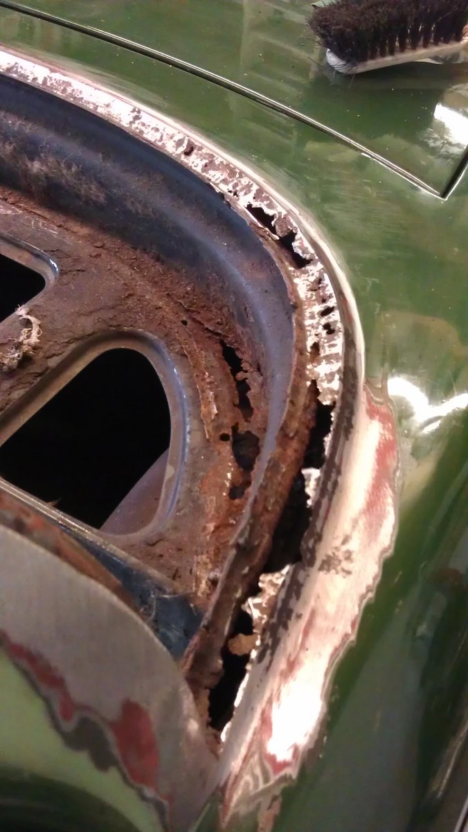

    I might have put these in the wrong order... But pretty soon after getting settled in the new place, I started poking around the rear screen rubber, or what was left of it.

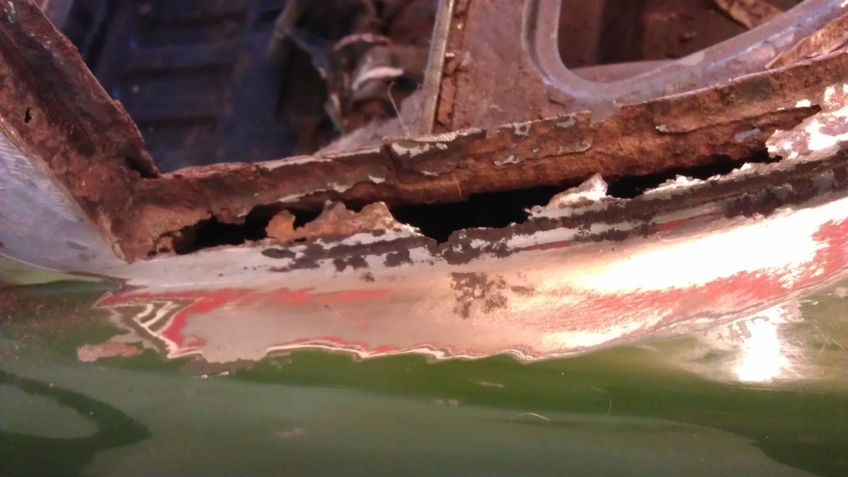

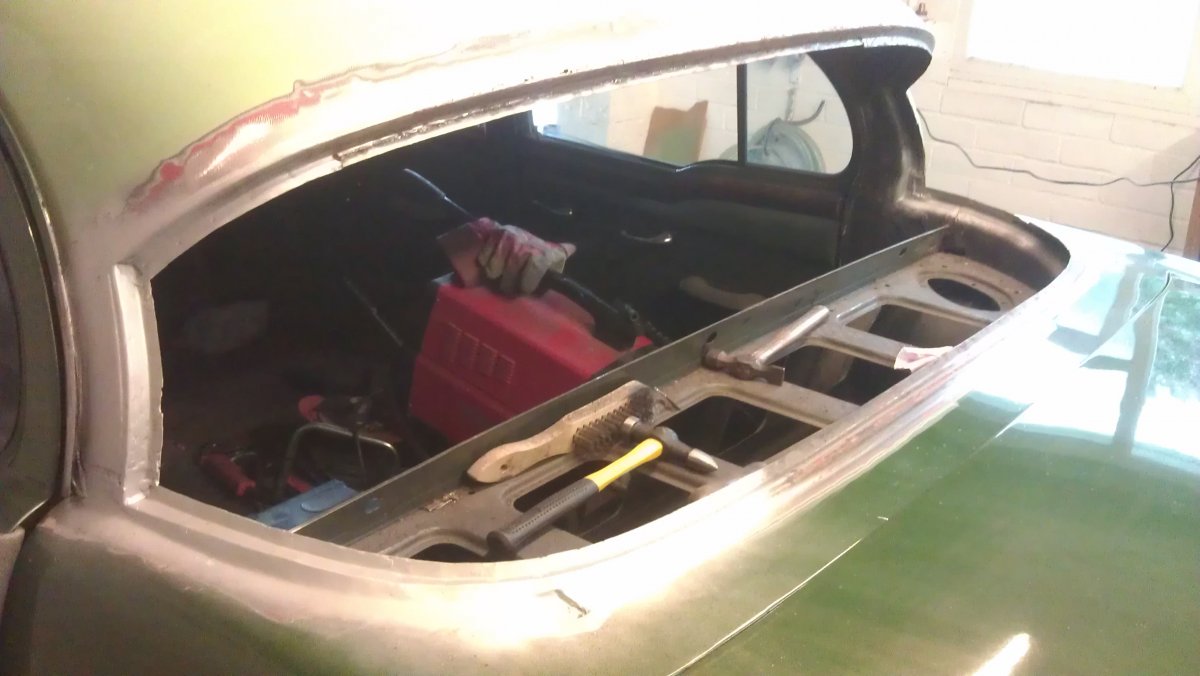

    The rear screen pulled out without any resistance at all... God knows how I managed to drive it the 100-odd miles home without it falling out.
    Once the seal was removed, I was faced with this lovely lot 2012-02-12 13.19.40.jpg
    After I'd swallowed back down the sick, I got to work removing the flakes...
    I guess water just sat there under the rubber everytime it rained. Even the top rail was all chewed up!

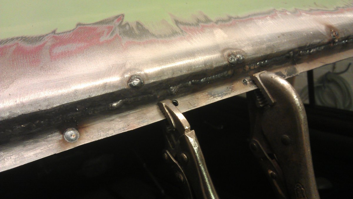

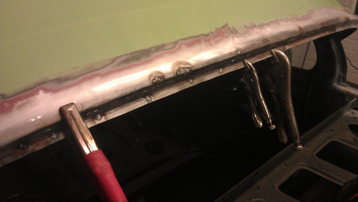

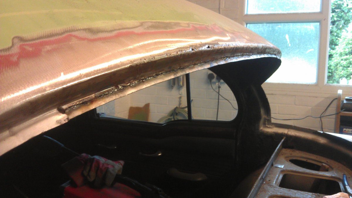

    I didn't have shrinker-stretchers, but I did purchase a copy of David Gardiner's excellent DVD (http://www.classicmetalshaping.co.uk/dvd/). He teaches a method of shrinking and stretching using something similar to a stonemason's hammer and heat... So I practiced a little , and got to work... Thinking as long as I kept the overall shape right, I should be able to fit the screen back in place once I'm finished... Pretty pleased with the results
    Doing little bits at a time, meant I could maintain the curve I needed, and as most of this new metal would be covered by the new rubber (I got the last one off the re-production line I think!) I didn't have to be too precious about making it all out of one large piece.
    The 'interior side' of the lip welded in place (more or less)
    Then, the 'exterior side' plug welded and finished off.
    Hopefully that should still fit the screen with the new rubber in place... Considering this was one of the first jobs I'd tackled on the car - you'd think I'd have the screen and rubber in place by now... Well, I wanted to get most of the tricky stuff out of the way so I could concentrate on bodywork later on...

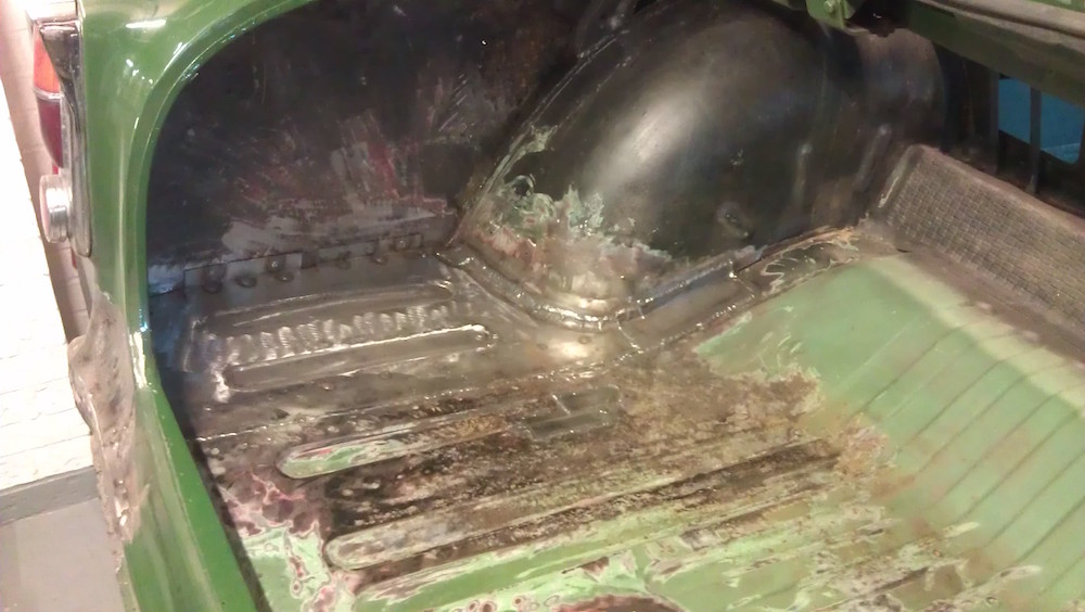

    Right, where'd I get to with this...
    Feeling pretty pleased with myself after successfully using some of the techniques I saw in David Gardiner's DVD, I thought I'd get hold of a stump, hollow it out a little, and tackle some more complex curves...
    Well, I'm certainly no Tommasini - but its better than what I started with...

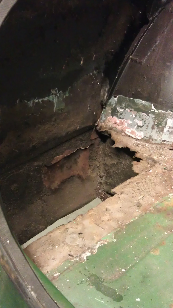

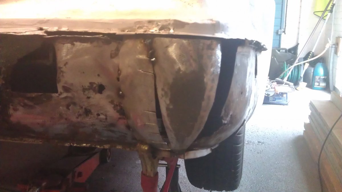

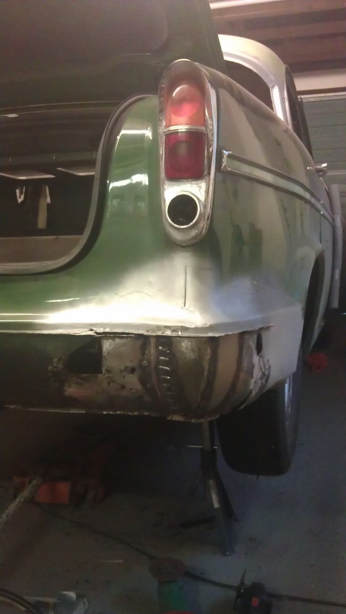

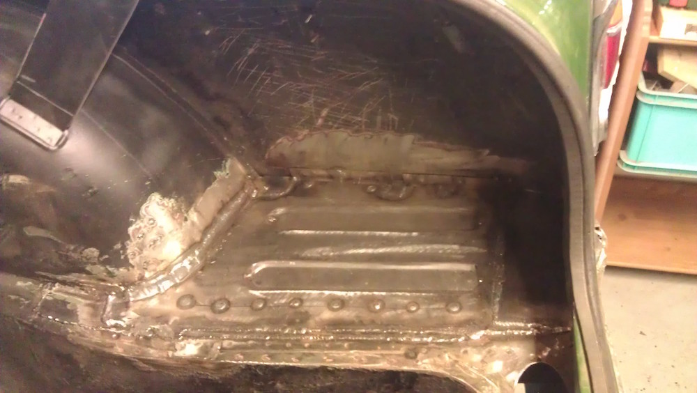

    So, I ground off the crap, underseal and riveted aluminium patches, and got to work... Kinda making it up as I went along, knowing most of this is covered by the bumper, and worst-case-scenario - I could just start over.
    I'd have loved to do this in less pieces, but I couldn't work out how with my limited skills/tools. I've got plenty of grinding discs anyway ;-)
    Again, not perfect by any stretch - but good enough, and certainly better than what was there to start with.

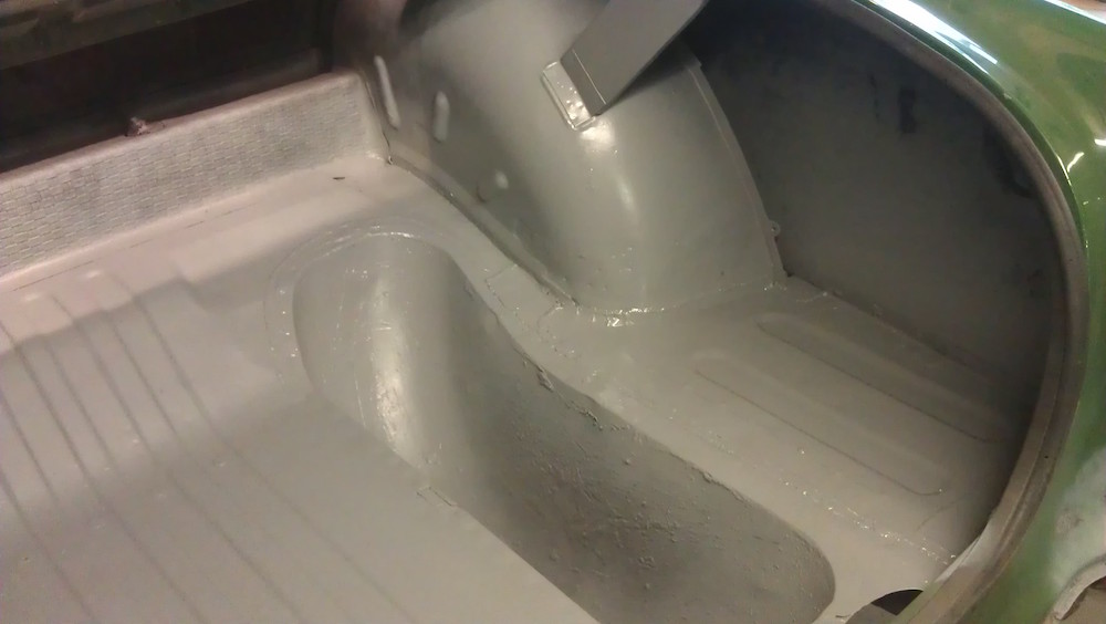

    At this point I thought I'd have the car back on the road quickly - so I started playing with filler, trying to get everything smooth.
    I'm definitely going to have to replace the centre-section of the rear valance (which sits between these 'bulbous' corners. I was thinking something along the lines of a Jag XJ6 Sill panel (assuming I can get hold of one cheap enough).
    A little more high-build primer, and a little more filler gives acceptable results for now...
    IMAG1026.jpg Looking back at these pics - My skills and attention to detail have moved on - I'm going to have to address the bottom edge of this rear panel at some point...

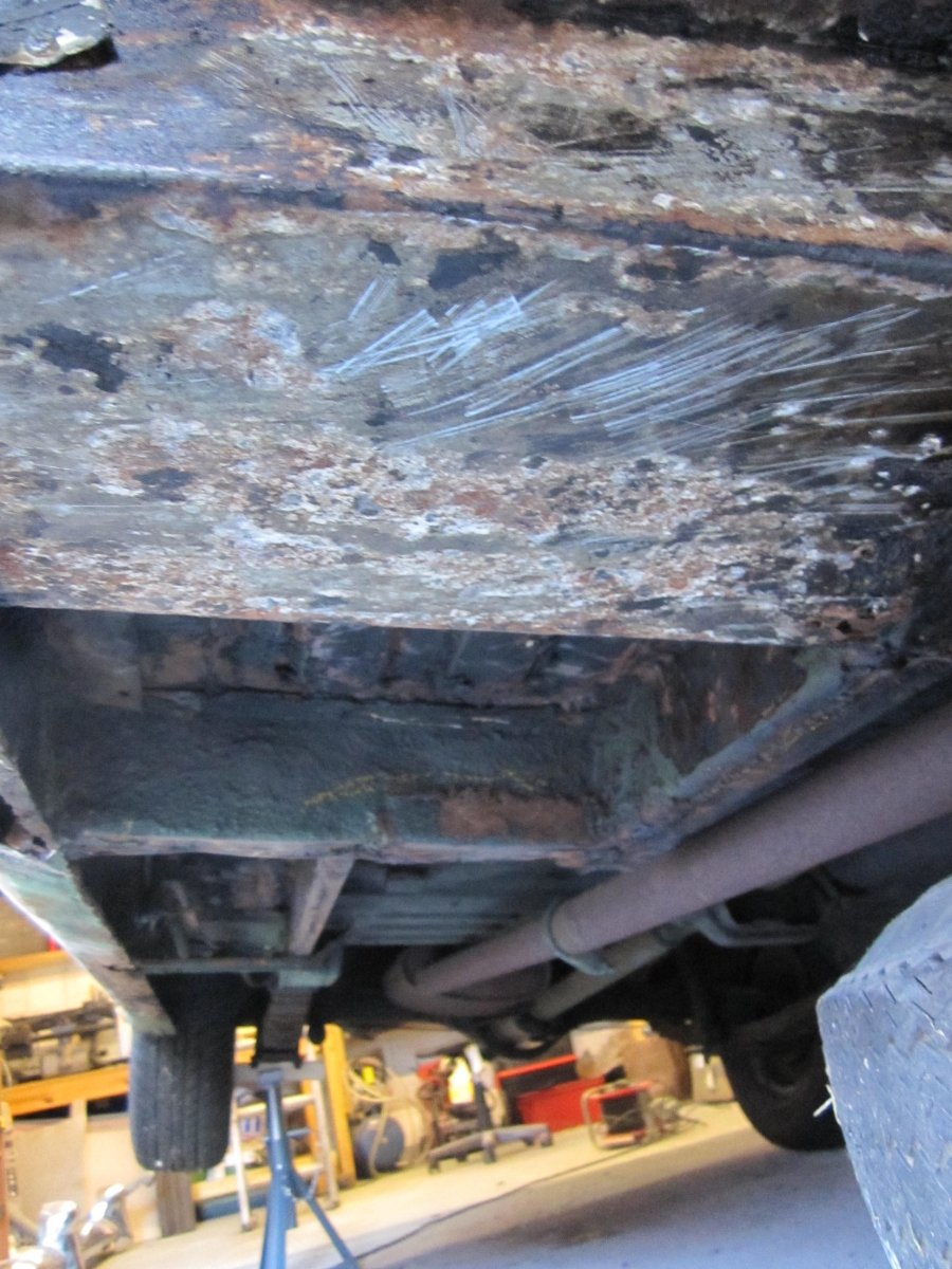

    Looking at these pics, you'd think I never even looked under the car before handing over the money... (sorry for the crap pics - my vision must have been at least this blurry when inspecting it at the previous owners!)
    The yellow marks are where the MOT inspector found it to be 'unsatisfactory' as far as repairs go... I'll give him that.

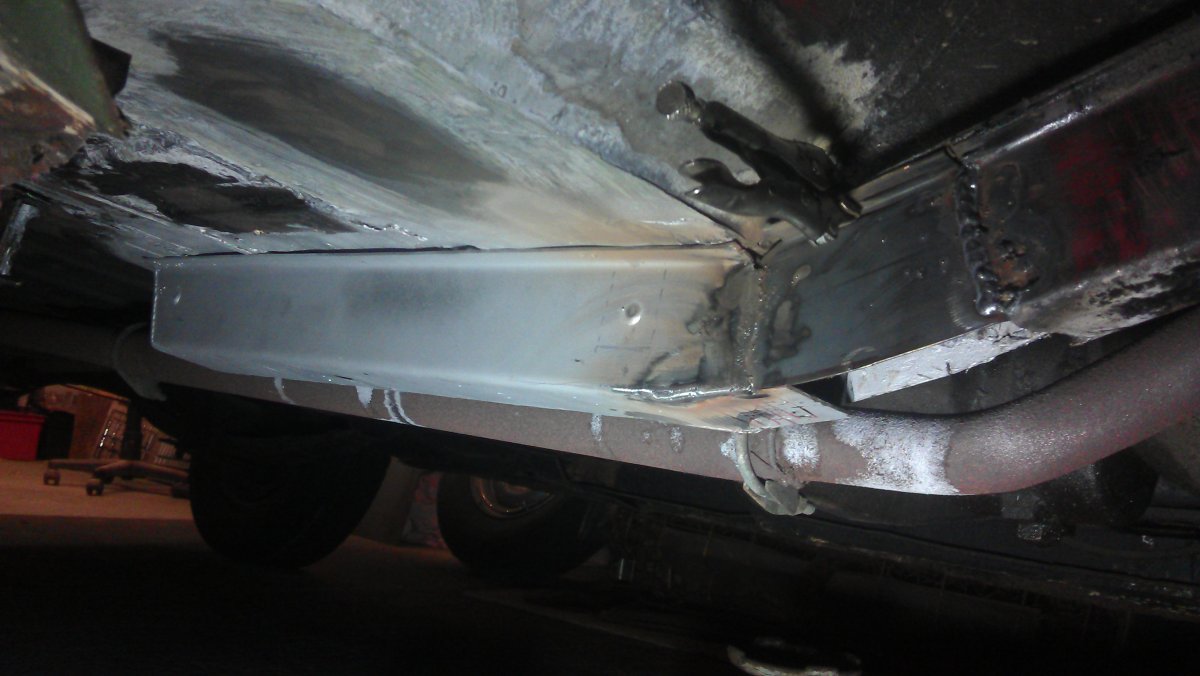

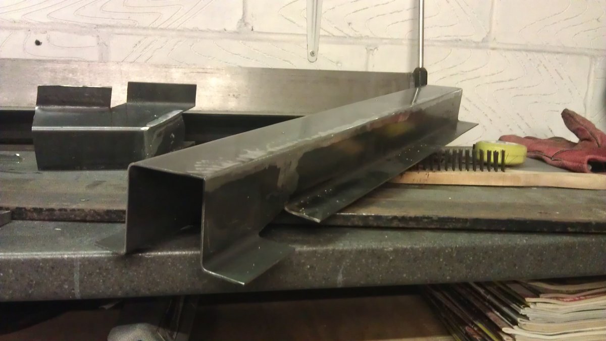

    So, thinking I'd replace only what needed replacing - I set to work making up a sort of 'top-hat' section to replace the longitudinal frame rail that kind-of forms the front subframe.
    My understanding is that with this car being an early monocoque design, it had very simple front and rear, fixed subframes that were more or less like a full front-to-back frame, but with the centre missing, and the sills taking over the load in the middle.
    (Here's a pic from the Workshop Manual to better describe what I mean)
    Anyway, here's what I did...
    IMAG1070.jpg I made this piece up in cardboard first, then transferred to 1.2mm cold rolled steel.
    I then added a couple of braces, with nuts welded to them, so that once positioned under the floor, I could bolt them through, and pull this new section up to the floor - then plug weld it in place.
    Skipping ahead a little (a lot!) here's the driver's side subframe 'leg' more or less in place. I struggled to get the metal clean enough where I had to join it to the existing rail - so I ground it all out and started fresh after this pic was taken... Live and learn right!
    Now I had a good, clean, straight starting point from which to build outward towards the sill. At this point I was simply going to replace the crossmembers that join the inner sill panels to this subframe 'leg' but a bit more digging, and I found this...
    Kinda reminds me of those pictures of the Titanic after all these years of being at the bottom of the ocean... I think that's where this might have been parked in a former life!
