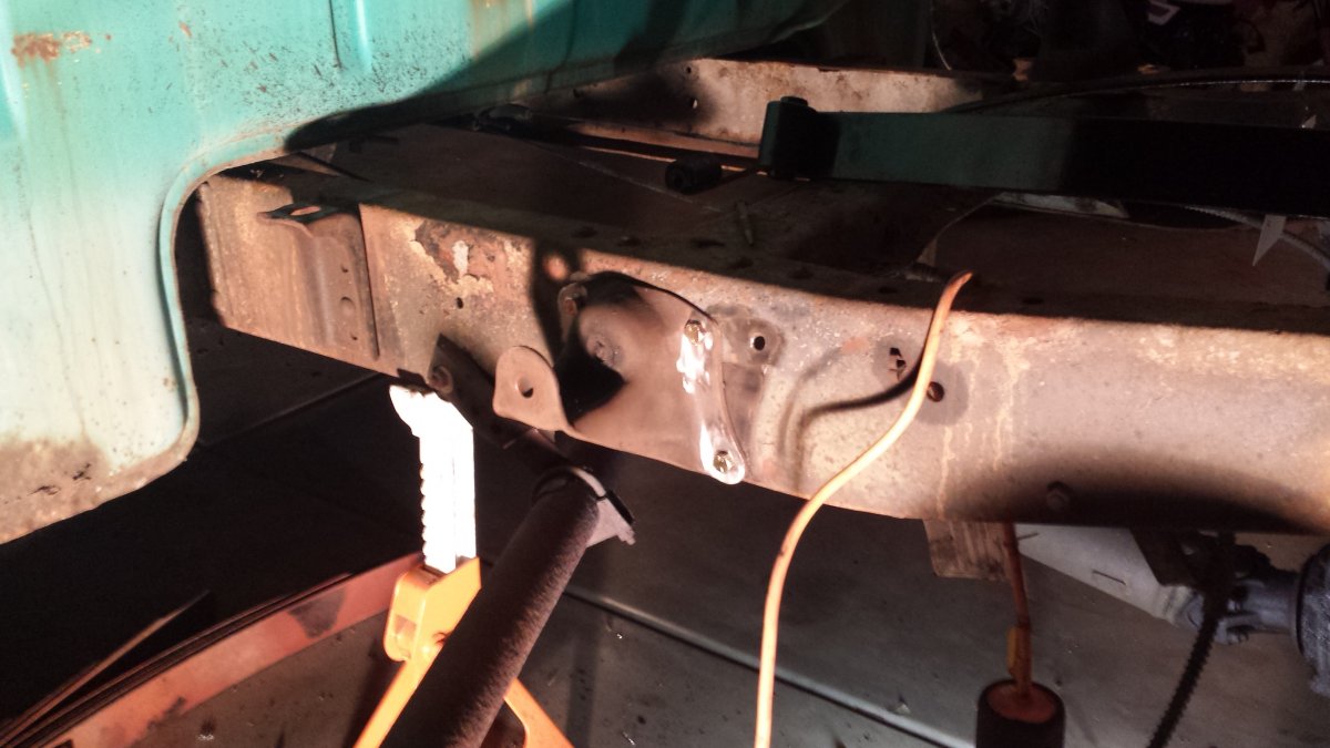

    A few more pictures with an update. Picked up Sid's front axle and the install went great. Very straight forward and the 3 inch drop really put it where I wanted it to be. I turned my attention now to the rear. After talking with Sid I decided to get the main leaf spring's eye reversed and to flip the front (rear front) mount and keep the leaf springs on top of the axle. Should have it all back together this coming weekend...of course that's what I thought would have happened last weekend. 20160206_121629.jpg 20160206_135327.jpg 20160207_132119.jpg

    Just a quick update. Picked up my main leafs yesterday after dropping them off at a local shop. I was going to reverse the eyes myself but a local shop only charged me $65 to do it so I couldn't pass it up. Last night I had a chance to work in the garage last night for a few minutes and mounted the front hangers. I was able to use two original holes and just had to drill the other two. Should be able to hang the new leafs tonight and get the truck on the ground, really interested to see how low it sits with the reversed eyes and complete leaf pack. hagner.jpg

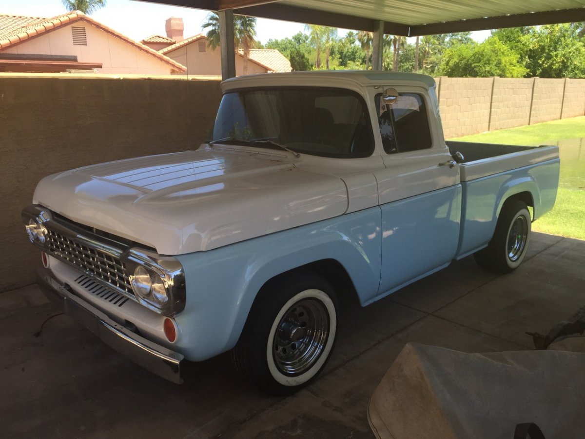

    Got the truck back on the ground this weekend and the new wheels and tires on. I decided to go with the Artillery style wheel mounted to a Coker Classic with the large 4 3/4 white Wall. I personally like the look and since the truck barely goes over 65mph the bias tires really don't create a handful on the road. I am going to drive it a bit this week as it is but I will most likely pull a leaf out of the rear (still running the whole pack) to drop it down just a bit. f100.3.jpg f100.4.jpg

    mine is available, side of 58.jpg 58 pu gd.jpg $12,500

    Super easy process. You can use two of the existing holes which makes it easy to drill the other two holes correctly. You will want to use the two holes that is farther away from the cab (closer to the rear of the frame), made the mistake of using the other two and it pulled the axle way to far forward.
