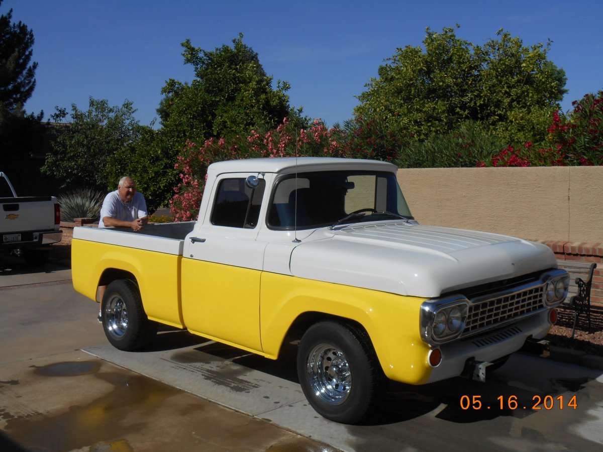

    You may be correct, But I had some made in Phoenix, Az. Cost over $500.00 I feel they were too long, because the front shackles went from about 80 degrees to flat, took them back and the "man" said we built them to "specs" you wanted them de-arched, they are, make them work. Well, if I was 45 years younger, I would have tried to stick one up his "back hole."
    Its been three years and I am still "pissed' and I own $500.00 worth of springs that didn't work for me. On the phone I had ordered springs to fit a 1958 Ford PU, front, de-arched to lower truck 2-3 inches. So I accept that is what I got. when you flatten stock leaves they "grow" I just didn't realize I would not get a shorter main leaf.

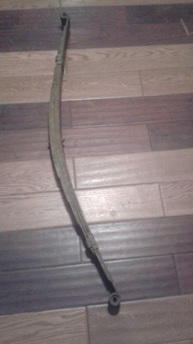

    I have a pair like this had them on my 59 I'm in los Angeles
