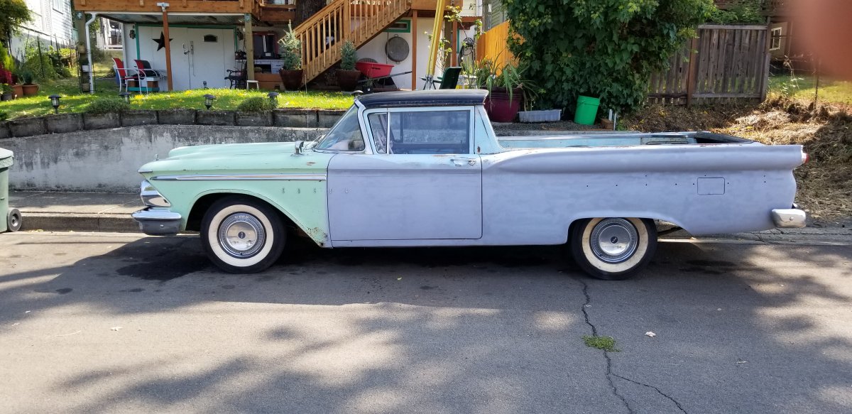

    There were no Edsel Rancheros. There a a number of Edsel-Ranchero conversions out there.
    Here's another one

    The later FE blocks retained the old motor mount bolt pattern in addition to the new ones so old style motor mounts will bolt right on.I've also seen examples of the edsel ranchero and they were all conversions either edsel wagons that had been converted or ranchero's that had edsel wagon quarters and front clip installed.There were a few 1960 Edsel Starliners built,I personally saw one and have seen sales literature depicting them.

    it would seem that the conversion uses an Edsel wagon tailgate. looks cool!

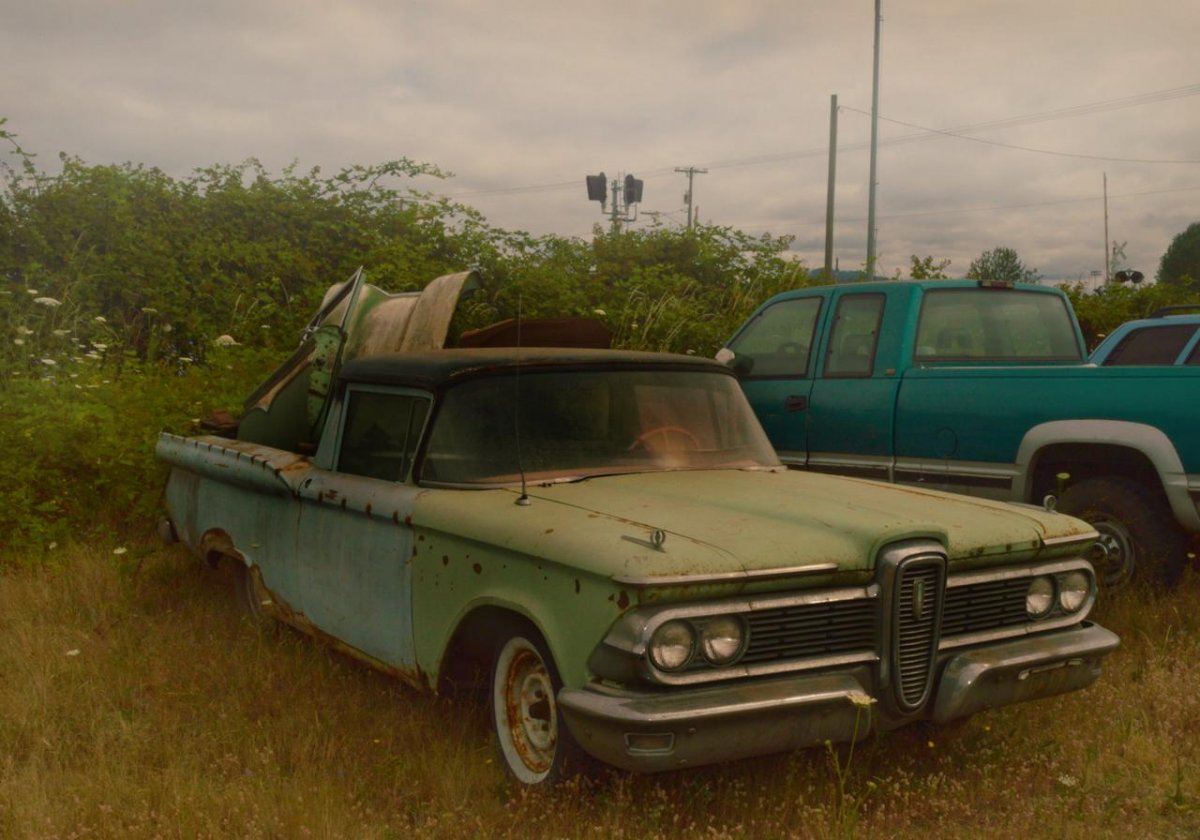

    Last picture is how I found it in a wrecking yard

    I had been frequenting this yard for years. They had a 58 Ranchero with an Edsel clip on it 20+ years ago, but some very major damage. I always thought M-E-L should have done it factory, but giving what I now know about the whole Edsel snafu, I understand why they didnt. Step up to five years ago. I was wandering around looking for trinkets, and I spot this against the fence. I made a bee line. I was all over this thing. My buddy thought it was cool. We were dismayed because this yard makes their money selling parts, not cars. Oregon law is pretty sticky about wrecking yards selling cars. I can be done, but the guy doesn't want the hassle. I asked him about it. He was storing it for a friend who fell on hard times and lost his shop. I asked if he'd sell it. "No".
    Over the next few years I visited it often, watching it deteriorate. Now the hood was stuck shut, some pueces had been pilfered, bodywork was needing redone and it was sinking into the ground.
    Once again I asked if the guy would sell it. "Yes" was the answer. He gave me his number and a deal was reached. I brought it home in June. My wife had seen pictures, but the reaction when I pulled it up behind the house was less than positive. She looked shook her head, and left me with my new prize.
    The car started out as a 1959 Ranchero purchased as a parts car from the very wrecking yard I bought the car from. The PO was an Edsel fan AND a body man at the local Buick dealer. He took the Ranchero body off the ford frame, and grafted it onto a 1959 Edsel Villager wagon frame, using the floor pan, cowl and front end of the Edsel. It has the Edsel dash, sheetmetal, suspension...even the Edsel V8 and Auto. Titled as a 1959 Edsel pickup. Complete with the rear quarters, tailgate and rear bumper from the wagon. Factory radio, power Steering, power brakes, electric wipers, windshield washers (with Edsel bag) and Edsel hooded mirrors and a set of Edsel spinner hubcaps.
    It needs a ton of work. Every system needs to be refurbished, but I think its unique and it keeps the previous owner's dream alive. BTW my wife has forgiven me, lol
