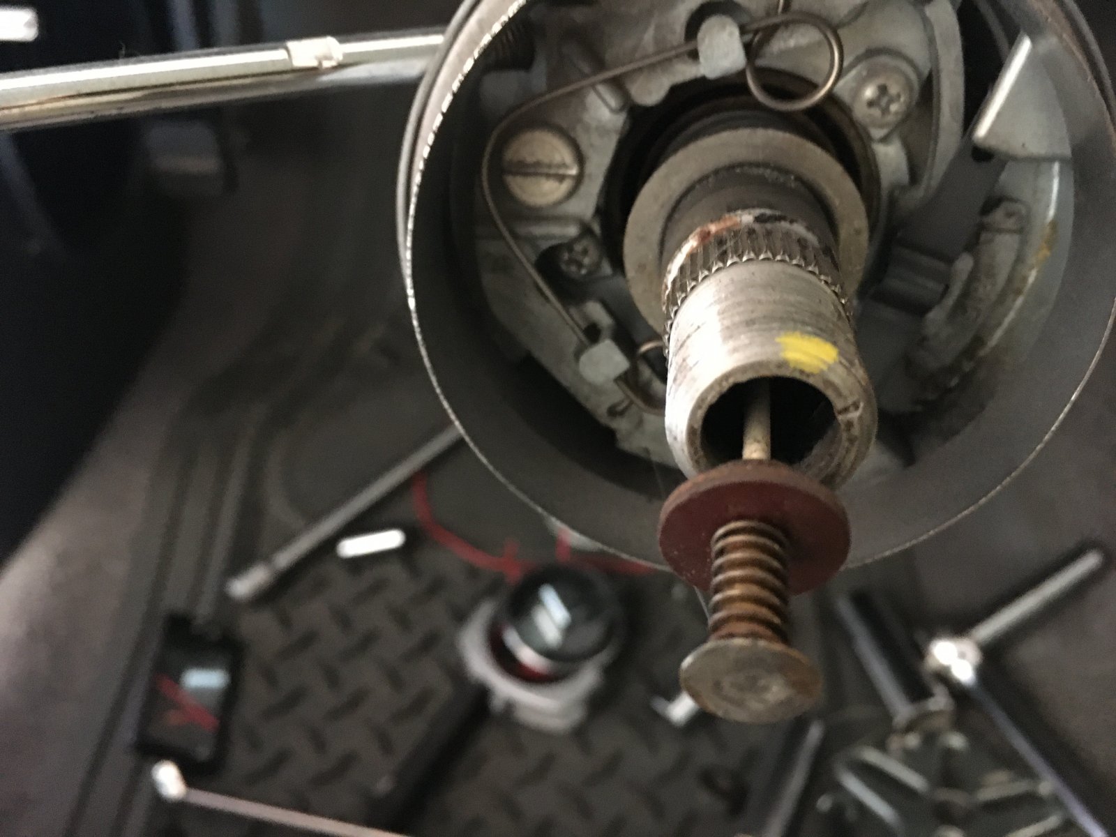

    Thank you for all your help. I forgot to mention that I checked the relay and removed the steering wheel. I have to work in the next 3 days and I will take your advice and check the electric again. I restored 2 steering columns from GM cars from the 70"s , but the 59 Buick is different. I will upload 3 pictures The horn wire comes out in the center of the steering shaft. On the lower end of the steering shaft is a switch with a contact to a brass ring inside the shaft. I belief Cadillac did have the same setup. so how the the wire connected to the brass ring?

  10. goldmountain
    Joined: Jun 12, 2016
    Posts: 4,476
    goldmountain
    Hopefully, the problem lies in the harness before the steering column. Pinched wire,easy fix. Somehow, I doubt that. I'm from the 70's street rod era where we ditched the old steering columns for fancy tilt columns so I'm of limited help. With the wire coming in from the bottom of the column, it would need a brush type contact to overcome the problem of a steering wheel that rotates. That would be that brass cylinder in your picture. The spring loaded contact would need some sort of insulator to keep it from grounding out and honking the horn. Start looking there. You probably will have to fabricate parts.

    Thank you for your help. I wish I had pictures of the parts in the steering.

    The wire goes inside the steering shaft and is soldered to the brass ring, which is on top of an insulator to keep it electrically separated from the steering shaft. The steering column tube has a spring loaded wiper that rubs on the brass ring with a connector on it.
