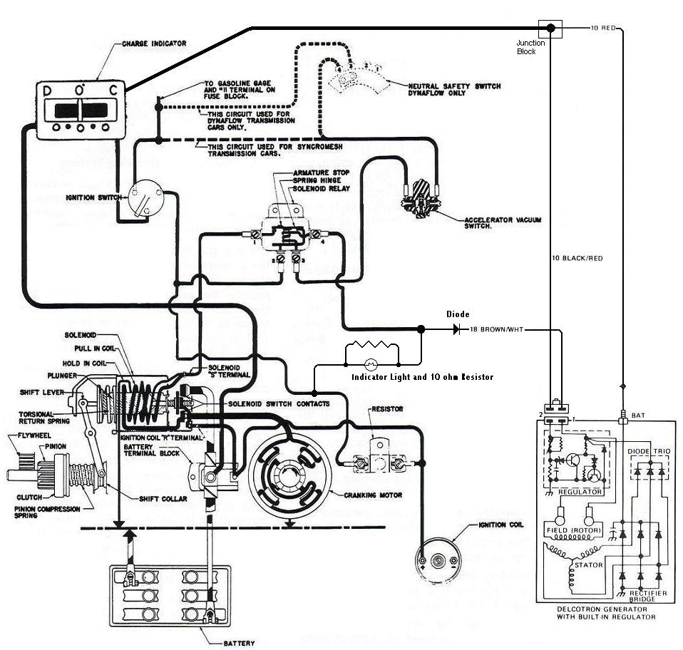

    I have a 1959 Buick Le Sabre. I like to convert from a generator to an alternator. I bought an alternator bracket from a 1964 Buick Riviera and a new Remy mid-1980s GM B-body (Electra, Delta 88, etc) with the Olds 307 motor used a 78 amp 12SI alternator.( voltage regulator mounted internally ). Does anybody knows how to wire the new alternator on a push gas to start 1959 Buick ?
    Is there a wiring diagram ?
    Thanks for any help

    Thanks so much for the info BJR.
    For my other 3 friends. I know that a generator will be fine to, if you use the car for weekend drives. I you the car for business. (wedding ,wine tours etc.) I rebuild the generator ,but with slow driving, Radio, Air etc the generator will not work good enough. One other problem is ,that in Canada you can't go to Nappa and buy parts for old Buick’s .Every thing has to be shipped from the USA. Shipping is higher than the part. I will keep the generator

    Basically the vacuum switch on the carburetor is grounded through the voltage regulator and when the engine is running will not complete the ground circuit to prevent engaging the starter. I just wired around that to ground and never had a problem since the vacuum switch also cuts off when the engine is running. If the vacuum switch ever got stuck it might cause a problem and that was what the regulated ground was to prevent.
