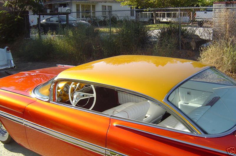

    This one looks good:
    Seems like the lower part of the rear window frame was removed, is the window lowered? Looks like there is no package tray.
  7. J; Have you done much Custom body work? It's a large learning curve for sure. The car above looks to be headed for some issues to me. Photos can hide what's going on. By the looks to me I believe the rear glass needs to be move to the rear meaning a band added to lengthen the over all roof panel to get things where they belong. If that's the case and it were me I would probably do it right where door glass and quarter window come together on the Drip Rail. You don't want to get into building new Quarter glass window frames, Just shorten vertical leg and re arch top frame to match drip rail.

    This one's nice. I would hazard a guess the stock window has been sunken.
    It would also appear by the angle that the rear corners of the windshield were trimmed, and then laid back...something you want to consider.

    I´ve chopped two cars, so I know what it takes. To me it looks like the gray car has a original length or shorter roof, as the roof on orange car looks longer.
    Now You know why I could use some project pics / info on the subject :D

    On the grey car, a filler piece can be seen added between the trunk and the rear window (sometimes called the "cat walk").
    The orange car may have added this amount to the roof, instead.
