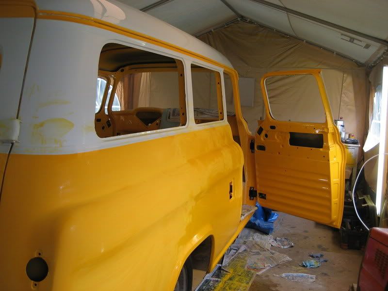

    Anyways after color sanding and polishing the roof it was time for the interior to receive the treatment.
    Then it was the outside starting at the top going down

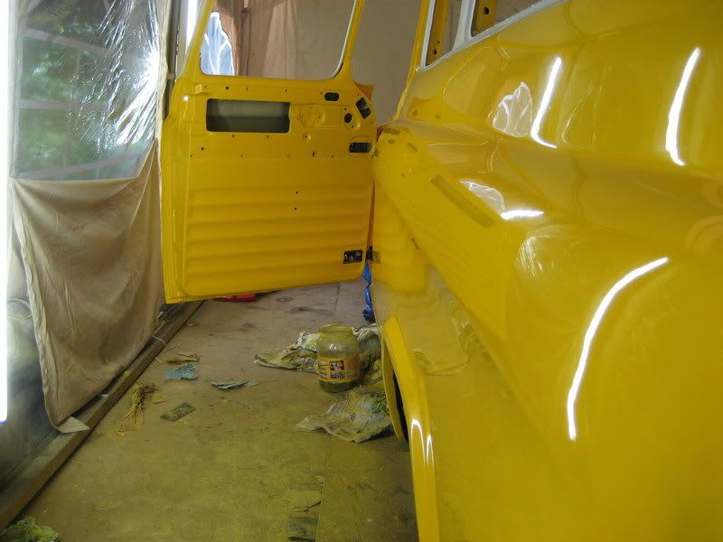

    Here is the passenger qpanel at various stages of sanding
    Did a test polish to get some inspiration (this is just a first fast cut with wool mop, not subsequent with fine cut and anti swirl).
    On to the rear doors
    And then the rest of the car until everything was color sanded. Then it was time for buffing work. To be honest I don’t know at what stage the pics below are taken but I think they look good :).

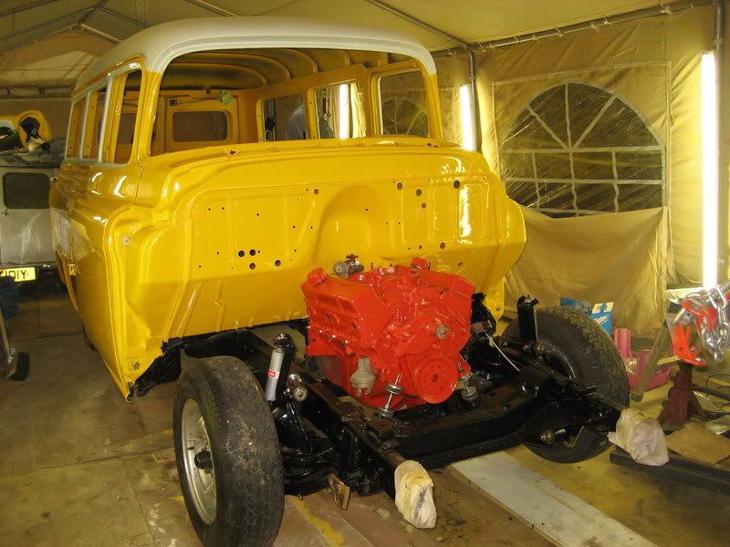

    Time to get the running gear in there; this my test engine and I will most likely change it later. It all depends on what happens when talking with prospective buyers.

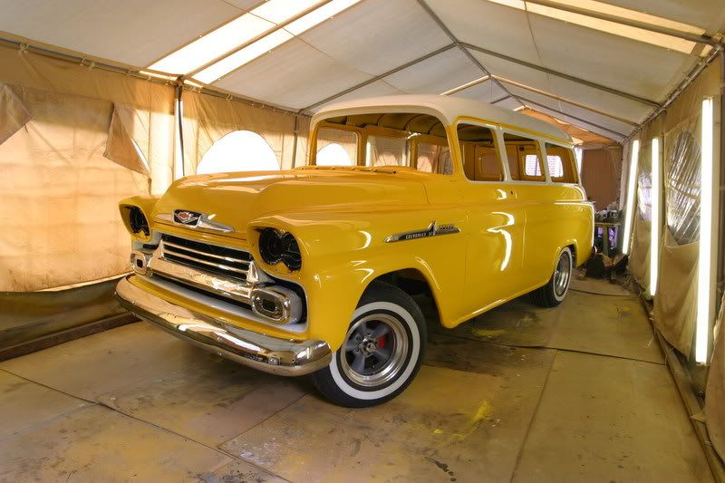

    Anyways after fixing things such as the steering rack it was time to get the front sheet metal assembled. But first a look at the new wheels :), got to say I really like the looks of the American Racings wheels with the whitewalls, the grey center is also something that later comes back in the interior color of the Burb.
    Here is the full pi of the front panels it’s buffed already here:
    Ah yes got the chrome back, it’s nice when it’s the original stuff that has been chromed. Anyways some further pics of the front end..
    It should be noted this is single stage solid paint and not base and clear coat, if it was the shine would been even deeper

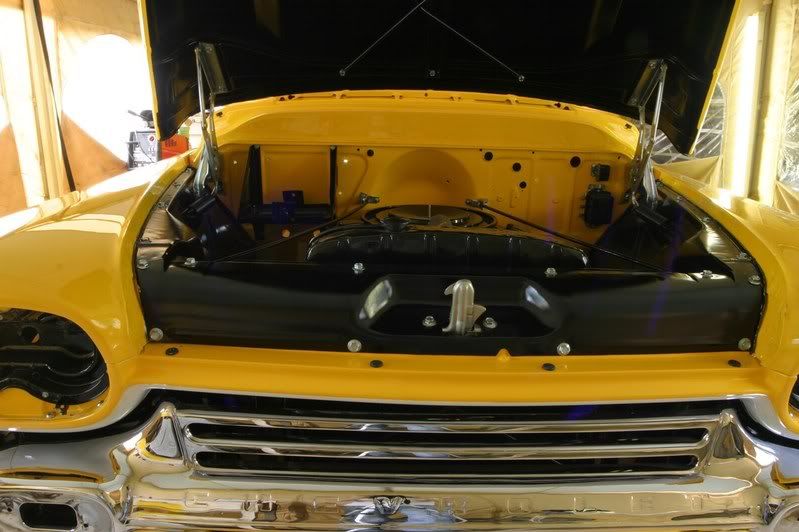

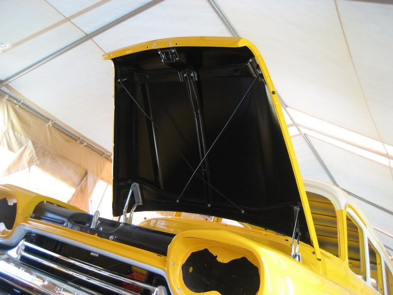

    Think the GM std under hood black primer looks really great when contrasting the yellow paint. (It’s not primer of course but two component polyurethane acrylic with matting agent to get the right egg shell look.

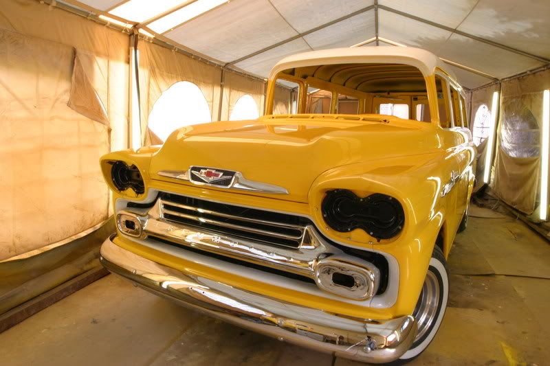

    So it’s pretty much assembled on the outside now, well it’s not 100% adjusted and there are still paint imperfections (nicks etc) to fix but I will do that at the very end you never know when you drop a wrench on something. But I thought it would be time for some sort of picture cavalcade to show it all off:

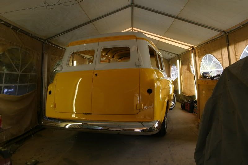

    The rear end ;)

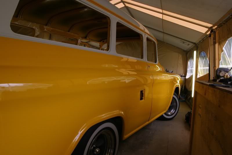

    Passenger side Qpanel:

    hehe time to get the hood up

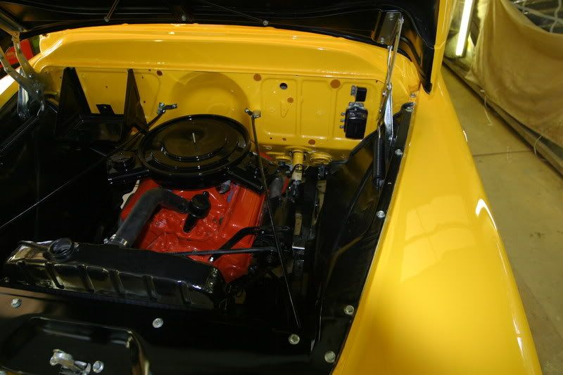

    I really like that you can’t really see the Jag front end it’s all pretty stealthy. The big air cleaner effectively hide the Holley projection fuel injection and the stock painted Edelbrock performer intake :).
    As you can see it’s all (99%) stock factory correct bolts. I know it might not matter to much on a hot rod but the original bolts make it look more authentic and there by adding to the feeling is this original or not feeling. Yes of course we will change the oil filler cap it’s dented!

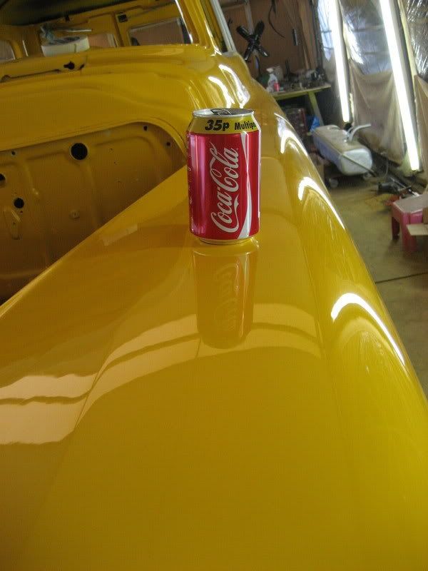

  25. Cool burban! Keep it up. Doesn't the can of coke drive you nuts on the new paint?!
