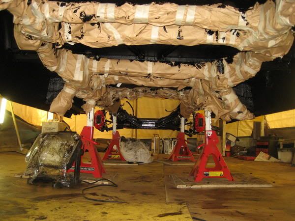

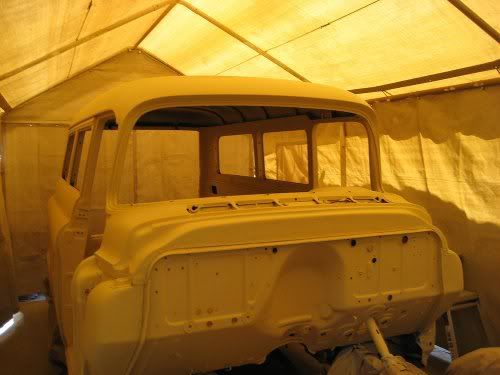

    And then into etch primer followed by high build primer. I was pretty lucky with the Burb, CA Burb so minimal amount of rust. There was just a few pinholes in the bottom of doors, and rear quarters. Easy fixes in other words..
    Then it was time to get it all strait and nice:
    Then followed some painting :). I settled for golden yellow and white, didn’t want a color combo that everyone else has.

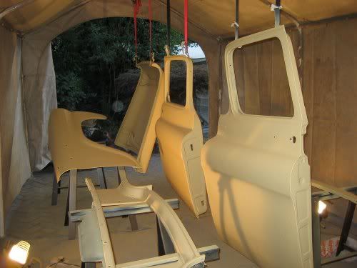

    Then it was time for doors and fenders to get treated, So back to metal again
    Followed with some primer:

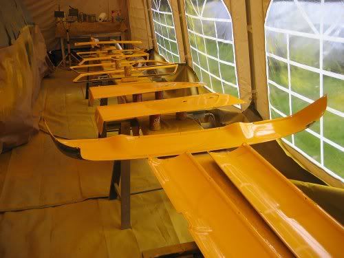

    Then I had to get around to the small bits that where supposed to get yellow, loads of it, metal first as per usual:
    Then primer and body work, before I finally could paint it:
    Really love that black, yellow, white combo.. its going to be so pretty..
    The contrasting under hood black to the yellow aint to wrong either..

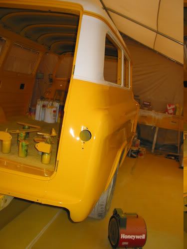

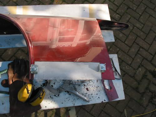

    Continue of the story as promised.. It was now onto the doors and fenders.. We are fixing them here.. not much to do really. New door bottoms and a bit of welding in the lower corner of one fender.. This was a pretty nice day during last fall:
    What took a lot of time was to redo the body. It was not strait mainly over the wheel openings. It was the same very shallow low above the wheel openings on both side. I think this must been due to pressing issues and I also guess it wasn't that important on a Burb. It's not much at all and you will not notice it unless you start looking very closely. The second thing I wasn't happy with was orange peel. I had called up the paint supplier after I painted the first time, and they had given me the wrong paint mixing ratios with too little reducer resulting that the paint didn't flow well. I should have rectified that my self from experience but sometimes you get stressed. Anyways when getting the new ratios on the small parts the paint flowed very well. So I wanted to repaint the body getting a nice and even flow with a minimum of orange peel.
    Here we are fixing the qpanels once again.. I have to say I love my very long AFS sanders. Don't think I would be able to get it strait otherwise.
    Then it was time for paint both body, fenders and doors..
    The result was a lot better, and the side was strait at last:
    [​IMG].
    The paint flowed well and over all I was happy with the result, a few runns due to low temperature when painting, and being a tired amateur painter :).

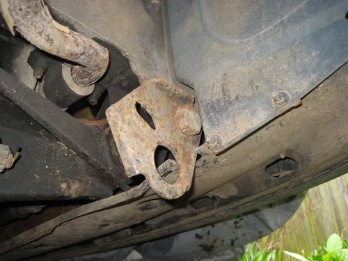

    Since we intended to hang the axels in there original mount points we cut out both the front and rear frame rails, here is the rear one.
    It's a good idea to take them since they are reinforced inside

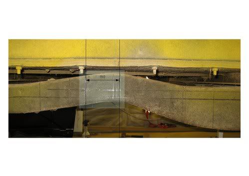

    We now turned our attention to the rear end, it was some measuring here too :)
    It's all about figuring out where the the two mount holes should be relative to the frame rails,
    When you know that (will write about it in the article), then you can simply scribe it on the frame rail.

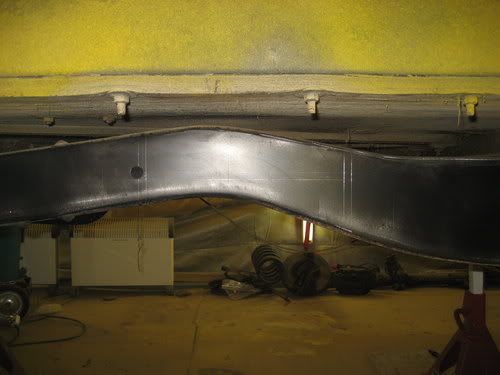

    What is needed now is a pair of new frame rails (I will provide drawings you can print). I've printed out the drawings and glued them to the 3mm sheetmetal so I can make new frame rails out of them.
    The new frame rails are now combined with the original Jaguar once and the threaded bars are attached to the mounting holes. That way you can align the mouting holes with your scribe marks on the old frame rail.
    The threaded bars also makes sure you get the exact right distance from the old frame rail. The main problem with the Jag IRS is that it's a lot wider than the Taskforce frame.
    You can now easily weld it all up. The Jag IRS need a mounting for the radius arm too:
    The advantage of haning the IRS in the original mounts is that it will self steer (rear wheel steering) when the body is leaning. This due to the flexibility on the bushings. This self steering will stabilize/ self correct the car when it's for example hit by a side wind or you sneezing.. All in all it makes for very relaxed stable high speed driving. (as a side note this is not the kind of behavior you want in a race car, or a car you want to be cornering as it was on rails, then you should not mount it solid in the frame but more about that later).
    When the new frame rails are done you can simply cut out the old one. We welded on end plates on the old rails that also are connected to the new rails to give extra stiffness. Notice the cross member just forward and rear of the new rails. It's important that you brace the frame from the twisting forces.
    You can now mount the IRS..

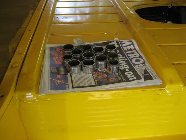

    [FONT=&quot]Plating the old bolts is a good way of saving, plated a load of parts and it was all in all just $150. Note: Don’t plate any springs they will break most of the time sice they become brittle. We bought new springs for the parking brake assemblies.[/FONT]
    [FONT=&quot]Restored the brakes too, I know it’s cheesy but red was the only caliper paint that had that day. Well it looks pretty nice too I have to say even if it doesn’t make the Burb stop any quicker[/FONT]

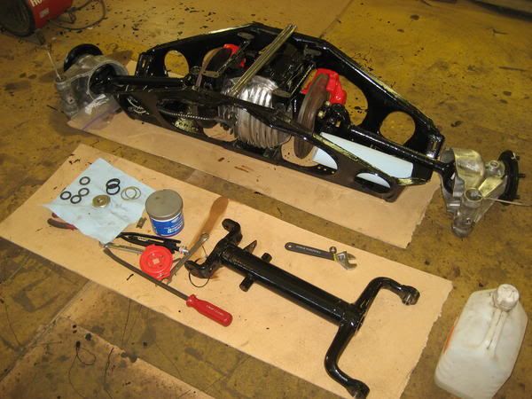

    [FONT=&quot]Time to restore and put together the rear axle…[/FONT]
    [FONT=&quot][​IMG][/FONT]
    [FONT=&quot]Looks pretty good when finished[/FONT]

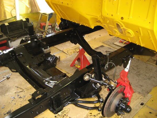

    [FONT=&quot]After that it was the front axle [/FONT]
    [FONT=&quot]Before I hanged up the rear axle I undercoated all sheet metal and plywood under the car. I use WaxOyl, a super undercoating with wax mixed in, it never really dries but instead stays little tacky and very waxy. [/FONT]
    [FONT=&quot]The frame looks like it’s a Xmas present out of a Disney cartoon ;).[/FONT]

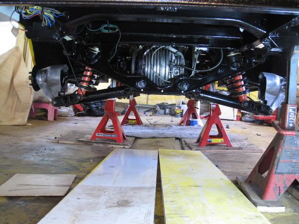

    [FONT=&quot]Time to get the IRS up under the Burb, I’m pretty happy with it’s looks. The orange Koni looks good even if they are a year old. Robbed another Jag I have of them ;).[/FONT]
    [FONT=&quot]Notice how the parking brake cable is routed the same was as the original truck parking cable. Combining the Jag parking brake cable with the Chevy truck one is very easy as you will soon see.[/FONT]

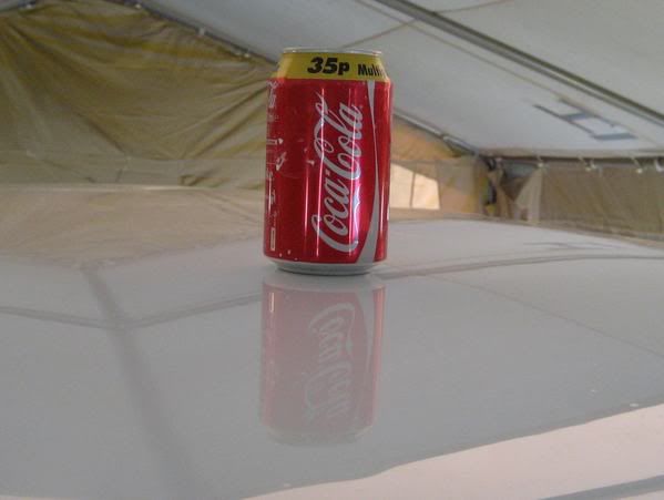

    [FONT=&quot]Time to start sand a buffing the roof, here we are half way with the sanding.[/FONT]
    [FONT=&quot]Here the polishing is nearly finished[/FONT]
    [FONT=&quot]Here it’s finally finished [/FONT]
    [FONT=&quot]I’m very happy with the result, when I painted the roof I know it wasn’t 100%. I’m too short and can’t properly reach the middle with my gun when I’m balancing on a high platform. That I got it this smooth and shiny made my day.. [/FONT]
    [FONT=&quot]Hmm that’s it for now Folks, [/FONT]
    [FONT=&quot]Burbly Dyna[/FONT]
