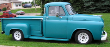

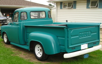

    Years ago, I did a 54 Dodge pickup with a Volare clip. We drove that truck over 44,000 miles before I sold it to buy something else. Of all the rides I ever sold (lots of them) that 54 was the only one i really missed. It drove great, rode nice, and had awesome brakes. If you got a little frisky through corners, the suspension was a little soft and as far as adjusting the ride height by tightening the bars up, forget it. The bars are too soft, they will raise the front end up for a couple months, then be right back where it was. Soon the adjustment is gone, and the ride height is the same as it was to begin with. My truck had the biggest front sway bar I could find, it would break the link bolts almost yearly. All the bent bars support the same weight, there is only 1 to choose from (least there used to be only 1),
    I used the info in the Tex Smith book to do mine. You determine the front end ride height by where you splice the tubing on to the original frame. In the book, Tex suggests you mount the 2 x 4 tubing on top of the original frame for a low front end. That, in deed, is very low. I mounted my tubing 1" into the original frame, I cut the top flange and dropped the tube down so the top surface was 3" above the original frame height. Even then, the bottom of my front bumper scrapped the road a lot and would not clear parking blocks. The leading edge of the running boards is another place the contacts the road surface with a low truck. The front edge of my running boards was the height of a 12 oz Pepsi can, and they too were pretty beat up. Running boards are a pita to try to straighten. Were i to do another Volare clip, I would sink the tubing 2" deep in the original frame. If you mount the tube flush at the top of the original frame, the truck would likely be pretty close to the original ride height.
    Another thing I did differently from the text Smith book was I extended the pieces of tubing that spliced onto the frame 2" longer. That moves the front wheels forward in the wheel openings, but makes connecting the steering a lot easier and improves the steering shaft angles.
    The 360 I ran was mounted on the Volare engine mounts, and required cutting the firewall. I had a 6" deep cutout that was the width of the engine & exhaust manifolds. That puts the interior side fairly close to the passenger edge of the dash. Someone sitting in the center of the bench seat had very little foot room, but the driver and passenger seats had plenty of foot room.
    I ran the truck with 15 x 7 white spoke standard offset wheels for a while with 215 75 x 15 tires and they tucked inside the fenders nicely. Towards the end, the truck had the 15 X 7 Mopar police wheels with a little deeper offset (wheel stuck out a little more) with 225 75 x 15, those would rub just a bit on the fender lip, if the wheels were turned sharp through dips in the road/ground surface. They put the tires close to the fender lip.
    All the pictures i have of the truck. Gene

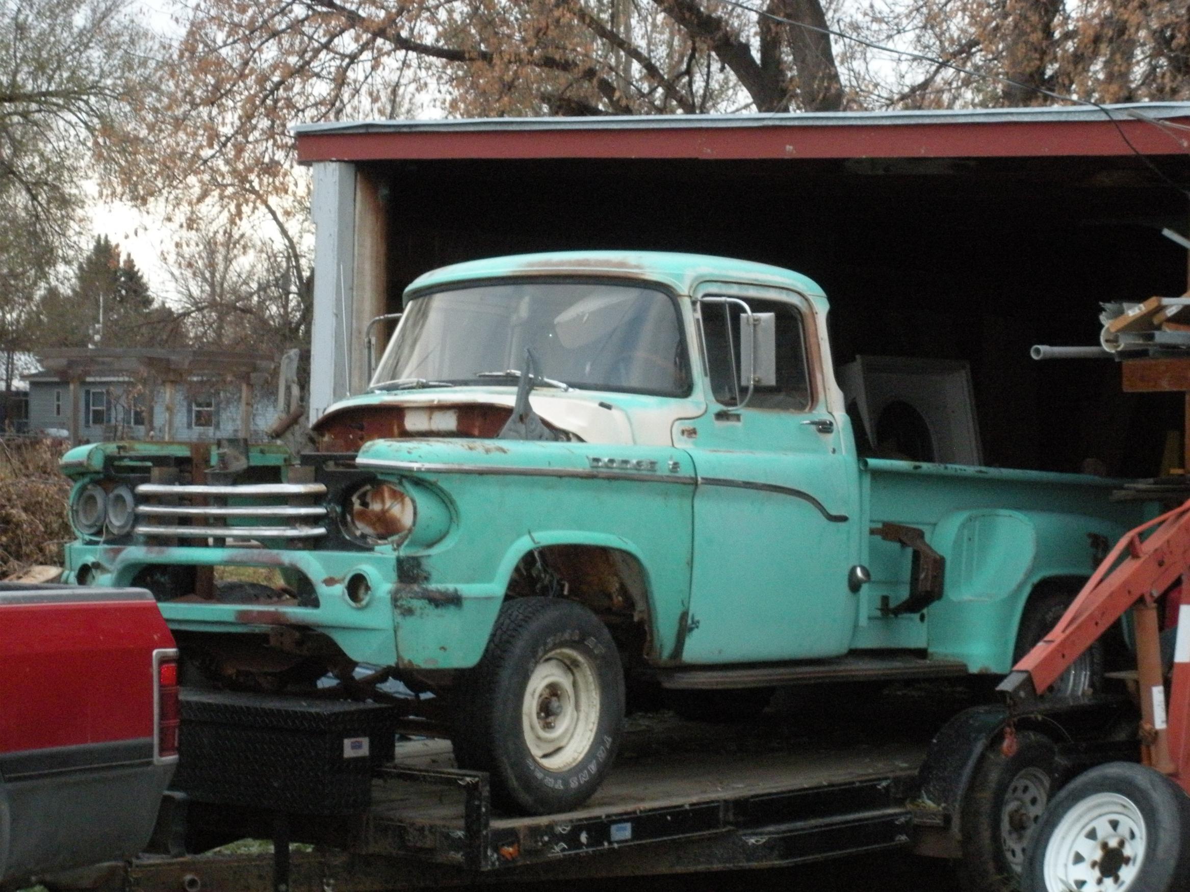

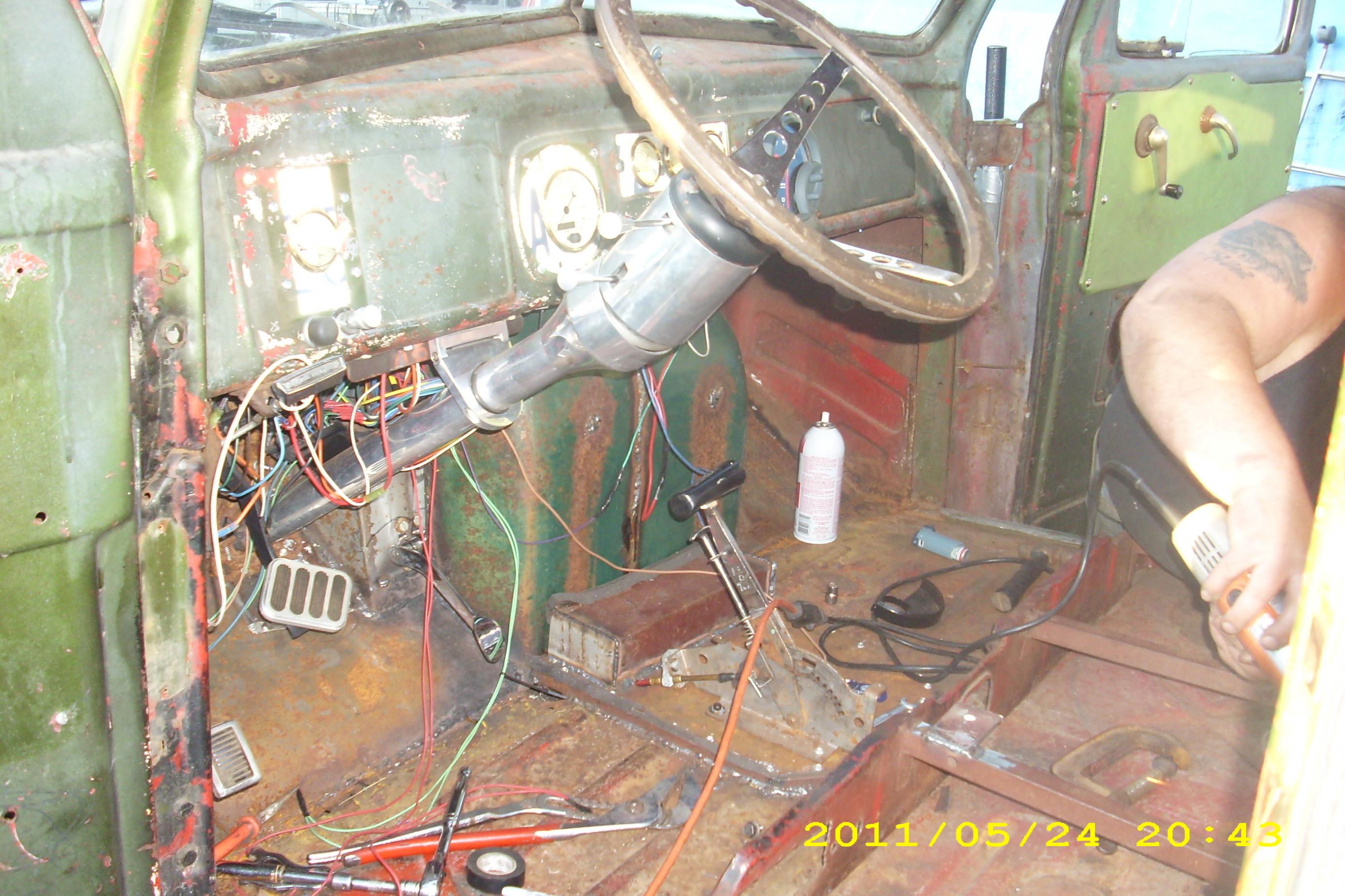

    Feeling better and the snows gone for now. Got out and tinkered with the pickup a bit yesterday. I sorted through all the parts in cab and box to see what all I have and dont have. Missing a few little pieces and all the original body panel hardware.
    Put a few misc nuts and bolts through ferders, core support/grill and later today I'll install the hood. Figured since it will be outside where the neighbors see it, make it a little less an eye sore. Comes off the trailer today also. Going to stash it in the dirt floored carport for the winter season.
    After removing engine parts from the cab, found a lot more rust and some really badly done "patches". Took some good measurements and will be making templates for new floor panels. Will also be removing the original seat and taking it to my upholstery man for a rebuild estimate. I have included a few photos for those following.
