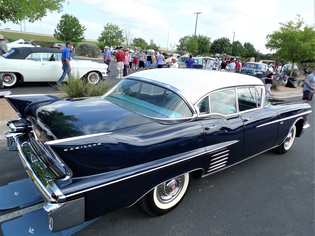

    As said, Electron Blue isn't a '58 Caddy colour, and I don't think that car in that photo is painted in an original '58 colour, especially given its not stock?
    This is Cobalt Blue, which is a '58 Caddy colour, and looks much darker?

    GeeRam, that's the shade I'm looing for, somewhere in the Ford Washington Blue range with metallic.
