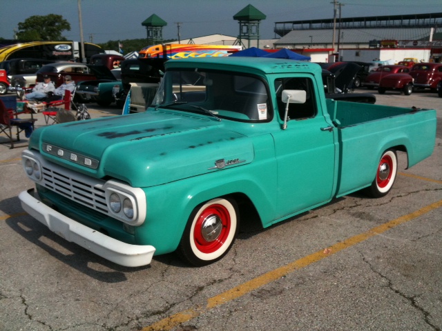

    3 inch dropped axle from Sids on this one :
    Your 57 looks like a great truck to start with. Looks pretty solid.
