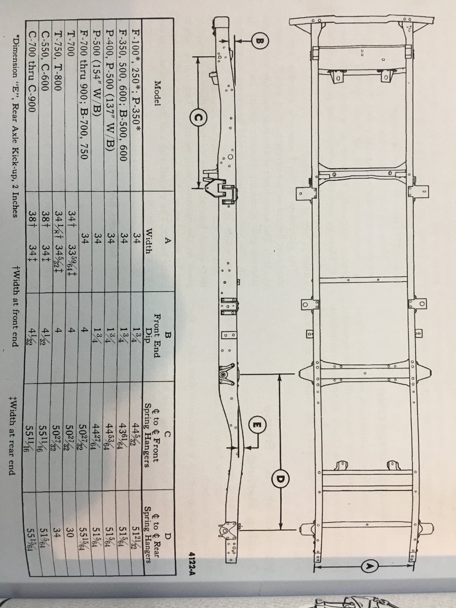

    Hey everyone, I'm looking for a drawing with all of the dimensions for a 57 F-100 frame. I bought a drawing on ebay, but it only has frame width and thickness, along with location of leaf spring brackets. I'm looking for a drawing that has body mount locations, bed mount locations, everything. Planning to build a frame and want to make sure I have good reference. Thanks.
  2. I believe that the dims are in the official 1957 Ford truck shop manual. I'll see if I can copy the page for you tomorrow.
    Big Shane likes this.
    Hope this helps. PM me if you need a measurement

    Thanks Criminal, I'm looking for something a little more comprehensive, and it may be that Ford didn't provide those type drawings. I repaired a corvette frame once, and found a drawing like this...
