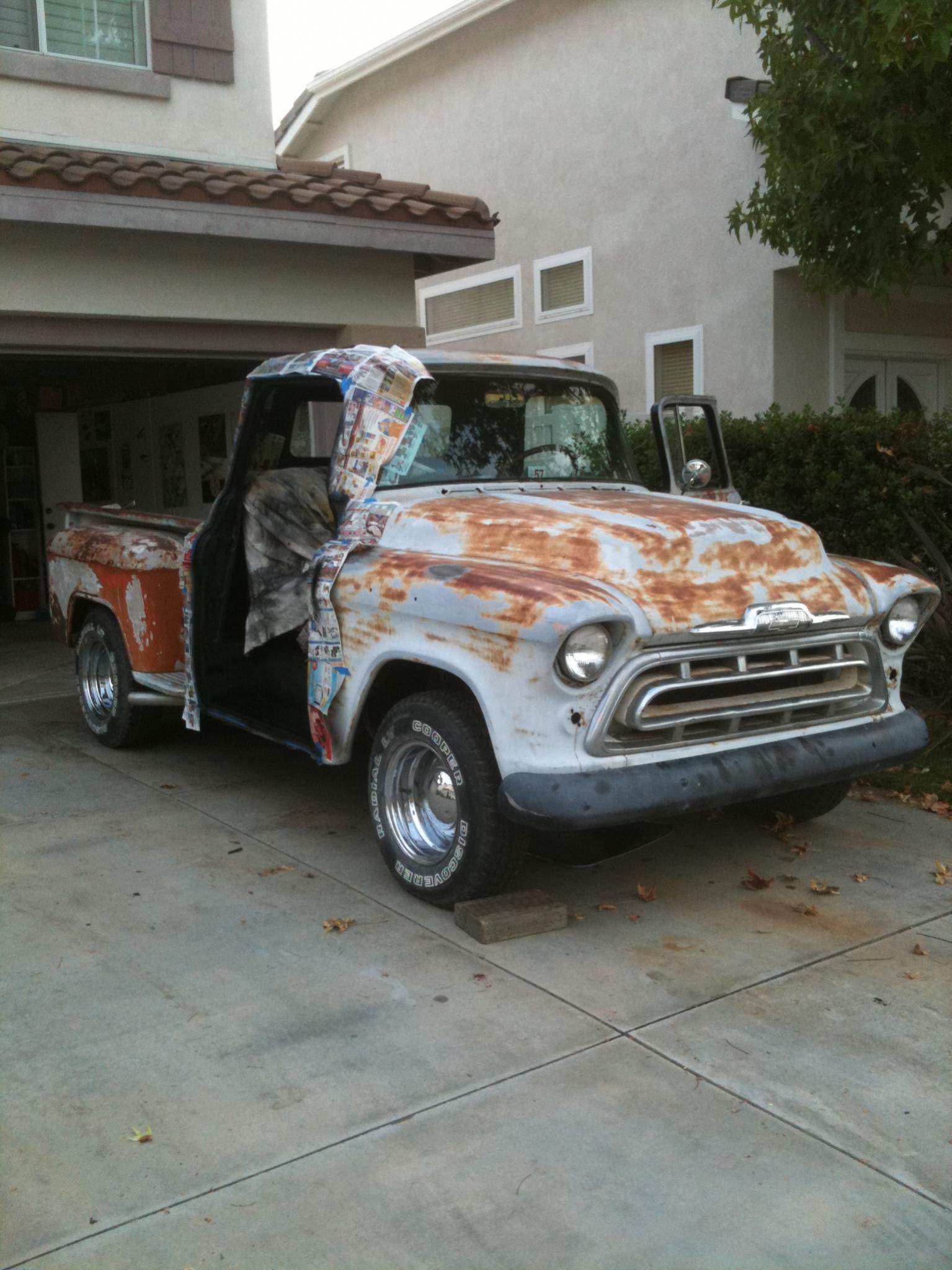

    Its actually a 283 in it haha. I kept blowing the float pins, so I had to kick the psi down a little, and I used a timing light to check it.
    Thanks for the kind words!

    Swapped out the old original coil for a new one and put new spark plug wires in while I was at it. Ive been running the same wires since I got it so I figured it wouldnt hurt! Took it out for a spin around the block and it seemed to run pretty good. Didnt miss or backfire when I was getting on the throttle either! Hope that fixes it....[​IMG]

    Just took the truck out for a real test run, and it seemed to run pretty good! No backfiring/missing! Hopefully the new coil and cables fixed that problem. Time to move on to the next problem...

    Make sure you mount the coil up on the firewall, they hate heat and are oil cooled so you can cook them pretty quick. Was the old one a 6volt like I thought with no ballast resistor? What about the light switch? Were the highs and lows on at the same time?

    I'm tucking all my wires and my firewall will be bare...do you think it makes that big of a difference in heat? I'm trying to think about where else I could mount mine, because right now it's in the same location as Taylors.

    Its mounted pretty close to the firewall, and kinda above the intake. It was the original 12 volt. I havnt had a chance to check out the light switch, but when I do I'll let ya know!

    Just picked up new cab corners and rocker panels today! Old wiring should be coming out soon as I get some free time, than its off to my buddies shop so I can borrow his welder and do some shitty patch panels...

    Looking good!!! When you install the cab corner patch panels pay attention to the curve of the door and try to match before you weld it up. Lots of the replacement panels are pretty flat on the jams.

    They are oil filled to cool them so heat is a real killer especially if you mount it with the top down they will get literally cooked eventually. More common with the cheapo no name brands. Also if it is a daily driver sorta like what Taylor is doing. If you are only driving it occasionally on weekends and to shows it will be years to never.

    with the cab corners make sure you pat the money for the expensive ones made in America (they are not in primer). The epoxy primer covered panels are made in Taiwan and are junk (they are not made right). Hope you bought the right ones. The hours you will have in to getting them right will be the difference between the good ones and crappy ones, check out my thread for pictures.

    I dont know which ones I got. Guess it doesnt matter now since I already got em haha.

    How do you know which retailer is selling the Made in USA ones? I need the passenger side...

    Counterpart = made in USA. Usually 80-100 bucks per patch panel. Truck and Car Shop in Orange, CA has them, they are the retail side of Counterpart. Their customer service blows and their shipping is overpriced... and they dont pack their boxes correctly and stuff gets damaged... and parts will probably be missing from the box... other than that go through them. Other places will price match so check around your area for a 1955-59 chevy truck part retailer. Dii is the Taiwan brand and it sucks, they are usually in black epoxy primer because they get shipped overseas. the ones made in the USA are bare steel with cutting oil on it.

    Got the old wiring all ripped out, and have the new harness all laid out where it needs to go. Just gotta get a few odds and ends and start connecting everything....

    Almost done with the wiring harness! My dads been helping a lot with it because Im borderline special when it comes to wiring and electrical....

    Don't forget to replace the headlight switch or relay the headlights so you don't burn up the new harness. I can believe you are getting rid of the trailer wiring harness ;)
