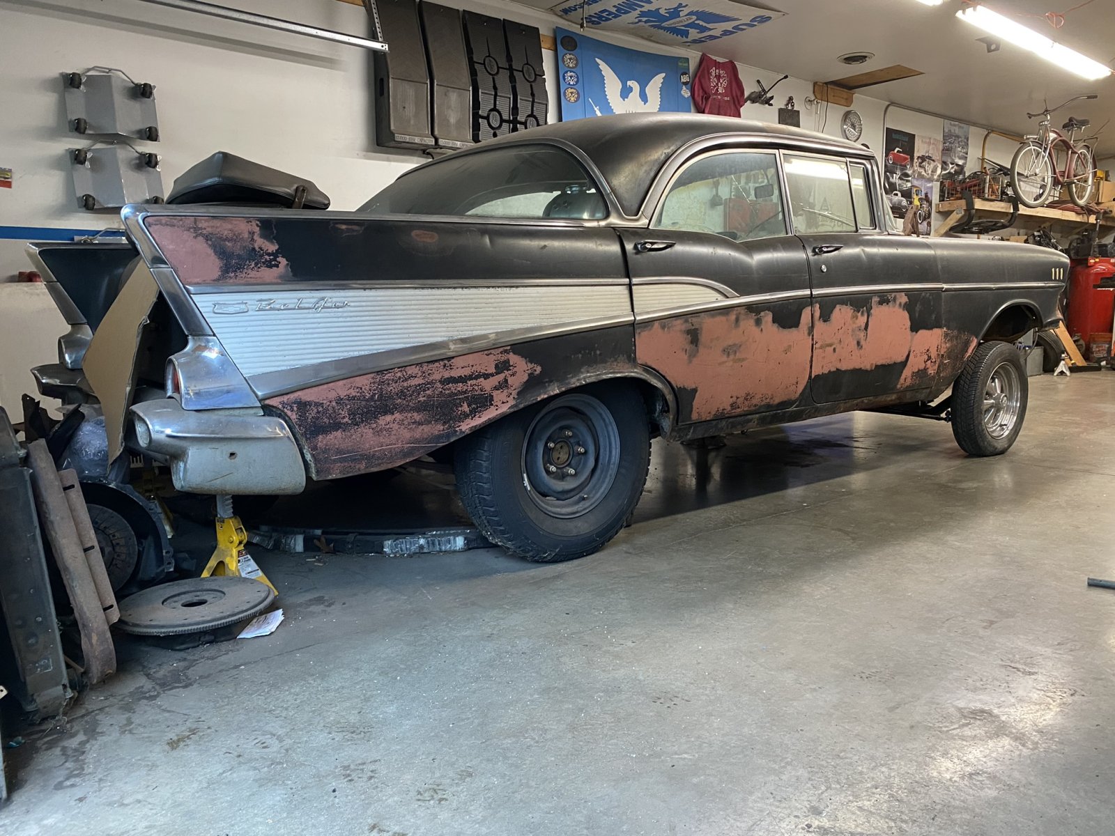

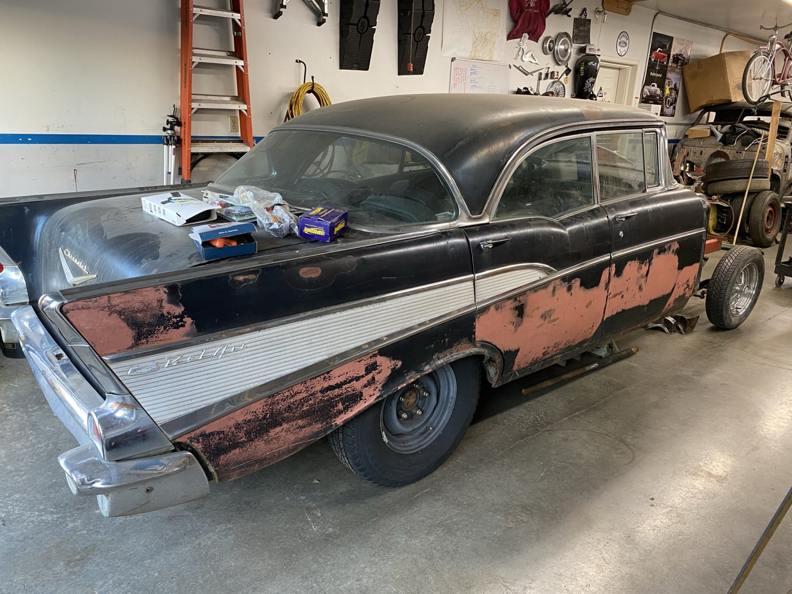

    I have been working on this build for a few years but the world transpired against me for a bit and drastically slowed down my progress. Now I am back at building a 1957 Chevy into both a street/strip terror as well as a family hauler. The impetus for the project happened with a brand new second child, turning 40 years old and finally realizing that the days of fully utilizing my Model T were over except when going on solo rides. A friend was parting out a 47-54 Chevy truck and I was gifted a straight axle so my search was focused on something with four doors to make car seat maneuvering as easy as possible, a roof to keep out the Oregon rain and something fast enough to run at the summer Wednesday night drags at PIR. IMG_2031 (2).JPG

    IMG_2013 (1).JPG IMG_2014 (1).JPG IMG_2015 (1).JPG IMG_2034 (1).JPG IMG_3102.JPG IMG_3103.JPG Not being a Chevy guy I stumbled onto a 1957 that was missing its drivetrain but seemed like a great start for a very low price as it was a little bit of a drive out of Portland. It was fairly straight with not too much rust so I scooped it up.

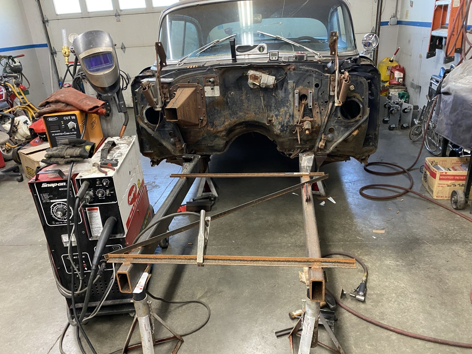

  4. fordman1
    Joined: Jan 11, 2008
    Posts: 380
    fordman1

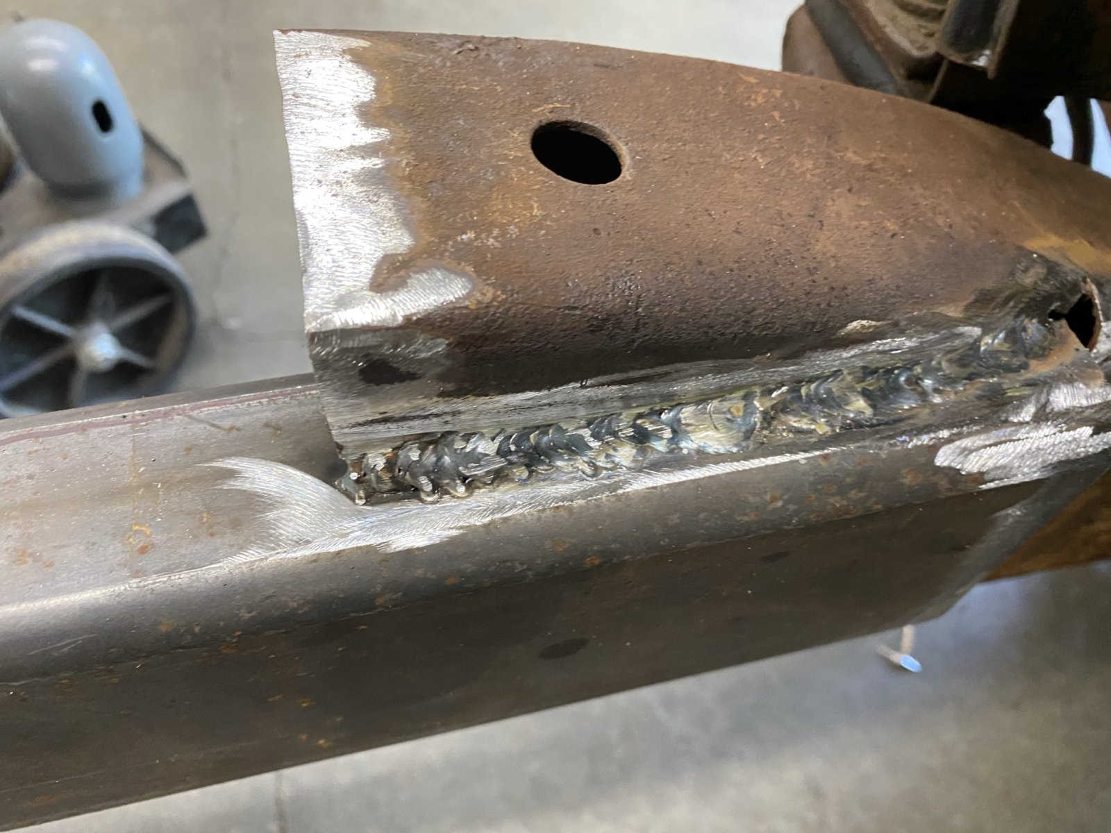

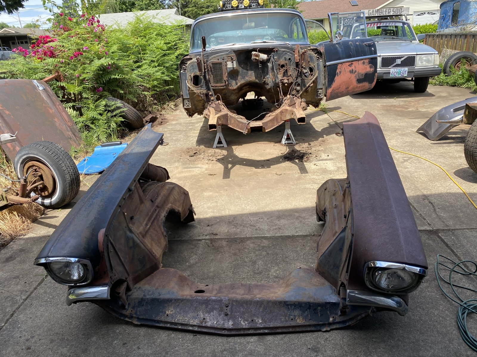

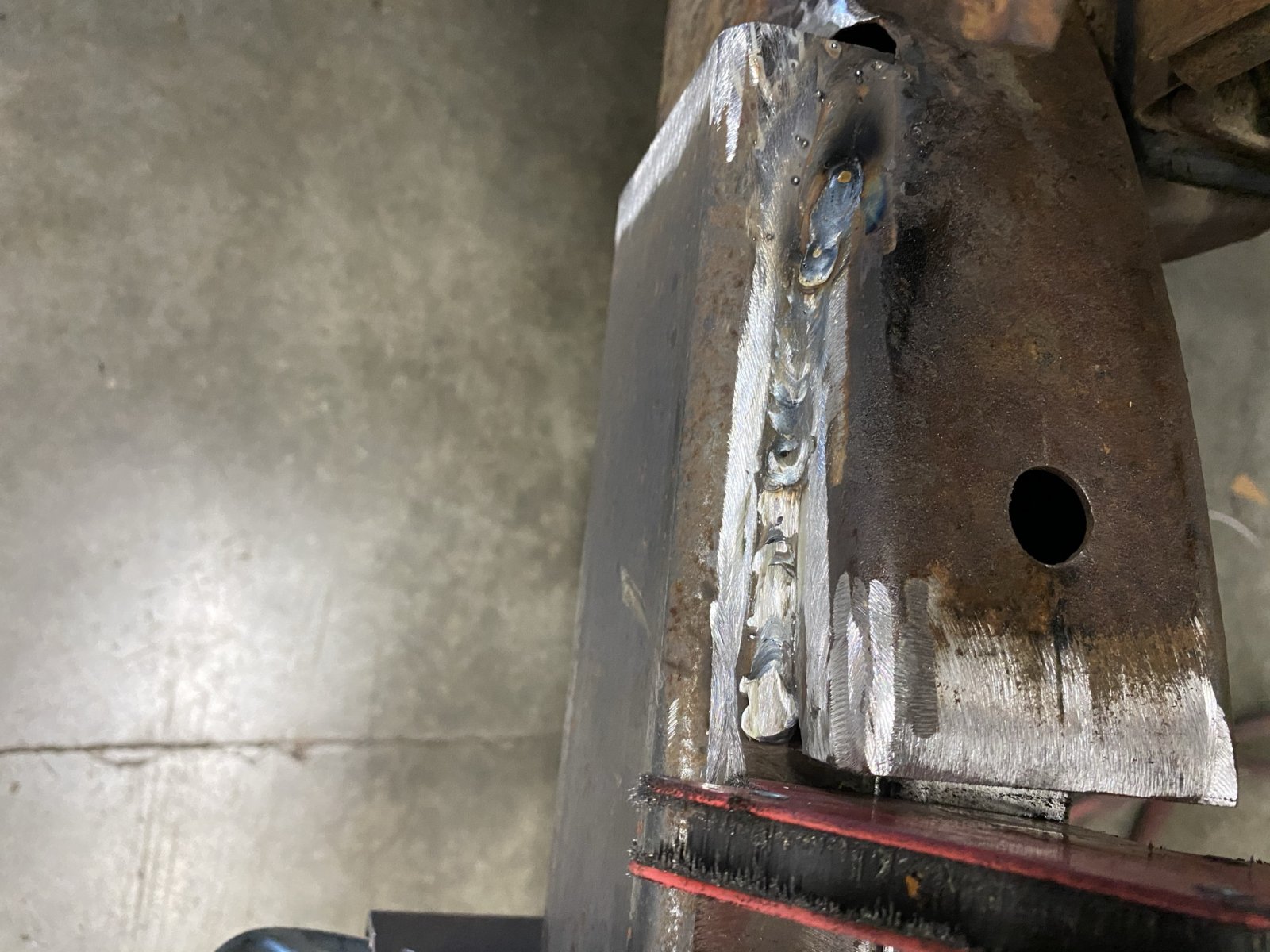

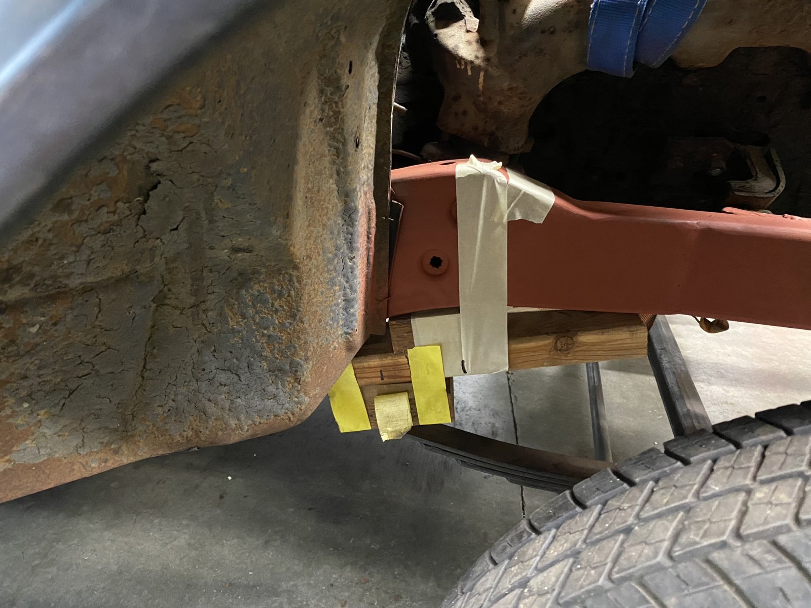

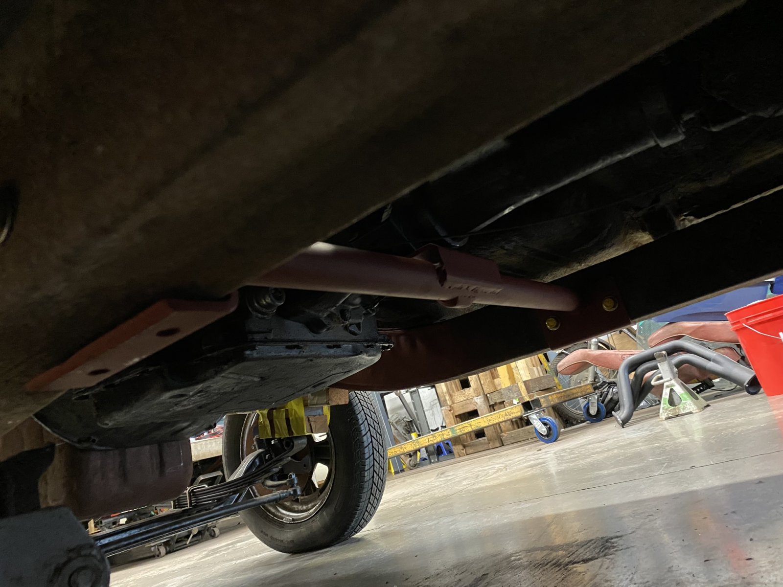

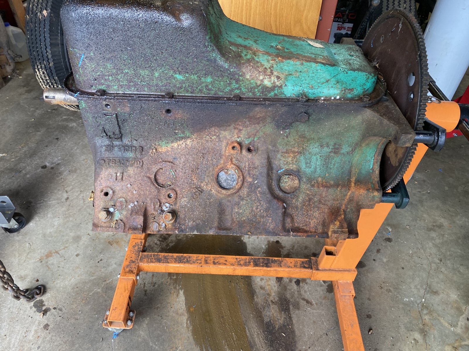

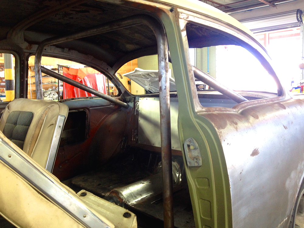

    IMG_3142.JPG IMG_3143.JPG IMG_3144.JPG IMG_3225.JPG IMG_3226.JPG IMG_3227.JPG IMG_3228.JPG IMG_3230.JPG IMG_4344.JPEG IMG_4345.JPEG IMG_4346.JPEG IMG_4347.JPEG The car had been driven hard and likely off road. Plus I had that straight axle so first step was chop off the front frame and fab up some 2x4 for a front clip.

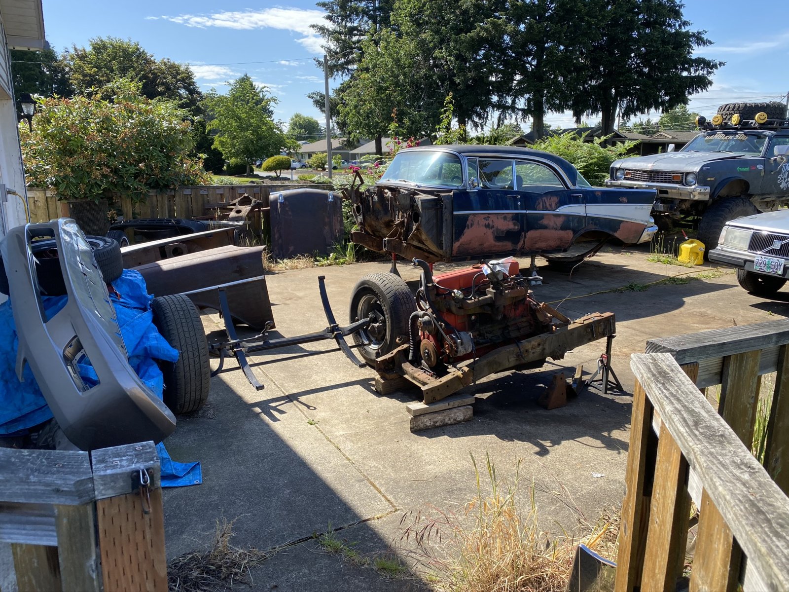

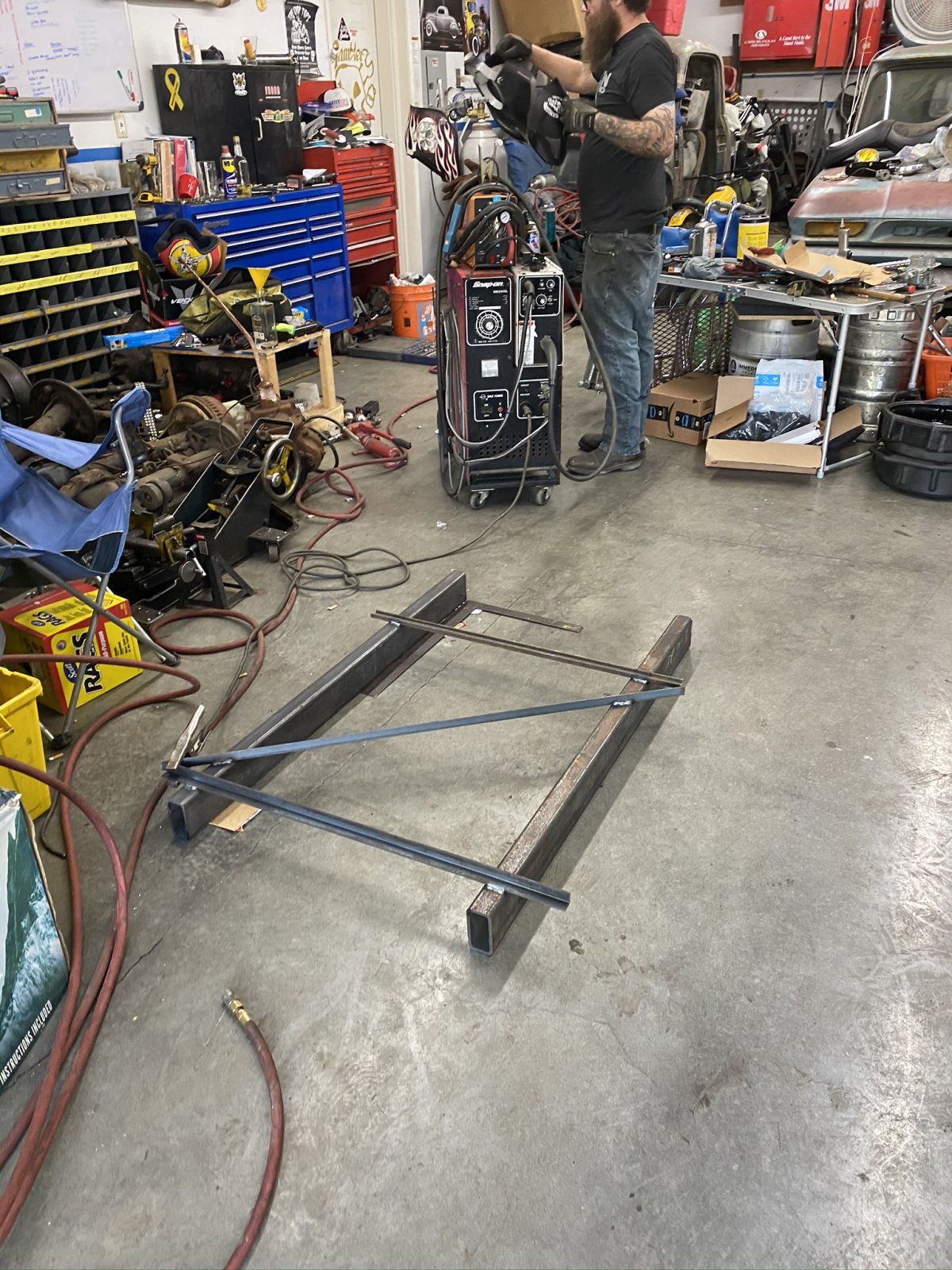

    IMG_2692.JPG IMG_2693.JPG IMG_2694.JPG IMG_2695.JPG IMG_4260.JPEG Next up was Wheels and Tires. Craigslist and FB Marketplace as well as Ebay resulted in crusty chromed steelies and Cragar S/S narrow front wheels.

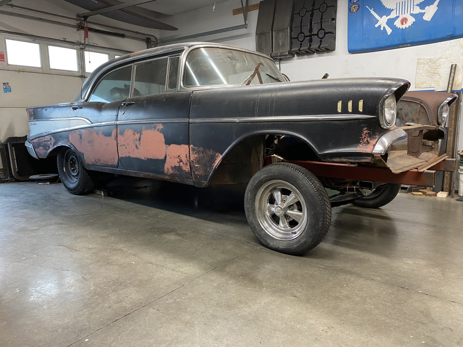

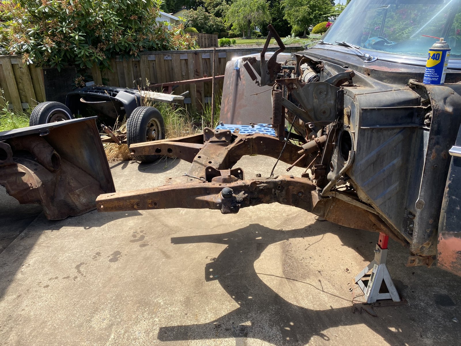

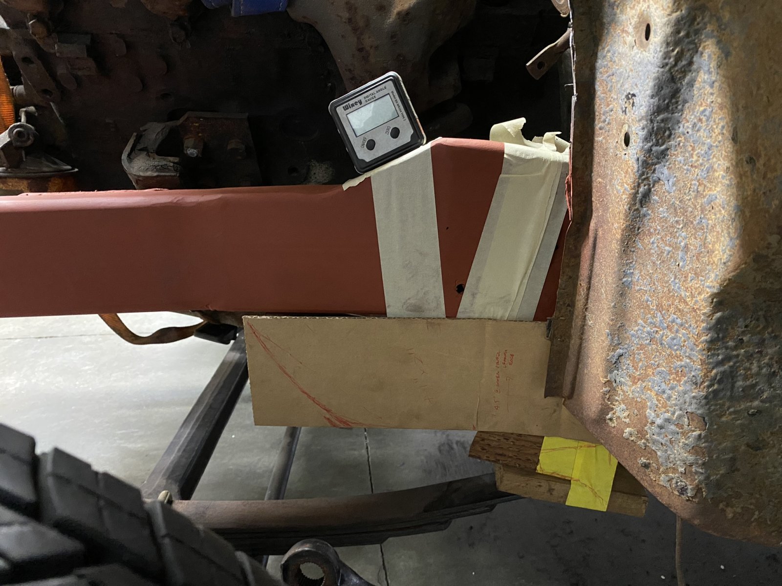

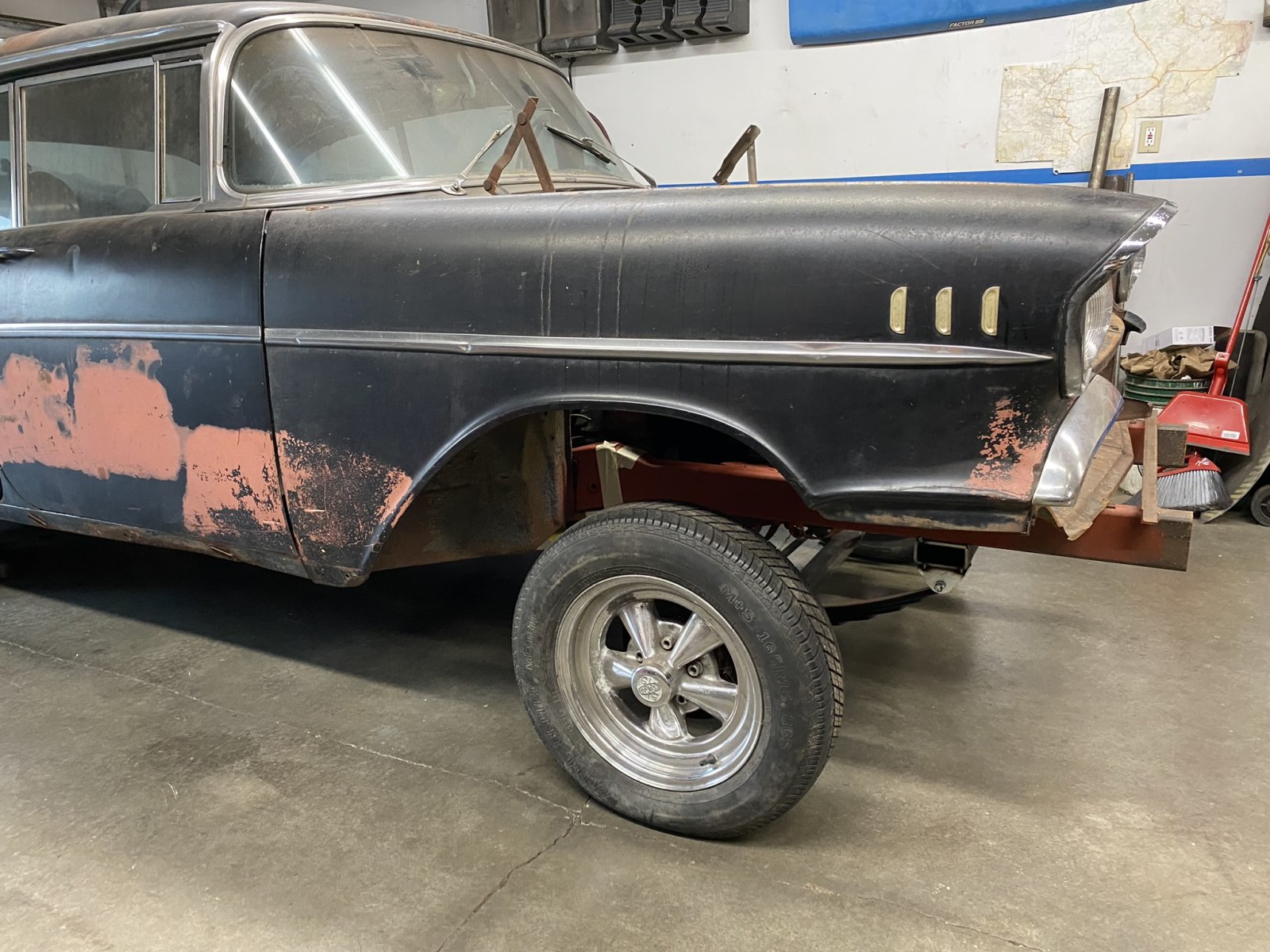

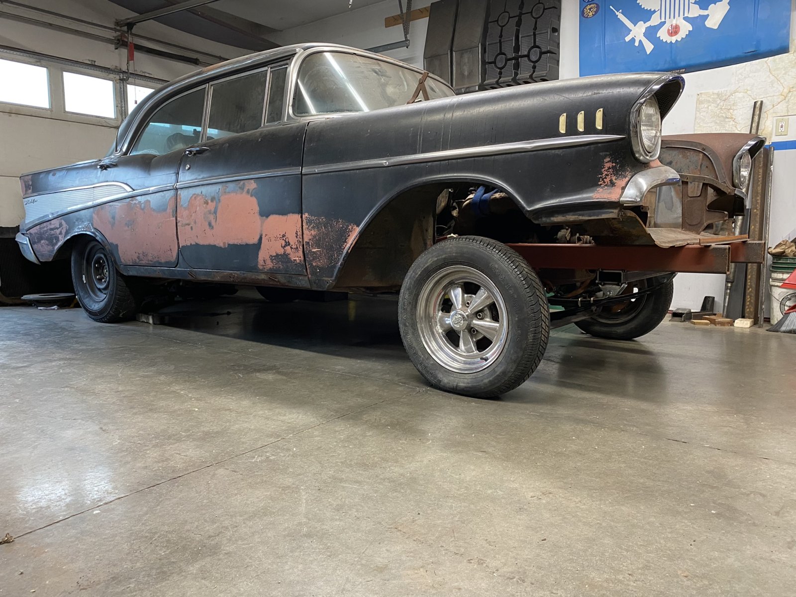

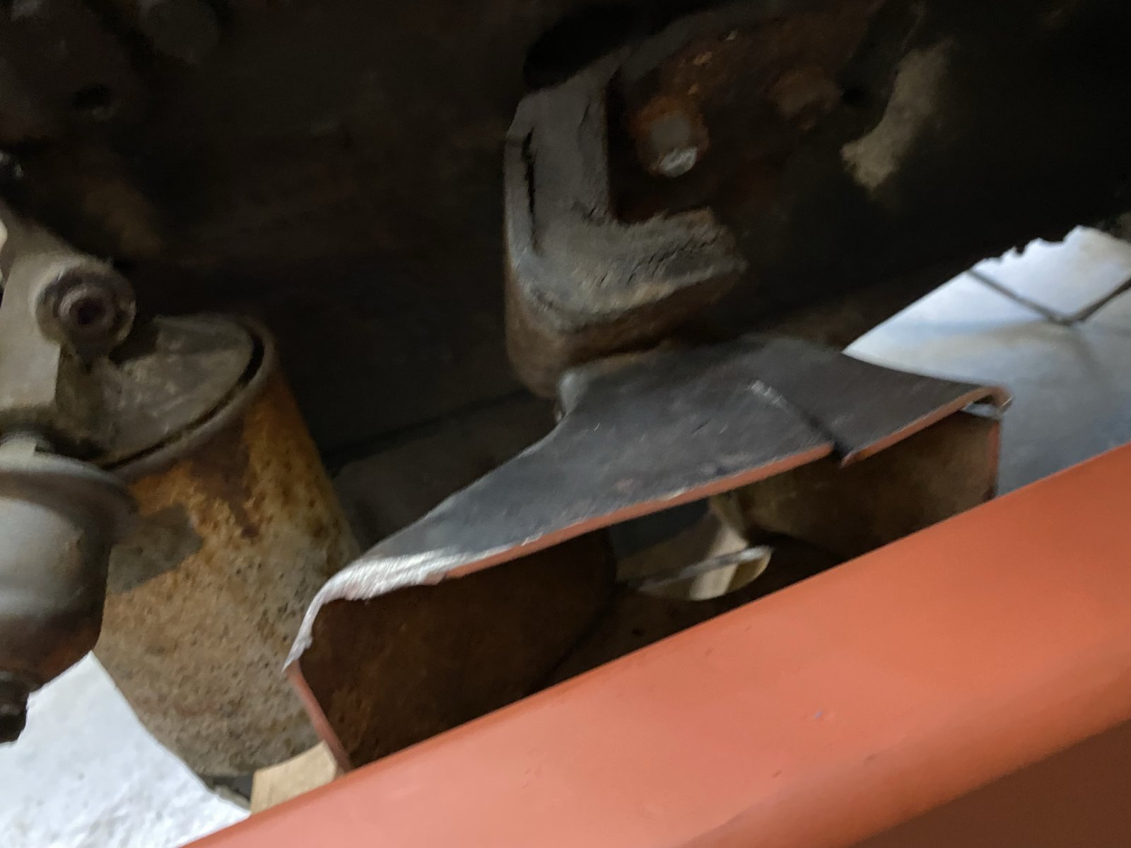

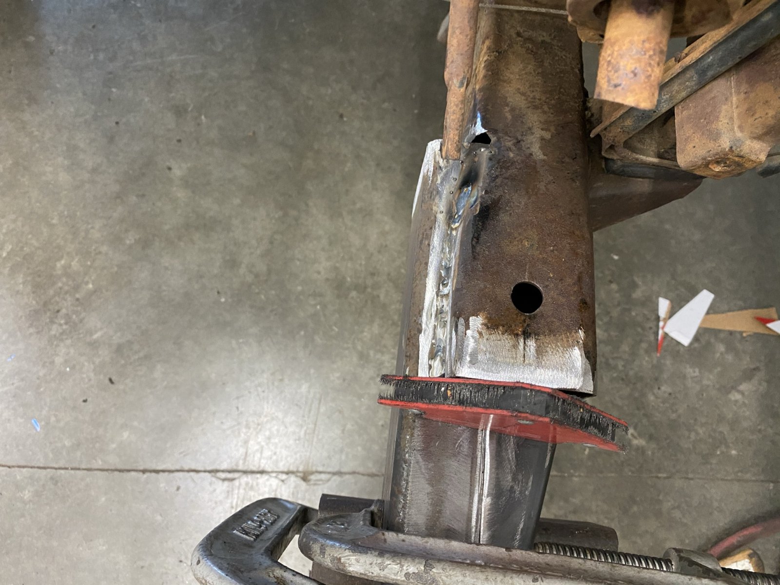

    IMG_4262.JPEG IMG_4576.jpeg Now I am getting excited about this thing! About this time after rolling the front end back and forth a hundred times I am noticing it is pretty crooked and bent and still needs a full brake kit. Again FB comes to the rescue with a 1950 Ford F1 axle with a full speedway brake kit installed. The center chunk was missing from the Tri Five rear so I was already planning on a 9". Again Ford guy so all the wheels I have are Ford bolt pattern.

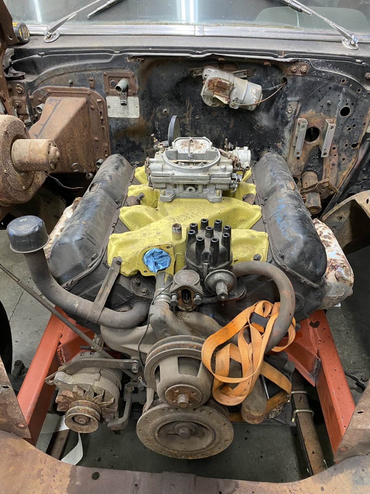

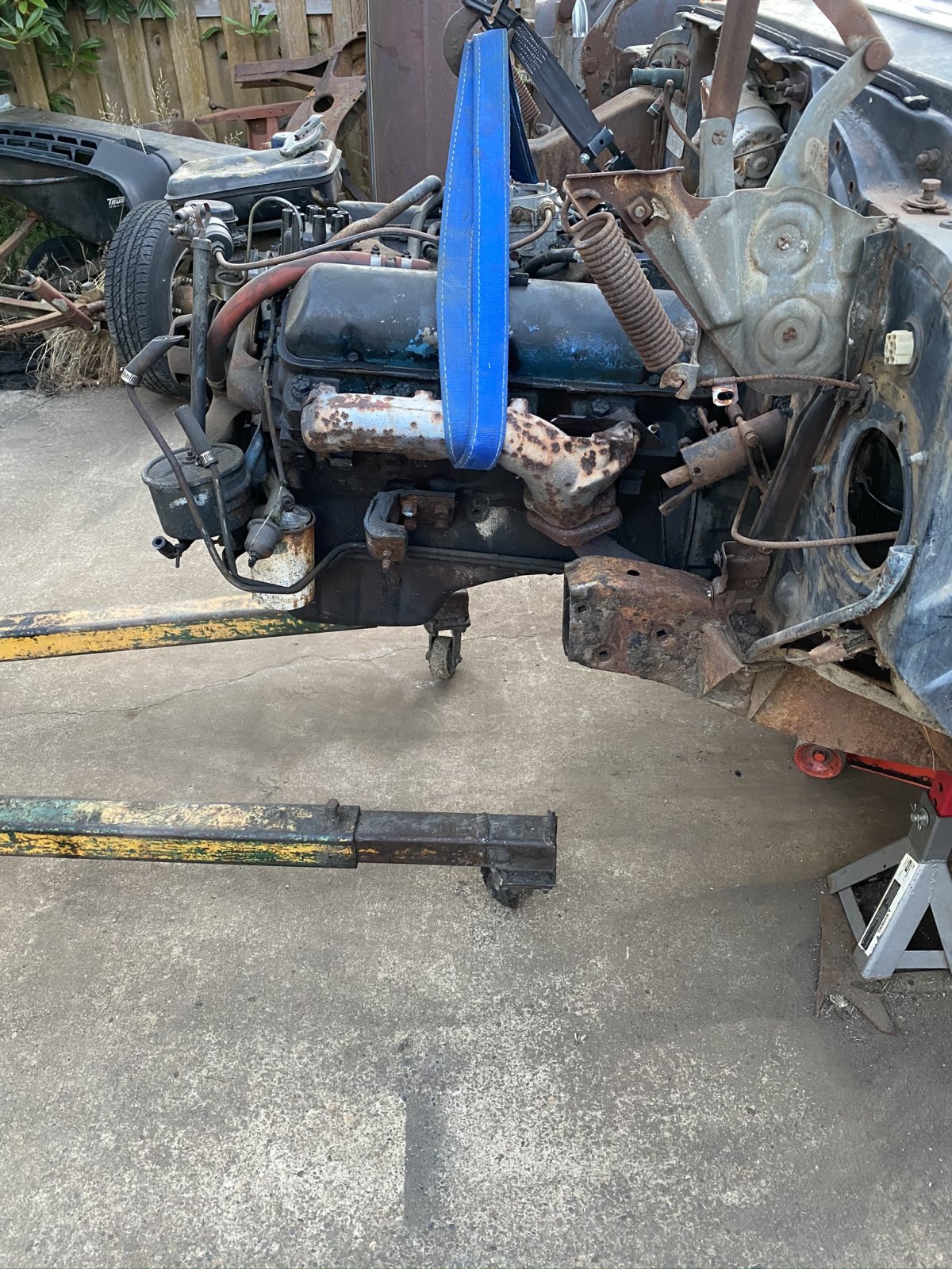

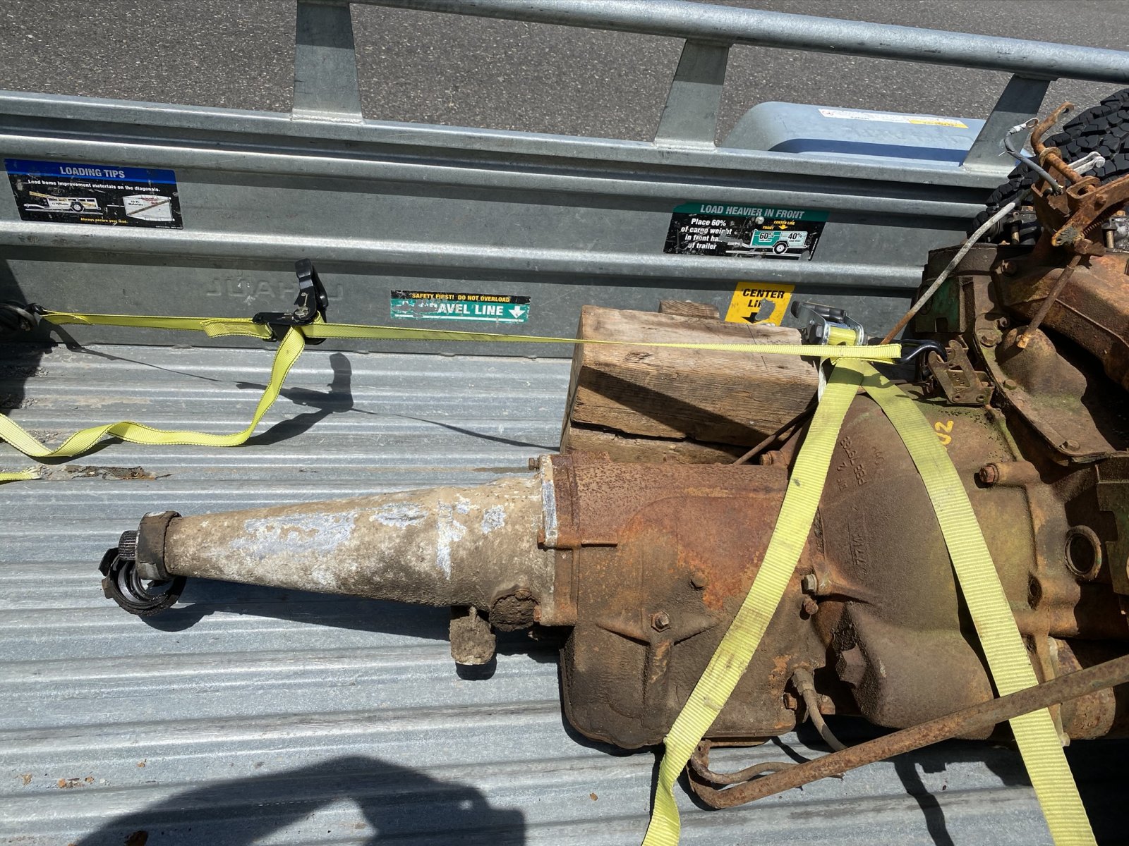

    61290581864__242A89D2-2619-40E8-8594-1D392200F140.JPG IMG_1961.JPG IMG_1965.JPG IMG_4349.JPEG IMG_4355.JPEG IMG_4357.JPEG IMG_4361.JPEG IMG_4569.JPEG IMG_4570.JPEG IMG_4573.JPEG IMG_5726.JPEG IMG_5727.JPEG Next up is power plant. I was hoping to find something cheap, as powerful as possible, late 50s to early 60s, something atypical as well as something my grandpa would potentially use. What I ended up with was a motor pulled for an LS swap though it had been running and drive and only needed a new water pump. For the princely sum of $200 I had a 1962 Lincoln 430 and auto transmission. Gobs of torque and not your typical engine swap. While searching local junkyards I came across a 1958 Edsel with an E475 410 ci engine that I got to dress up the MEL engine as an earlier generation. The '58 was a 340 hp and 475 ft lb of torque motor so I am hoping with the better intake, Big Block Chevy fenderwell headers, better holley 4 barrel, pertronix distributor that I can be close to 350 hp and 450 of torque. Also this gave the name of MEL-icious Intent due to the Mercury Edsel Lincoln engine family.

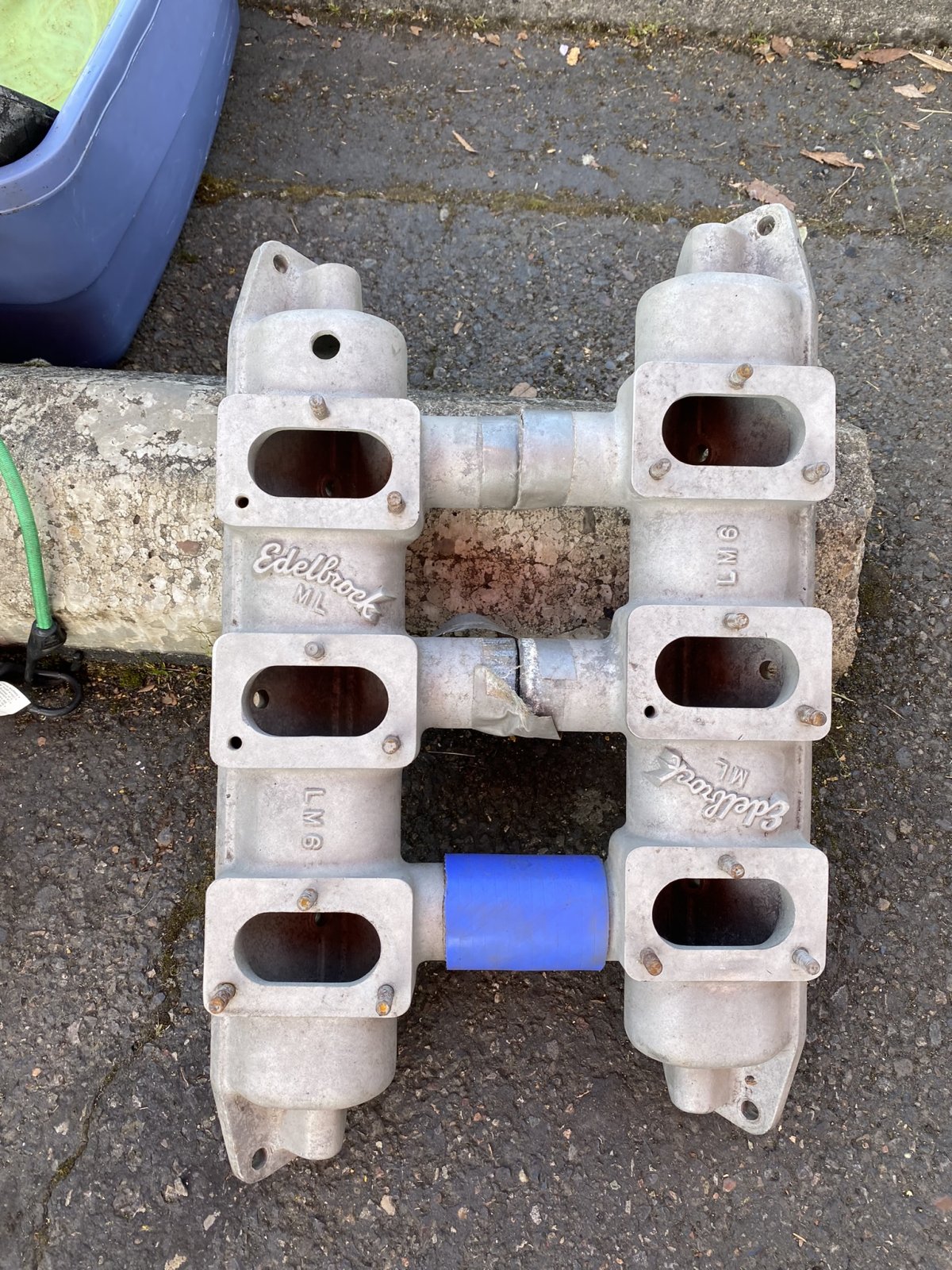

    IMG_5728.JPEG IMG_5735.JPEG IMG_5736.JPEG IMG_5737.JPEG 61290579385__2FE2F502-2F44-4E06-A68E-23E1F896AFC6.JPG IMG_1966.JPG IMG_4359.JPEG IMG_4443.JPEG IMG_4444.JPEG IMG_7033.JPEG IMG_7312.jpeg With the '57 Chevy and the '58 Edesl I also have acquired some gauges for under the dash and a floor shifter for the transmission. I also bought an Eelco gas pedal and scored an Edelbrock 6x2 Intake for a potential future induction system. I was looking for MEL parts and also accumulated almost enough to build two more complete motors. I had heard it was possible to adapt FE manual transmissions to MEL blocks but unfortunately it puts the starter in the wrong spot as well as the crank not being drilled out for a pilot bearing. My plan is to not give this first motor any mercy so I can have another one built up to make more power once I get used to this package.

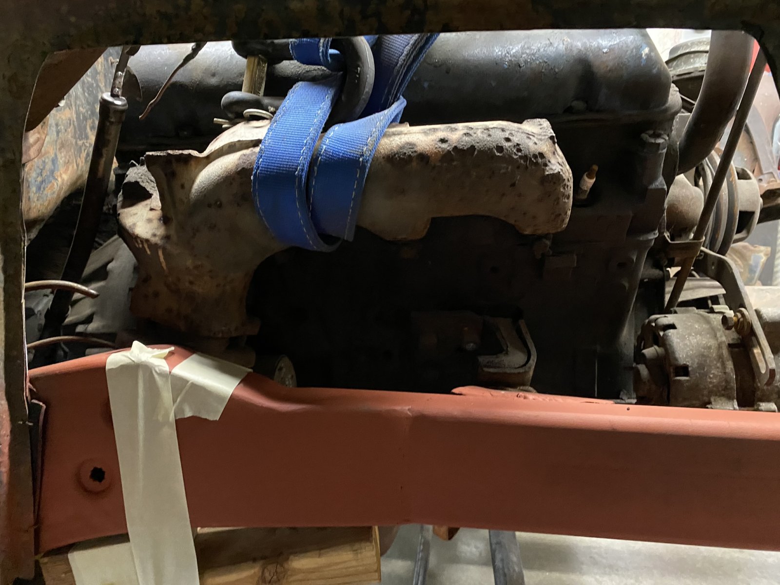

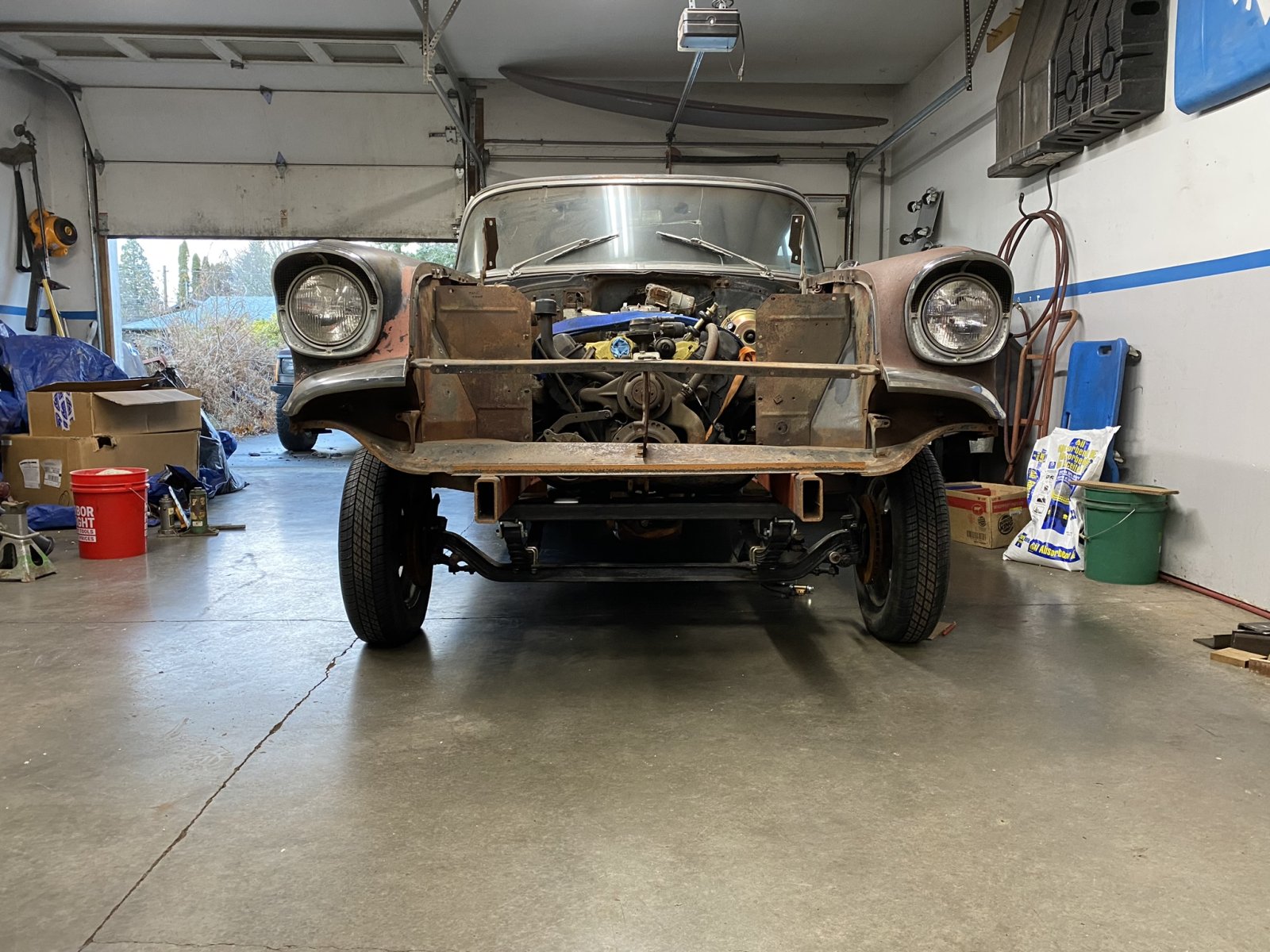

  12. fordman1
    Posts: 380
    fordman1

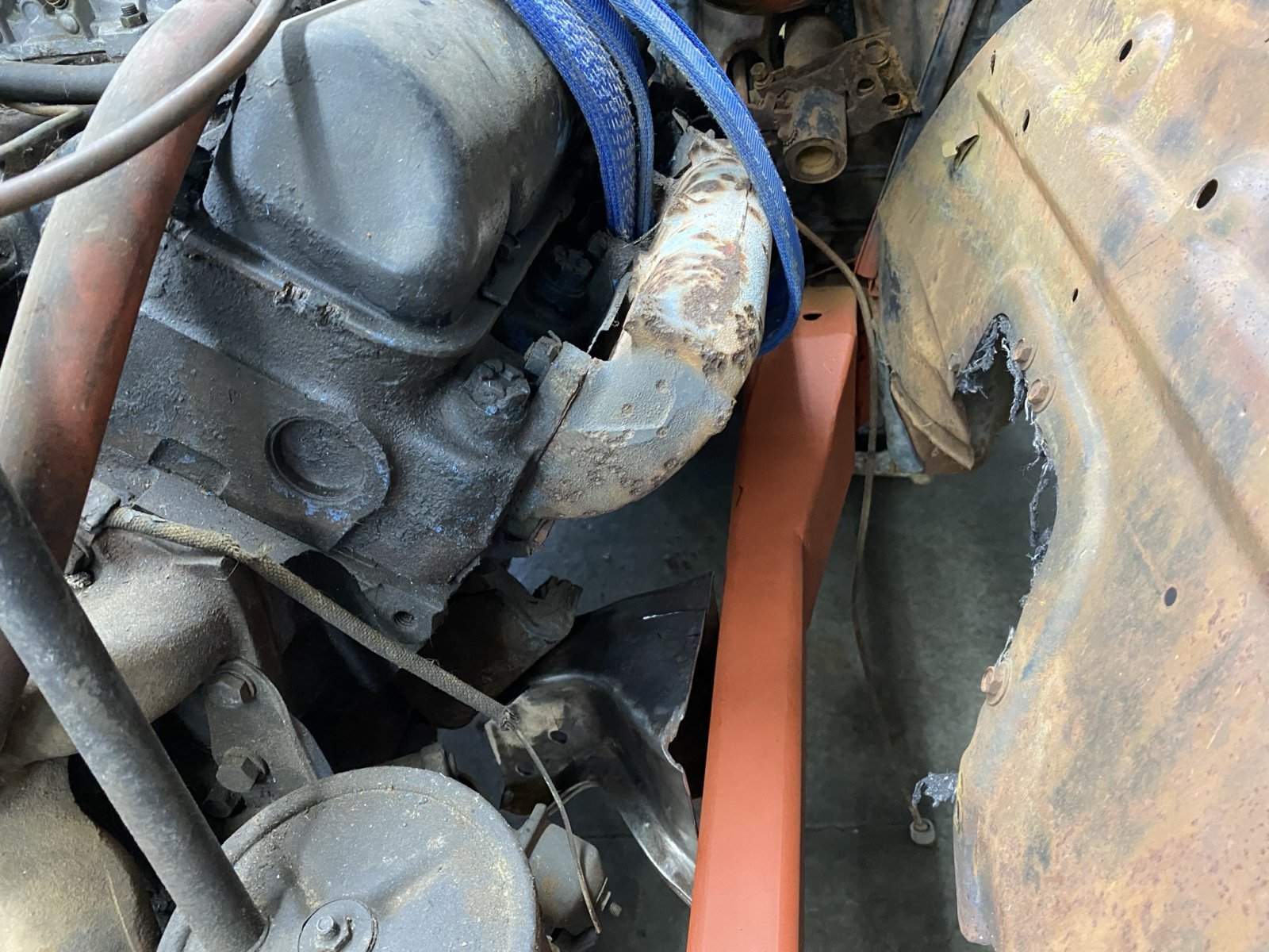

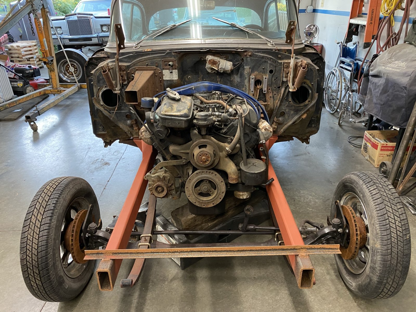

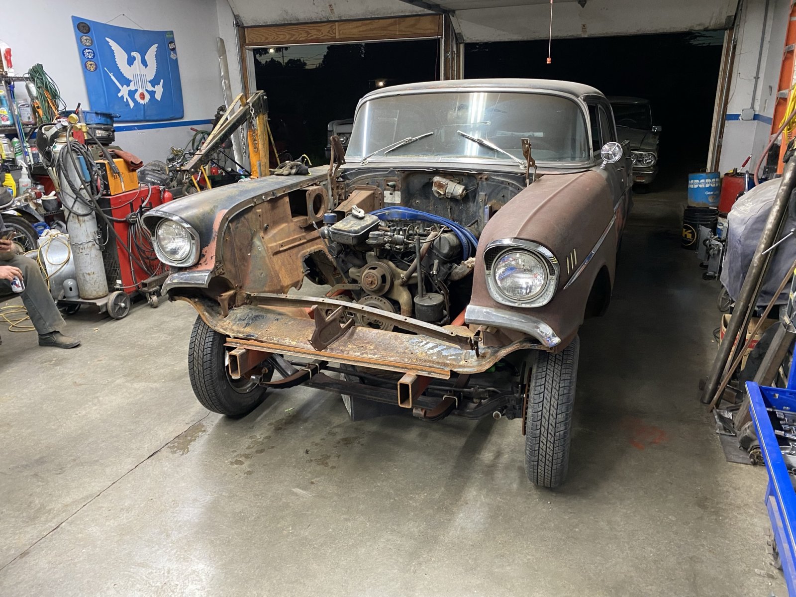

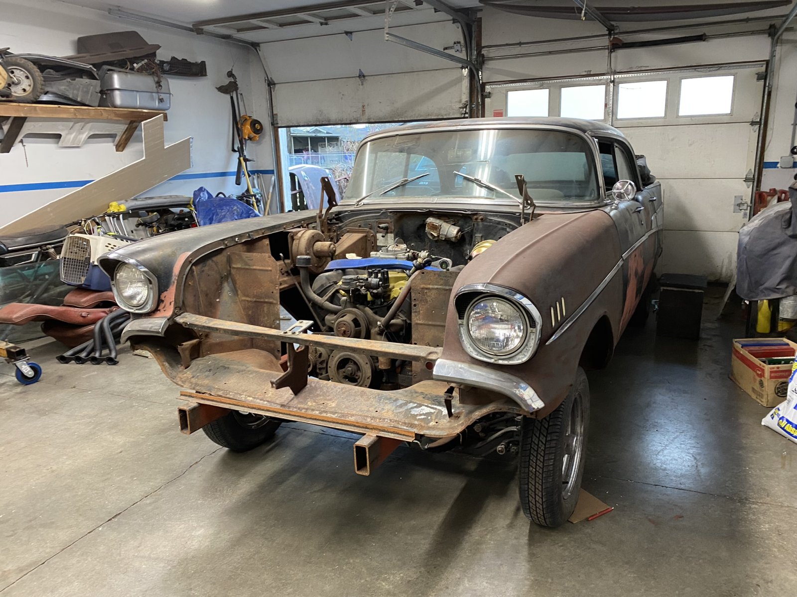

    IMG_8580.JPEG IMG_8581.JPEG IMG_8582.JPEG IMG_8583.JPEG IMG_8584.JPEG IMG_8586.JPEG IMG_8587.JPEG IMG_8588.JPEG IMG_8589.JPEG IMG_8590.JPEG IMG_8591.JPEG IMG_8592.JPEG IMG_8593.JPEG After way too much moving the engine, measuring, leveling, moving, measuring, up/down, etc. I said to hell with it and just welded in engine mounts to move forward. I modified the chevy mid mounts that held the saddle of the transmission and now use them to mount the engine. I then made my own transmission mount to hold the big Lincoln 3 speed. Another chunk of 2x4 tube spans between the front spring hangers. I have been luck to have a fellow HAMBer (1971BB427) helping with his knowledge and set up the suspension with the swing shackles at the rear.

    I believe this man is making race car noises!
    Love the build!
    Love a sport sedan! And the Fomoco powertrain is super cool. Go, man, go!!
  14. FrozenMerc
    Joined: Sep 4, 2009
    Posts: 2,942
    FrozenMerc
    Awesome! The early MEL's ('58 to '61) use the same bellhousing pattern as all FE's, so the starter location is the same as the FE as well.
    Keep up the good work.

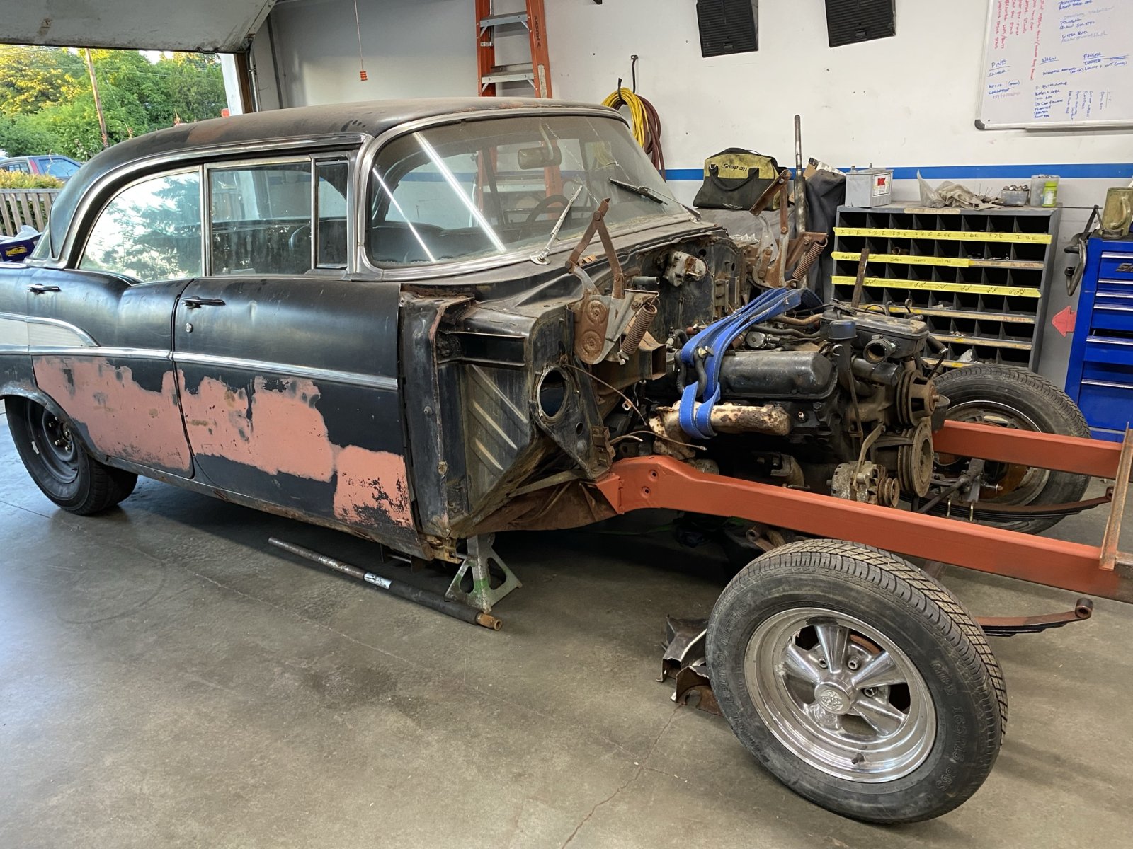

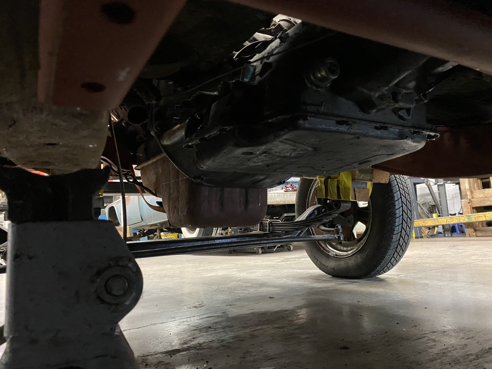

  15. fordman1
    Posts: 380
    fordman1

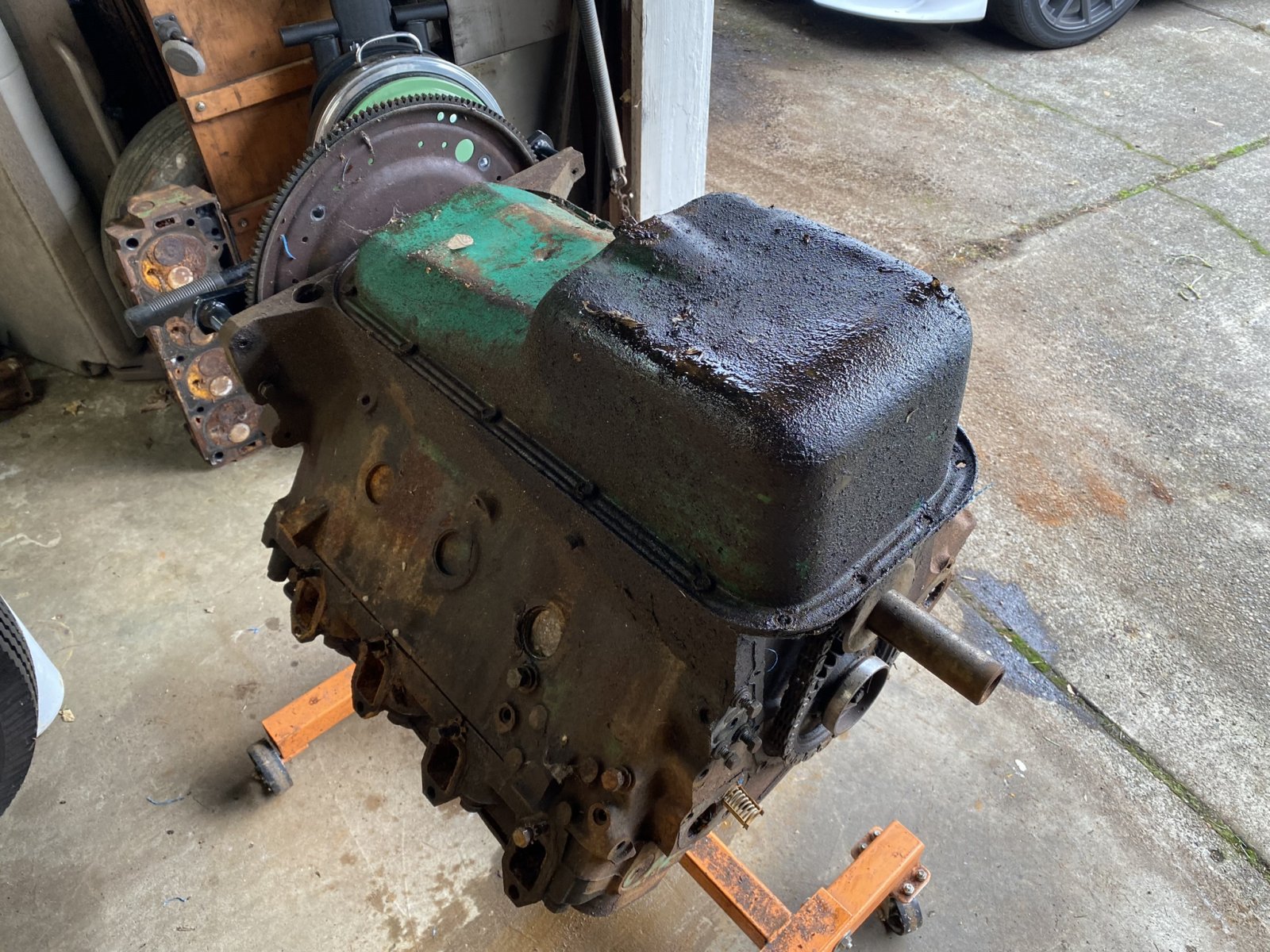

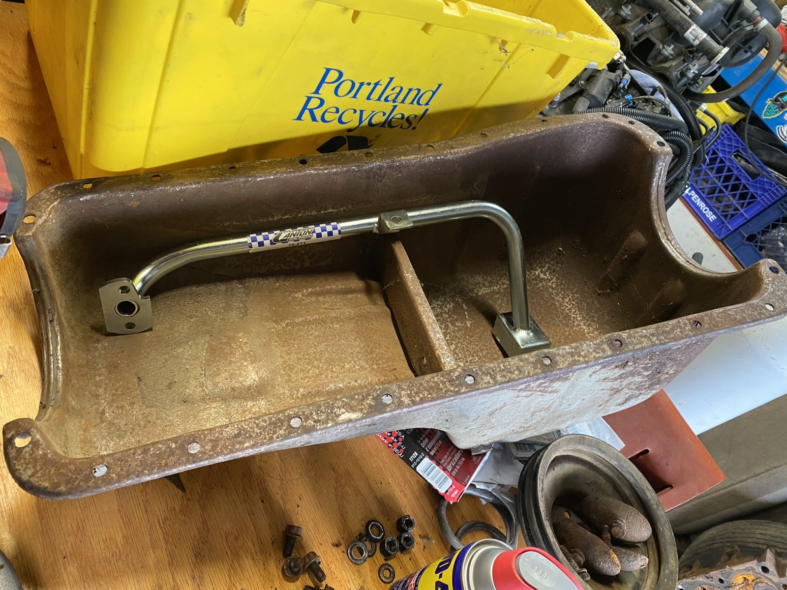

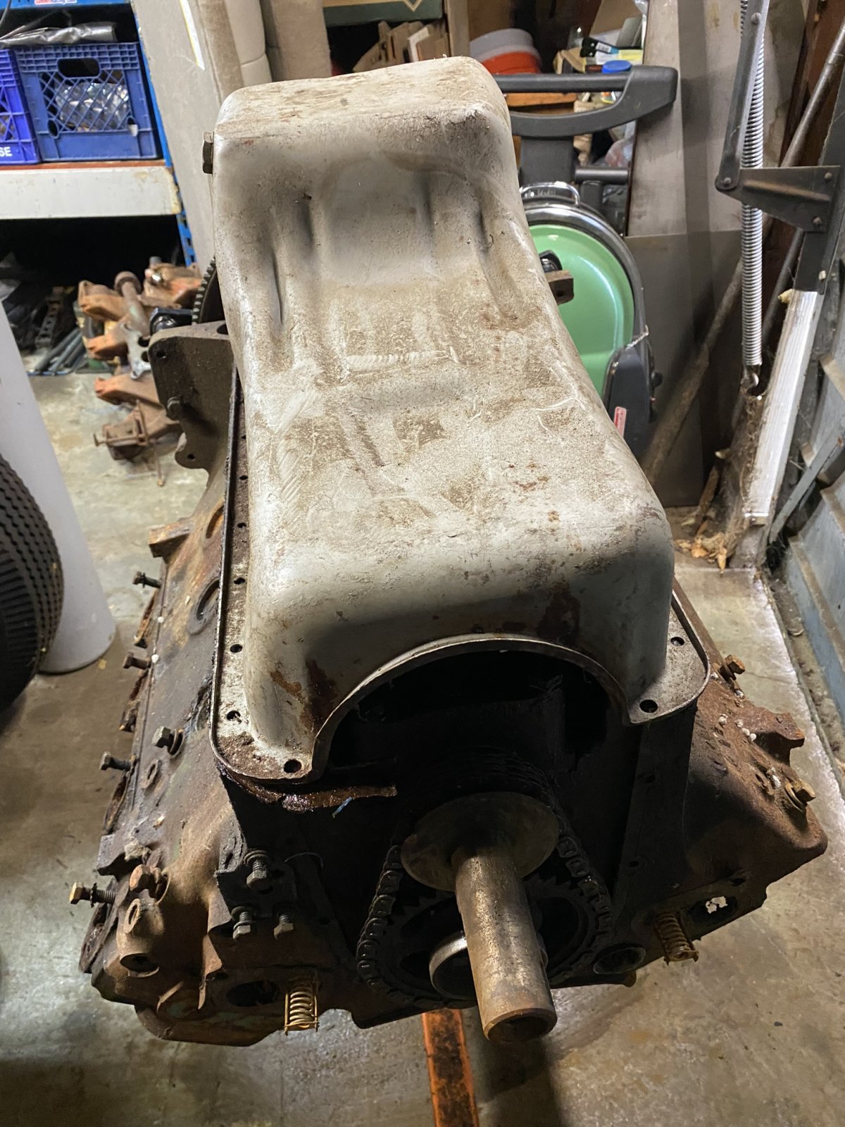

    IMG_8611.JPEG IMG_8612.JPEG IMG_8613.JPEG IMG_8614.JPEG IMG_8615.JPEG IMG_8616.JPEG IMG_8617.JPEG Next up is the fact that the MEL engine is front sump pickup for the oil pan and that will cause all sorts of problems but given that the MEL and FE share so many parts I bought a canton rear sump 4x4 oil pick up tube for a 390 and it bolts right in. With that haul of MEL parts came two extra oil pans that at the time I didnt realize were not for these engines. As far as I can tell, the are for 460 fords. So some slicing and dicing is in order to make a one off rear sump pan.

    IMG_8619.JPEG 63710106044__A0BD54A6-D731-42C1-9863-C5E646B44E6C.jpeg I have been talking to Slover Machine out of California about adapter plates to run 460 BBF intake. With how the engine is sitting I would like to run a Ford Tunnel Ram with a 6-71 or 8-71 blower on top poking through the hood similar to the Tunnel Cram that David Freiburger built on Motortrend.

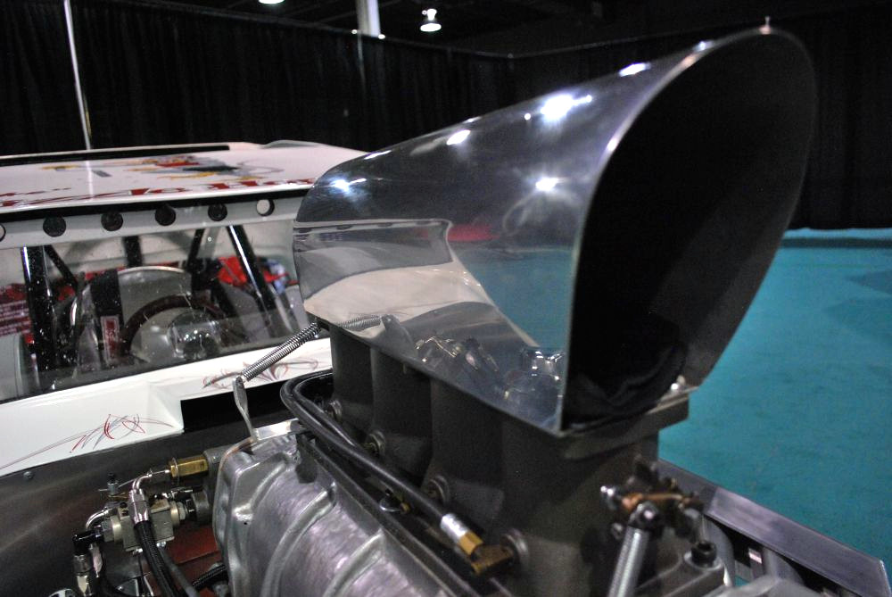

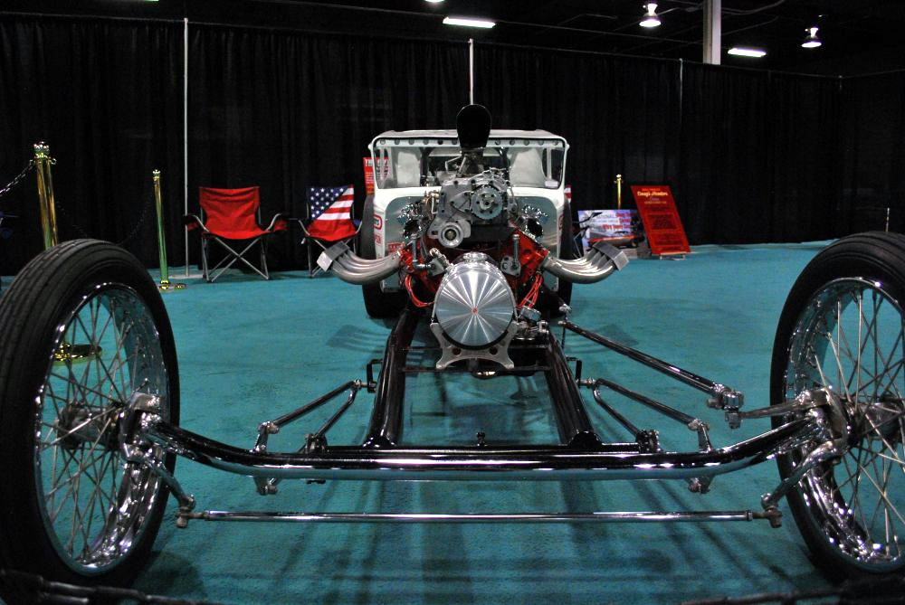

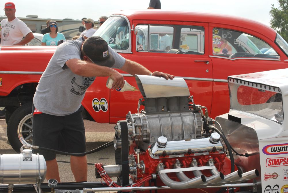

    20170608_172053-e1538669667211.jpg blower1.jpg blower2.jpg blower4.jpg blower6.jpg blower7.jpg cyr2.jpg cyrdragster.jpg drag3.jpg DSC06580.jpg DSC06583.jpg Gizzle_Hopper_MCACN006.jpg Gizzle_Hopper_MCACN016.jpg Gizzle_Hopper_MCACN025 (1).jpg Gizzle_Hopper_MCACN028.jpg IMG_0150.JPG IMG_1827.JPG IMG_1829.JPG IMG_1830.JPG IMG_2045.JPG IMG_2046.JPG IMG_2202.JPG IMG_2244.jpg.f2c06289770997806b2aa04f1928f2a4.jpg IMG_2551.jpg IMG_2760.JPG IMG_9432-grizzlehopper.jpg lincoln_engine.jpg lincolnpotvin.jpg MEL 671.jpg melblwr1.jpg In case anyone doesn't think MEL engines were historically used for racing, here is some bad ass stuff I have found.

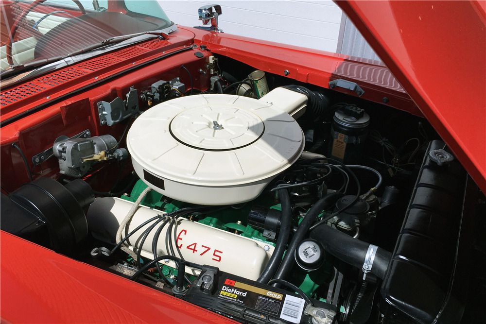

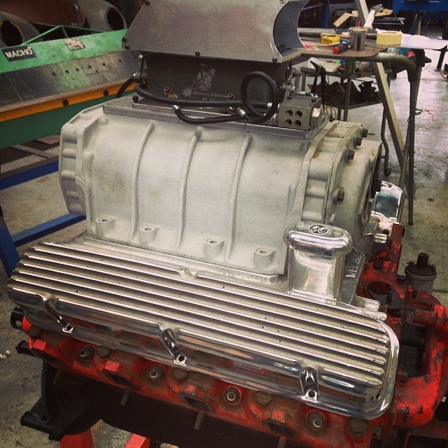

    005-2018-Engine-Masters-Kaase.jpg 009-2018-Engine-Masters-Kaase.jpg 222193_Engine_Web.jpg 404733-49.jpg DNzHE-SUQAEcSX-.jpg ffbea33c354b9c336c65041e3af288ff-700.jpg melblwr2.jpg s-l1600 (4).jpg s-l1600.jpg s-l1600-2.jpg A few more engine candy!

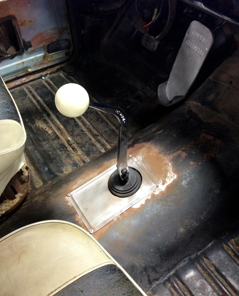

    Should also mention it is a Sport Sedan, came with silver vinyl with black and silver cloth seats but I may step away from all that black. Is onyx black with black wheels. It has a pedal and column shift that is absent as well as a butchered trans tunnel that someone used a gas axe on.
