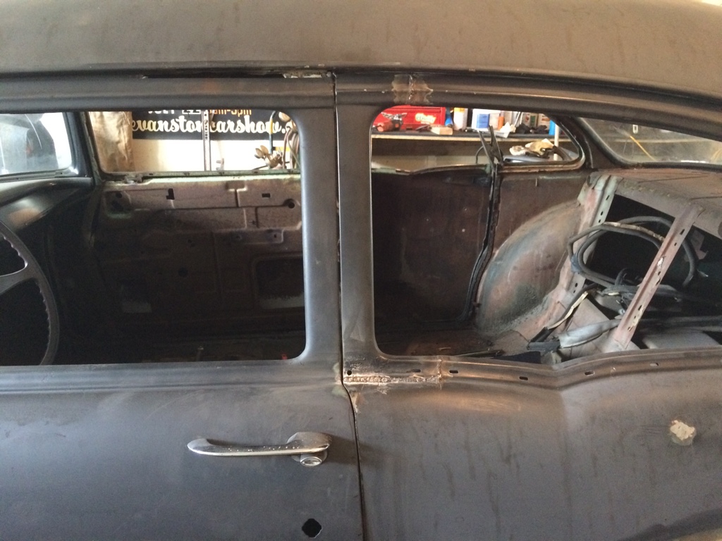

    [​IMG][​IMG] here is a pic of how I cut the post to make room the the rear window post to make it fit like a 2 door

    [​IMG] I know my door is off it's off on both sides I'll do door alignment with the body work and I'll also finish my door gaps

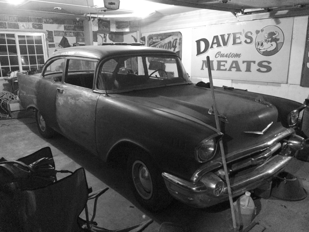

    [​IMG] still making progress just slow here's a couple pics I snapped tonight I did them in black and white because the lighting sucked haha[​IMG]

    Daves sign looks better on the wall too;)

    Lets see the place you joined the back door skin to the quarter panel. Did you use any bondo?

    I did use body filler to cover the weld spots but not much I separated the outer door from the inside but cutting it in half (I did not skin it) the reason was because the door not skinned has a stronger edge that is more easily welded and also with the double wall edge it stops excessive warping

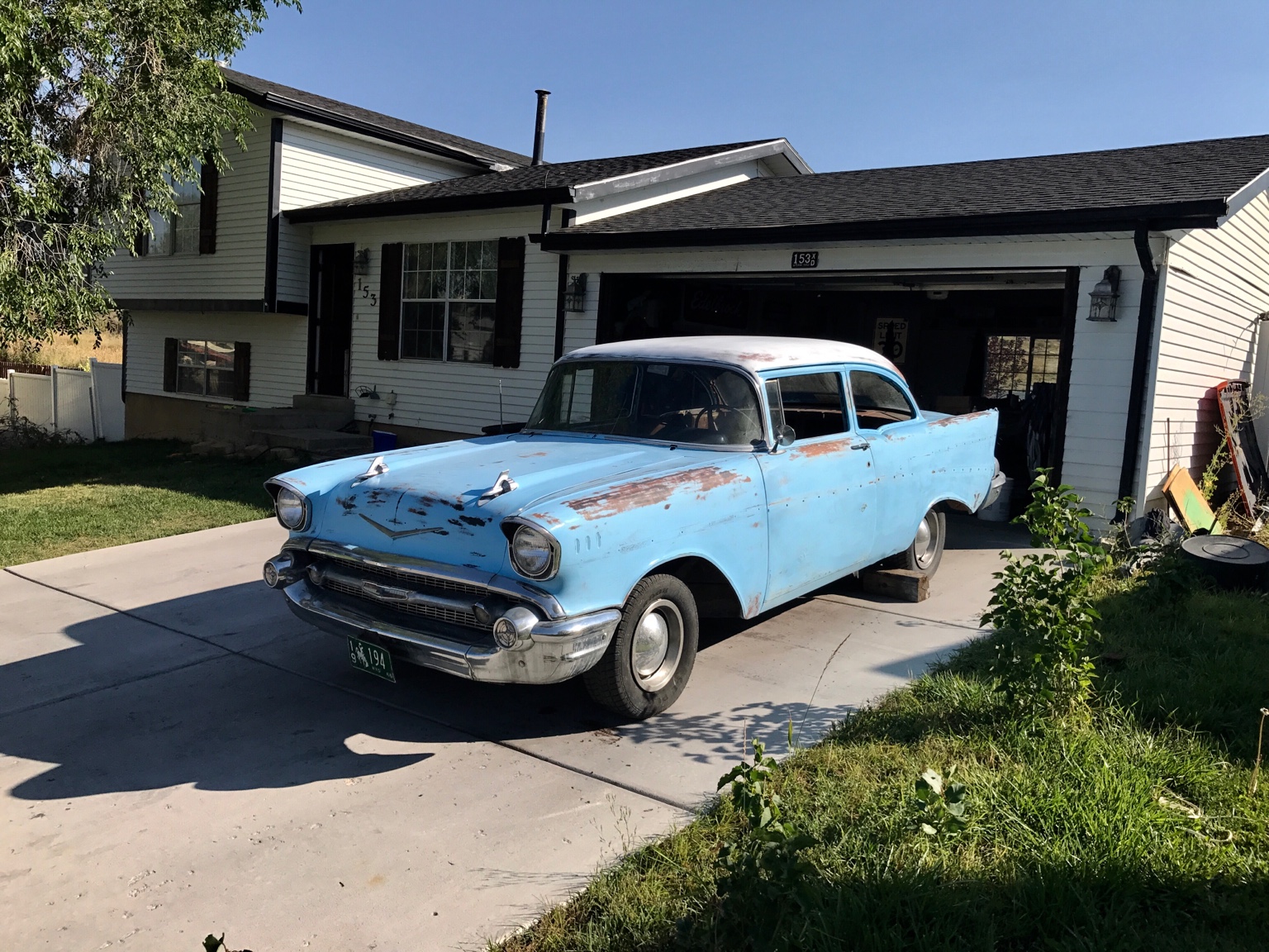

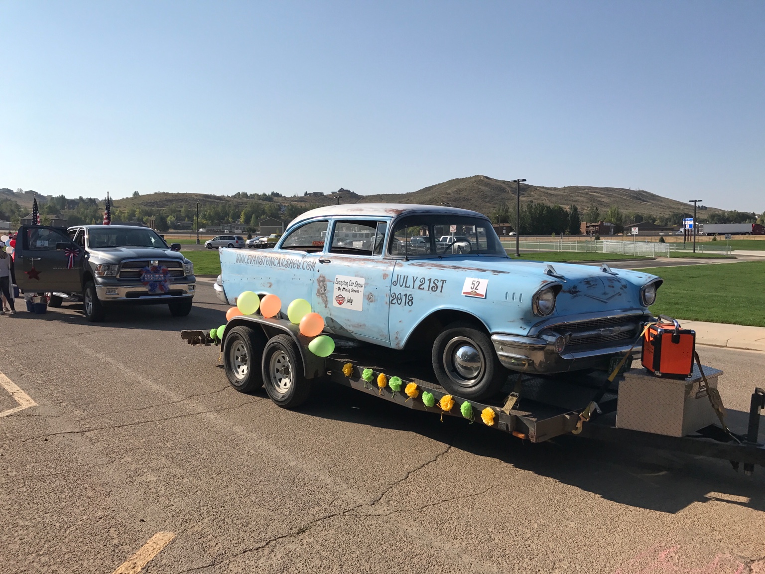

    I have some videos of this on YouTube I'll post a link soon. I have made some progress but not in the way of the conversion, I bought a crate engine and am currently installing it I also did a quick faux patina paint to use the car in the labor Day parade here in town I AM GOING TO PAINT the car just for now it's being used to advertise our car show! [​IMG][​IMG][​IMG][​IMG][​IMG][​IMG]

    awesome fake patina

    Does look pretty decent at least in the pics, I would be tempted to take it back to this, put the trim on it and roll for now.
