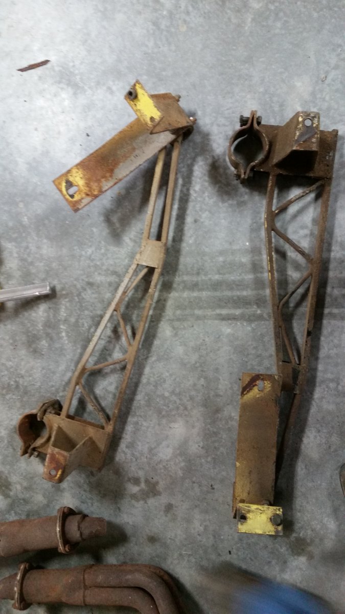

    Rear suspension. I have looked at and read a lot of threads but I still feel really stupid on this.
    My knowledge of rear suspension is basically limited to leaf springs and slapper bars, Caltracs would be hi-tech for me. That is the way I am wanting to go out of simplicity's sake, but I would like this thing to work good and look the part of a real gasser.
    • Leaf springs and traction bars
    • Ladder bars with leafs and floaters
    • Ladder bars with coil springs and separate shocks
    • Ladder bars with coil-overs
    If I go the ladder bar route I feel like I am going to have to enlist a chassis guy to help me. I have attached a picture of some clamp on style ladder bars that came with the 56, but I don't think that they would really be a good choice, maybe I am wrong?
    els likes this.
