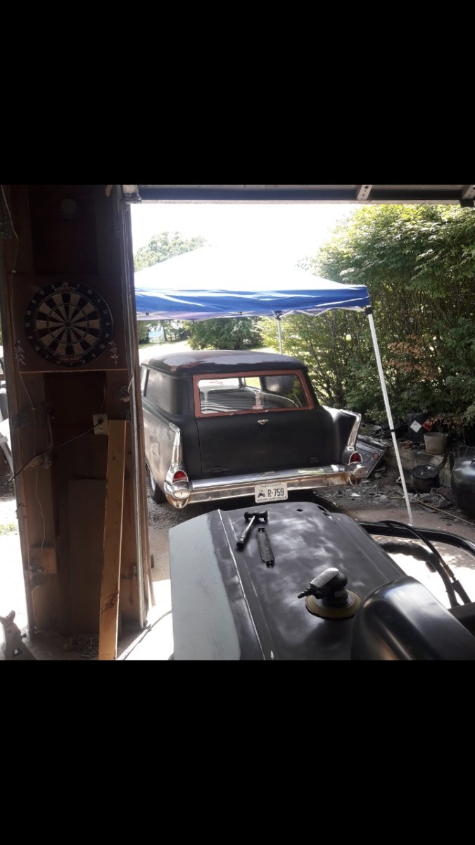

  27. When you've got way too many jobs going on to get your own car in the garage and it's hot as hell outside, you come up with a way to make things work :D Screenshot_20200726-144310_Gallery.jpg

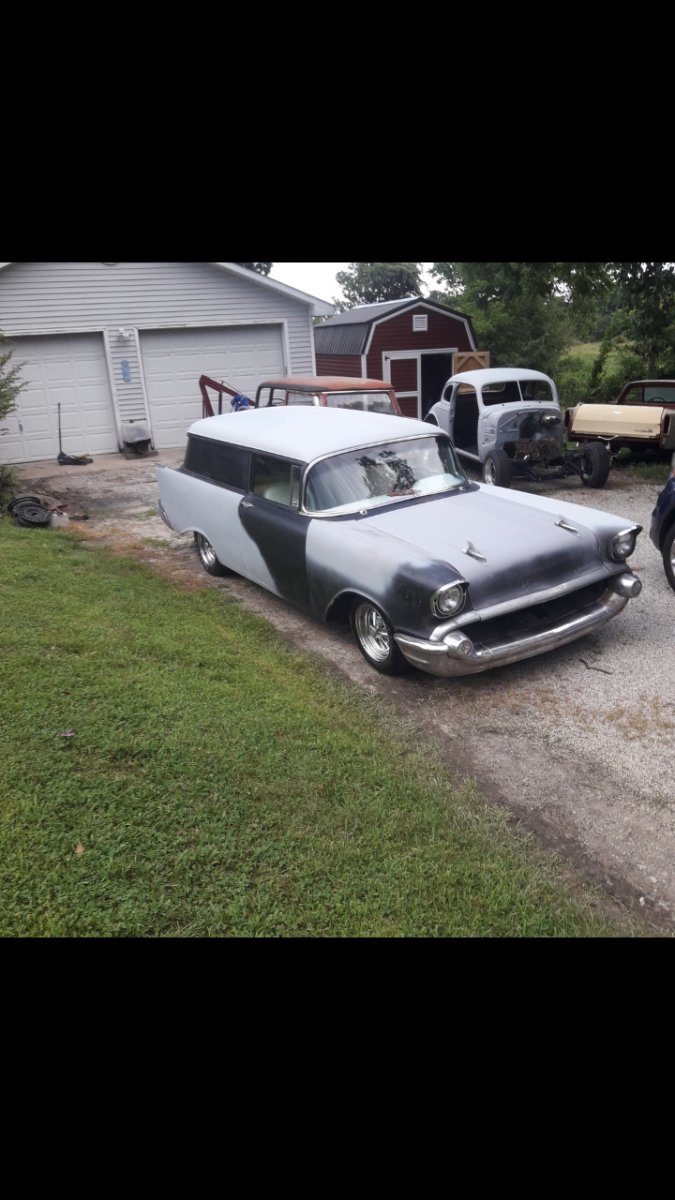

  28. Alright, bodywork done on the top, and the left fender. Screenshot_20200726-185813_Gallery.jpg Screenshot_20200726-185810_Gallery.jpg

    Yeah, get back to slinging some mud, that other stuff was boring me. :D
    Lookin' good.
  30. Ain't that the damn truth!! Thought about doing some other stuff, but i decided to just do some bodywork ;) i did put some plug wire separators on it! Gotta do a little filler work on the tailgate and the hood. Finish a little place on the left quarter panel, and I'm calling it good :cool: I'm gonna shoot the top white and lace it with white diamond pearl. Then I'll figure out the rest. I'll do the top this week.
