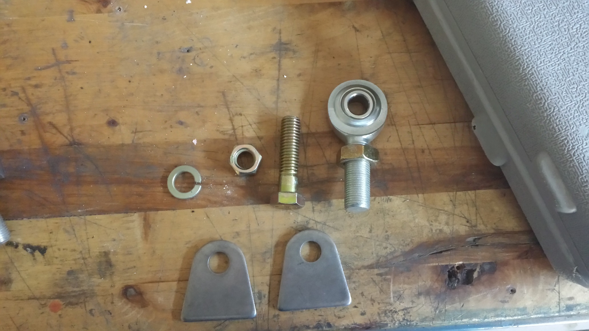

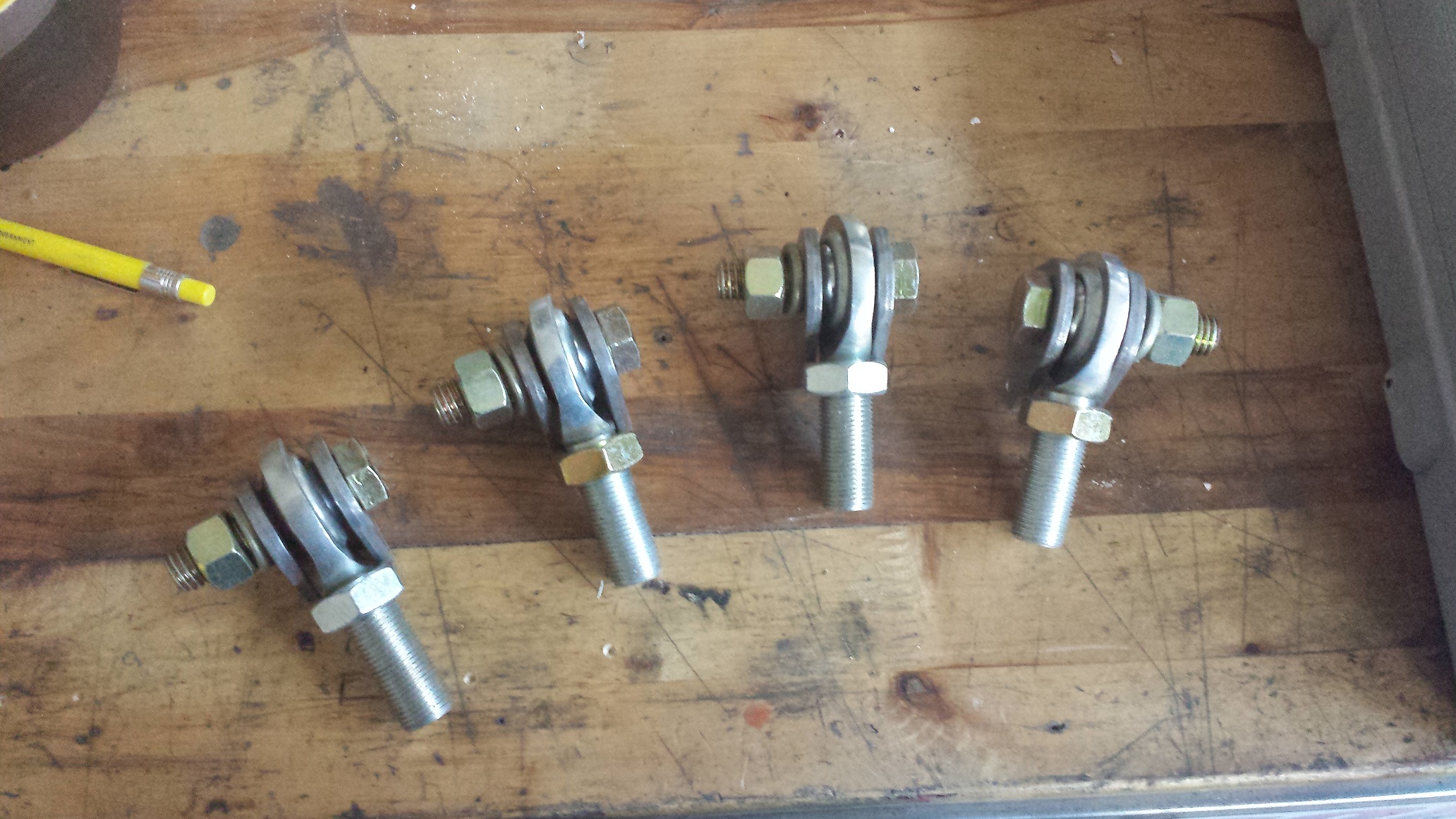

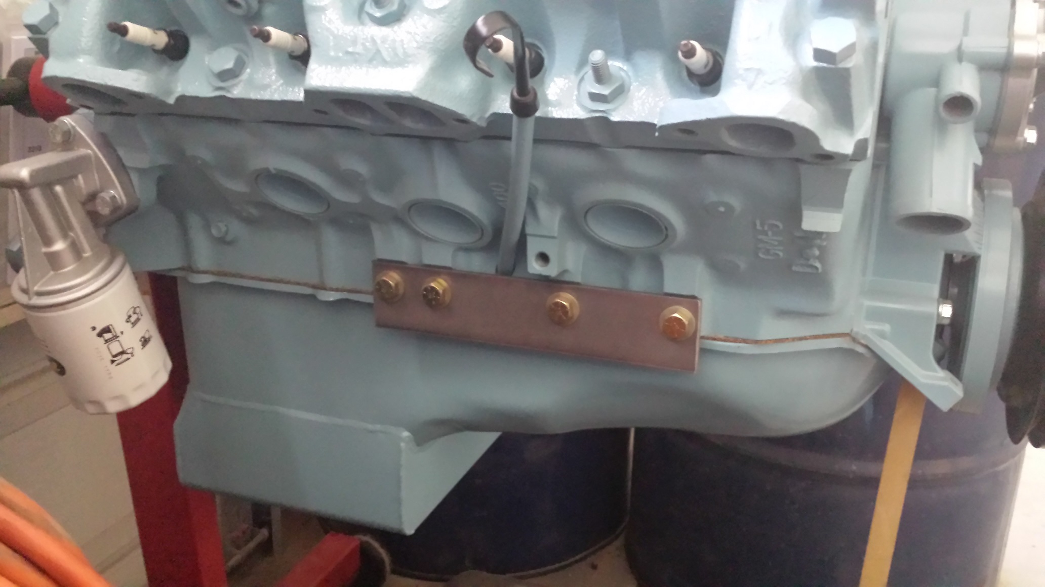

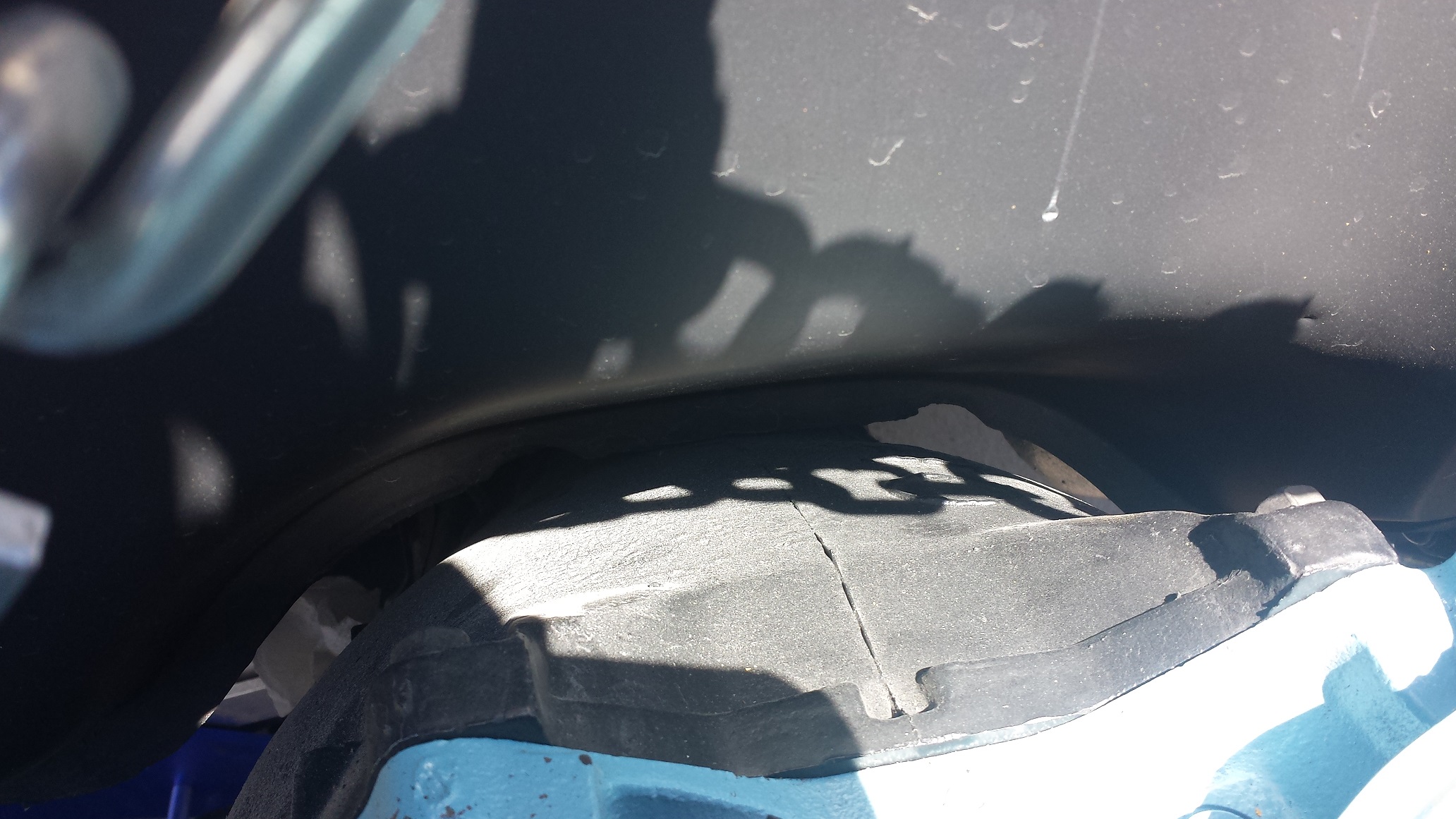

  12. Well that has been the most current hold up for me as well but I think I got it all figured out. I took some quarter inch flat stock and made some plates to bolt up to the engine and sandwich the frame rails, then I went online and found some high misalignment threaded rod ends(left and right hand thread) and made some tabs. I plan on mocking up the engine exactly where I want it and then its as simple as welding the tabs to the plates and using inside thread radius rod to connect the rod ends on the engine and frame. Bam! Fully adjustable motor mounts! At least in theory. 20140808_163831.jpg 20140808_163941.jpg 20140808_164029.jpg

  22. Ok so I finished up the front motor mounts so now I just need to finish the trans mount and its off to paint. Here I am just mocking up where they go 20140901_111129.jpg 20140901_111150.jpg

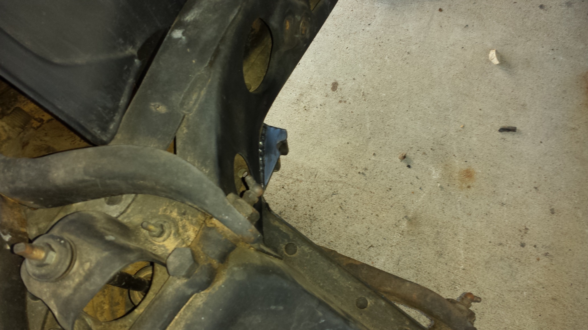

  23. I had raise the engine up a little so that the ram air exhaust manifold on the drivers side would clear the steering gear box. This caused a little clearance issue with the trans hitting the tunnel, nothing a cut off wheel cant solve though. In hind sight thought it was just the pinch flange that I needed to get rid of. 20140901_111101.jpg 20140901_112922.jpg

    Nice work, i've had my engines mounted in a few ways, built side mounts to frame and also both styles of the Hurst mount. Now using the later style Hurst that uses the side mount holes and extends to the front with biscuit type mounts. Keep in mind the angle of the engine to rear pinion so they match and not have vibration issues.
    Lokar makes a column mount cable shifter kit, may want to look into that. Not much room for a floor shifter in front of the seat, almost hardly room between dash when in park.
    That flange at the firewall I bent flat on mine.
  25. After I got the engine to sit where I wanted it I welded up the passenger side engine plate and then used some tie rod tubes to position the bottom tabs and weld them up 20140901_155313.jpg 20140901_155333.jpg
  26. Thanks for the advise, I had to shift the engine around a bit but I was able to keep the 5 degree tilt back and the trans tail shaft looks to be about the same. Like I mentioned earlier I am running a TH400 so its not in the same "exact " spot.
