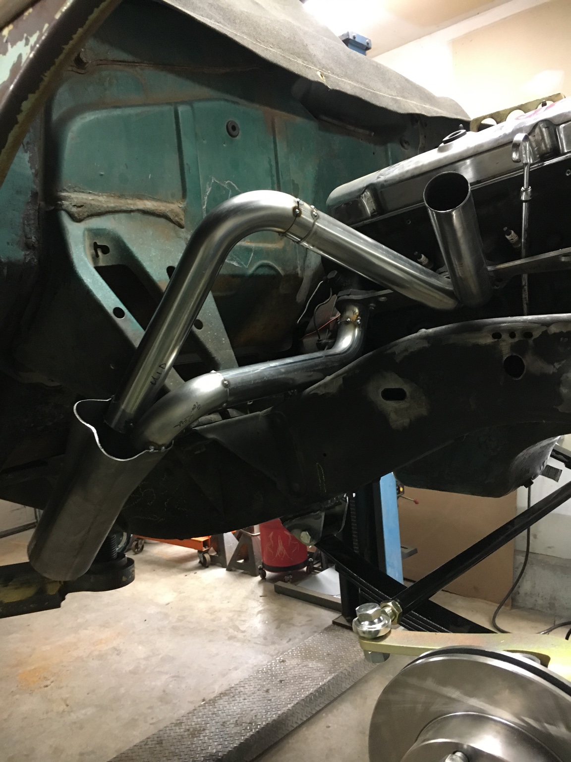

    I figured I'd start a thread on the build up of our new project. We picked this Pontiac up of a buddy of ours back in august. Drove it the rest of the season and started tearing it apart once the weather turned cold.
    Hanging out next to my other race car "the Gizzle hopper"
    Anybody should be able to recognize this guy we saw at Pontiac nats in august.
    And now the fun began a few weeks ago. Pulled in the shop and got the motor and trans pulled out.
    Then proceeded to cut the front suspension out in prep for a new straight axle kit.
    Axle mocked up in place
    And fully welded sitting at about ride height.
    Set the motor and trans back in.
    Started building headers on Monday of this week.
    Ended up with these last night. Getting ready to go out in the garage to start the driver side after dinner.
    All comments and suggestions appreciated. Been watching some threads of Pontiacs on here. With the help of bill-55chieftan and the thread of another 56 were to the point we are now. If the cars done in time we'll probably take it to BG Hotrod reunion and we'll make sure the cars done for meltdown! Also planning on dragweek again this year with this instead of my truck.

    nice! headers look great! keep up the good work!

    You putting a slip joint in that back header tube and splitting the flange so you can take it out I hope.

    I'm torn. I say this after cutting my 56 up. I would have had a hard time doing anything to that car. I've loved that car since it turned up here years ago.
    On the other hand, that you want to make it more competitive, well, damn, can't complain about that. I just hope you make it more competitive without messing with it any more than you have to.
    It's your car though.
    P.S. nice work on the headers.
  5. Looks like a mixture of engine parts. You using a hydro, side mounts then?

    The motor is a 59' 389 and yes there was a hydro in the car. We're switching over to a 4 speed. The bell housing im using has side mounts.
