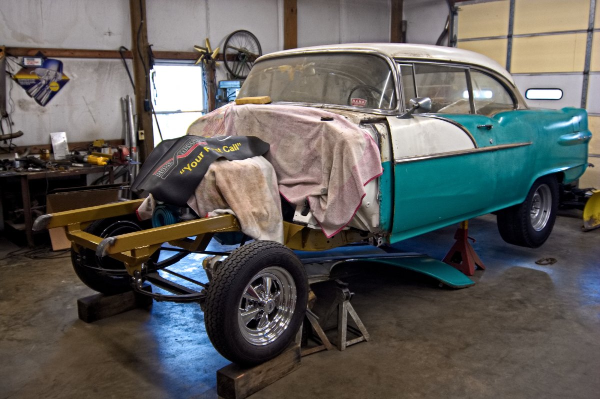

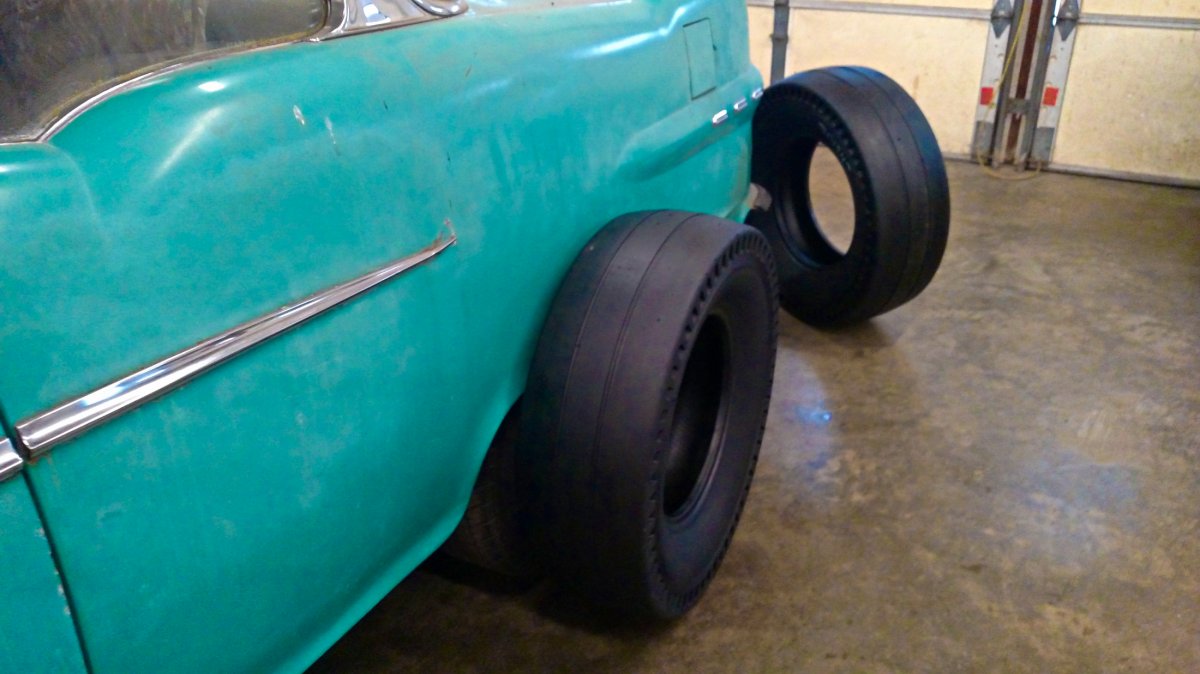

    I haven't got alot done over the holidays but these showed up on porch. Hopefully get them mounted tomorrow.
    IMG_20180103_163606866.jpg IMG_20180103_163624691.jpg IMG_20180103_164220133.jpg

    wvenfield

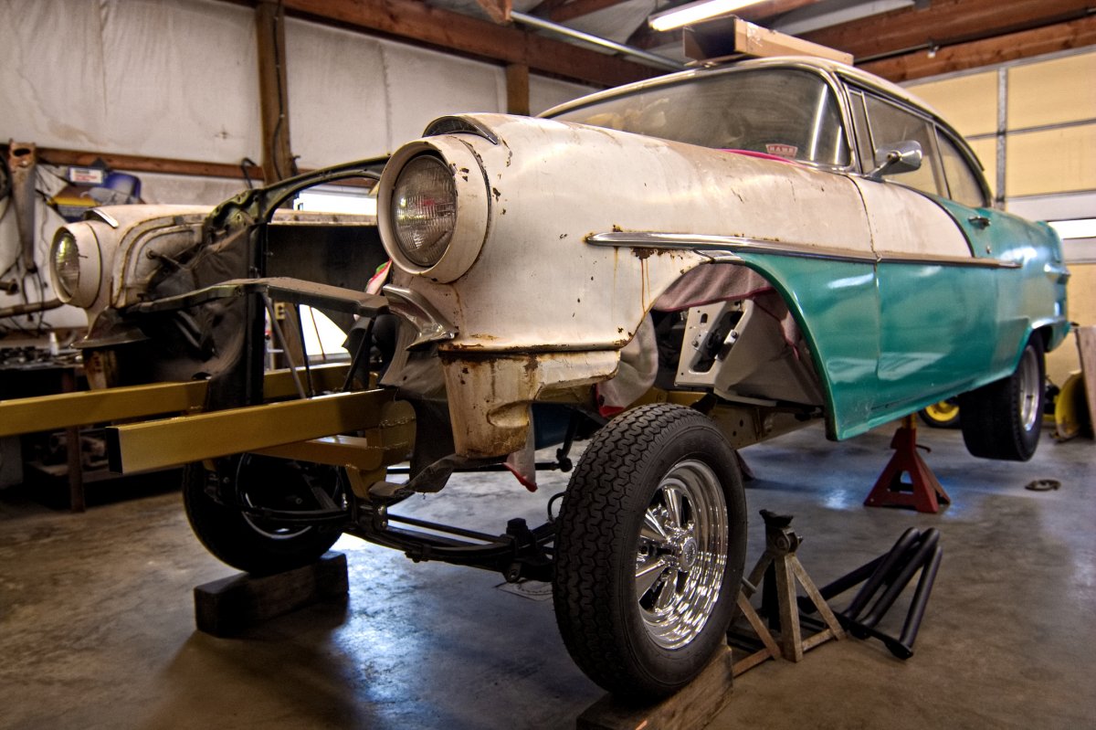

    Sitting on jack stands........I think if I wanted to I can leave the wheel wells if I simply roll the lip. Too cold even with the heat on to mess with it for now.
  3. wvenfield
    Joined: Nov 23, 2006
    Posts: 4,534

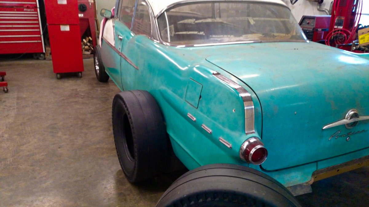

    wvenfield
    All kinds of room on the inside. I think I'll change the offset on the wheels and leave the rest.

    It was probably said earlier in the thread but, what are all the specs on rear end width, wheel sizing, and offset and tire sizes? I want to stuff as much tire as I can with out cutting the wheel wells. I don't mind modifying stuff on the inside. Looks like you have a pretty wide tire setup.

    I'm going to check offset next week. I'll update. It's a 1969 GTO axle. Best I can find, flange to flange is appx 61 inches. The wheels are 15X8. I think the guy I got them from said they were standard Corvette something or another. LOL Tires are 15X9 28.5 tall.
    To leave the quarters without doing anything I would without question have to roll the lips but I have a lot of room on the inside. With a 1/2 inch different offset everything will fit easily.

    I can get these done locally. I'm just going to have them moved in 1/2 inch or so. If the lip was rolled and the quarters pulled I probably could get 10 inch tire under there. Another thing noted earlier. I'm not getting slicks under there without disconnecting the rear shackles and springs. Maybe with standard lugs but probably not.

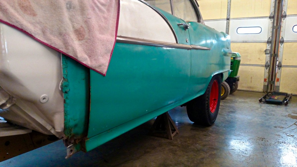

    I've been busy on other things but the rims are 15X8 with a 4 inch offset. Still deciding if I want to change the offset on these or just find a couple 15X8 with a 5 inch offset. Everything would then clear easily.

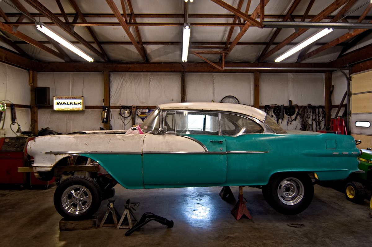

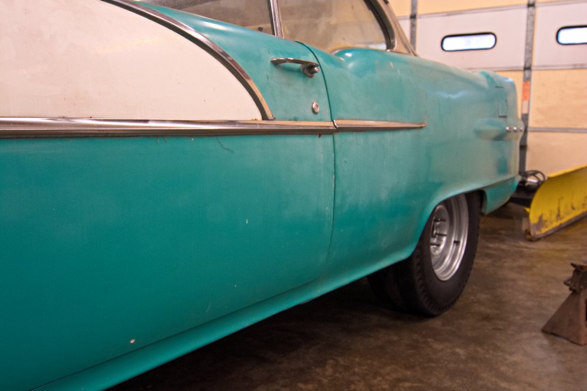

    I know it's not full race but........15X8 with 5 inch backspace. I now have all kinds of clearance all around.
  12. bchctybob
    Joined: Sep 18, 2011
    Posts: 1,298
    bchctybob
    Wvenfield, I haven't checked in on your thread in a while, your Pontiac's coming along nicely! Very cool that you got those tires under there without a bunch of cutting. What tires are they and where did you get them, they look perfect for one of my projects.
    Did you get the header problem worked out? I was going to mention, Mark Yac said that the 1 5/8" primaries are kinda small for most Pontiacs, I agree. You could get some 1 3/4" U or J bends and use about 10" of the 1 5/8" tube at the ports and slip the 1 3/4" over it and continue to the collector giving you a "step" header. You could even add 1 7/8" for the last bend or two into the collectors. The step headers I did for some of my customers ran very well and the fact that the tubes slip over each other even makes the creation of each tube easier. Just be sure that the ports in the header are as big as, or slightly bigger than the ports in the head.
    Keep up the good work, can't wait to see the start up video!

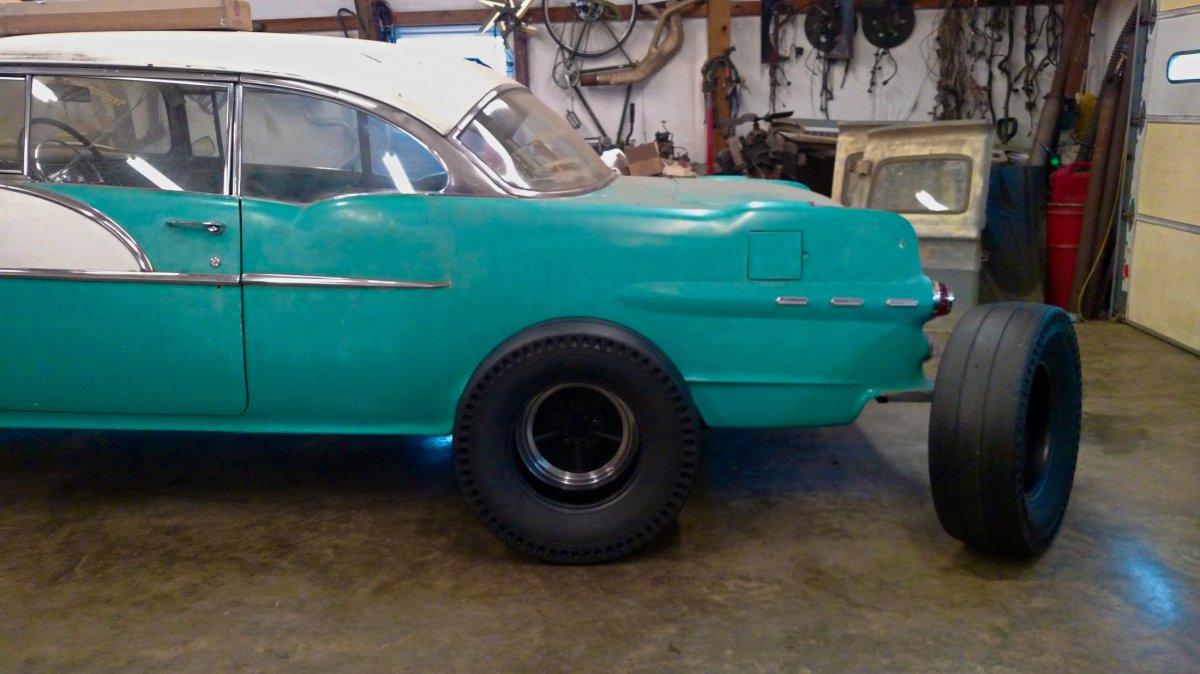

  13. wvenfield
    Posts: 4,534
    wvenfield
    The tires are Towel City. 15X9. I think they are like 29 inch tall. I have a set of Ford Headers that are close. I bought a cheap plasma cutter and we are going to cut out some flanges. Yes, that is probably a little overkill but I just wanted to do it. I have other pieces we have to make also plus we will have it around for other things. I will get some elbows and make the Ford headers fit.

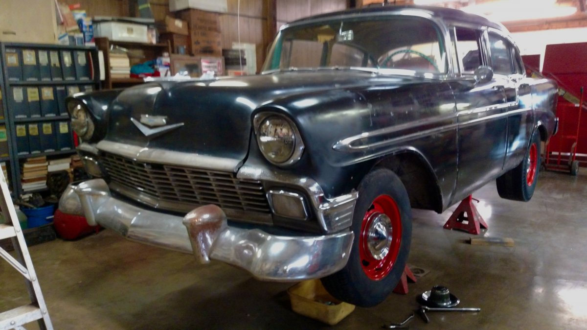

    It's been slow but my buddy that owns the garage just bought a 56 Chevy 4 door and will soon be itching to 2 door it so we have to get moving on the Pontiac.

    bchctybob
    Thanks for the tire info.
    Looks like a nice '56. Tell him to post a thread on the conversion, I'm sure there will be lots of interest.

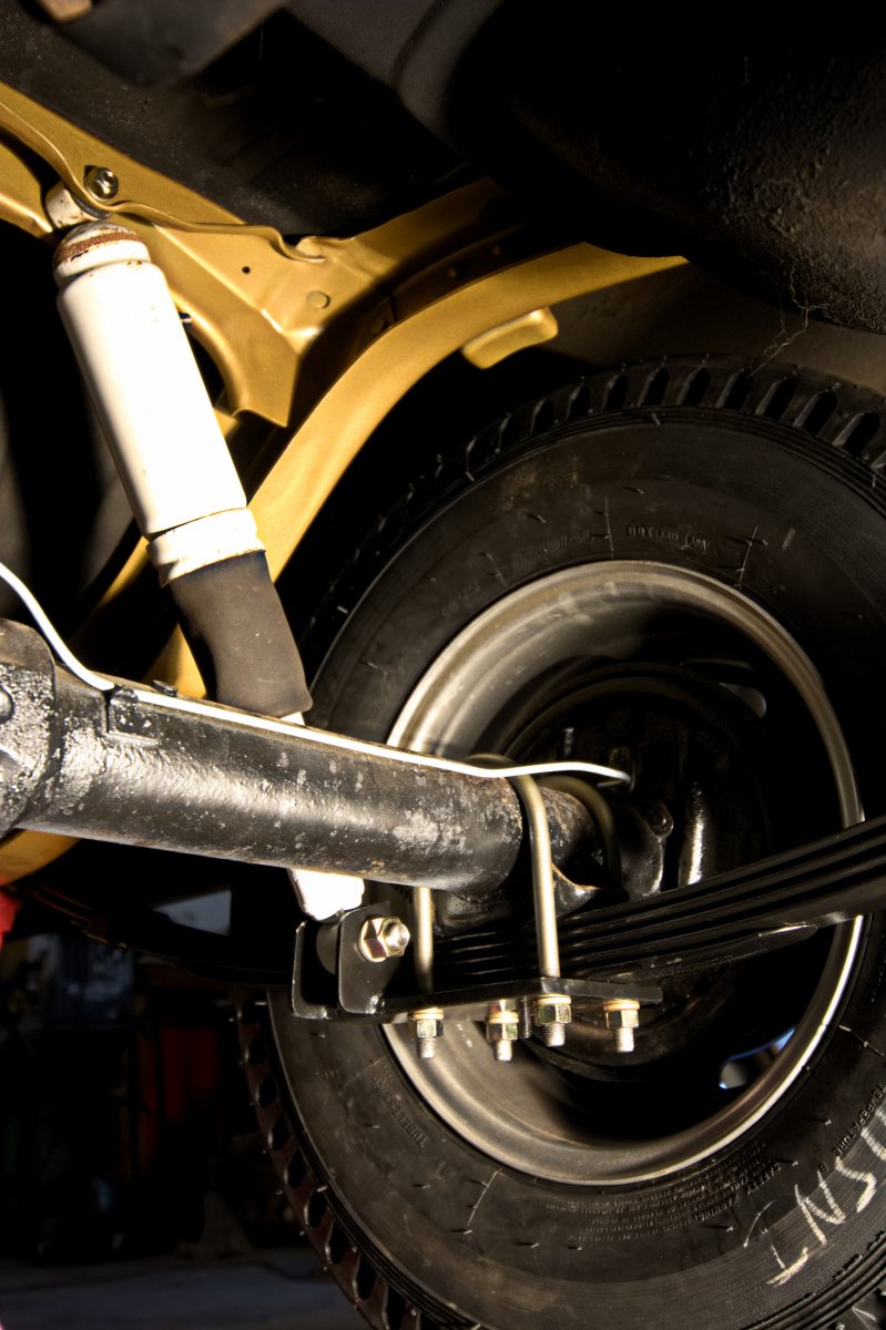

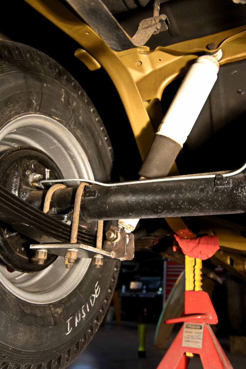

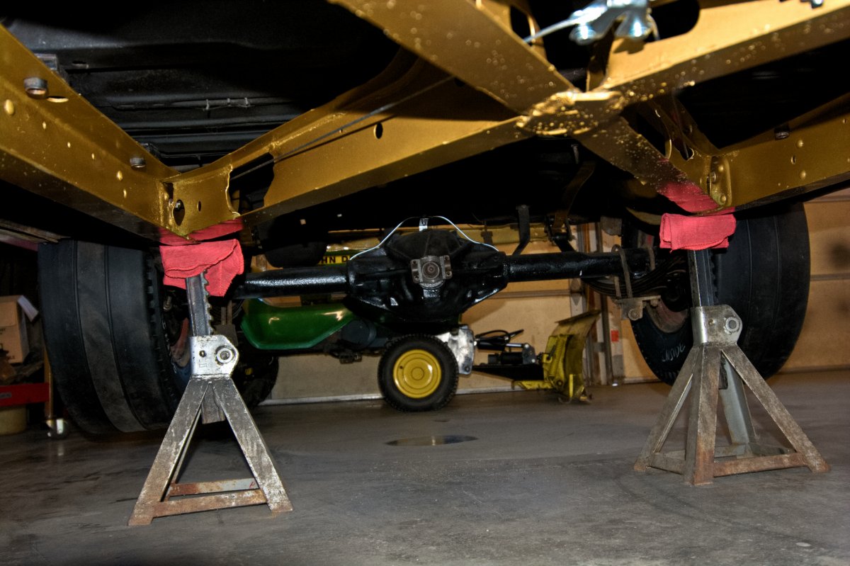

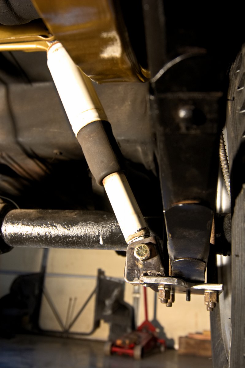

    Mostly just posting for a record of the progress in case I ever do get done........but I also wonder about something. My rear springs had one leaf that was cracked and the other side had been buggered up (for some reason I never bothered to actually count the leaves). Took them to a spring shop (the only one anywhere near close to me).
    We re-arched the fronts ourselves (pics are earlier in post) and took a couple days. I got lucky I think. One side had an extra leaf for some reason and it happened to be the one that was cracked on the other side. This shop has a really good reputation and highly recommended so..........He looked at my springs and said they were otherwise in excellent shape. That they no longer make the steel for a beveled leaf spring and he would re-arch them and put the extra one in place of the cracked one and I would be as well off as him making a new set. It's wonderful to have the right equipment as he had it done in little time. Sound right?
    The lower bracket pinched with the later axle and perch. We decided rather than drill new holes to just make a new bracket (again, a multi day job for us hackers) LOL. On the factory mount the shocks mount below the spring. We did it so it would mount above it and I should be able to change tires without removing the shock. (Sound and look right)?

  17. D-man313
    Joined: Mar 17, 2011
    Posts: 1,125
    D-man313
    I never thought about changing the shock mounting location like that. Going with a longer shock and moving the lowest point higher up, should equate to letting the axle drop farther down. I'll have to do something to make changing tires easier on dragweek. And I'm not cutting the quarters.
  18. wvenfield
    Posts: 4,534
    wvenfield
    They aren't perfectly square but I wonder if you could flip them from one side to the other? Stick the mounting bolts up as opposed to down? Like I said, mine pinched so I had to do something else also.

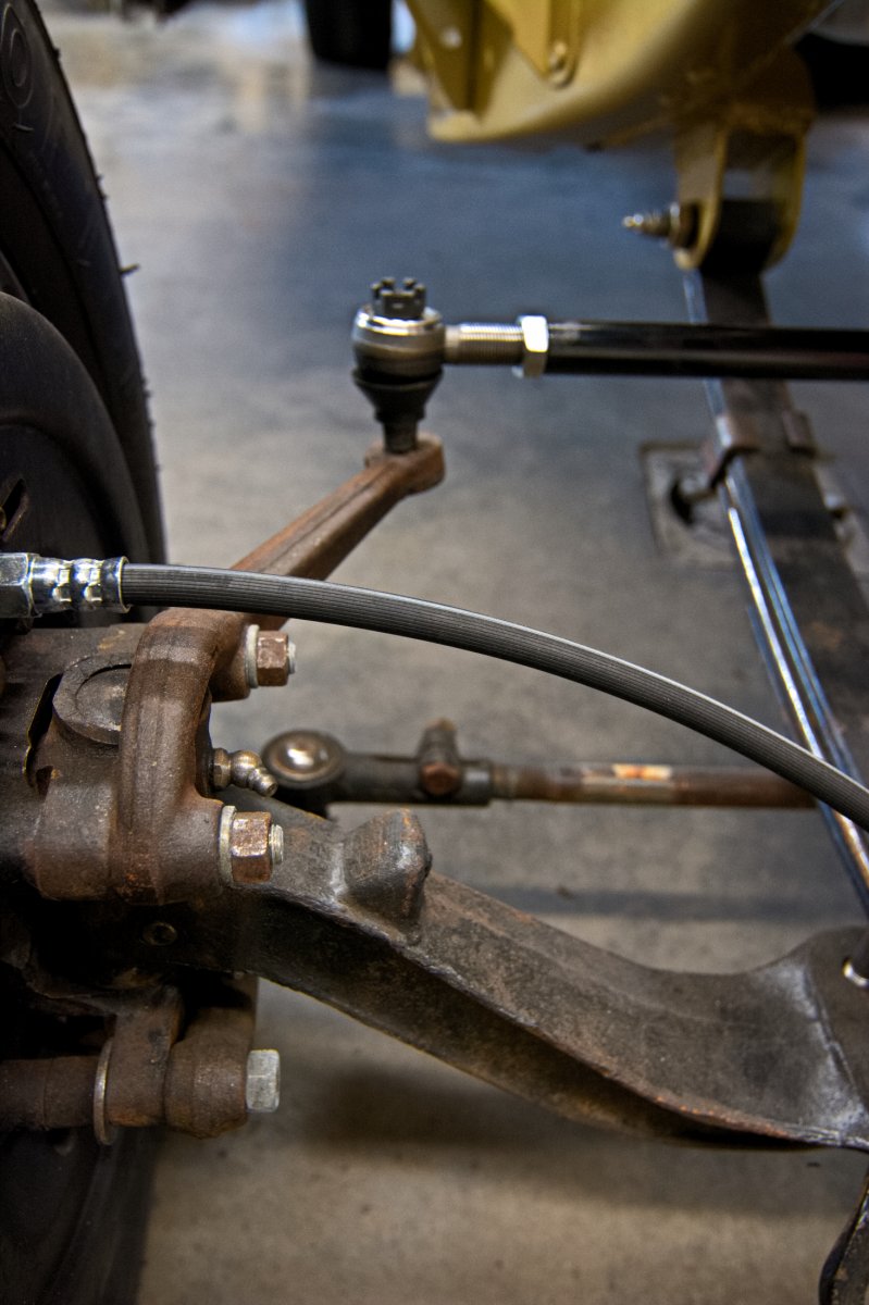

    It shocks now. QUESTION: I've seen this answered but I'm working nights (and obviously not getting enough sleep so I don't feel like searching). I need to taper the steering arm to put the tie rod end through the top as opposed to the bottom. This is off an early 50's Chevy truck. What is the taper? What bit do I need and shouldn't I do something else as the bottom is still going to be tapered? (Sorry, never done this before).
    DSC_2954.jpg DSC_2955.jpg DSC_2956.jpg DSC_2957.jpg DSC_2958.jpg DSC_2959.jpg

  21. wrenchbender
    Joined: Sep 5, 2007
    Posts: 1,501
    wrenchbender
  22. wvenfield
    Posts: 4,534
    wvenfield
    Thank you! It works OK with the bottom still being tapered? (I'm assuming so but I'm still going to ask)
  23. wrenchbender
    Joined: Sep 5, 2007
    Posts: 1,501
    wrenchbender
    Yes but be careful and don't ream it too deep you don't want the tapered part of tie rod end below the bottom of the steering arm because if you bottom the nut out it won't be tight lol

  27. saltflats
    Joined: Aug 14, 2007
    Posts: 8,525
    saltflats
    from Missouri
    If the hole is way larger than the small end of your taper at the bottom a new larger taper would be the best fix.
    loudbang and wvenfield like this.
