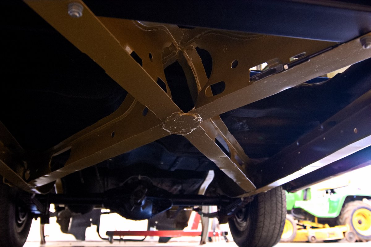

    Going back under the car. (I really just wanted to see if I could figure out how to do this on my phone)

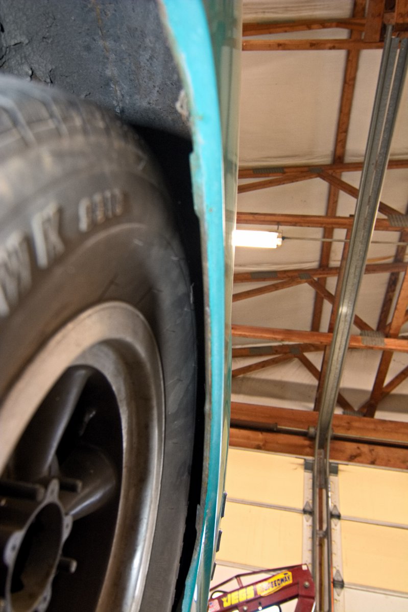

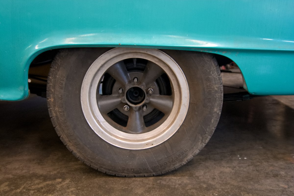

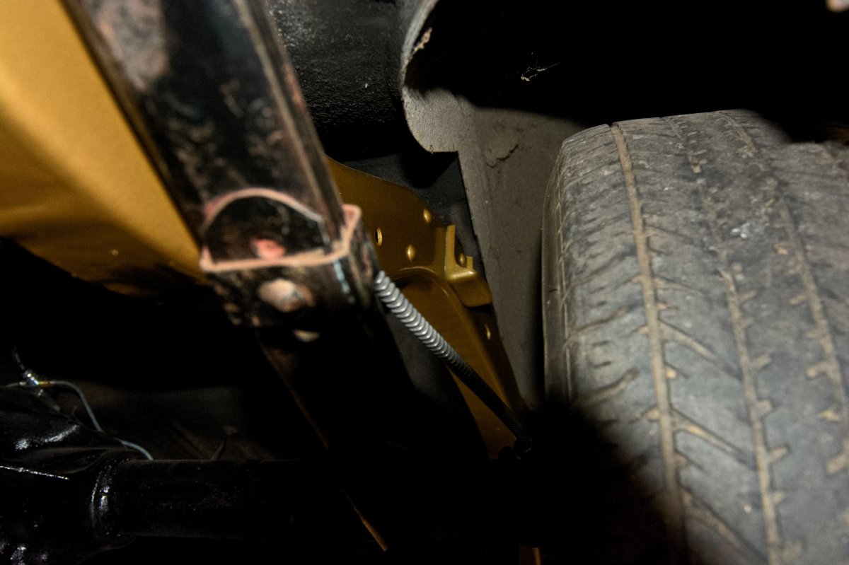

    I know it's not real "race" but I really hate to cut these quarters. The car really is super solid with very, very little rust so I hate to cut the quarters. I think I will be able to fit a 15 x 9 inch slick with a 4.5 or 5 backspace steel wheel.
    I probably will have to drop the rear spring to get them on though.

    Damn, that's close....:eek:

    I may roll the lip a bit if need be.

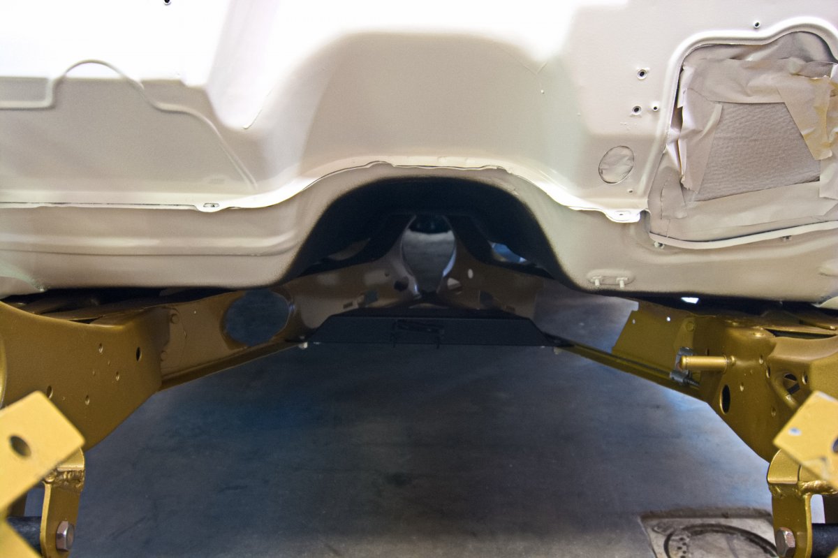

    From the pictures you posted, I'd say you could do the tri 5 Chevy trick. Relocate the leaf springs to under the frame. Cut and move the inner wheel tub inboard toward the frame. Fill the gap with a strip of sheet steel. A narrower rear or offset wheels will give you room for rubber.

    The Chevy spring kit will not work. The frame is differant , the Pontiac spring is on the outside at front than frame kicks out and spring lines up with frame at the back. Think the Chevy frame is straight all the way back.
