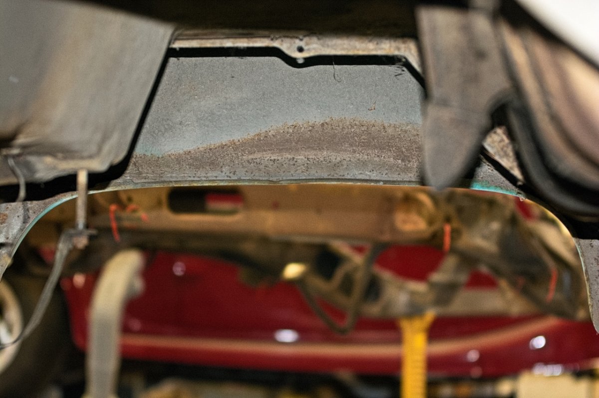

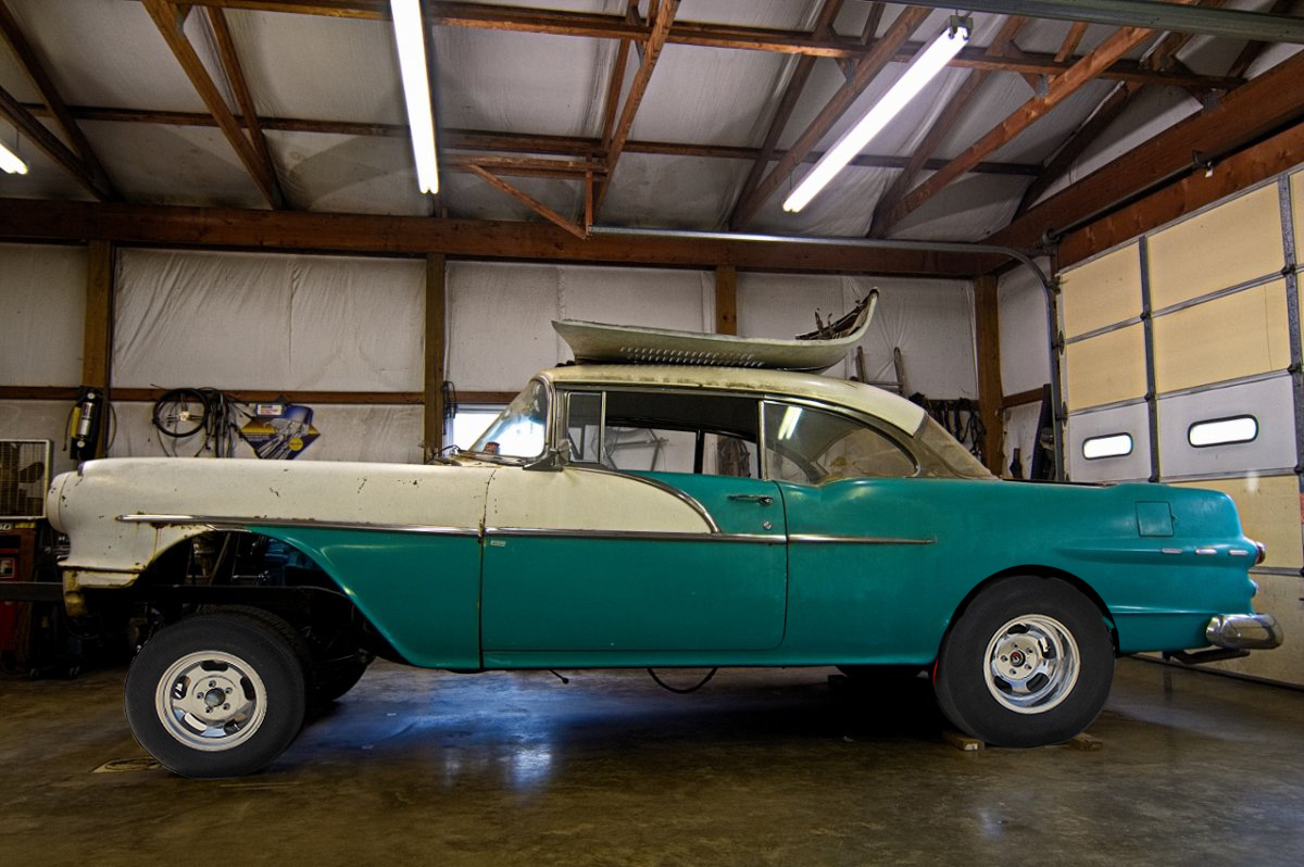

    Sorry it took so long to do the photoshop but here is an idea. 56 Poncho gasser wvenfield w slots.jpg
  2. 55chieftain
    Joined: May 29, 2007
    Posts: 2,123
    55chieftain
    I found some longer shocks and modified them to work. It allowed the rear end to drop down further without affecting the ride, I had 15x7 cragars with 235 60 15 and could get them off easily. The replacement monroe shocks were actually shorter than the factory ones and made it worse. How wide is the GTO rear I thought the newer ones were a little wider? The 8.8 explorer rear was a little under 60" and helped some. Guess if your cutting the 1/4's doesn't really matter.
  3. wvenfield
    Joined: Nov 23, 2006
    Posts: 4,503
    wvenfield
    Much thanks......That helps with the wheel well cut to get some idea.
  4. wvenfield
    Posts: 4,503
    wvenfield
    I think I was told earlier that the GTO was a little wider. It was under my friends 55 Nomad that he drag raced. (It's ready to go). I have a line on a set of Vintage 15X8 and 15X4 Cragers but I have to find the time to go get them. (about 8 hour round trip)

    Looks good with radius wheel opening I think..

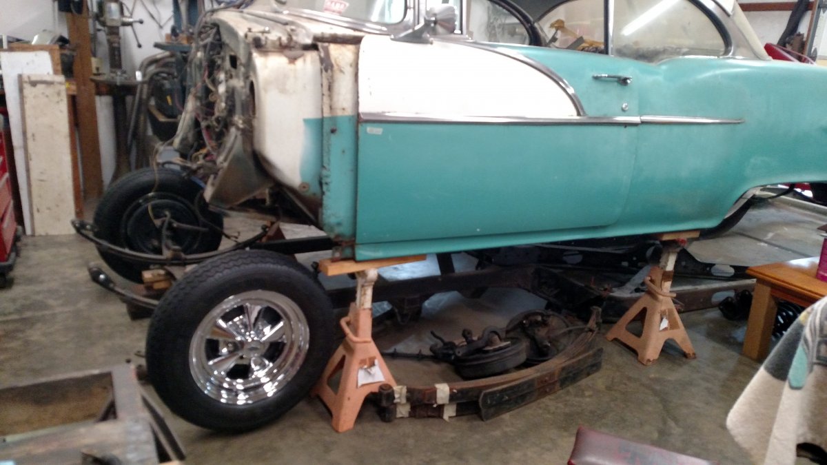

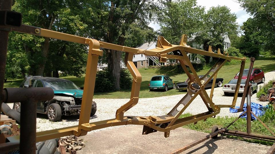

  9. wvenfield
    Posts: 4,503
    wvenfield
    Trying to get up the nerve. So nice for 60 year old wheelwells. I have to think I can get a 10 inch slick in there. Should have the rear end in place in the next couple weeks. Will measure and measure and measure again before cutting.
    Frame is all welded up. Just waiting for a decent day to get it outside and degreased.

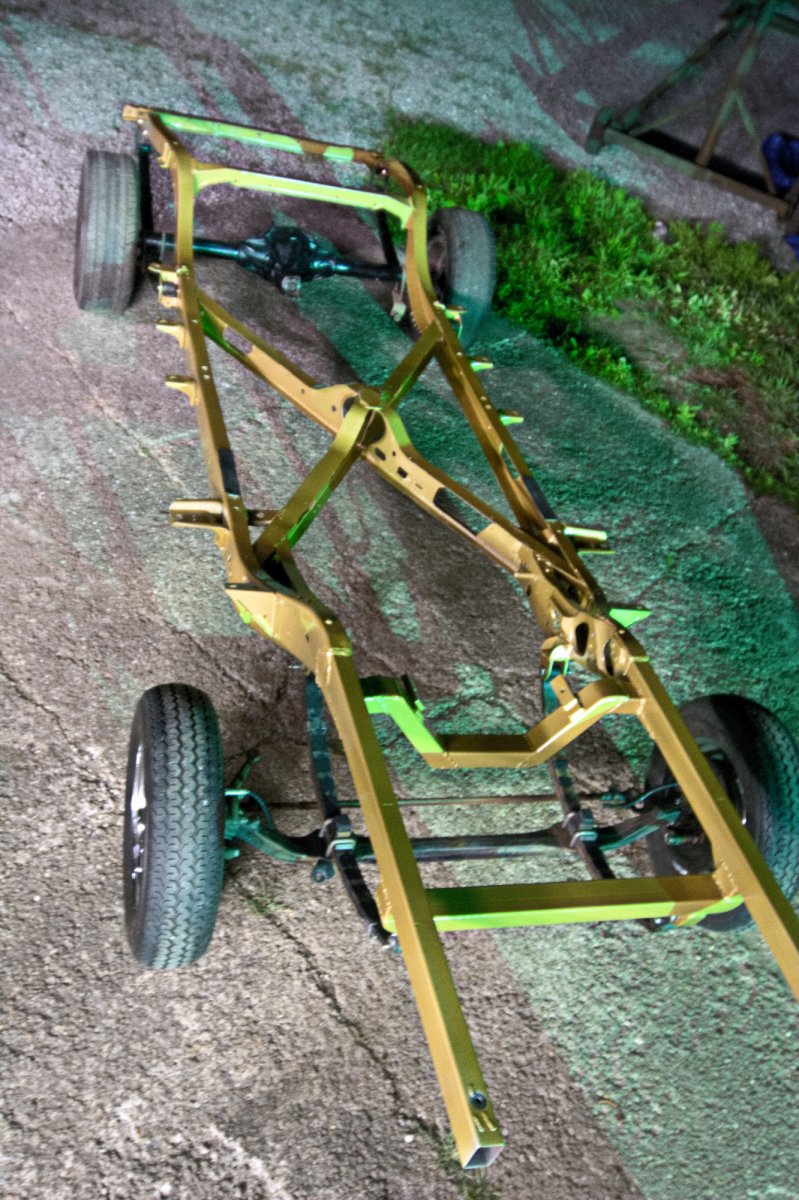

  11. wvenfield
    Posts: 4,503
    wvenfield

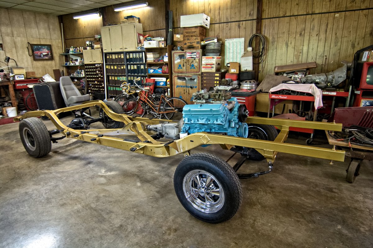

    Frame cleaned....rear end out of 69 GTO about ready to go in......Just measuring out in the yard it's a 1/2 inch or so wider.

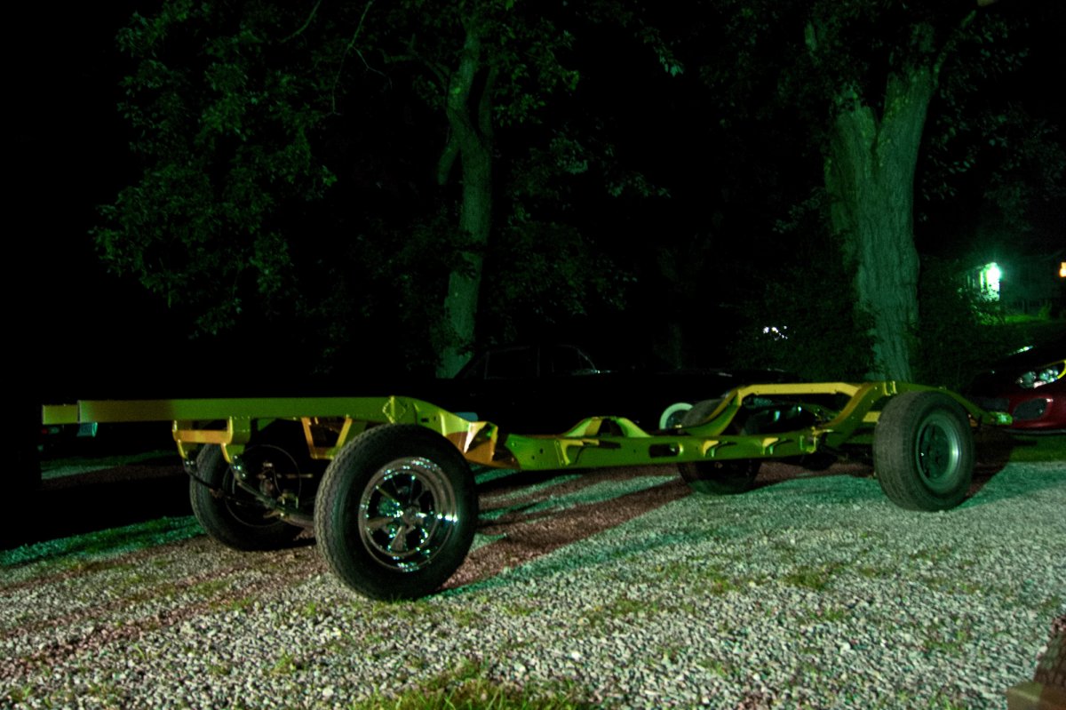

  13. wvenfield
    Posts: 4,503
    wvenfield
    Wow, been a year........had some family issues and got delayed. Anyway, new directions and back at it. Hopefully it will roll again by the end of next week.
    Found some fronts.
    Different direction on the intake.

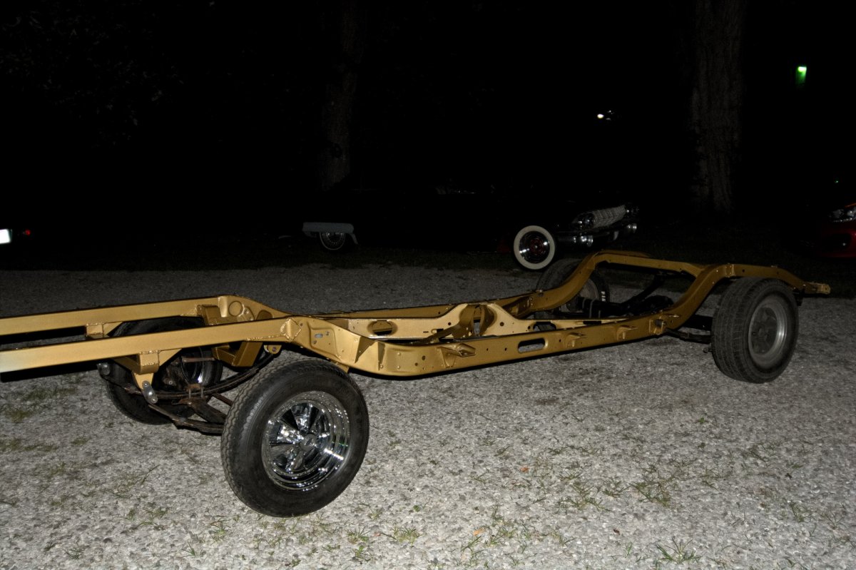

  14. wvenfield
    Posts: 4,503
    wvenfield
  15. OahuEli
    Joined: Dec 27, 2008
    Posts: 4,827
    OahuEli
    from Hawaii

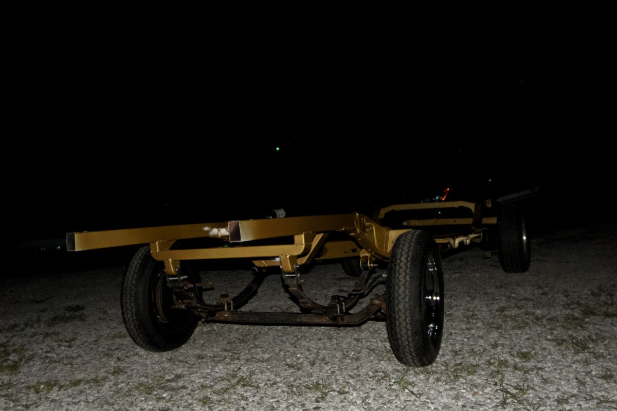

    Looks good! Are you going to leave the front frame tubing open?
  16. wvenfield
    Posts: 4,503
    wvenfield
    No, I got ahead of myself but the opportunity to do that presented itself. It still a foot too long or something like that. It will be cut off, rounded, filled and the paint touched up.
