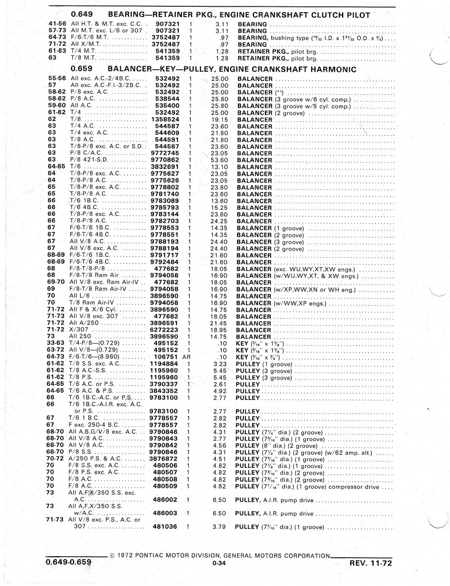

    Part of the heating issue is the water pump pulley, it way under driven to cool correctly. Second issue is the water pump design, those early pumps never worked very well. Try adjusting the inner plate closer to the impeller when you get it apart, it really helps the newer designed pumps. I will go through my parts manual and see if I can find a smaller diameter pulley, your other choice is to switch to the later front cover with the 11 bolt water pump. The engine block and heads rarely effect cooling, they hold plenty of coolant. I worked on two GTO's this summer with the early water pumps, and both heated up quicker then they should have, and both were fresh rebuilds. Pontiac changed pumps in '68 for a reason.

    I scanned the pages for you. The early pulley sizes are not marked, but most all A/C equipped engines use smaller diameter water pump pulleys. '66-'67 will work with the front cover you have.

    Pulley ratio's.
    7 1/4" diameter crank -- 8" diameter water pump = 1:1.1 under driven 1000 rpm /899 rpm water pump
    7 1/4" diameter crank -- 7 1/2" diameter water pump = 1:1.03 under driven 1000 rpm /966 rpm water pump
    7 1/4" diameter crank -- 5 11/16" diameter water pump = 1:1.32 over driven 1000 rpm/1274 rpm water pump
    https://www.blocklayer.com/pulley-belteng.aspx pulley ratio calculator.
    '73 and up - all A/C
    7 7/16" diameter crank - 6 5/8" water pump = 1:1.12 over driven 1000 rpm/ 1122 rpm water pump

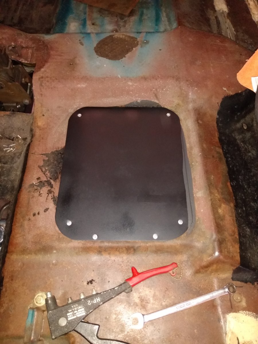

    Car does run and drive after 6.5 years. Sorry, no video yet. Mostly posting to document for myself.
    Filled in the holes in the floor where underseat heater was and where we made access for brake master cylinder.
    Filled in the heater box holes in the firewall.
